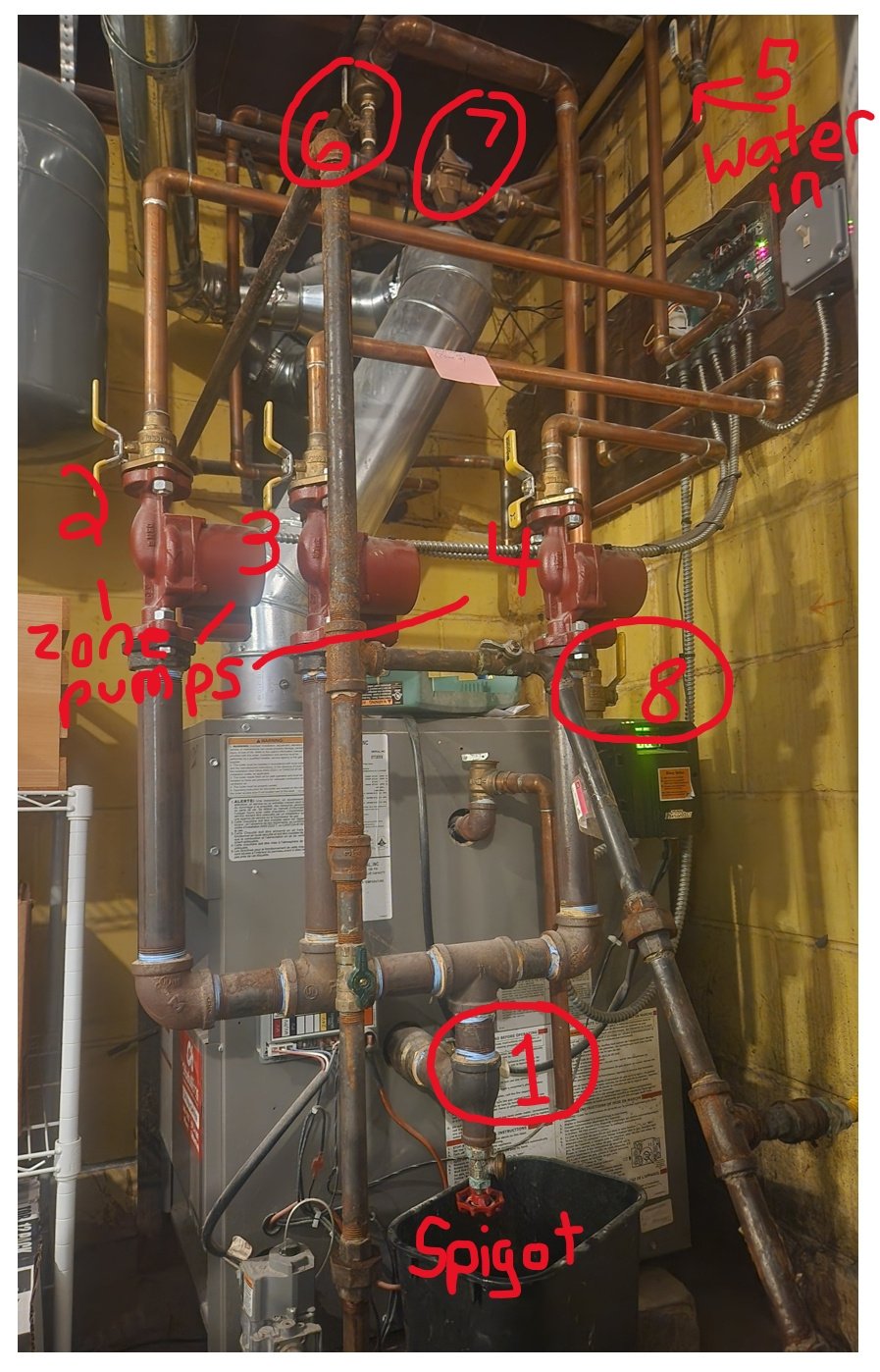

I’m guessing that I’m doing something wrong in bleeding the air out and that there’s some big air pockets in there that I’m just not able to get pushed through. If you agree that’s likely the problem, could you point me in the right direction as to what combination of valves I should have open/closed to ensure I’m pushing all the air out?  I’ve labelled some in the attached picture for ease of identification.
Could a check valve within the circulator pump be preventing me from bleeding out the air correctly? If so, how do I deal with that?

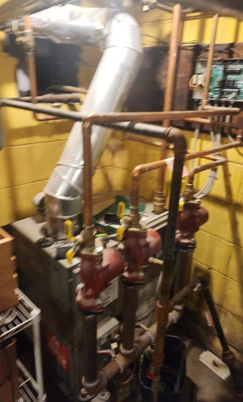

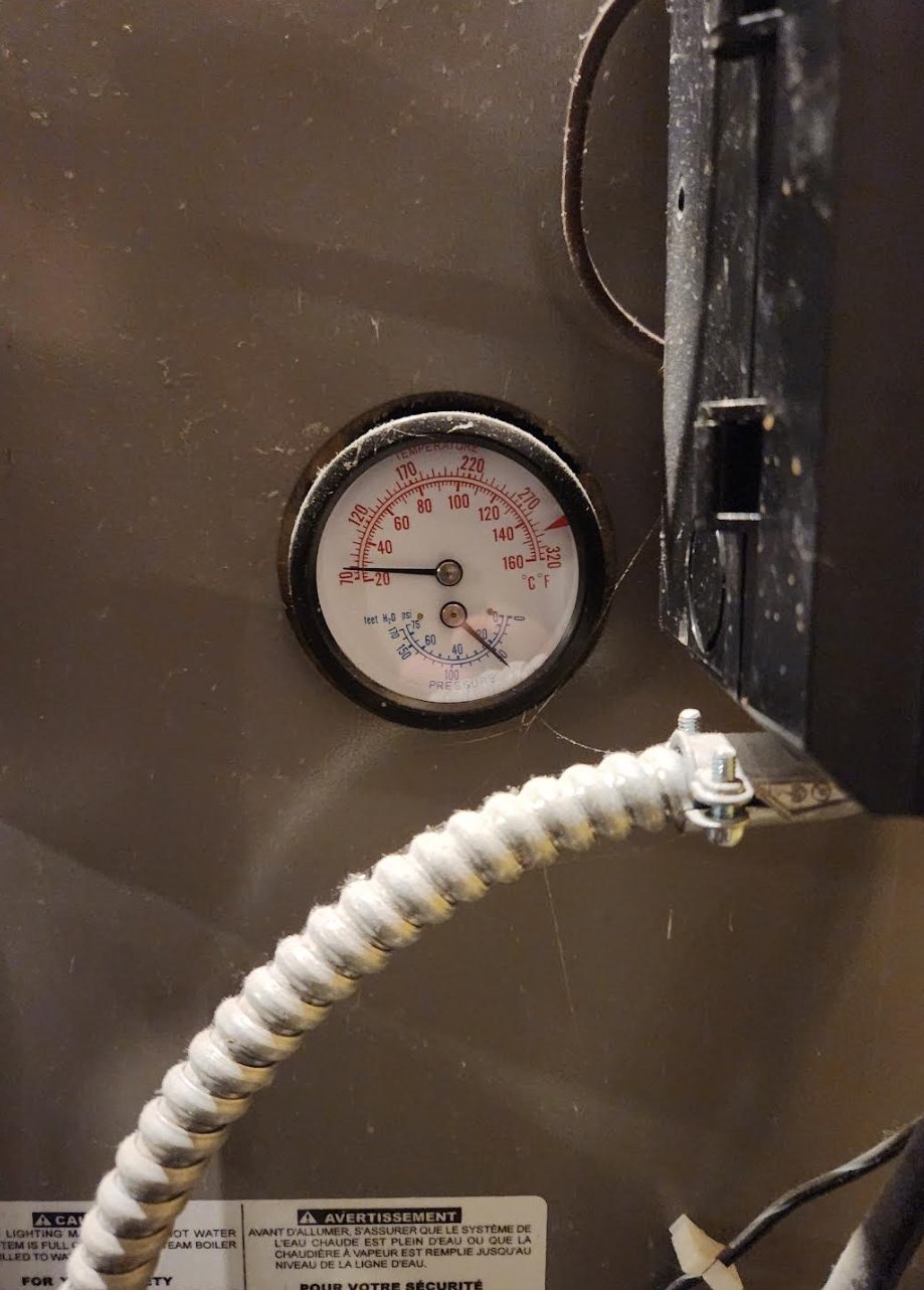

    what's the pressure in the boiler? post a picture of the gage,
    and another picture of the entire boiler, a little wider shot, floor to ceiling, from a different angle

    As long as they're not monoflo loops, close valve 8. If purging the top floor, close the valves at the circulators for the other 2 zones not being purged. Purge through spigot. Open ball valves when done. Its not exactly piped correctly. There might still be air in the boiler itself when done, but the Spirovent should make short work of it once there's flow.
    FWIW, whoever did the gas piping should be ashamed of themselves.

    Pressure is about 50 psi

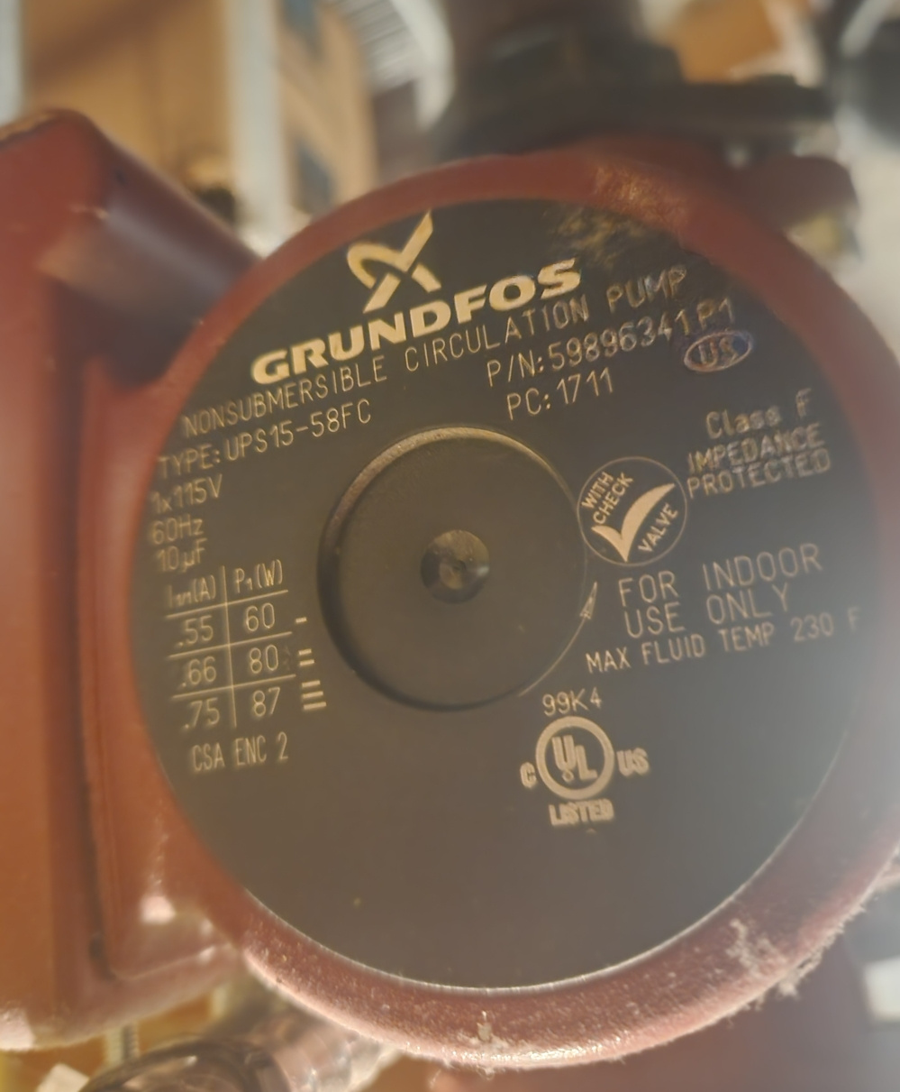

    Well, I'm an idiot. It ocurred to me that I should put a multimeter on the leads for the problematic zone's pump. It is indeed getting voltage, but I can't feel the pump whirring at all even when it has voltage. (Whereas the others do slightly whirr when they have voltage). So, I guess it is the pump after all. It does make sense that this pump would fail first, since it's the one dealing with the most head. I'm just surprised that I'm getting any heat in the upstairs basebaords if the pump is completely dead. I guess convection can accomplish a good bit, though. Or perhaps the pump is just barely turning. Either way, I ordered a new pump. Installing that next week will be interesting.
    Yeah that gas piping is horrible. My fault, though. After the plumbers installed it, I noticed an extremely minor natural gas leak. (Yes they should have dealt with that of course.) My temporary fix was simply rotating that whole assembly slightly clockwise, which tightened the problematic junction without the whole thing needing to be re-done. (Though I should get all that re-done asap!)

    Just for starters, 50 psig in the heating system is too high. It needn't be more than 25 psig, even for a three story building. Which causes me to wonder what the expansion tank is set up for…

    DOUBLE YUCK!!!!!!!!!!!!!!!!!!!!!!!!!!!!!!!!!!!!!!!!!!!!!!!, invest in three very well written books by Mr. Holohan, "PUMPING AWAY", "CLASSIC HYDRONICS" and "HOW COME"
    Where is your air scoop/air purger?
    If it was me I would cut that mess all out, make the home a single zone system, eliminate pumping into the boiler and replace the gas line mess.
    Using one circulator with isolation flanges and gauge ports for pressure and vacuum gauges and use pumping away with a pump module and three zone valves would be simpler.
    Seeing that exposed wiring above the gas valve is also troubling to me as a homeowner.
    You need to move the shelving that is in front of the boiler as it hinders the quick access to the boiler burners.
    A home plumbed as a single zone is so much simpler to deal with and live with.

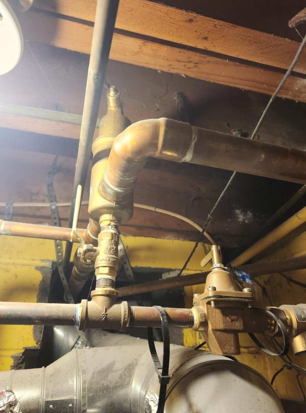

    Does the fact that I have one of these thingamajiggers mean I don't have to worry about air in my lines? Or are these only good at getting rid of tiny bits of air, not big flow-restricting pockets?

    I think you're reading 50 feet, and around 22 - 25 PSI, might be a little high for that low a temp,

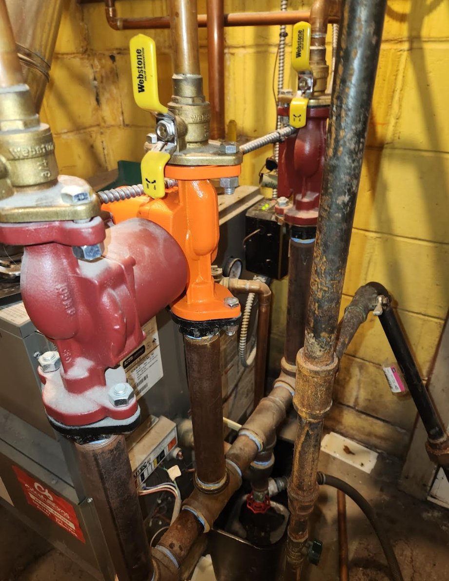

    did you change that circ yet?

  • Well, yes, it's a vevor, yes, its ugly, yes, it's not aligned the same as the other pumps… but it's in, it works, it's not leaking, and I have heat!! It'll be interesting to see if a vevor pump lasts. I'll try to remember to post here if it fails. I appreciate all your help!

  • Look at the Gauge in the photo. the arrow is pointing to 50 Feet H2O.
  • My bad, I was mis-reading the gauge. So 50 feet h2o is an okay pressure?

    50 feet h2o, 22 psi, at 80* may be a problem when you get back up to 180*,
    that 180 will expand the water, and if your tank isn't ready for it, you'll be testing and exercising the 30# safety valve
