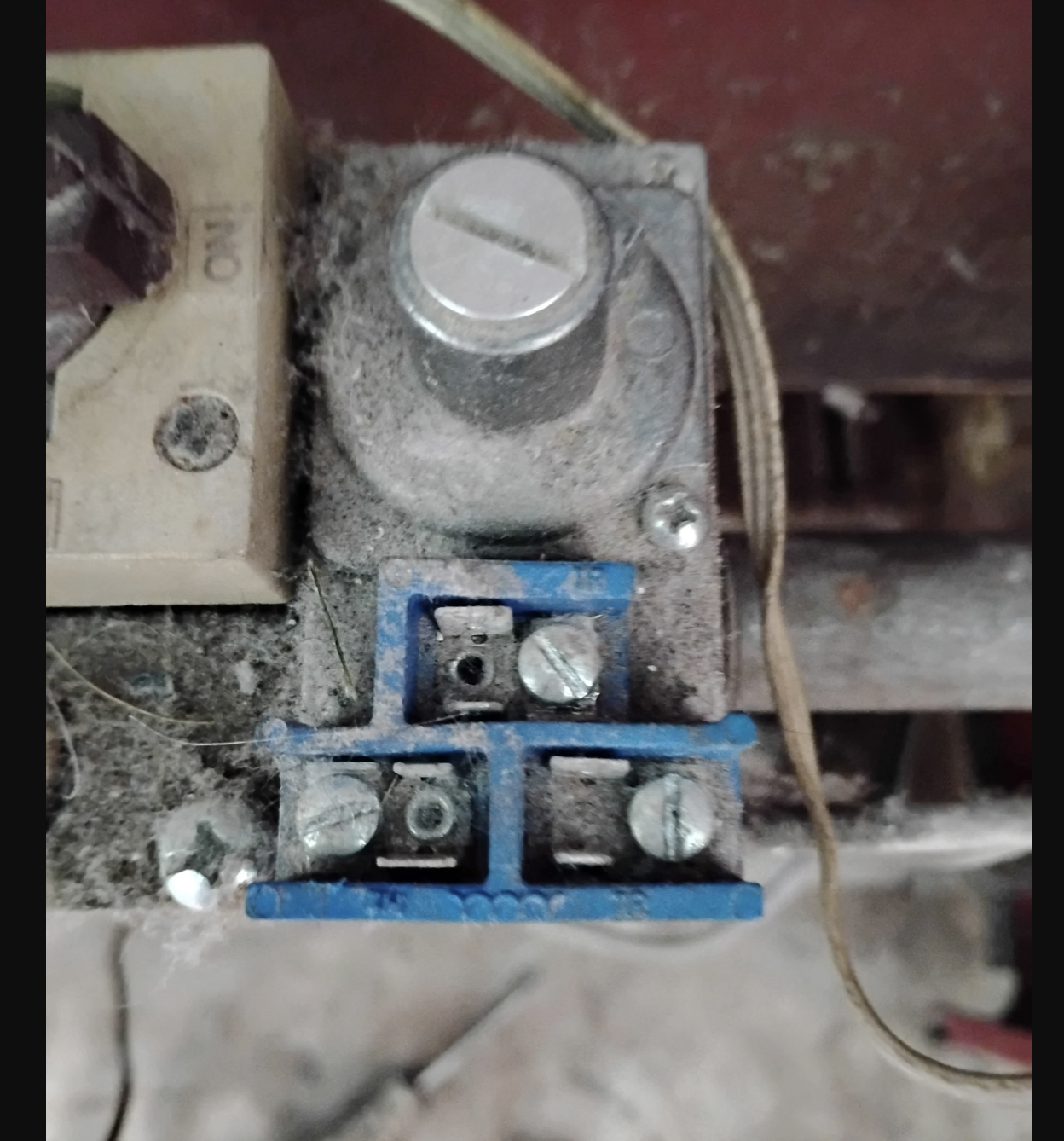

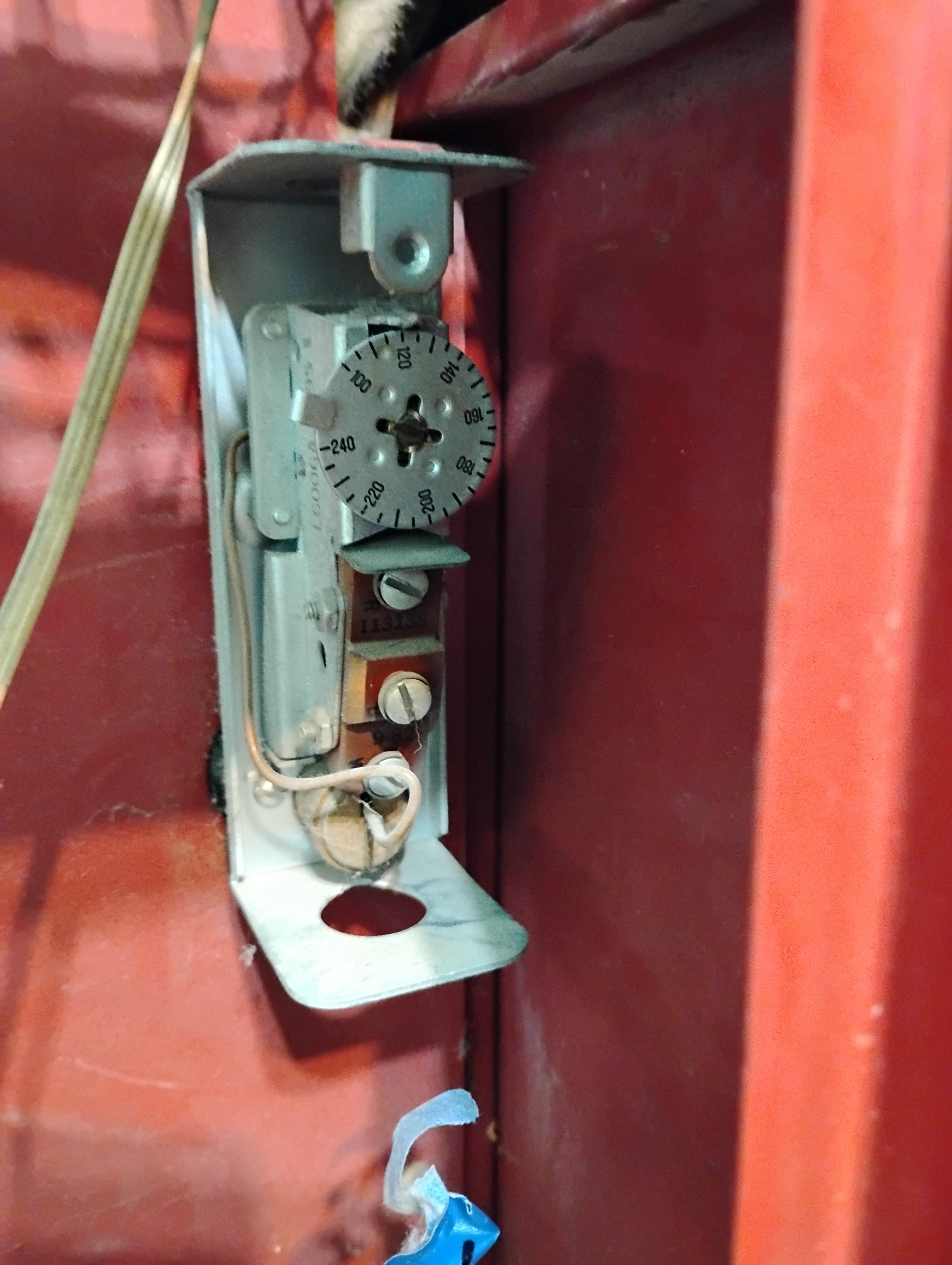

last night I was dismantling my boiler to clean out the mice, crap, etc, (yearly ritual) & I now have 3 wires that need a home. It's a national from 1949 & came with the house. We've been here 7 years now & i must admit we've had very few problems with it , ( till last night ) . Normally i put a piece of tape ( with some of my home made short hand on it ) so i know where they belong when it's time to reassemble. Well, i had the tape ready with my short hand already applied & forgot to attach it untill it was too late . Maintenance on this unit is 250$ just to pay for their gas to pull in my driveway , so i thought " what the hell " i'll buy myself some gas & maybe take a vacation or two & see if i , or you can fix it .

    Take a photo of the burner control to which the wires were attached… and post that. And then figure out where the other end of each wire is and what it attaches to and post that. Someone will figure it out ( @EdTheHeaterMan is a genius at that!)

    heres your pic:s, technology aint my thing the photo poiuytf theres 3 little bolts the wires go on those & when i teted them none of them were hot
    its a gas burner
  • Brian61
    Brian61 Member Posts: 7
    when i tested the wires they wer'nt hot
  • Brian61
    the photo 187 is where the wire starts from then goes to photo 185 , 2 of the wires get connected there ( i know where they go ) & then on to that little silver box where all 3 get connected

    EdTheHeaterMan Member Posts: 12,542
    edited October 2025

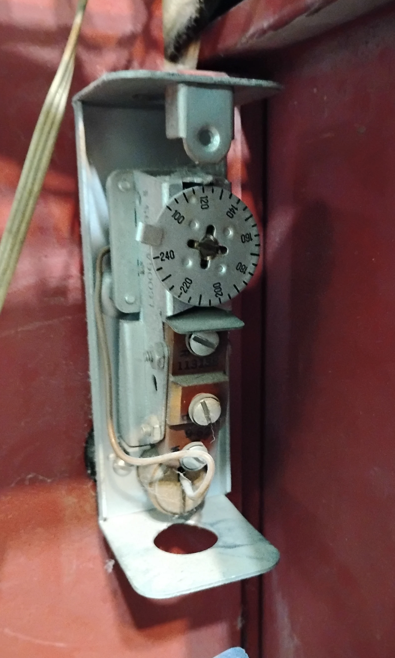

    Are there any more controls like this one? this is possibly the High Limit control but the setting is at 120° which in my mind is too low to be the HI limit

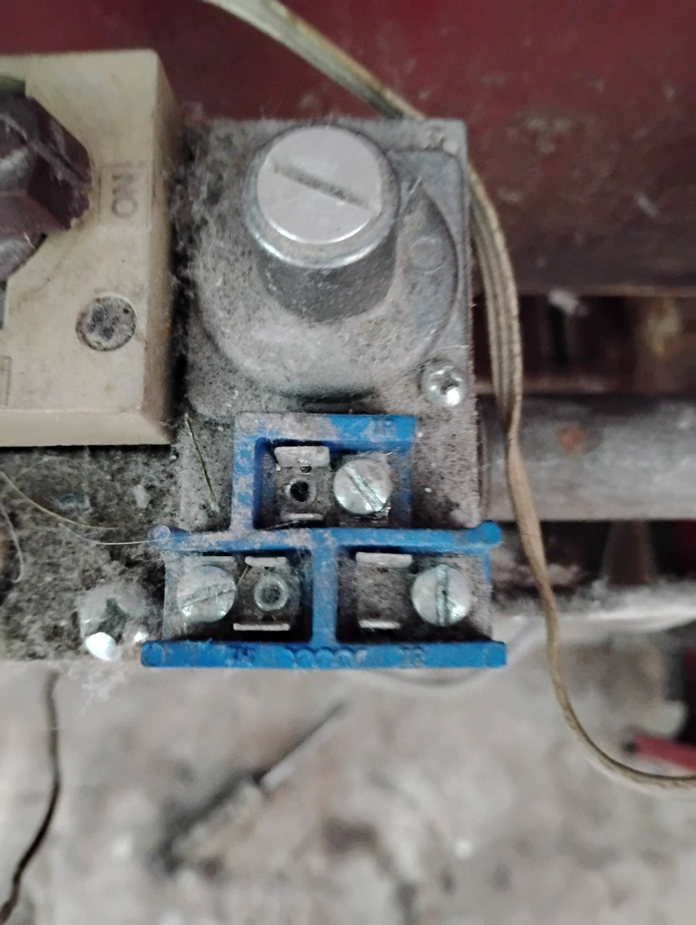

    This photo indicates that your heating boiler is located near your clothes dryer, and that clothes dryer vent is allowing lots of lint into the boiler room area.  All the telltale dust on the gas valve tells me that there is most likely dust on the actual burners inside the fire compartment, and the combustion air openings of the burners.  That dust can lead to insufficient combustion air and incomplete combustion.  That can lead to the boiler heat exchanger getting a build up of soot and carbon that will cause more problems that you do not want to deal with, some day this winter.

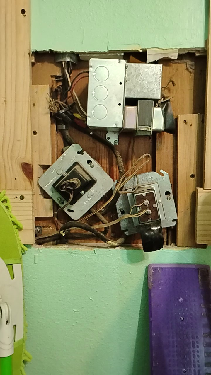

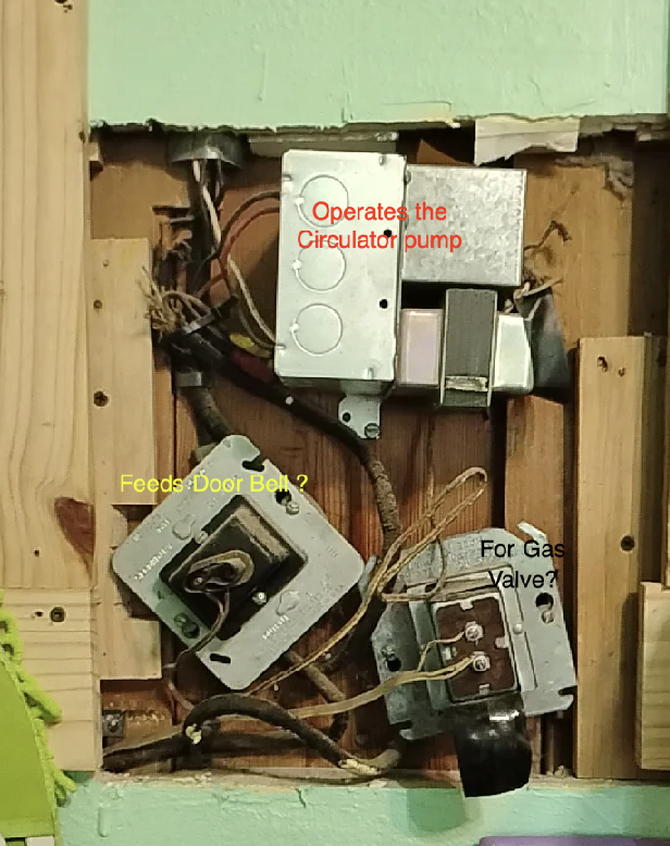

    This shows that you have three 24 volt transformers.  You only need one to operate that heating boiler.  Without seeing the bigger picture I have to ask how many thermostats you have?   That may explain the reason for more than one transformer.
    But getting back to your wiring problem, If you have only one thermostat for the entire home, then at least one of those transformers is not for the heating boiler.  So I am guessing that the door bell is connected to the transformer on the left   That leaves the upper transformer with a relay, to operate the circulator pump, and the other transformer on the lower right looks like it has the same 3 wire that is near the high limit control in the top picture.

    Now let's just say that you get a professional to come to make sure the 1949 boiler is operating safely and properly and that professional is not experienced on older model equipment. They might tell you that you need new equipment (and they would probably be right when it comes to operating cost) by telling you that this old stuff is unsafe. (that would be wrong information) and you didn't mind the "operating cost" gas bill which you feel is very affordable, and therefore no amount of fuel savings will justify the cost of a replacement boiler.  You will need to know how to put the wires back…

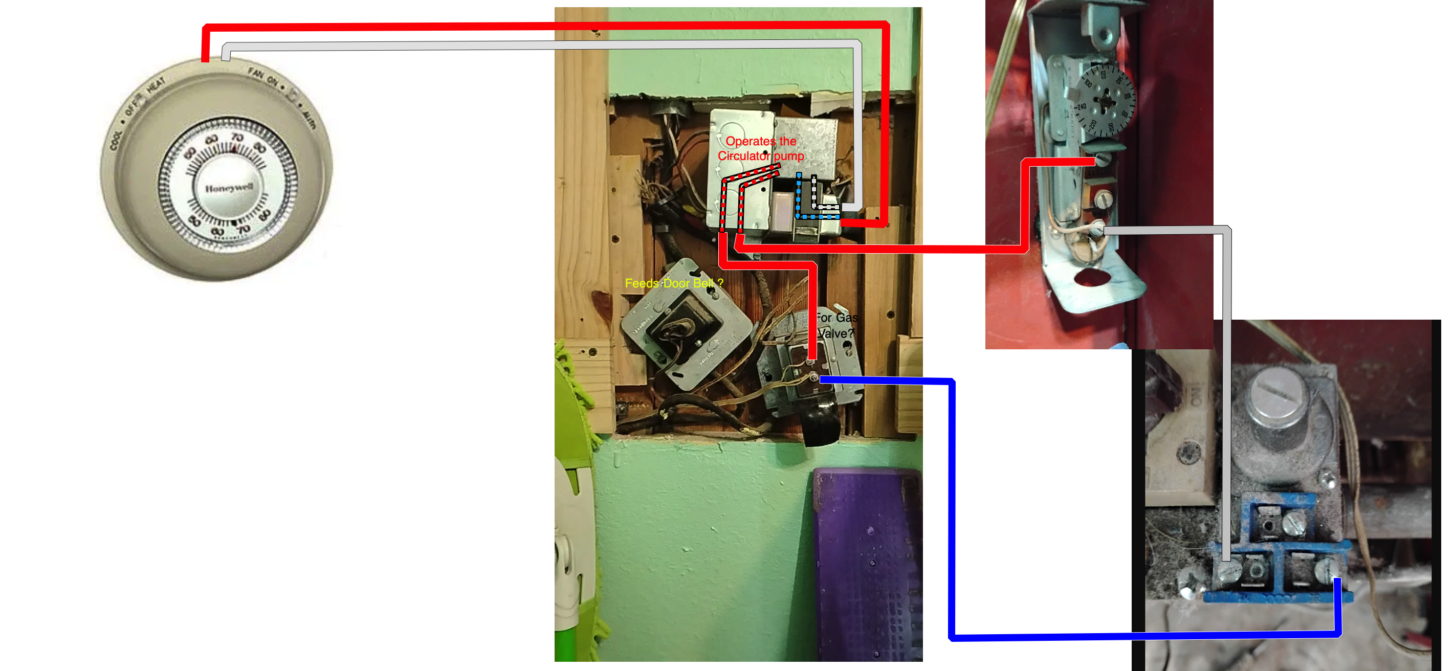

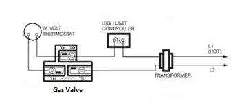

    I am only guessing at this point as to what you might have… but this is a safe wiring diagram that will shut off the gas burner in the event the water in the boiler gets hotter that the High Limit Setting. I would like to tell you the put the red wire here, and the green wire there but you only have gray wires, so I have placed colors on the diagram for clarity, but electric is color blind and will travel thru any color wire. I have made the assumption that the top transformer/relay is connected to the thermostat. When the thermostat calls for heat, the relay in the silver box will connect 120 VAC to operate the circulator pump. There will also be a connection in that same relay using low voltage (24 volts) to make the gas valve operate the burners.
    This is most likely where you have the three disconnected wires.  I have indicated that one of the three wires is Red and connects from the transformer to the R terminal on the aquastat.  The W on the Aquastat will get connected to the TH on the gas valve indicated by the white wire in the drawing.  Then the TR on the gas valve will get connected to the transformer  indicated by the blue wire on the drawing.
    I hope this helps.  And I really recommend that you call a professional to check your boiler.  It is probably in need of some professional maintenance. Hopefully you will get someone experienced that will actually do a good job for you.
    Mr. Ed
    By the way,  when I did gas boiler maintenance I never found it necessary to remove the wires you removed.  This might tell you something…

    Pictures with the available wires at each device location may help. A circuit is a loop, not sure if this wiring diagram will help you. I'll try to find one with better quality.

    If I understood the 3 wire aqustat was hooked up on all three terminals so that would be low limit and circulator. Fan relay to run circ.
    Could be an old non-integrated system with a tankless coil. Circ relay pulled in by T stat through the fan center relay when circ control is made. Other switch on aqustat maintains water temp by firing burner.
    S/B a high limit in the picture as well.

    That is why I asked if there were any more aquastats, and if there are any more thermostats. with the limited information given here, I can only speculate that there is one aquastat and one thermostat.

    And the wires were removed from the limit also.
