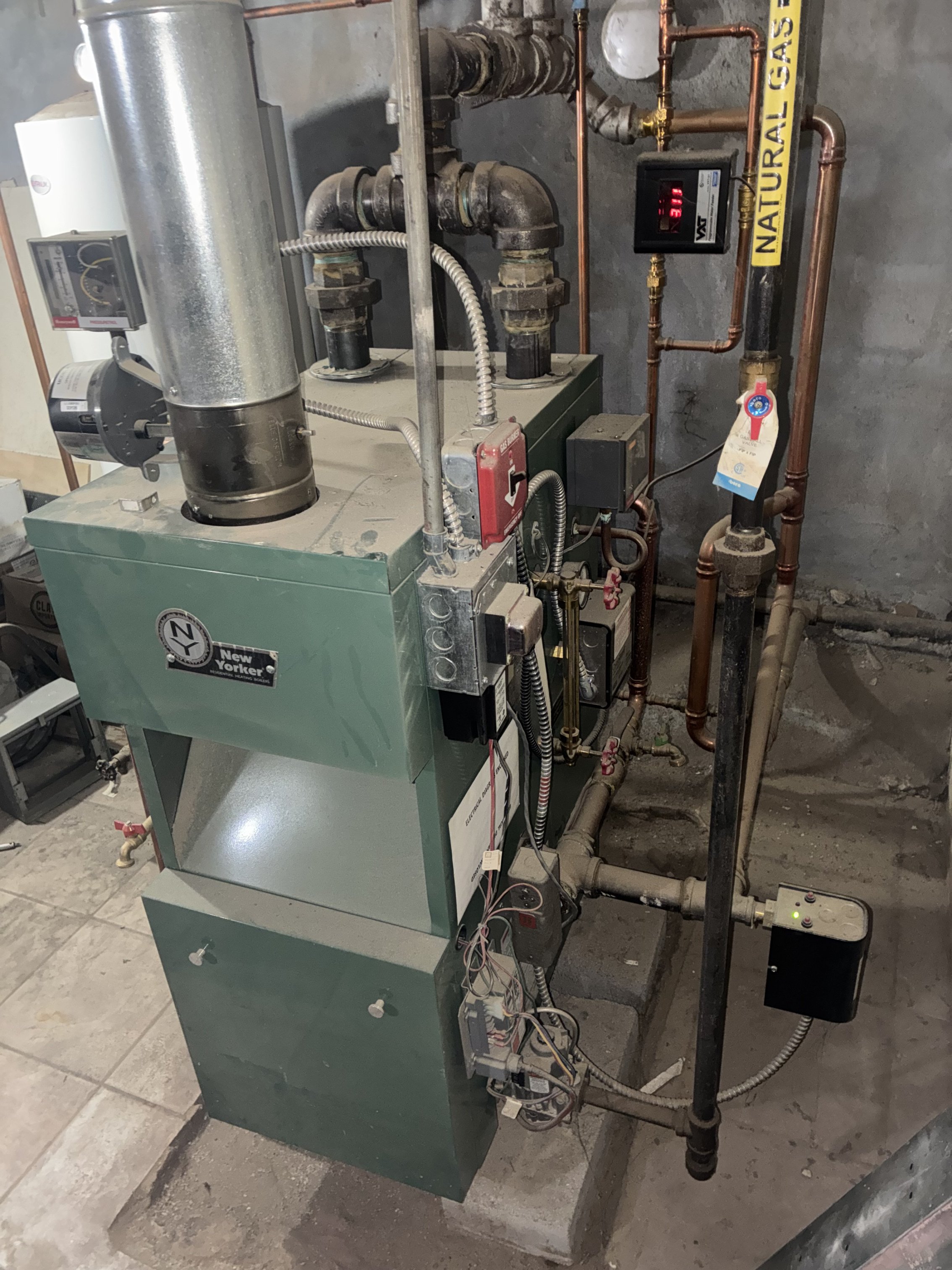

We converted to gas from oil, and got a new boiler installed about 4 years ago, along with an indirect water heater. Still using the same ancient steam piping though. No maintenance has been done on the system since.
I was thinking it was overdue for skimming and maybe I could do it myself. But looking into this install, it looks nothing like what the manual calls for, and nothing makes sense to me.
It was installed by that classic plumber who's been doing these forever and isn't exactly spending time with his nose in a damn book. As you can see.
My untrained eye caught the following:
  • Seems like the skim valve(s) are used by the pressuretrol(s) and other… stuff.
  • The hot water tank has its inlet & outlet from the boiler reversed. Hot is coming in from the bottom…?
  • There are valves before the circulator - the manual says " Do not install valves, or other devices having a significant pressure drop, between the boiler and the circulator inlet"
  • There is no Y strainer after the circulator, also contrary to the manual.

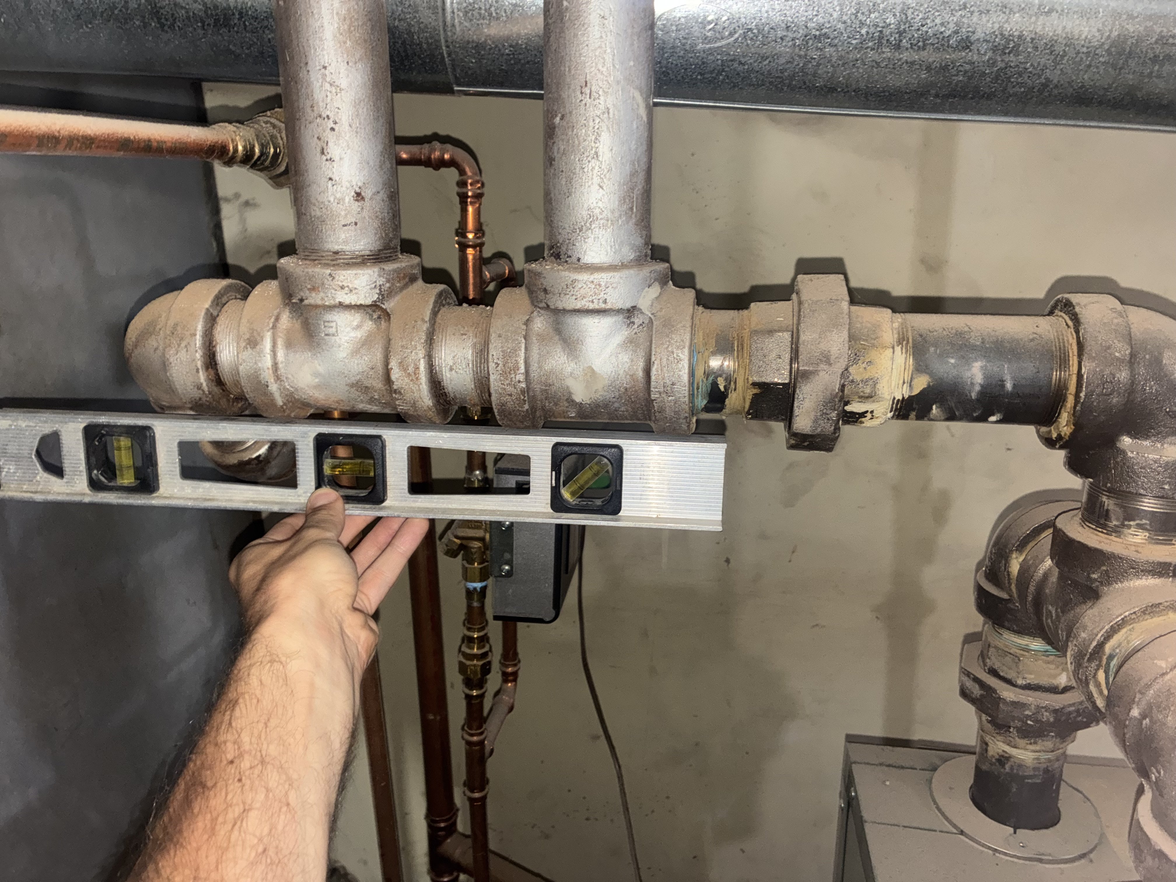

  • The header is tilted towards the boiler, not the return. Is that a big problem?
  • The way the steam returns run is just confusing the hell out of me, but that might be me.

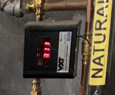

    How many gallons of water is this ???!!! 311 ? Is there a leak ?

    1.The header has no swing joints which could possibly damage the boiler. However the length of the header is so short the amount of expansion may not be enough to cause an issue.
    2.The header is pitched wrong (as you mentioned) but the amount of condensate in the header is not much so if the boiler is quiet skip that

    4.The horizontal run on the Hartford loop is too long. Again, no noise leave it
    5.I do not like the safety relief valve on the long horizontal tapping. The relief valve must be mounted upright and should be directly on the boiler
    6. I have no Idea what the xtra low water cutoff are for.
    The guy that installed this never reads an install manual "I have been doing this for 40 years" Yeah, 40 years of doing it wrong.
    If it seems to work ok, I would leave it alone except for the two things I am most concerned about.
    The location of the safety valve (which may be the skim tapping)
    and the header with no swing joints.
    If you read the manual, it mentions the safety valve being vertical
    it shows swing joints and a 3" header (depending on the boiler size)

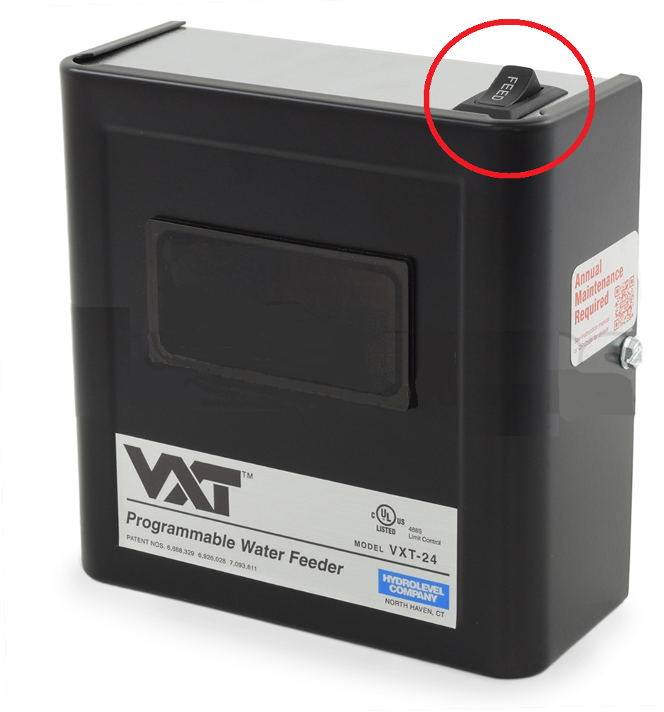

    @109A_5 Yes the water feeder does indeed say 311… is that an issue? I have no idea how this works!

    109A_5 Posts: 4,759
    Sound like it may need skimming.

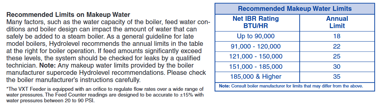

    From
    https://hydrolevel.com/wp-content/uploads/2021/06/VXT-24-Instructions-web-0321.pdf
    4 years times the biggest boiler in the chart is 140, you are more than double that. Kind of makes me wonder where the water went.

    The 311 on the feed counter is rather high — and could mean that you have a small leak somewhere. Try keeping an eye on it, and seeing how often it changes. How often or how much is variable — some systems go months without needing any water at all, and some may need a gallon or so a week.

    With everything that's going on the water usage is what I see as the worst problem. That is several lifetimes worth of usage. Mine is coming into it's 12 season and sits at 70. 311 is crazy usage. There is a leak, or leaks somewhere. Could be steam could be actual water, but somewhere there is a leak that needs addressed.

    When chasing a presumed excess water usage issue.

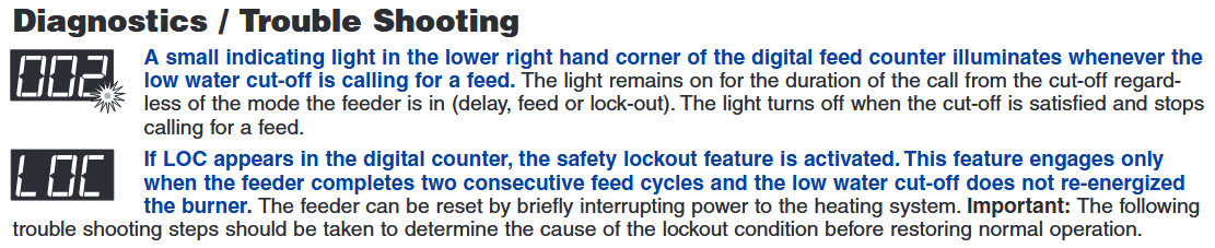

    The VXT does not measure water volume like a utility water meter does. It measures the time (displayed in minutes) the the water feed valve is commanded to be open. The water flows through a calibrated orifice that at an average water pressure passes a gallon of water per minute. So the VXT display, displays how many minutes the feeder has the valve commanded open.
    If your water pressure is abnormally low or the orifice is restricted or the screen is restricted the displayed value may be erroneous, there could be other reasons too. I would drain at least 2 gallons from the boiler and use the feed switch to refill it, see if your 311 goes to 313.
    If the VXT seems to work correctly;

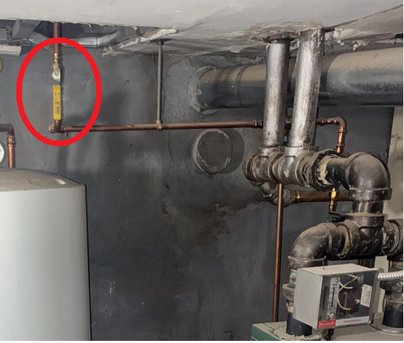

    It appears you could close this valve and see how fast the boiler water drops during the heating season. At some point the LWCO (Low Water Cut Off) should eventually trigger the VXT. The VXT should trigger and start counting since no water is flowing with the water shut off valve closed and it may go into LOC mode.
    If excess water usage does seem to be an issue, inspect for water and/or steam leaks, wet returns buried in concrete floors, vent valve(s) that don't close with the presence of steam.
