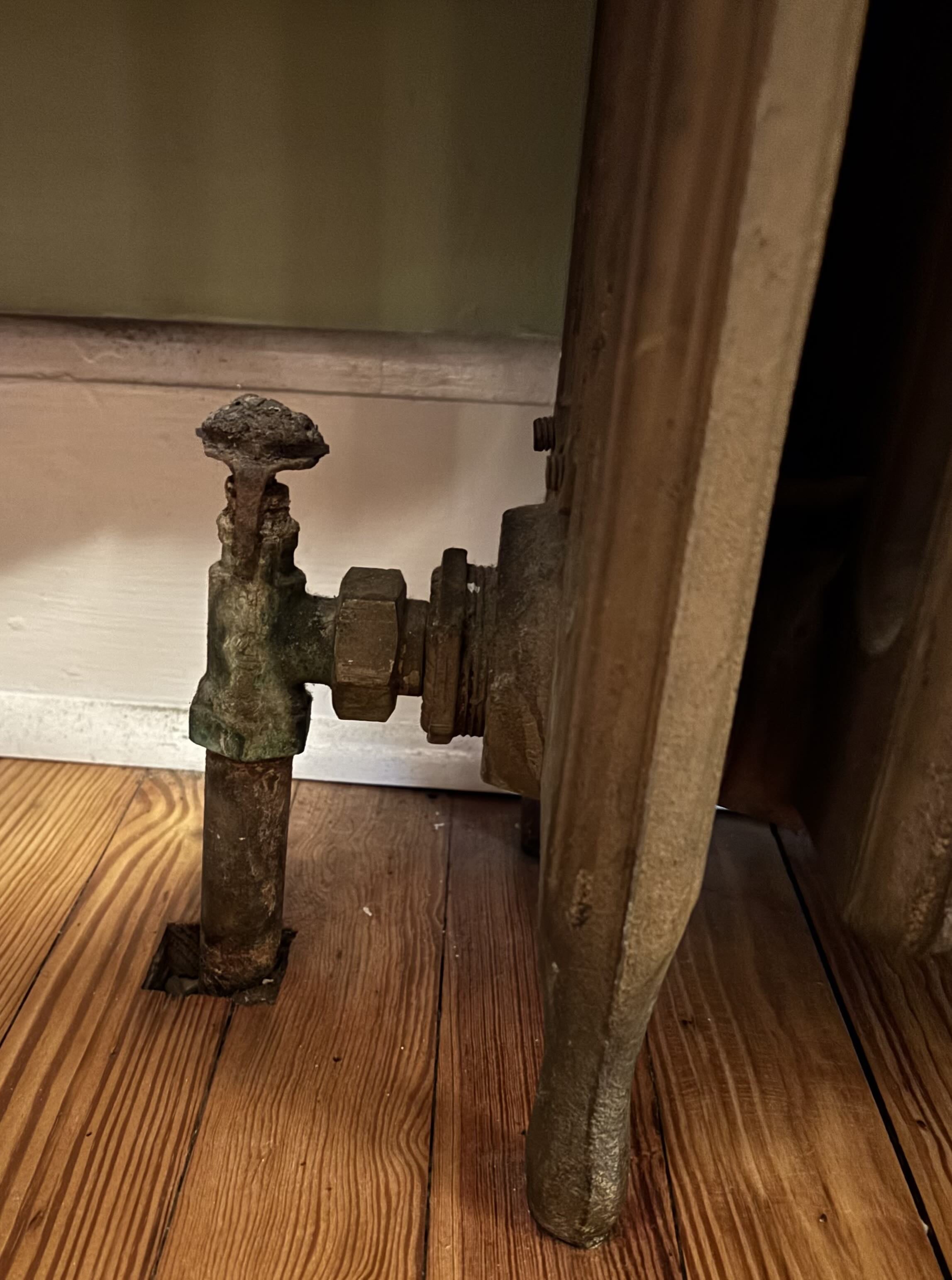

Hello again after a long absence. I have a roughly 100 year old radiator valve that is seized and I would like to replace it with a thermostatic valve. The existing fittings are all 3/4". The system is pumped hot water. Pic is attached.
A few questions:
  1. I have easy access to Danfoss and Honeywell TRVs. Any opinions on which is better? I'm also willing to shop elsewhere if there are better options.
  2. I've read that for my type of installation it's better to have the thermostatic actuator body project horizontally (to the left of the valve body for my rad) rather than vertically above the valve body, because heat from the supply pipe will rise up into a vertical thermostat and create a false reading. I'd prefer vertical in order to save space to the left of the rad. Will this be an issue?
  3. Any chance the union fitting on the new valve will mate with the existing 100 year old union fitting and not leak? I'm prepared to remove the old union fitting if needed, but the last time I did that I needed to carefully cut the old fitting out from the bushing, and I'd rather not do that again.
  4. Any thoughts on how long TRVs usually last before the actuator body or other parts need replacing? Part of me thinks it might be easier to just use a conventional valve and control things manually, with the hope that a conventional valve will last many decades.
TIA!

    Item 3 above. Almost no chance at all, though it has been known to happen. People win the lottery now and then, too.

    Whatever you replace it with you will have to replace the spud and union fitting. A new valve will probabl last longer than a TRV. If a TRV goes bad it is usually the actuator and the valve is ok.
    You have to position the actuator the way the mfg instructions show or use a remote sensor.
    TRVS and radiator valves are not all the same dimensions so shop wisely.
    Honeywell, Danfoss Tunstall associates sells Macon they are all about the same. Pick the one that fits physically the best.

    This actuator: Honeywell T104B 1038
    This valve: Honeywell V110E 1012
    You can place the temperature sensor up to 6 feet away from the radiator. However, you will have an exposed capillary tube from the control the the actuator. and the short valve profile you want to use.

    I think my situation is a bit simpler though. The room it will be in always tends to be on the warm side when the heat is on, and since the existing valve is seized I can't adjust it. The objective is to allow us to dial the flow back in order to balance the room temp with the rest of the house. That's why I'm also considering just installing a simple/traditional hot water radiator valve. I'd hopefully be able to just crack the valve open a small amount and find a sweet spot in terms of room temperature.

  • You have a point there, but do you want to have to access the room any time or should I say ALL the time. The point of the TRV is that it is automatic. So the labor to install a manual valve or a TRV is identical for you. the only cost difference is the price of the valve and actuator. I like the idea of the remote actuator with the 6 foot capillary tube where you have confined space for the valve to be installed.
