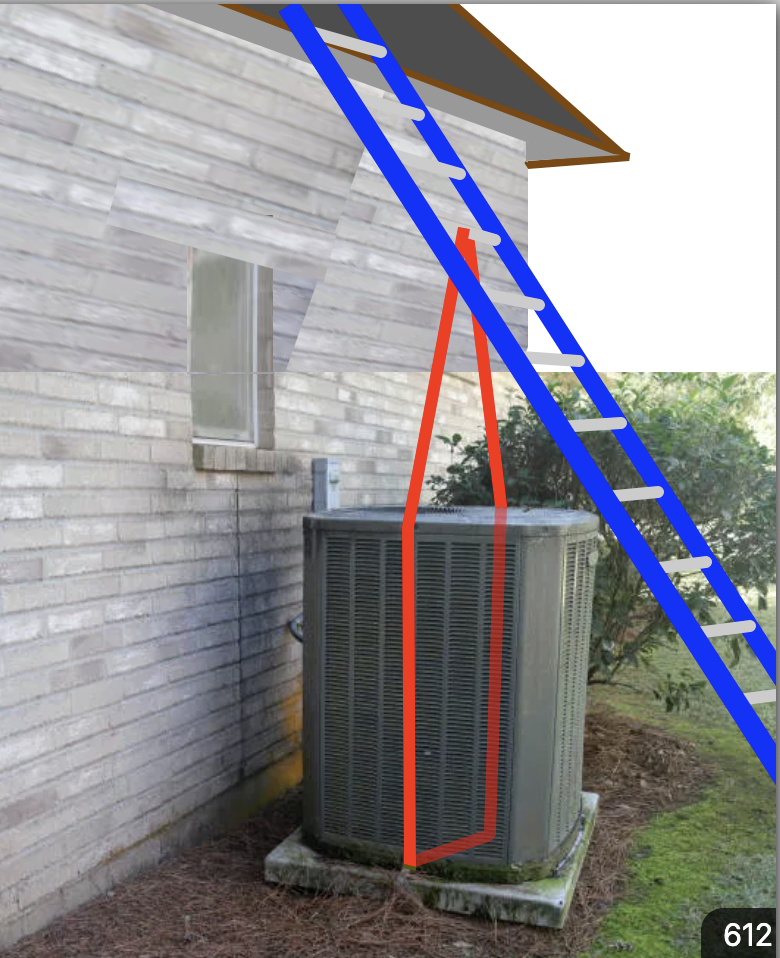

    Place a ladder over the outdoor unit and suspend the unit with the proper straps to handle the weight. I actually owned something that was made for lifting condensing units to a roof using a ladder as the crane support. https://www.youtube.com/shorts/1sE-y3RadDc But you can just use straps on the ladder to lift the unit a few inches.
    Use two straps one side to side and one front to back so the unit can't fall out of the sling

    I used a ladder crane a couple of time to lift compressors to a roof. Didn't like it much. The shop I worked for thought it would save money instead of having two men on the job.
    Is the one in the video electric? The one we had fit on the ladder rungs and you had to crank it like starting an old car. Cranking and having to push the ladder out to have the compressor clear the building was risky.
    I worried about the ladder feet kicking out and would brace it against my truck when I could.
  • I owned the electric version. and all roof top jobs needed 2 men to operate the ladder crane. Once the two men part of the job was completed, the second mechanic could go do other work. or if it was a helper without a truck, then he stayed as a runner from the roof to the truck and learned how to use a vacuum pump and micron gauge.

    I have a metaltech scaffold here (the yellow one), and I think the best option would be to set that up safely over the unit, then put a ladder horizontally across the rungs on the two uprights (and lock them into place with clamps), and then attach ratchet straps over the ladder and under the unit on both sides (and maybe add a pair of back-up ratchet straps on the insides of the legs of the heat pump in case of - hopefully unlikely - slippage.
    If I do it carefully I think this should work well. As long as there's no swing back and forth as this would make the unit want to pull away from the lines, but correct positioning of the ladder should be able to prevent this.

    Does it have a plank? Wrapping the straps around the plank would be better than a ladder.

  • @Lion_Heart, it appears the your Scaffold is the perfect item to lift the outdoor unit off the stand about 3". that should give you plenty of room to remove the old stand and install the replacement stand. I would not stress over it, just lift, replace and lower. 3"- 4" movement should be no problem. If the line-set is strapped vertically to the wall, then remove the support straps for extra movement.
    I wouldn't use a ladder across the scaffold. Get a 4 x 4 or something similar or screw some 2 x 4s together at least 3-4 of them so it doesn't roll. The unit isn't very heavy. You only have to pick it 2"
    the floor of the scaffold which is essentially a proprietary plank is designed t support a couple hundred pounds over a a horizontal span.
