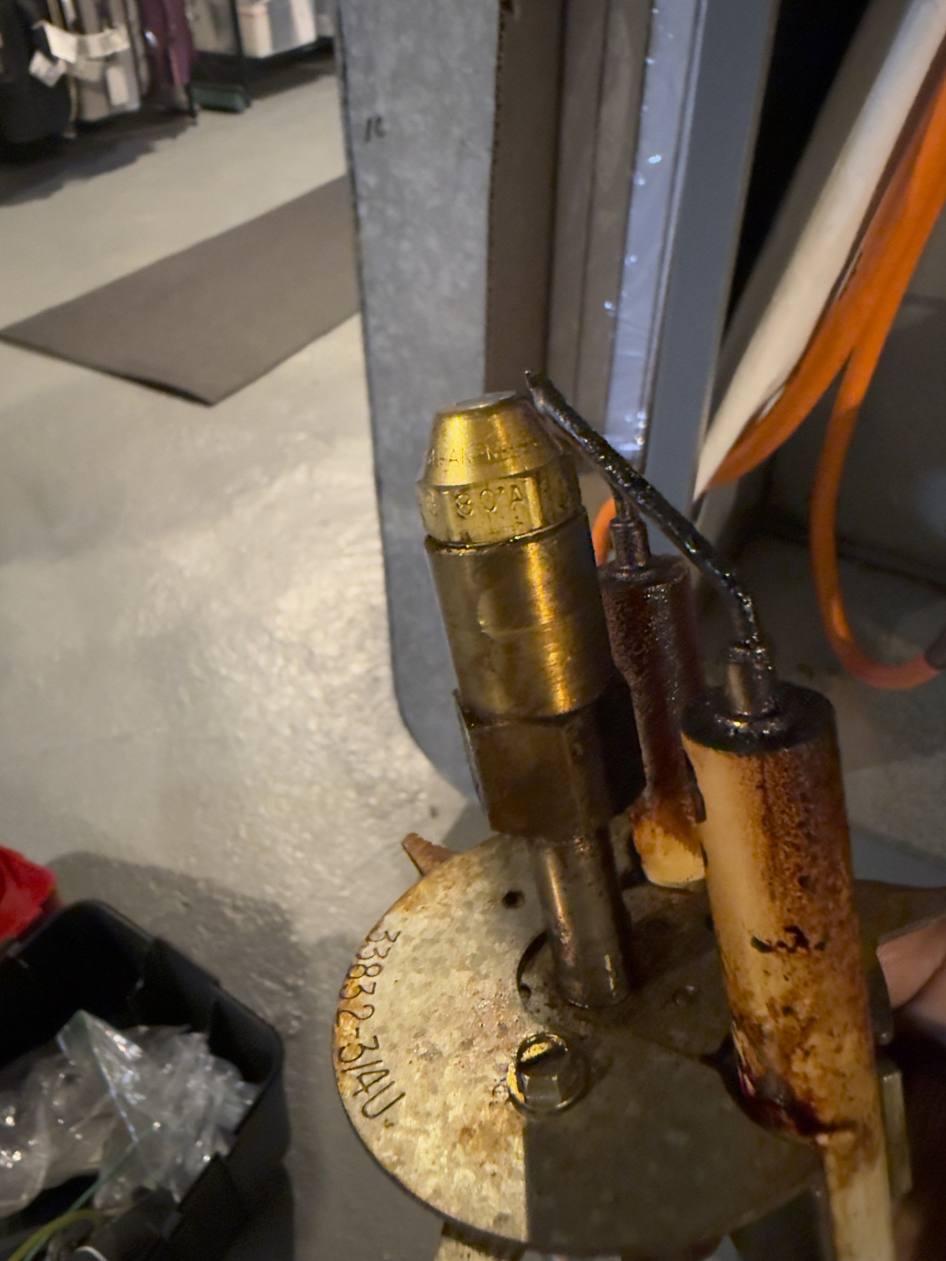

While performing the yearly maintenance on my oil furnace, I've come to notice that the electrodes are looking a bit rough. Being a DIY guy, I have a feeling I should replace them. I did find this set as a replacement (consulted the manual/part number) at my local Home Depot but the insulators are not long like the ones currently installed. However, this part appears to also have the longer insulator.

  • Can you post a photo of your suspect electrodes? I was wondering how you are going to adjust the burner for proper combustion. Do you own a smoke tester and a combustion analyzer? Of course of you might save 100 or more on doing all the maintenance steps yourself, but will the fuel usage increase resulting form improper adjustment be worth it? A guess it might be a wash.
    Do you know how to test all the safety features in order to make sure the system is safe to operate? My 28 point tune up of an oil burner included testing 5 different safety items and if one of the items did not pass the test, then the burner was not safe to operate. But you can save on that part too by ignoring those items and just hope that those safety features are working as they are supposed to.
  • @EdTheHeaterMan See attached.
    I don't own any of those tools but I read the manual a few times and the steps listed doesn't sound very difficult to follow. I understand the risks but my goal is to hire a tech every other year for an overall assessment. I came to this conclusion after realizing that the time he was spending during the yearly maintenance was becoming less and less. Hardly any parts were being changed etc. The icing on the cake was one year where a tech misconfigured something and the furnace started to short cycle. I had to call another company for them to fix it since the original kept coming back and not finding the issue.

    Looking at the assembly, maybe have a tech check it this year.

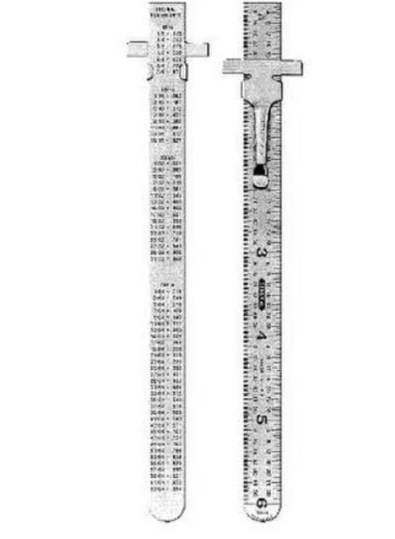

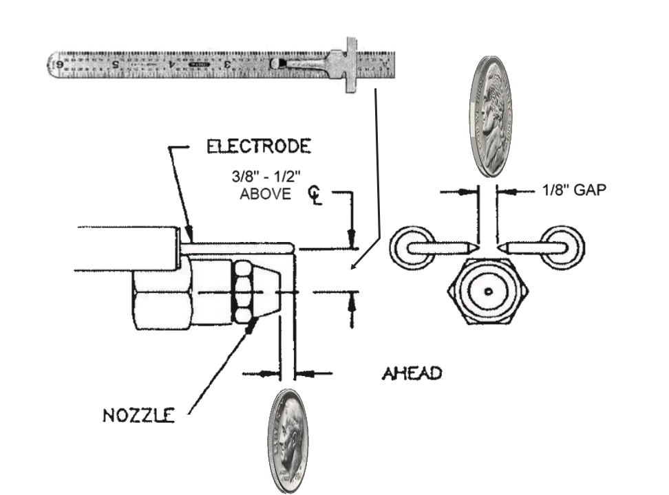

  • Looking at that assembly, I don't see anything wrong with the electrodes that require replacement. A wire brush and some degreaser should make them operable. Do you have a small ruler that has measurements in the 1/32" increments? you will want ot set the gap and the hight above the nozzle centerline with one of these:
    That is all I used when learning how to set electrodes in the 1970s. You could use a nickel as a feeler gauge to set the gap. A dime for the measurement ahead (foreword) of the nozzle, but you still need something to measure the hight above the nozzle centerline.

  • @EdTheHeaterMan Thank you for the instructions. I really appreciate you taking the time to write this up. I purchased a "Beckett z2000u Gauge Kit "Z" based on some research. I was planning on using that and double checking it with the small gauge that came inside the electrode kit (I found all the parts I needed at my local F.W. Webb).
