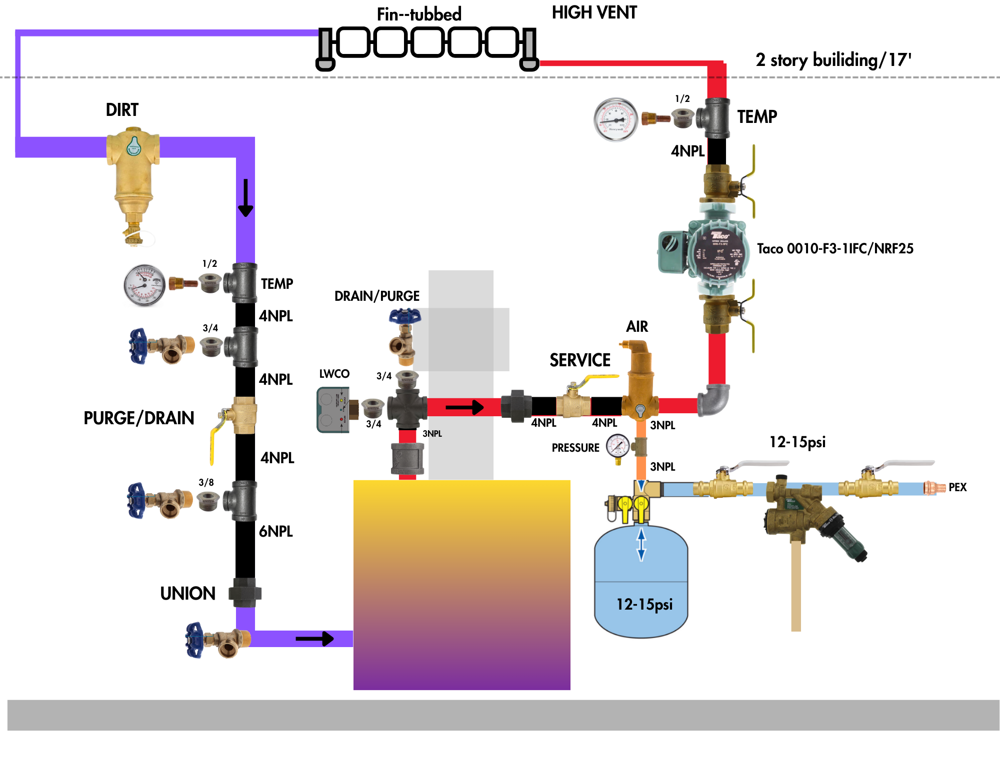

Hi everyone,
I noticed my boiler (CG8 hydronic) has been operating for years with the boiler vent pipe capped (no auto-air vent). If I install a Air Separator at the supply of the boiler above the expansion tank (I will be pumping away), should I also add an auto air-vent on the boiler? Thanks for your advice!
  • GroundUp
    GroundUp Posts: 2,573
    Unless there is a high point trap that would require venting, no

  • Thank you @EdTheHeaterMan . I have a EX60 membrane-type tank. Reasoning for adding an air-seperator is to help prolong the life of this old, cast iron boiler. Ive always had issues with bleeding the fin-tubbed heat emitters on the top floor. Hoping this conversion to pumping away will help, as well as air sep and/or automatic air vent at the boiler. Am I off track?
    EdTheHeaterMan Posts: 12,952
    edited September 2025
    Depends on the circulator location.  If you have the air sep on the supply (HOT) side of the boiler piping and the circ is pumping away from the air sep, AND you attach the Ex-60 expansion tank and boiler fill valve at that same point, you will actually eliminate the air problem.  It all has something to do with the Physics of  Water and Boyle's Law of dissolved gasses.  Long story short… Hot water and low pressure will release dissolved air.  Put a vent there and all the air in the system will get absorbed in the water and released at the air sep.  (ask me how I know this)

    what is the static cold fill pressure and how high above the boiler are the problem emitters? you might need a little higher cold fill pressure to keep adequate pressure at the top.
  • Thank you @EdTheHeaterMan and @mattmia2 . Yes, on the supply side: boiler - expansion/airsep-circ.
    circ to top radiator is roughly 17feet.
    202,000 output boiler.
    Once a gravity system.
    pecmsg Posts: 7,634
    thats a lot of heat.
    how big and where is this home?
    AlwaysLearning2024
  • Thanks @pecmsg. 1937 4-family apartment building. (2bed 1 bath). About 4000 sq/ft.
    Brick. Cincinnati, OH.
    17 feet above the circulator pump that may be about 3 feet above the boiler pressure gauge indicates that you need about 8.9 PSI of static pressure to get the system filled. add a little extra for a buffer and you can operate at 12 PSI for that system. So 15 PSI at the boiler gauge is more than adequate without going overboard. Set the air charge in the expansion tank to 15 PSI when the expansion tank os not connected to the boiler water pressure. That would mean with the boiler pressure below 12 PSI if you want to check it without disconnecting it. Then set your auto fill pressure to 14.5 PSI to 15 PSI so not to add more water to the 15 PSI expansion tank at cold startup. You should be good to go with pumping away from the expansion tank!

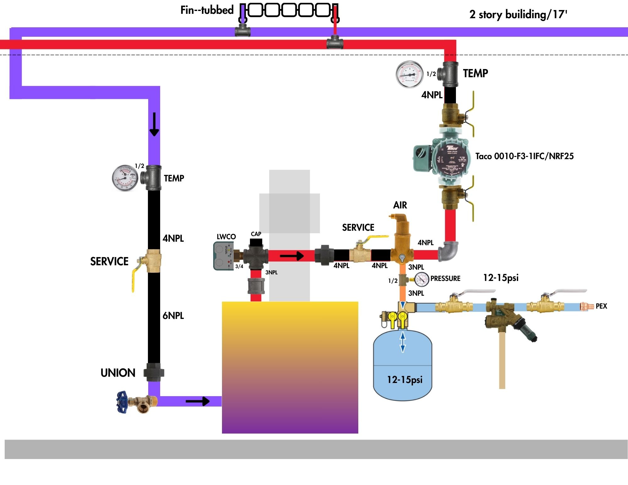

    How does this look?

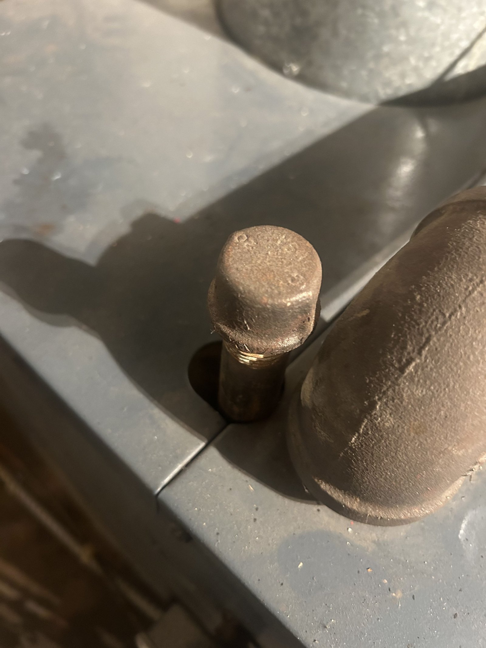

    AlwaysLearning2024
  • Thank you, @leonz! I have not tried this. Excellent idea. Are you suggesting the boiler vent port (which is currently capped?)
  • leonz
    leonz Posts: 1,994
    Yes, that is what I am suggesting to you as long as you have enough space overhead to install one of the air vents from Mcmaster Carr using a pipe coupler, pipe nipple, ball valve and then the air vent in that order.
    A long enough pipe nipple clears the elbow and lets you safely tighten the pipe coupler, pipe nipple and air vent in one operation-if you have a big plumbing supply house nearby they may have a one inch air vent in their inventory and they may very well put the whole thing together for you leaving you to remove the cap after you drain the boiler and use pipe dope for the male threads on the pipe nipple. Do not paint the last thread of the pipe nipple with pipe dope or teflon tape as it will end up in the boiler water and you do not want that to happen as it can cause problems.
    HVACNUT

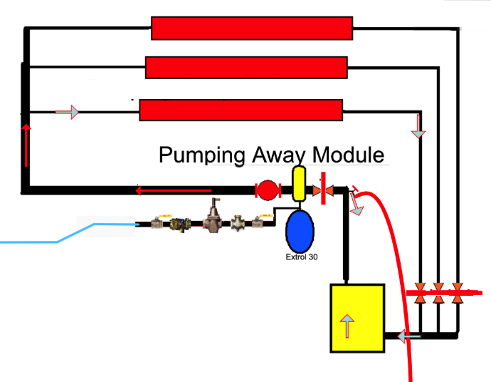

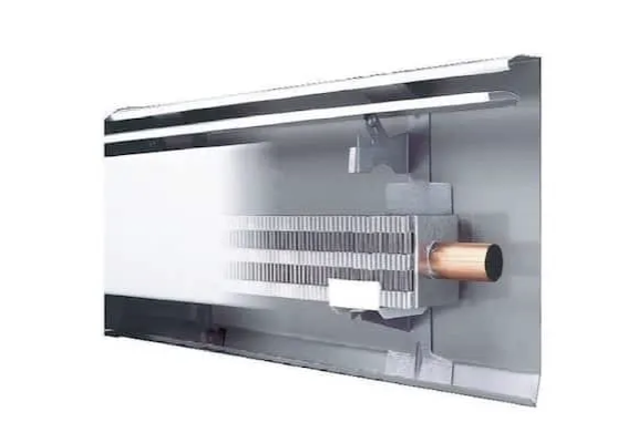

  • That looks great! I am wondering how all the rest of the radiators are connected? Obvioulsy you have more than one radiator or Fin Tubbed.
    Are they all in one series loop of baseboard

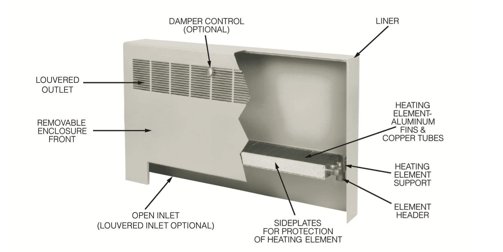

    or are they all convectors with fin tubes inside a cabinet?

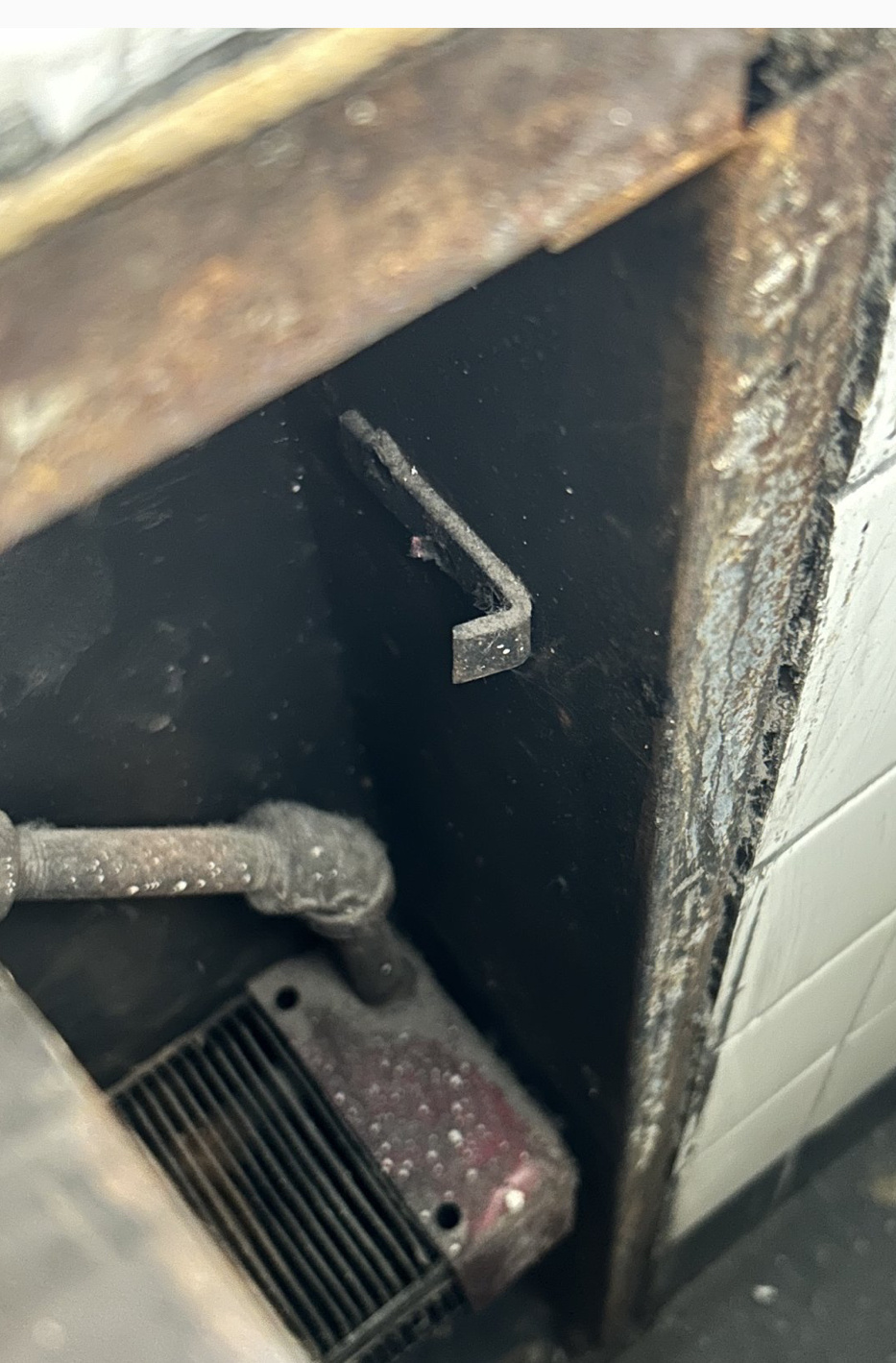

    AlwaysLearning2024
  • AlwaysLearning2024
    AlwaysLearning2024 Posts: 119
    thanks @EdTheHeaterMan !
    All are convectors with fin tubes inside a recessed cabinet. Photo below.
    I have roughly 6 30” sections of convectors per apartment (so a total of 24 convectors).
    The basement supply and return pipes are not insulated which seems to be intentional in order to heat the basement also.
    From what I can tell this is a 2-pipe system.Not sure if it is a direct or reverse return.
    1 1/2” supply/return in basement.. 3/4” risers to second floor. 1/2” piping to first floor.

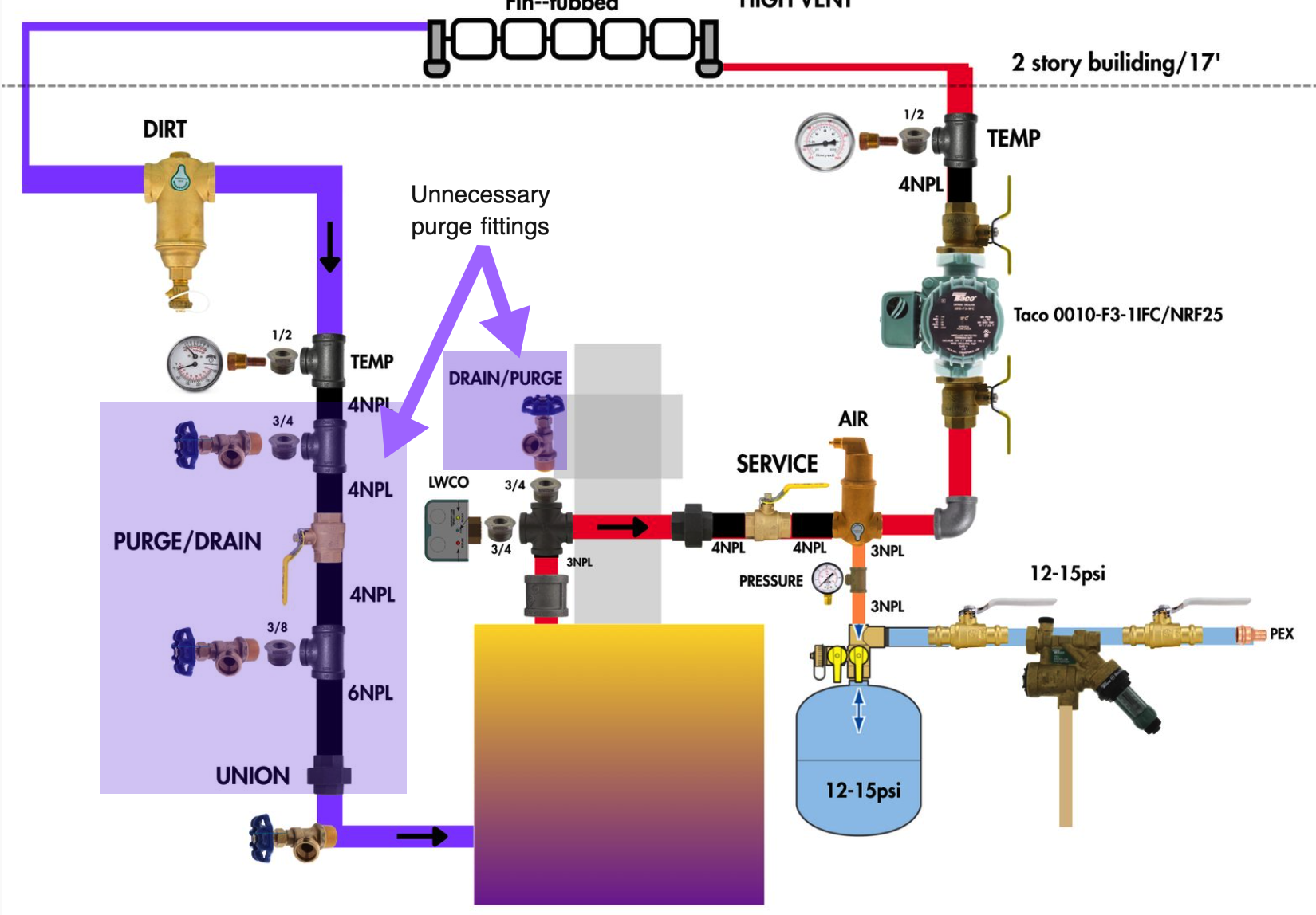

  • Then as you may already know, Purging air from the system is not going to work. You must vent the air at each radiator to get the system started. so the highlighted valves and fittings are probably a waste of $$$
    Purging only works where there are no Tee fittings involved and since your have a parallel piped system with 2 tee fittings for every radiator, purging is not an option, Venting is the only way to get the system filled with water.
    Once the system is operating, then you can use the pumping away design to remove any air that may have found its way into high spots. That will happen over a short time (about a week or less) depending on the amount of air stuck in the system. Pumping away uses Physics of water (Boyle's Law) to remove air on a molecular level and vent it on a molecular level at the air vent just above the expansion tank.

  • @EdTheHeaterMan revised the plan with your suggestions.
    What do you think?
  • Like.
    This will remove air from the system as the system operates with the help of the laws of Physics. But each radiator convector must have at least some water in it so that water can flow and can absorb the air into the water and carry it to the hottest, lowest pressure location where there is an air separator.
    I like your diagram
