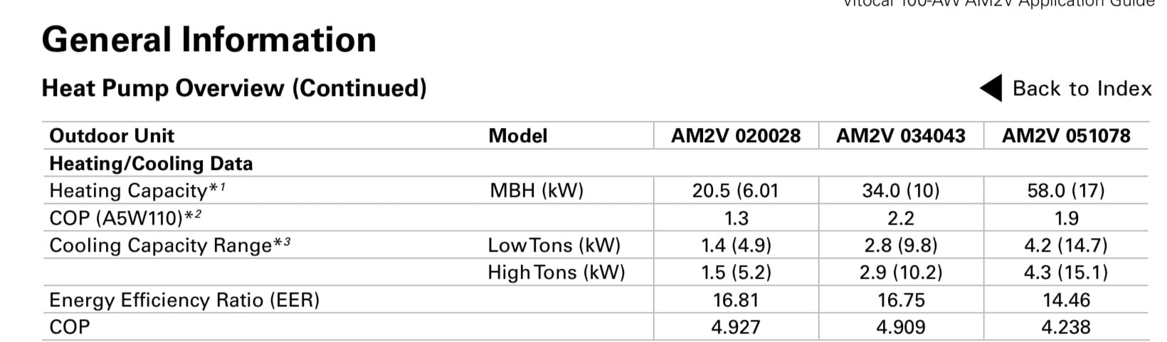

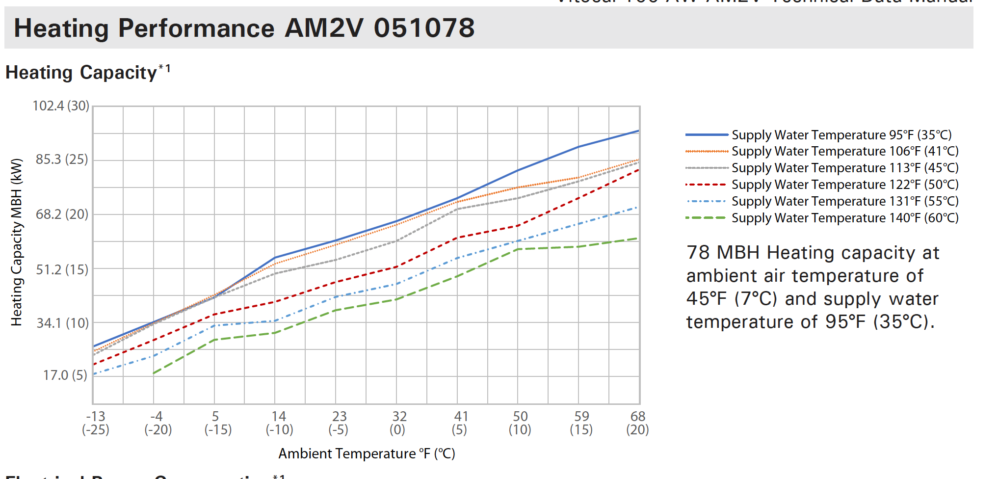

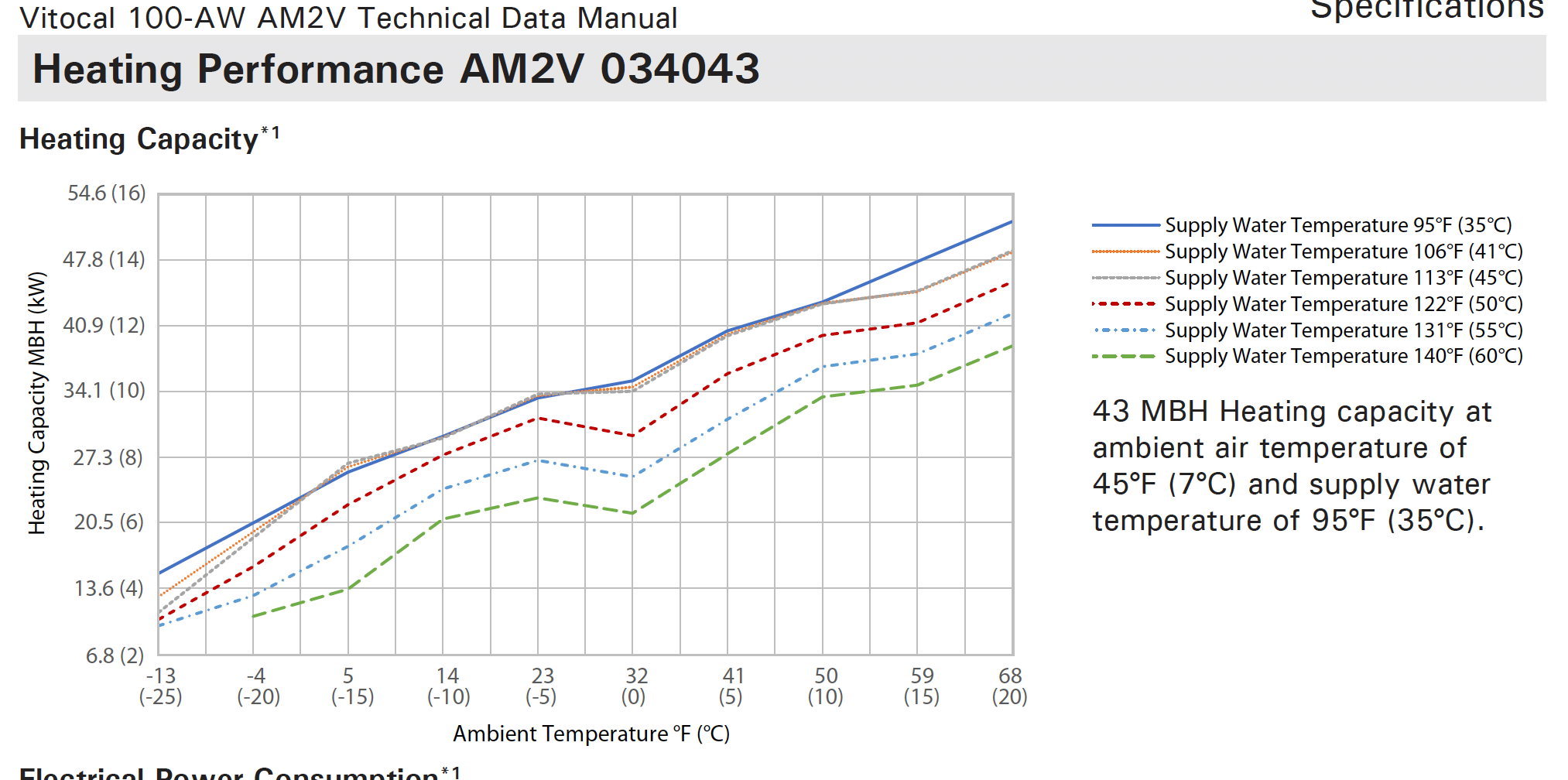

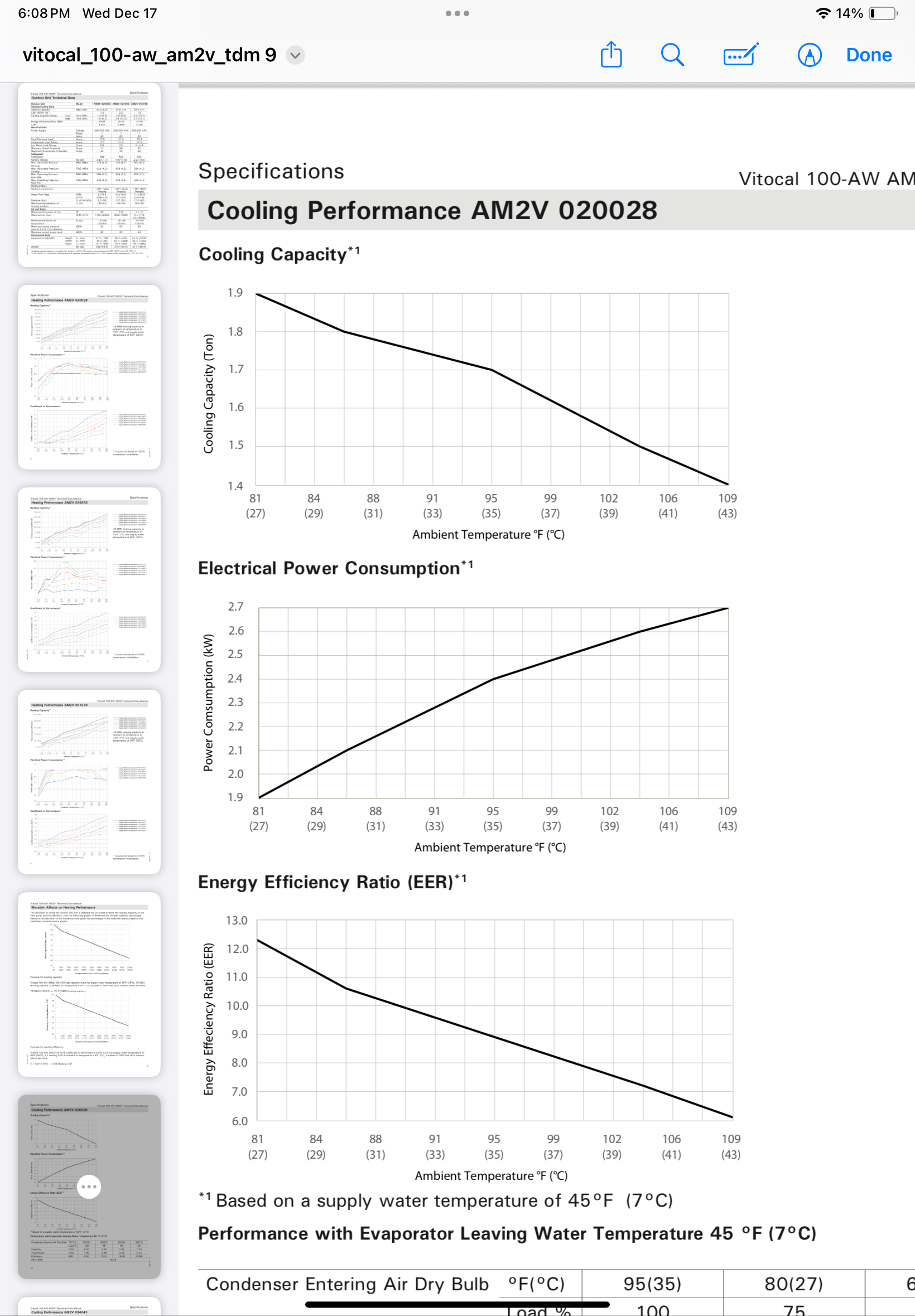

    So we had an energy assessment done and the heating load of our house is 38000 BTU. The auditor said that insulation is up to date and there is nothing we can do that would not be invasive and economic.
    With that in mind I was looking at the sizing of the Viessmann Vitocal 100 AW which comes in a 34000 BTU or 58000 BTU size.
    What would be the way to go?

    How does the fuel use calc compare to the assement? How many BTUs is your existing radiant capable of using 115F water?
    Generally with AWHP oversizing buys you a bit of extra efficiency as long as you are not short cycling it. Check the min output of the unit and make sure your smallest zone is above it or add a buffer tank.
    Since the install cost is so far removed from BOM cost, there is very little drawback in this case for the larger unit.

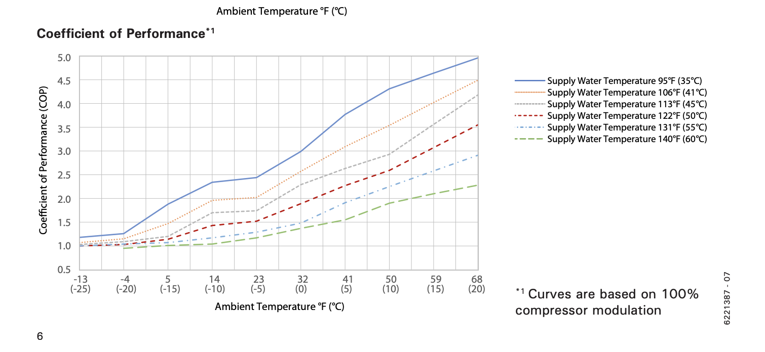

    hot_rod Posts: 28,708

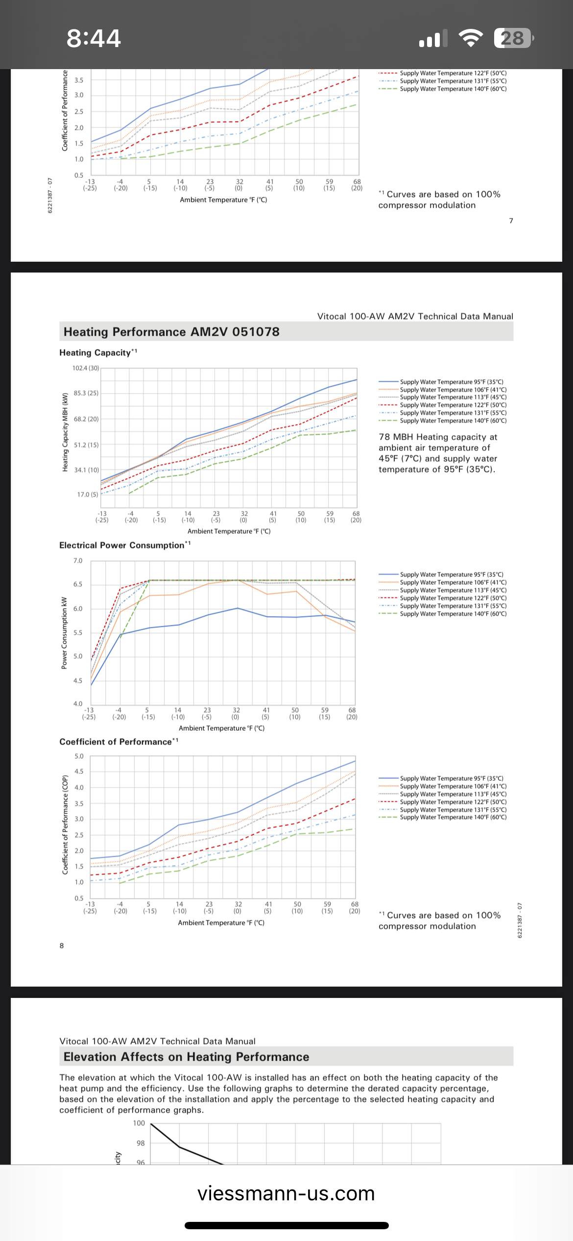

    what temperature water do you require?
    The tech manual has good graphs for performance and efficiency at difference conditions
    https://www.viessmann-us.com/content/dam/public-brands/ca/pdfs/heat-pumps/vitocal_100-aw_am2v_tdm.pdf/_jcr_content/renditions/original./vitocal_100-aw_am2v_tdm.pdf

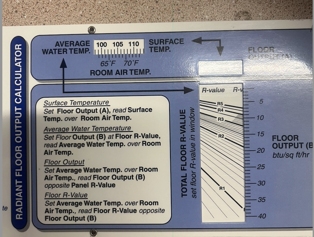

    R-1.7 floor, 20 btu/hr design, shows 108 AWT, so around 112-115° supply should do the job. That is comfortable for an A2WHP. 80% of the heating season you will be below that 115° requirement, better COP still.

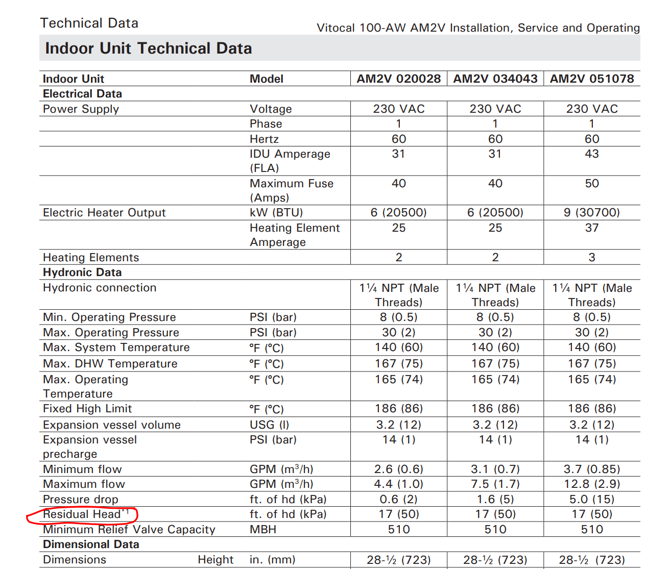

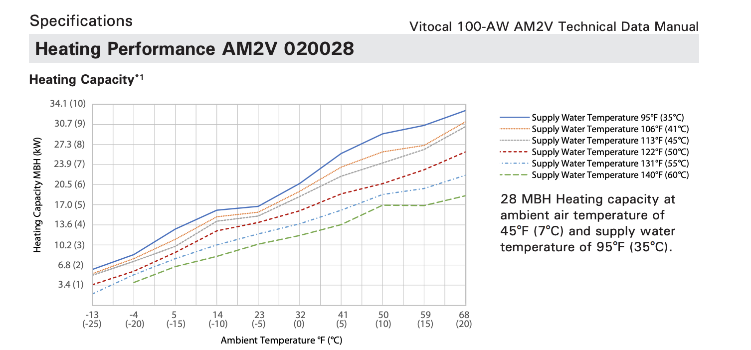

    It's good to check the output and COP at your expected outdoor temperatures. Down around 14°F COP drops.
    https://www.google.com/search?q=vitocal+heat+pump&oq=vitocal+heat+pump&gs_lcrp=EgZjaHJvbWUyCQgAEEUYORiABDIICAEQABgWGB4yCAgCEAAYFhgeMggIAxAAGBYYHjIICAQQABgWGB4yCAgFEAAYFhgeMggIBhAAGBYYHjIICAcQABgWGB4yCAgIEAAYFhgeMg0ICRAAGIYDGIAEGIoF0gEINTYzOWowajSoAgCwAgE&sourceid=chrome&ie=UTF-8
    Screenshot 2025-11-19 at 8.01.13 AM.png Screenshot 2025-11-19 at 7.59.30 AM.png

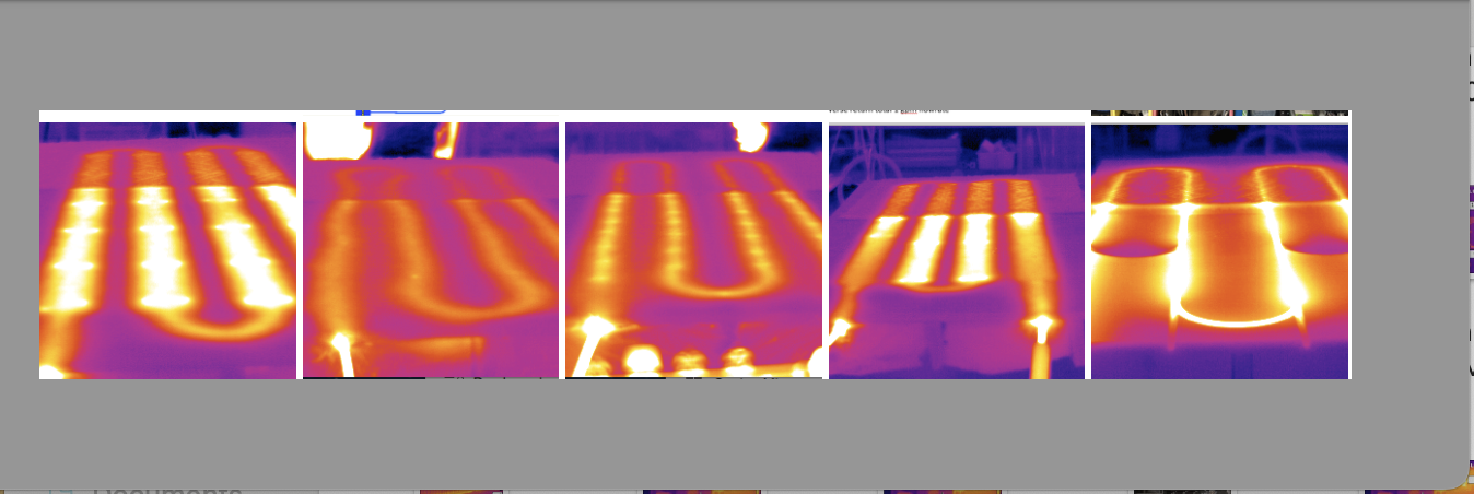

    Below is a link to a post I did a while back with some FLIR camera shots I took of a test to compare effectiveness of a couple of thicknesses and widths of heat transfer plates. The wider, thicker plates show a notable difference. Take it for what it's worth.
    I have the handicap of being in Alaska and many vendors either won't ship here or shipping isn't cost effective (they love to send things UPS second day). That affected my choices.
    The thicker, wider plates came from pexhouse.com in Canada. They were the only supplier I found who could provide a plate that was wider and thicker than the common .016" X 4" plates but less expensive than extruded plates. I am using them in a part of the house that will be challenging to heat using underfloor plates and I'm using the thinner plates in the rest of the house. With today's tariffs on Canadian goods and aluminum to the U.S. they would probably no longer be cost effective.
    My system is still a work in progress. I had initially looked at routing grooves in the top of the subfloor, but decided to put plates under the floor.

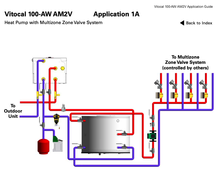

    Now for the design part, there are lots of open questions.
    It was my understanding that the Viessmann Vitocal 100 AW has outside temp control and uses room sensors as well. I never set one up. So I am by far not an expert as you can see.
    From what I read, the AWHP should handle 3 zones of radiant in floor most efficiently without a buffer tank.

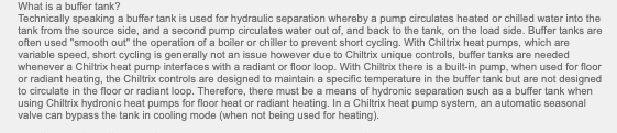

    Other say, the buffer tank is needed and the AWHP will just keep the water temp of the tank steady according to the heating curve.
    And others say the buffer tank needs to be in line with the return to add volume to the cold return/system.
    In Europe I almost never see a buffer tank with these. They say it runs up to 20% more efficient without, the contractor says I need it.
    Then I do not understand how to wire and setup the circulator pumps and zone thermostats. I thought the entire heating system will be run by the indoor unit.
    I appreciate it, if someone can help.
  • It depends on whether you use zone valves.
    With a heat pump, you need to keep it from short-cycling. Which means that it always has to have enough water circulating so that the compressor has a decent run time before hitting the high limit and shutting off. If you have zone valves, it's possible for all the valves to close at once, which means no water circulating, which means short cycling, so you need a buffer tank to provide volume when all the zones are closed.
    If you don't have zone valves you have the full volume of the system available whenever the heat pump is running so you don't need a buffer tank. This is simple and at a certain level more efficient.
    The reason I say "at a certain level" is that the purpose of a heating system is to deliver comfort. If you are unable to deliver comfort without zone valves then it's failing at its primary purpose, that isn't efficient.
  • Well, the buffer tank will likely go in and then we take it from there.
    As to the components between the buffer tank and the manifolds. What do I need there?
    So the wiring diagram of the heat pump says that it can have two heating circuit pumps wired to it and two temperature room sensors.
    We will have two manifolds, one for the main floor and another for the top floor. The more I think about it the less likely i find it to make set the floors to different temperatures.
    That means I would want the same temperature everywhere and would only need one zone, meanung only one circulator pump for both manifolds? And since there is no high temp emitter on the system, no mixing valve. The individual loops would be balanced on the manifold.
    Should the loops be limited to a room each for better balancing or can they just cross room borders etc.?
    So, only a circulator pump in between the buffer tank and the manifolds and the supply sensor?
    Or would would install a circulator pump for each manifold with sensor and wire them as HC1 and HC2?
  • A guiding principle when working with heat pumps is that if you're mixing, you're doing it wrong.
    I'm not familiar with the data sheet for your heat pump, so I pulled up one for one I am familiar with:
    https://www.chiltrix.com/CX34-air-to-water-heat-pump/
    Scroll down to where it says "Heating Data." Note that when it's 17F outside, if your water temperature is 95F the capacity is 20,575 BTU/hr, and if you're water temperature is 122F it's 15,494 BTU/hr — 75% as much. So if you're heating water up to 122F and then mixing it down to 95F you're losing a quarter of the heat pump's capacity for no gain. Note also that the COP is 2.66 at 95F and 2.03 at 122F — so you're using 33% more energy for no gain.
    One of the issues with buffer tanks is they introduce mixing. That's why a system without them is more efficient.
    A second guiding principle is ignore the nameplate capacity. This unit has a nameplate capacity of 2.8 tons of heating, it says so right at the top of the page. That's 33,600 BTU/hr, and if you look at the chart, it does in fact have that capacity at 47F with 95F water. But what you should care about is the capacity at your design temperature, which is probably going to be closer to 17F where the capacity is 20K BTU/hr.
    So before designing anything I would ask how the capacity of your heat pump compares to your heating load at your design temperature. Specifically, are you going to be able to heat the whole house with one heat pump? Because if you're going to need more than one, it's easiest to design each as a separate system.
  • At -25°C it has 25k BTU at 41°C water temperature. So almost exactly our design load.

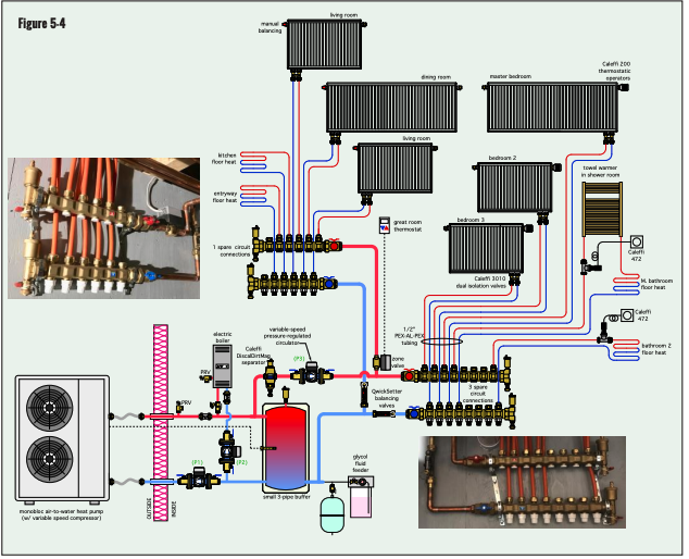

    If you go with a lot of zoning you want a buffer tank, the 3 pipe method is the way to go.
    Lots of good piping info here. A single delta P circulator with zone valves or a manifold home run shown here. A home run system takes more tube but gives you the ability to infinitely zone, or combine zones at any time by wiring actuators together or separate.
    I run a single low temperature to a slab, the heat pump is controlled by a sensor in the tank. I keep the tank at 115.
    Zoning is up to you. I would not micro zone every room in the home. Main living, dining kitchen can usually be combined. Maybe a master bath as a separate zone. It really depends on your floor plan.
    Run the loops so you have the ability to separate room if you want, but it will take more loops and manifold ports.
    https://www.caleffi.com/sites/default/files/media/external-file/Idronics_27_NA_Air-to-water%20heat%20pump%20systems.pdf

    Looking at the output curves, the 051078 our contractor wants to put in can exceed that even at -13F and 113F water temperature. It seems way oversized for most of the year and shoulder season.
    The one size smaller, 034043, is undersized for design temperature, but can meet demand for most of the year.
    See graphs.
    The will supply DHW as well. I dont know hoe that affects capacity.
    Is the big one really way oversized and should we go with the smaller one and take the slightly undersized capacity at design temperature?
    I can not find and data how far the big one can modulate down.
    Bildschirmfoto 2025-12-16 um 22.48.36.png Bildschirmfoto 2025-12-16 um 22.48.27.png

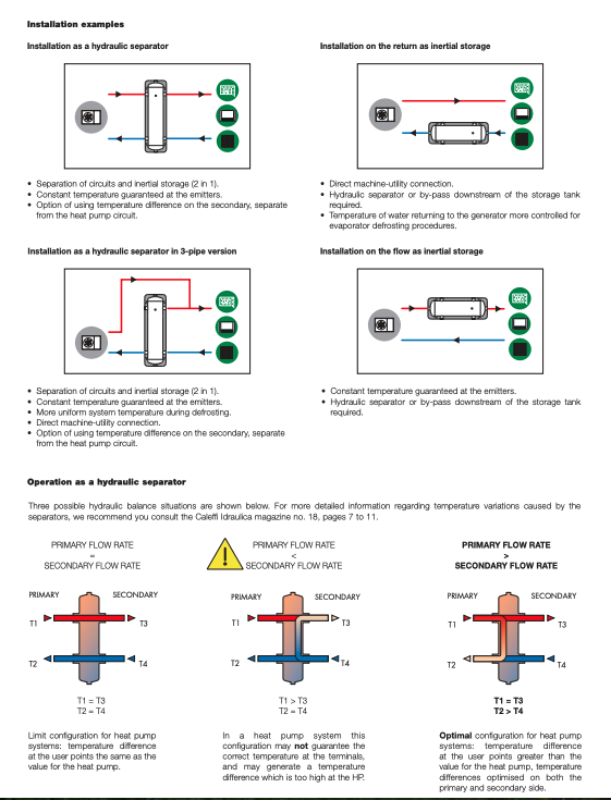

  • I agree that 3-pipe is the way to go if you have to have a buffer tank.

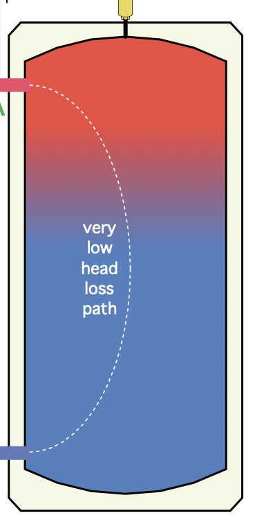

    I have to take issue with that picture that shows a nicely stratified buffer tank though. That's not going to be realistic in a heat pump setup.
    There are going to be two circulators — one on the heat pump itself, one to serve the zones. Between them is the tee that goes into the buffer tank. The flow through both of those circulators will be variable. The one on the heat pump will vary to meet the output of the heat pump, which will be trying to match its output to the load. The one on the zones will vary depending on how many zones are calling for heat, and which ones.
    The difference between those two flows will go through the bottom leg of the tee on the buffer tank. If the heat pump flow is the greater one, water will be flowing down into the buffer tank. The buffer tank should be small — Chiltrix recommends a 17-gallon tank for their 5 ton heat pump — so the entire tank will quickly reach the temperature of the water flowing into it, which will be coming straight off the heat pump.
    If the flow to the zones is the greater one, the flow will be upward out of the tank. The tank temperature will quickly reach the temperature of the water being returned from the zones. If the load is low and the heat pump turns off altogether, all of the flow to the zones comes out of the tank.
    Neither flow is constant, so the flow to the buffer tank can reverse directions as conditions change.
    From an efficiency standpoint, things work best when the flow out of the heat pump is the greater flow, the emitters get water at the temperature being produced by the heat pump. When the zones are greater than the heat pump the water supplied to the zones is being mixed with cool water coming out of buffer tank. And when you're mixing, you're doing it wrong.
    Fortunately that usually happens when the load is low so you're not asking much of the system anyway.

    In terms of sizing, the smaller unit would probably suffice?
  • Before I answer, can you tell me your zip code or even your county so I can look up some weather stats? I want to verify the design temperature you're using.
    I'm a little dubious of your heating load — 22K for the above ground and 14K for the basement seems unusual. 22K is low, indicative of a well-built modern house. In such a house the basement is typically insulated, which would mean 14K is kind of high.
  • Voodoo90
    Voodoo90 Posts: 34
    edited December 2025
    Halifax, NS Canada
    House is from 2009. So the basement would account for only a third of the total load or even less usually?

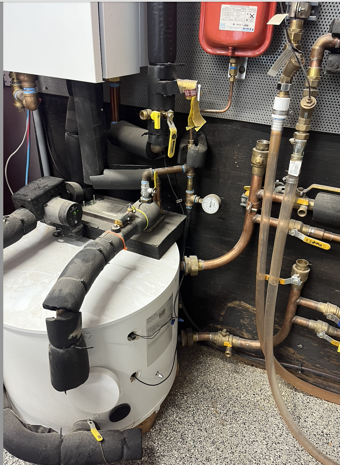

    The pump in those Viessmann runs constantly. The small buffer that Viessmann provide is a stubby, so not much stratification even if the pump would stop. When all the loads satisfy, the HP continues to tun until the buffer is heated to the setpoint temperature. Next call for heat comes just from the tank until it drops the differential.
    I believe all the VitoCals have a backup electric element built into the indoor unit, that can be enabled if they fall short.
    If @DCContrarian has a better piping diagram, go for it. Confirm with Viessmann that is piped to their requirement so you do not void warranty.
