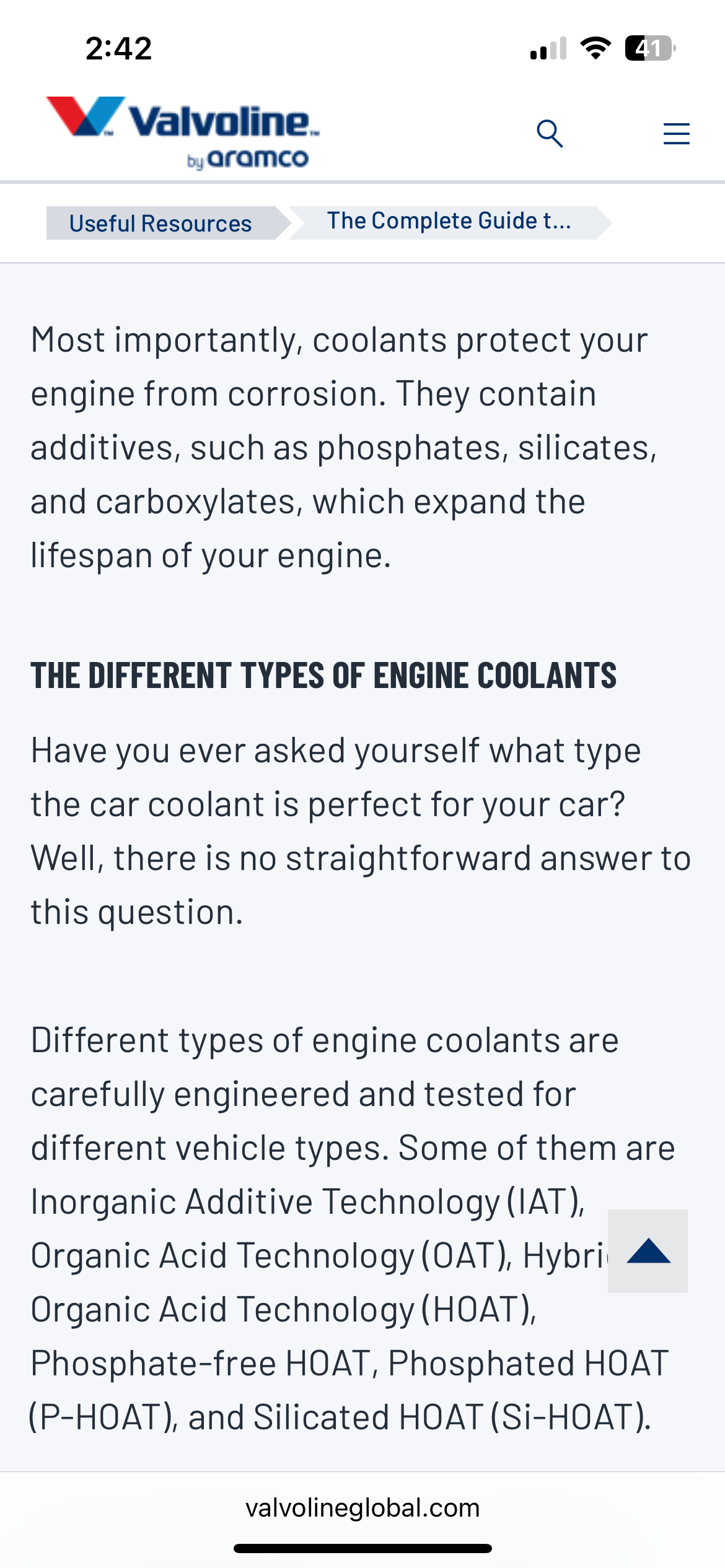

    Automotive glycols containe silicates which can sludge a hydronic system. Do not use automotive PG or EG in hydronics

    Silicates haven't really been a thing in coolants in over 25 years. That would be IAT coolant you're thinking of. Old school early 1990s and before green "prestone"

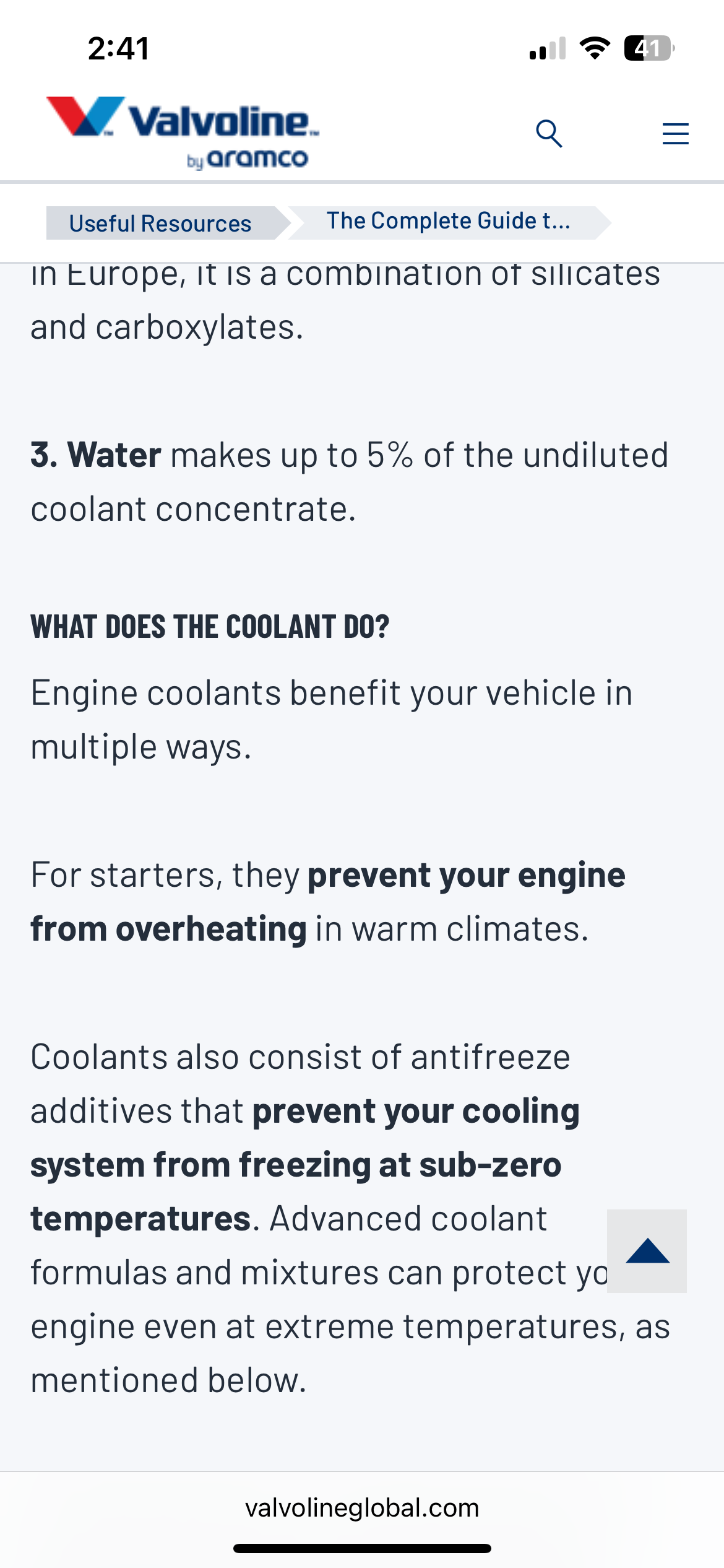

    the automotive glycol manufacturer still show silicates in some blend

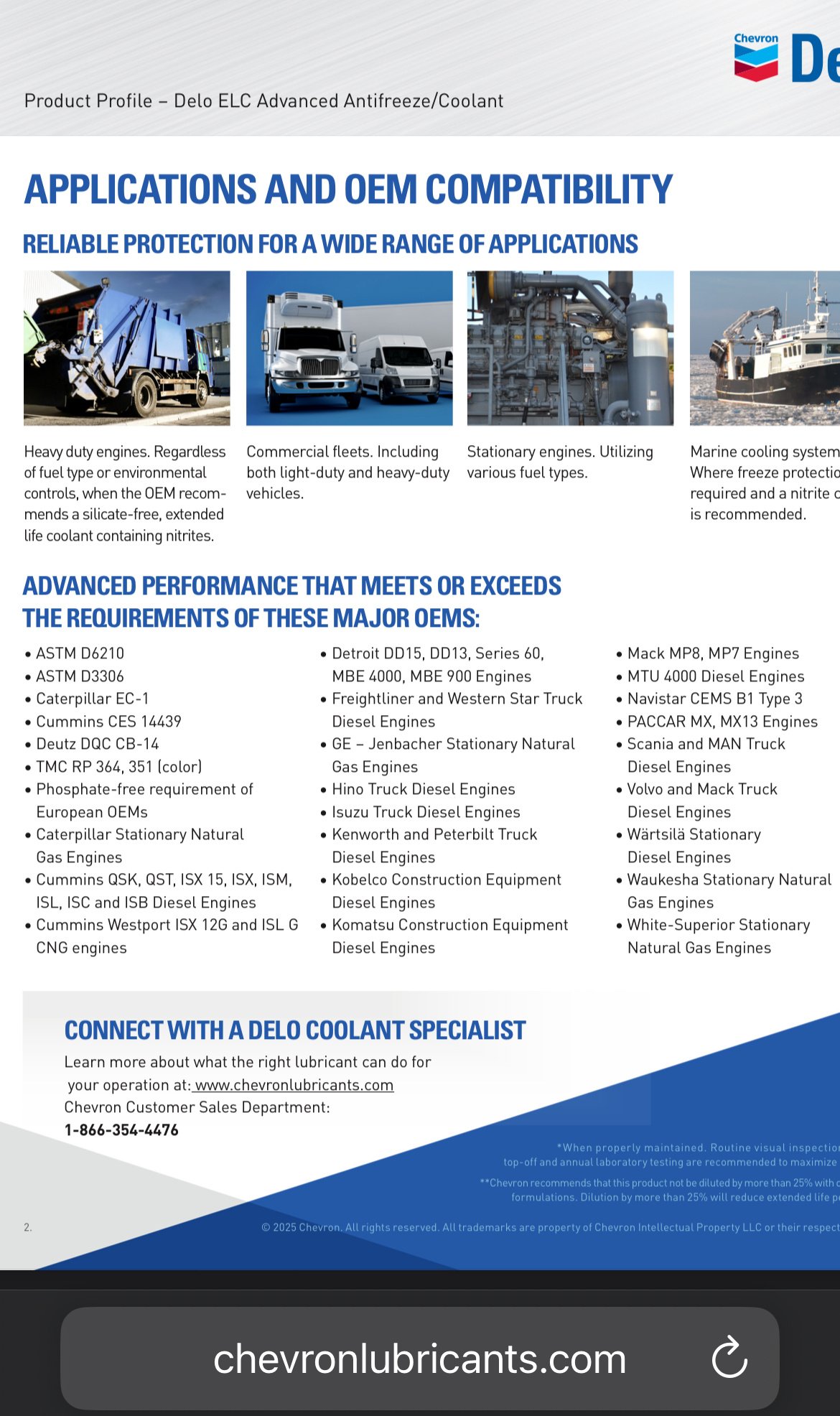

    I didn't say it doesn't exist. I said it hasn't been common in many years... IE MOST current antifreezes aren't using silicates. I don't know about all as there's probably hundreds available nowadays. I'm mostly familiar with Chevron as that's the products I've been trained on.
    Regardless, the Delo ELC I mentioned, (which I run in almost everything) is silicate free.

    Why not ask Chevron for a letter indicating the automotive antifreeze as safe or legal, or acceptable to use in hydronic systems, they should know?

    so you connected with a Delco Coolant Specialist and they said it us approved and recommended for hydronics?
    If not, why not?
    Can you post their response?

    Their tech line is generally not helpful.
    In fact their "experts" have called one of our grey beards for answers, when it was him calling them for info 🤣🤣🤣. He's been with the company since the 80s and reads and deeply understands and remembers spec books for fun.
    Grey Beard said he couldn't think of any issues, that a heating system is far less demanding than in automotive use. He thinks the "don't use" is due to wanting no liability on the toxic aspect. That it's very common to drain boiler water to the ground. And lot of systems are tied to drinking water.
    Just easier to say "NO, BAD, NO!"
