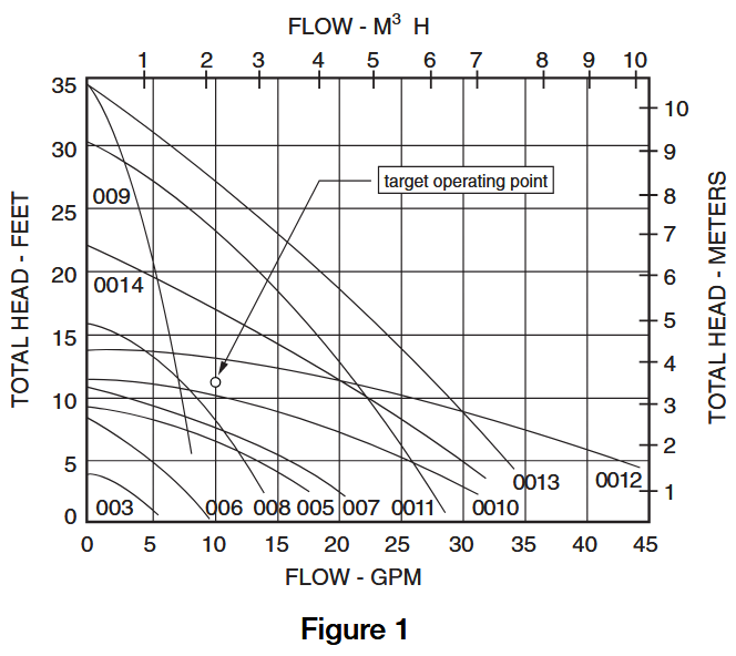

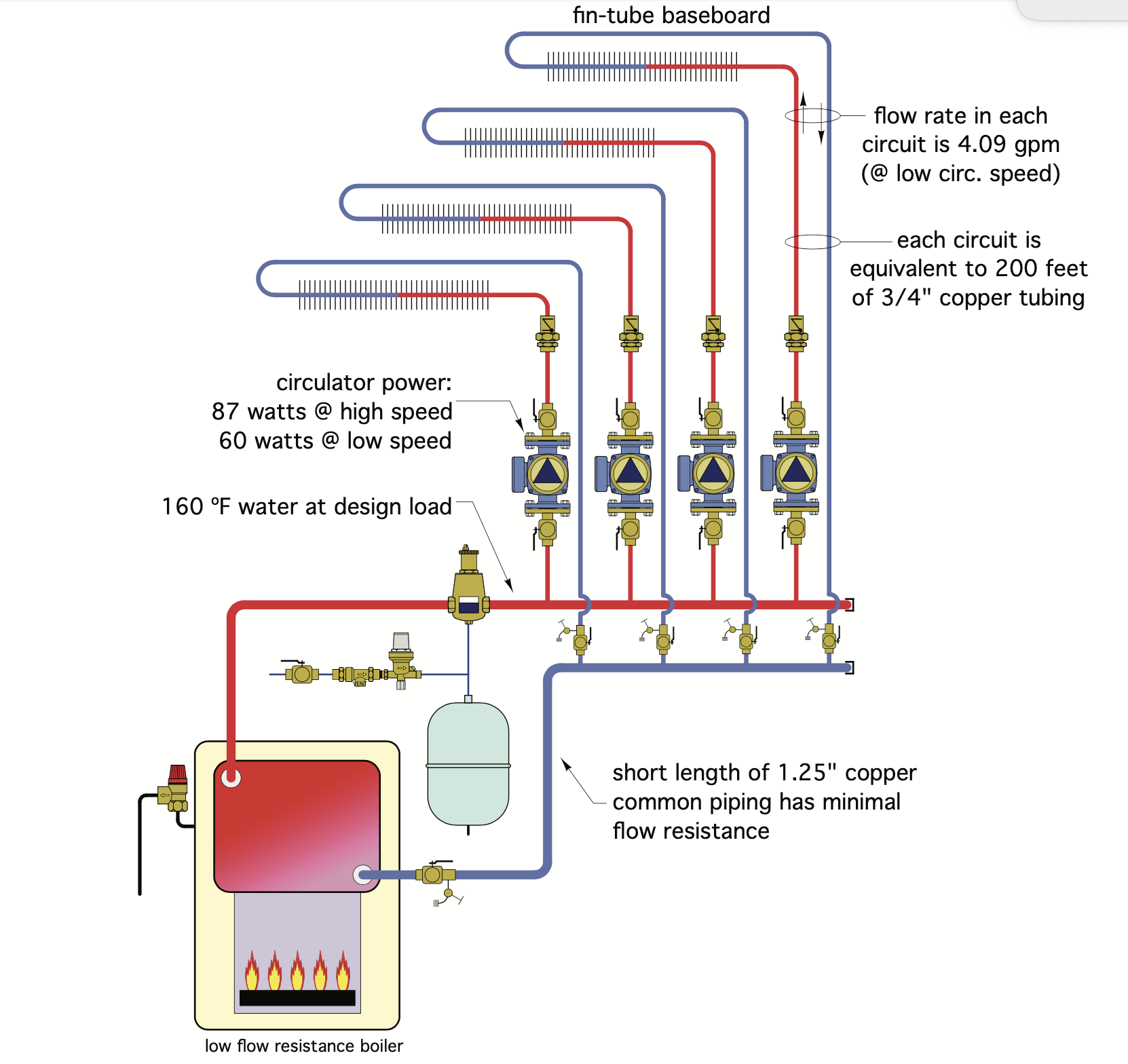

  • To answer your query about selecting the proper pump head you can find a simple explanation starting on page 7 of Zoning Made Easy and it continues on page 8 where there is this rule of thumb for small residential systems.
    Of course there are some other insights about your system that were brought up. You indicated that there is 121 feet of baseboard radiation on one zone. If that 121 is one continuous loop of 3/4" with 121 feet of aluminum fin behind all those covers, then you will have a problem getting heat past the first 70 feet of aluminum fin. if you reas the first couple of pages on Zoning Made Easy, then you will see that you cant fit enough heat for that much baseboard in one 3/4" pipe. As @hot_rod stated, that pupe can only handle about 60 to 70 feet of baseboard. That zone will need to be split into two sections that are fed by a 1" shared pipe from the boiler to each individual section as it tees off the shared pipe.

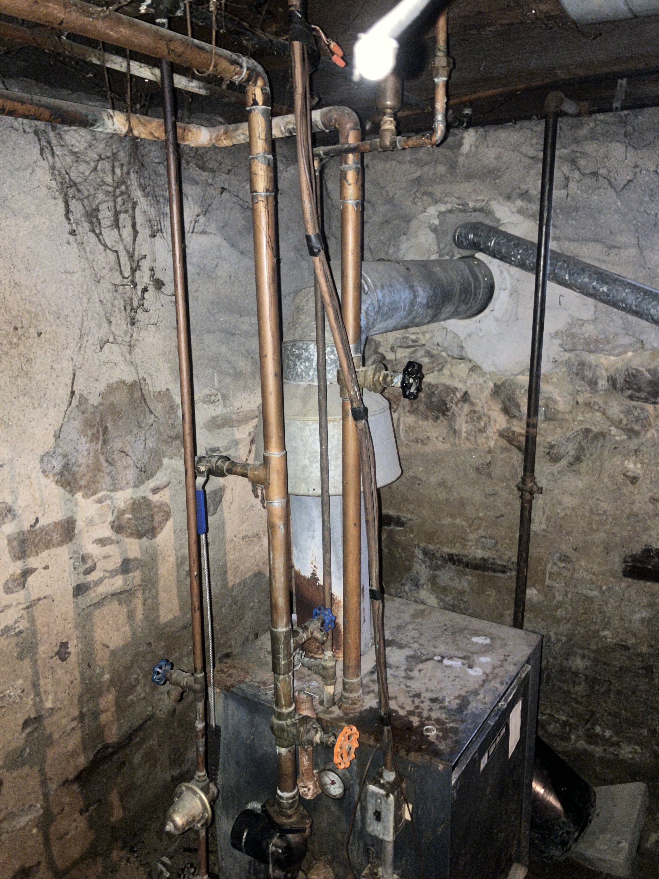

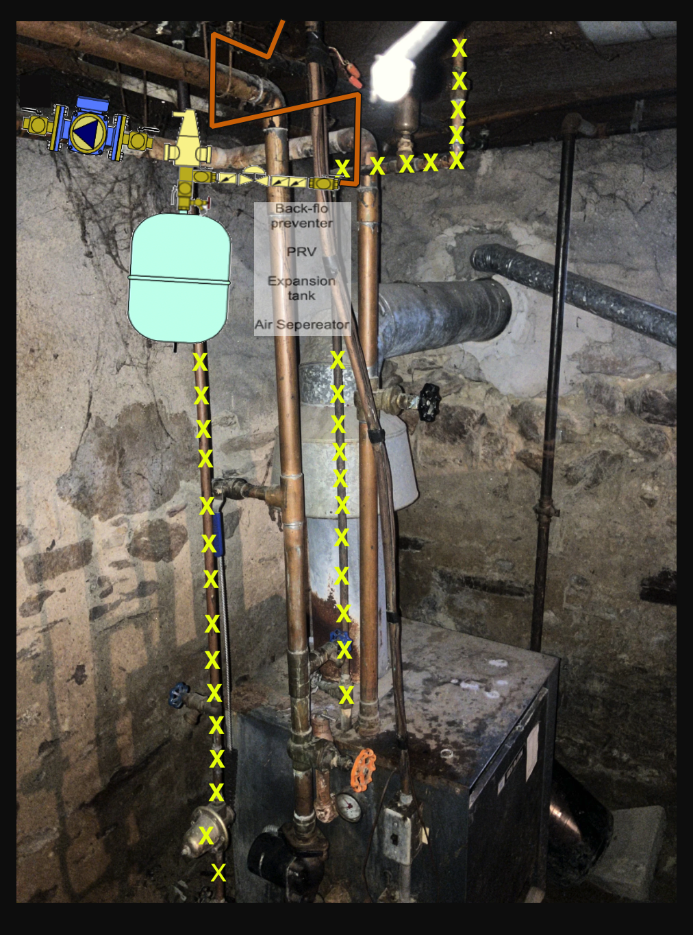

    Can you show some pictures of the boiler and piping? In this type of system the circulator is usually run off the end switches on the zone valves.

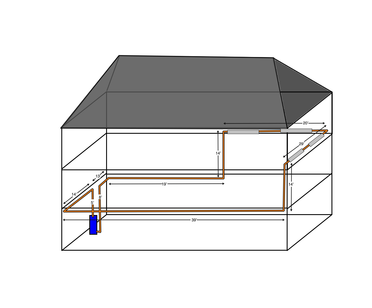

    @wyatts Said: "its not a 121 foot loop. off the boiler is a 1 1/4 supply that feeds into two zone valves. off each zone valve is a 1 inch supply these feed the upstairs and downstairs. off each 1 inch supply it splits off into 3 3/4 loops series loops i assume."
    This sounds like a proper piping design for the amount of BTU the boiler has to give you, almost. If you look at the first few pages of the Zoning Made Easy booklet, you will see a pipe size to BTU capacity chart. The 1-1/4" pipe can move up to 140,000 BTUh when there is a 20° temperature drop (∆T). Since your boiler can deliver 168,000 BTUh, there are 28,000 BTUh that can't fit in the 1-1/4" pipe unless you do some changes like move the water faster, which may be noisy, or a higher ∆T.
    So to determine the needed pump head, you take the loop with longest run of pipe. Now if you have a 2200 sq ft. home. Lets say that there is 1100 SqFt on each floor and each floor's dimension is about 30' x 40'. the boiler is at one end of the basement. The longest run of baseboard goes from the boiler. The riser is about 5 feet to the basement ceiling.  Then it goes to the front of the basement about 14 feet, then 39 feet to the other end of the basement where it turns to go up to the second floor. That takes about 14 feet to get there. Then that zone wraps the baseboard with ¾” tubing around the far side of the house for 29 feet and turns across the back of the house another 20 feet. Then it drops down to the basement for another 14 feet. Once in the basement it will return to the boiler room across the back of the basement about 19 feet.  At the back of the basement it turns to the boiler for about 13’ the turns down to the boiler return about 8 feet. That is a total of 180 feet if you count all the 8” drops and risers from each baseboard as it jumps from room to room.
    Here is an illustration of that loop:

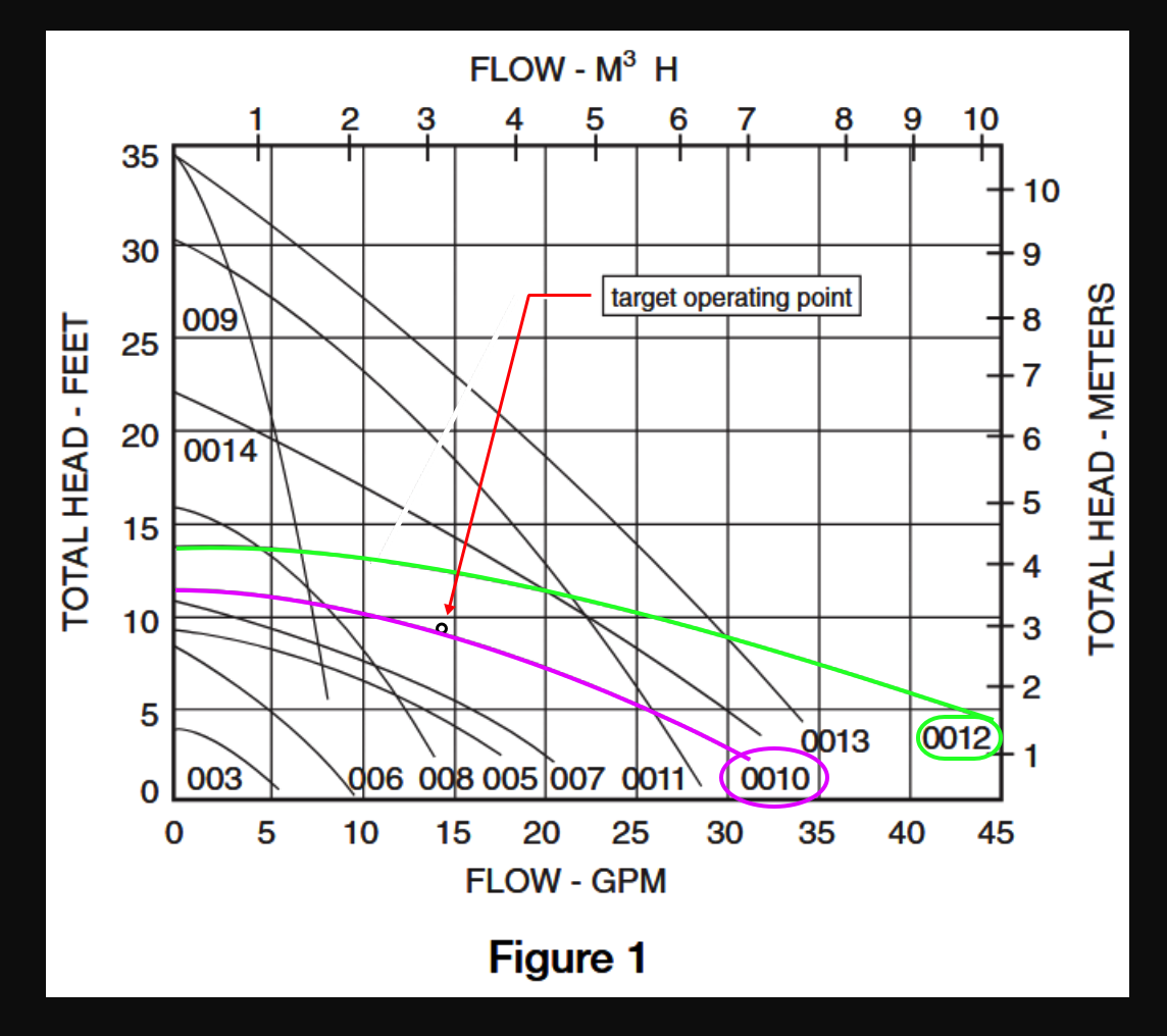

    Now here is an easier way to do that calculation.  House dimension is 30 x 40.  The total perimeter is 140 feet That's the round trip around the house.  There are 2 risers from the basement to the second floor at 14 feet each 140 + 14 +14 = 168 feet. Now add the near boiler piping at about 12 feet and you get a total of about 180 feet of total piping round trip.  There is the first number you need for the rule of thumb calculation 180 feet.
    180 x 1.5 for additional fittings = 270 total equivalent length of pipe.
    Multiply that by 0.04 for noise free operation, and your pump head is 10.8 or just about 11 feet of pump head. So look for a pump that can deliver 17 GPM for 168,000 BTUh at 11 feet of head.

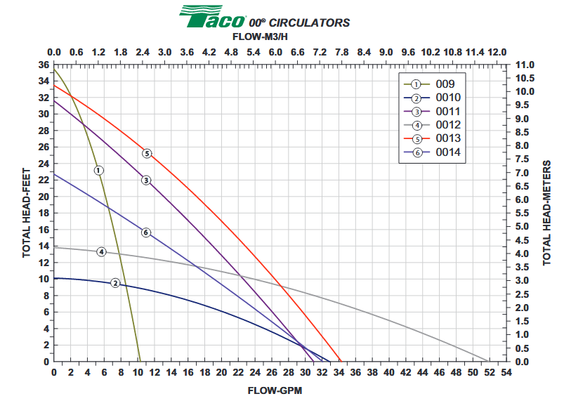

    The Taco 0012 looks like the pump I need for my hypothetical 2200 sq ft house. The Taco 007 falls short by a lot.
    You need to measure your longest run to see what you require.

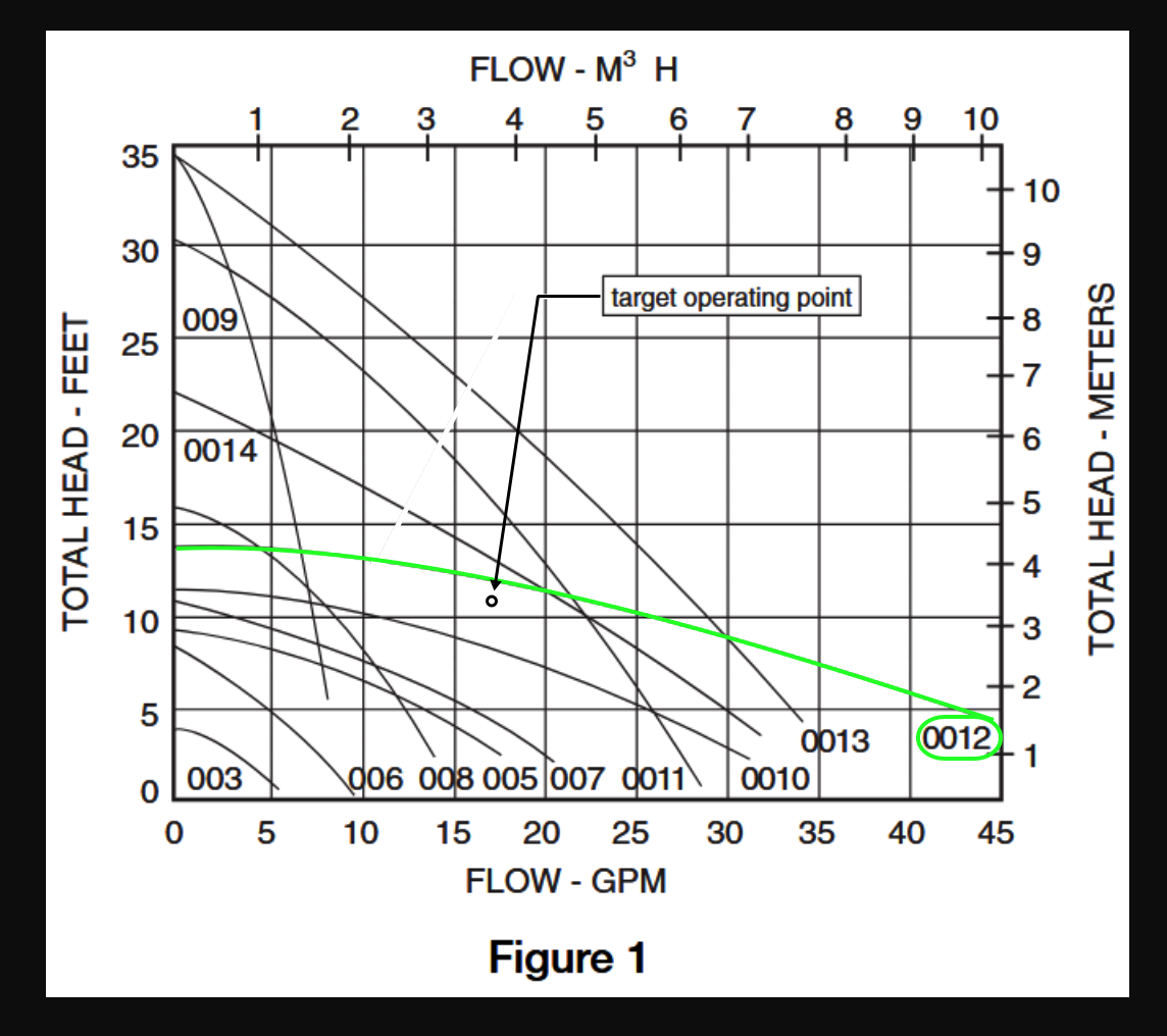

    Another reason to select the 0012 pump over a 0011, 0013 or 0014 is because the pump performance curve ofthe 0012 is so flat.  Think about it this way.  When you have a zoned system and one of the zone valves is closed then you only need to move enough GPM for the smaller load of one zone.  That might be about 8 gallons per minute when only one zone valve is open.  Look at the head of the 0012 when it is only pumping 8 GPM.  Compare that to the pump head of the taco 0011. That pump will move 8 GPM with a pump head of more than 20 ft. That much extra power may actually move the water thru that single zone too fast and you will have noisy operation and poor performance.   The amount of pump head increase from 8 GPM to 17 GPM is very little on the 0012.  This is a great pump for zoning.   .
    If you look at @EdTheHeaterMan pump selection at 11' of head the 007 is out of gas.

    we still haven't seen the boiler. in 1980 it probably came with an 007 installed on the return.

    You need 17 gpm and an 007 will not even be close to moving enough water.
    The 007 runs out of gas at 4' of head which is 1.73 psi differential across the pump.

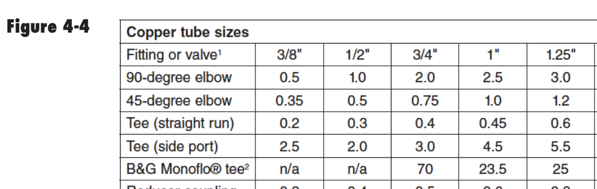

    A B&G 1-1/4 Monoflo tee has an EL of 25' of straight pipe. So that adds up quickly for calculating pressure drop.
    Also heat emitters are in series in a Monoflo tee system, so the end radiators see much lower SWT. Two reasons that they may need more pump power.

  • i measured around 154.5 foot * 1.5 = 231 * .04 9.27ft of head so maybe smaller then taco 0012
