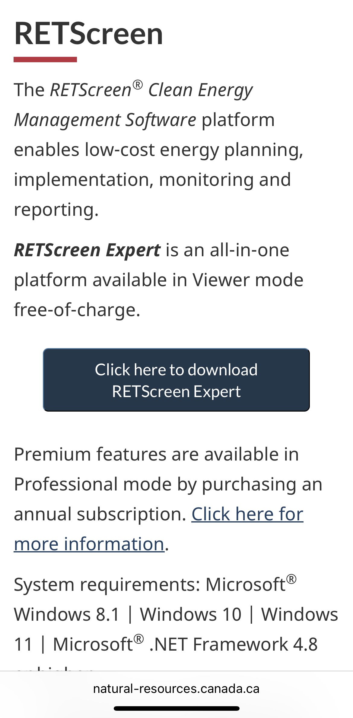

    you need a solar simulation software to make it quick and easy to do those calculations and comparisons.
    RET Screen out if Canada had a powerful, free program with solar calcs
    Possibly some freebie at the NREL site also

    Thanks Hot Rod, I'll check out RETScreen.

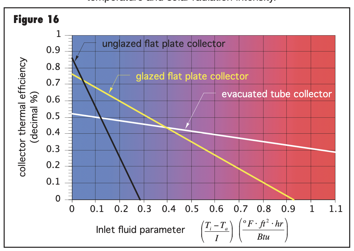

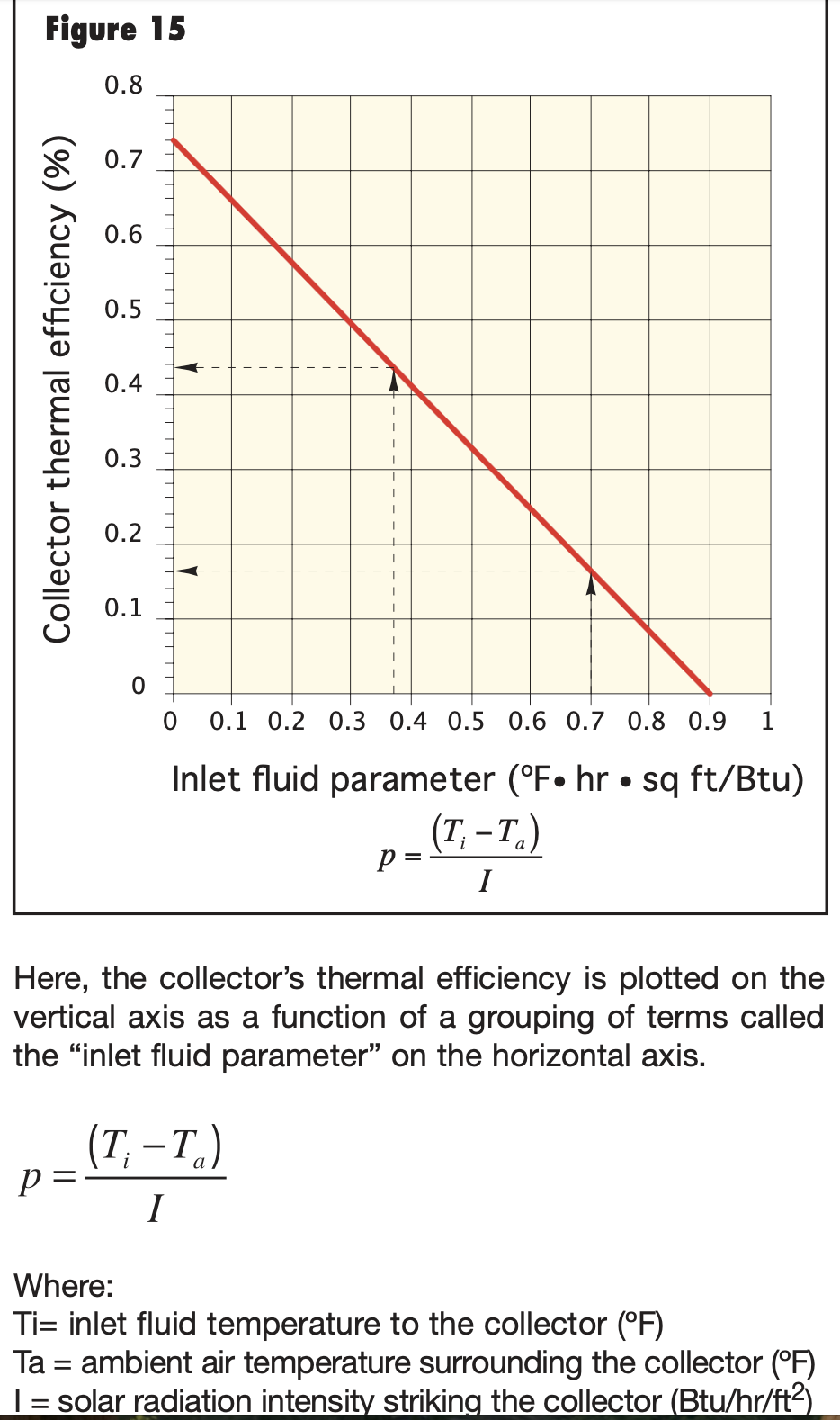

    While an unglazed pool type collector can reach near 90% efficiency in warm months, the black line on the graph below, in the winter when you need heat you are looking at dismal performance.
    Screenshot 2025-09-16 at 7.41.51 AM.png Screenshot 2025-09-16 at 7.49.54 AM.png
