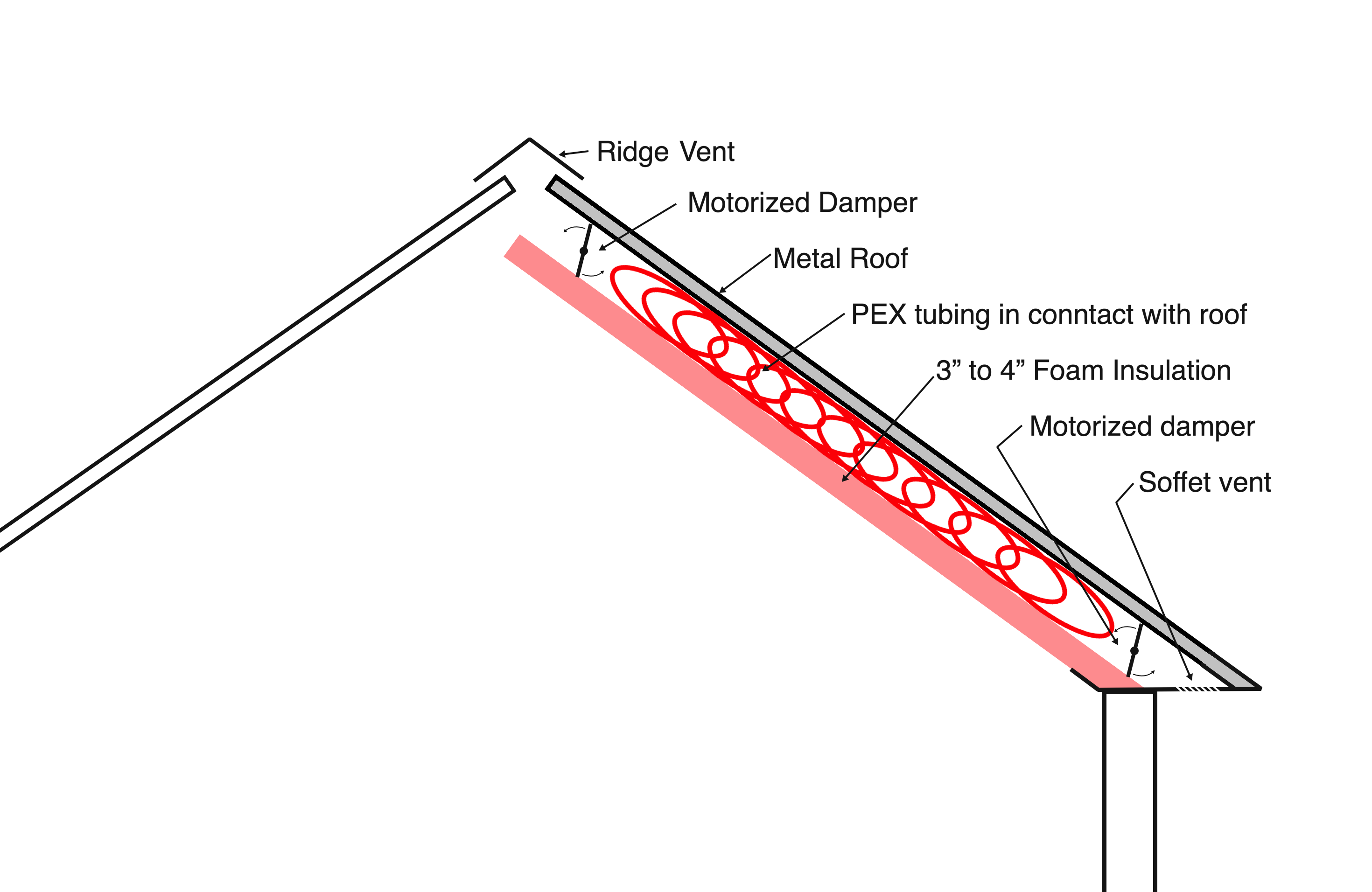

    EdTheHeaterMan Posts: 13,016
    edited September 2025
    The first thing I thought of when I read your original idea is "Too Hot? Just purge some of that heat". If there is a High Limit temperature for that tubing, you can have a ventilation system operate to dump some of that "overheating" even if it just a damper motor that will allow thermal air flow to reduce the roof temperature.
    Set the solar roof to the best angle for winter collection and open the dampers in the very hot months to keep the roof from getting 100% of the solar temperature by venting ambient air under the metal roof component. You could also pump cooler water thru the PEX when you are not collecting heat in the summer by dumping that heat into a closed loop geothermal well or field to cool off the tubing
    The damper can be a single rod extended thru the roof joists with a pulley or linkage arm at one end, then attach sheetmetal dampers on that rod to fit between the roof joist spaces. One damper motor can move both linkages to open and close the dampers at the top and the bottom of all the joist spaces with PEX tubing

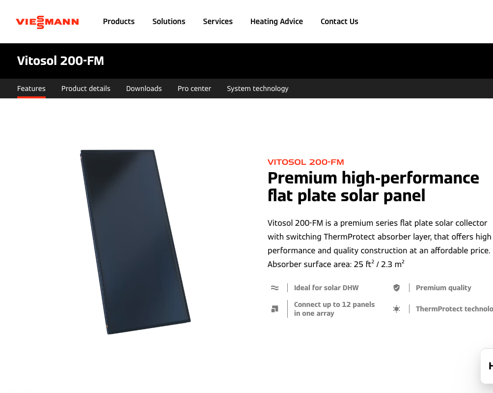

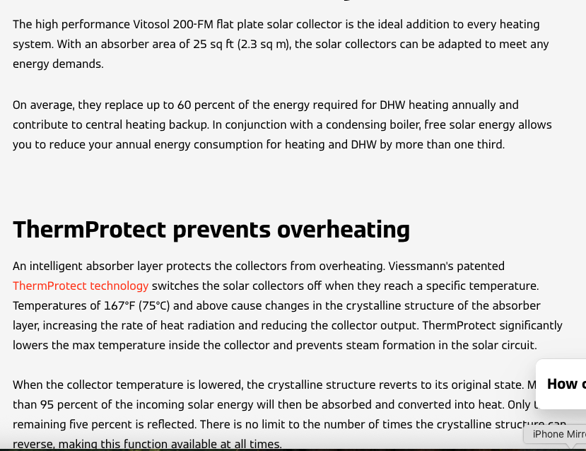

    Viessmann introduced a coating recently for their thermal panels that lessens the energy striking the absorber based on temperature. A simple non electric solution to minimize over-heating.
    Screenshot 2025-09-19 at 8.39.53 PM.png Screenshot 2025-09-19 at 8.39.34 PM.png Screenshot 2025-09-19 at 8.39.19 PM.png
    Larry Weingartendesert_sasquatch

    First… I see what @hot_rod was saying either here or in the Azimuth, Solar Elevation, and Solar Irradiance thead: That what I'm proposing here still won't be as cost efficient as the good ol glazed solar thermal panels. I realize now that when I posted the SRCC data for the solar roof I was reading it wrong—I didn't realize that the low irradiance column was pretty close to how much irradiance I could expect in the winter. And as the solar roof can barely heat water to 5 C above ambient in those conditions … yeah, I see that the roof won't help me heat the home in the winter.
    On the other hand, I do see that in this climate some glazed panels plus a heat bank would seem to be cheaper than grid tied solar with a heat pump, both because Arizona has Net Billing (which is less lucrative than net metering) and because heat pumps cost a lot of money and, if used frequently, seem to need replacement every 15-20 years at best (last I heard).
    And I've always liked solar thermal more than heat pumps, so I'm happy about that :).

    1). Hot_Rod, how important is it to keep those solar thermal panels from overheating? I guess I thought it wasn't that important because presumably there would be a portion of the day when the panels could make hot water and then the system would drain back and prevent the pipes from turning all the water to steam and exploding the system….
    2). One thing I liked about the solar roof idea was that it also provided a convenient way to chill water to very near the outdoor temperature at night. If I could store this cool in the heat bank (the one for home heating and cooling, not the hot water one) I thought this might be useful in the summer to keep the indoor temperature to manageable levels (though admittedly, during heat waves, that could be 80-85 degrees F I would guess). Is there a better, cheaper heat exchanger that people wind up using?

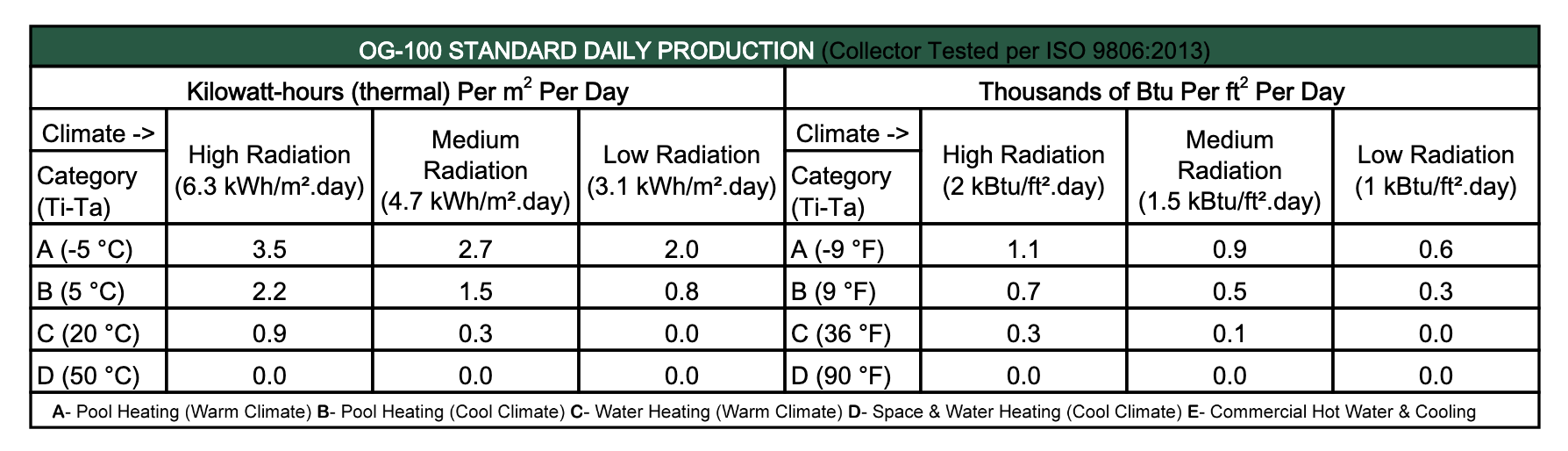

    a basic flat plate solar collector is glass, aluminum insulation and copper. There is really not much to be damaged in an over heat condition, drainback eliminate the fluid, so no flash to steam
    Early collectors used insulation where the binder in the material would out gas and fog the collectors after time. The newer insulations eliminated that concern
    If you are in a heating climate use the correct category in the SRCC data. Category C or between C and D.
    YOU need to define the condition the collector will run at, SRCC just shows typical example
    The hotter you run a collector, the less efficient they are, too much loss to the ambient air. The glass and insulation lessen the losses from the collector.
    There were some collectors build with double pane glass, patio door glass to lower the front loss. However the second pane of glass lowered the collection efficiency, and were expensive to replace broken glass. The juice wasn’t worth the squeeze🌞
    So there are trade-offs.
