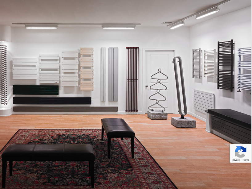

    hot_rod Posts: 28,705
    I sure like the looks of panel rads in a glass sunroom. You still get the radiant output and feel but no need to build an enclosure. I have seen them right in front of glass walls where the glass is ceiling to floor.
    The load calc is crucial if you want to warm this space to a comfortable condition.
  • Thanks guys- yeah- will be doing a load calc soon and weighing different hydronic heat options- but that is the way I'm going to go with the sunroom, definitely-just makes more sense.
