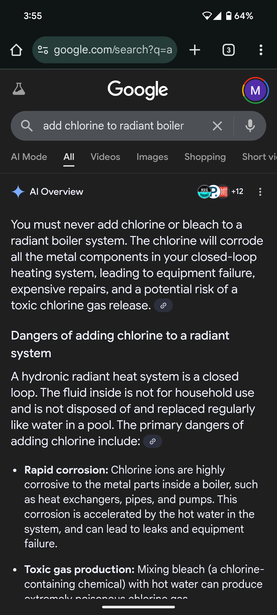

  • Please don't take this the wrong way but info I find online seems to strongly discourage adding chlorine to radiant boiler systems.
    Here's Google, for example (I know, I know.. AI...)
    Ah yes. Google knows everything… don't mind us.

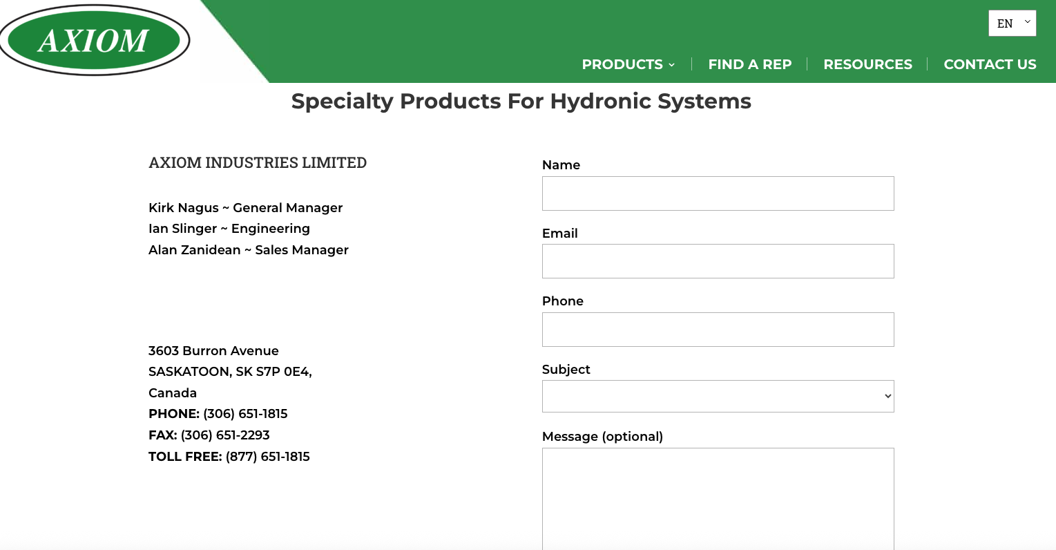

    You might call Axiom directly ask for Kirk, Alan or Ian they would certainly know this by now after all the years of building those systems.
    pecmsg Posts: 7,634
    then it’s not a concern
