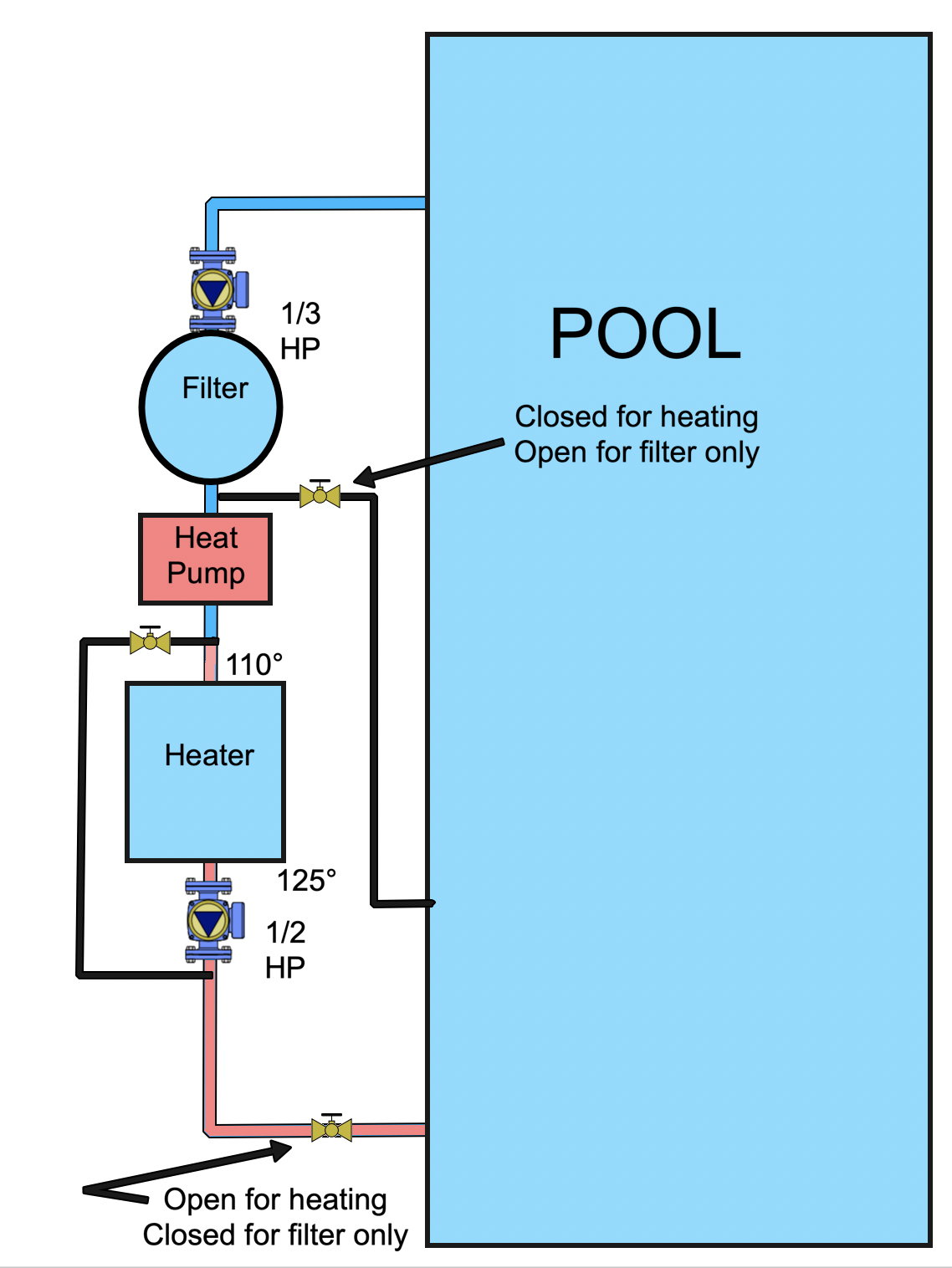

    I know that I used the filter pump when I heated my pool with a home made contraption years ago. and I assume that there are several valves and bypasses installed with your heat pump pool heater and filter setup, that this simple diagram does not show. the concept of using the bypass and the pool filter to get 110 inlet to the pool heater without primary/secondary and two heater pumps to accomplish that is what I'm illustrating here. If the fossil fuel pool heater is added to the system like the illustration on the right you may not get the outlet of the heater to be much more than the 125° illustrated in order to keep the water entering the pool at a safe level.
    If you add the heater as illustrated on the right, you can get a higher temperature from the fossil fuel heater and mix it with the lower temperature water to accomplish the safe water temperature entering the pool. either design uses the bypass with a valve to adjust the inlet water temperature to 110°. Once you get that valve dialed in to get the 110° then you should be able to lock that setting in and leave it alone.
    Leaving water is more or less irrelevant — adjust the bypass so that the return water hitting the boiler is at least 110 F. To clarify a bit, the circulating pump will be at the boiler, pumping away from the boiler, followed by a T which goes to the pool or the bypass, or on the return, pumping directly into the boiler, with the bypass upstream of the pump (on the pool side of the pump).
  • Thanks all. Ed I think I will try your left picture first since I don't have an extra pump laying around. The system already has 2 pumps in it a 1/3 HP pump that runs all the time giving 10 gpm all the time on the system, then a 1/2 HP pump in series that activates with the heater to raise the flow to about 25 gpm (moves both pumps lower on the head/gpm curve) when a heater is running. I have already closed the pool for this year but will try in the spring. I can always add a pump and go primary/secondary or bypass if things are not going well. After the water mixes, I am only expecting a delta T of about 20 degrees based on the 25 gpm and 200,000 btu's from boiler.

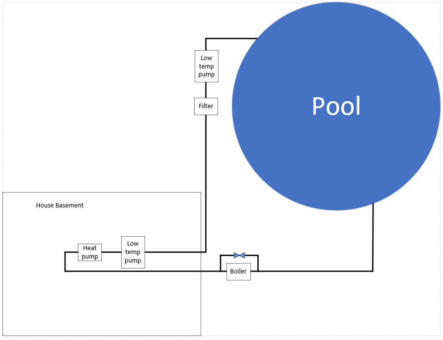

    I'm not sure how you are already piped and which pump is first in line, or if there is a different path for filtering only, but here is how I might do what you are thinking of. I believe this might be in line with Jamie's recommendation also.

  • Based on Ed's 2 pump concept I understood the following to be what I would pipe. If I am misunderstanding let me know. I don't intend to run both heaters at the same time. When the house gets hits minimum cutout temp, the HP will shut off and the boiler will fire. There is about 100' of pipe to get the water from the pool to the basement and back to the pool.
