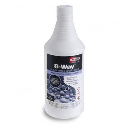

I had my oil-fired boiler replaced a few months ago. I'm in NY and use the boiler only for heat, so it's idle for the summer.
I was just cleaning up in the basement and I found a bottle of this stuff. I asked the installer, and he apologized and said he must have forgotten to add it when he filled the boiler. He suggested that I drain a bit of water, remove the air vent, and pour the bottle in the hole.
I have no problem doing that, but is it worth the hassle? Does this stuff really make a difference?

For a steam boiler, open to the atmosphere and having fresh water added to it more or less regularly, I highly recommend it. But only use like 1/3 of what the directions say. Its main useful feature is that it raises the pH of the water dramatically reducing corrosion.
for a hot water boiler that is a closed system with very little water added to it, I don’t think it’s as helpful. But it can’t hurt. But if it were me I’d just add 1/2 bottle and save the rest for next time the boiler needs to be drained (if ever).

Ek recommends the use of 8 way in all it's boilers( it's shipped with every boiler we sell). The ek-2 holds 4 gallons of water and depending on the size of the rest of your piping and radiation type may change things but usually one bottle is more than enough.

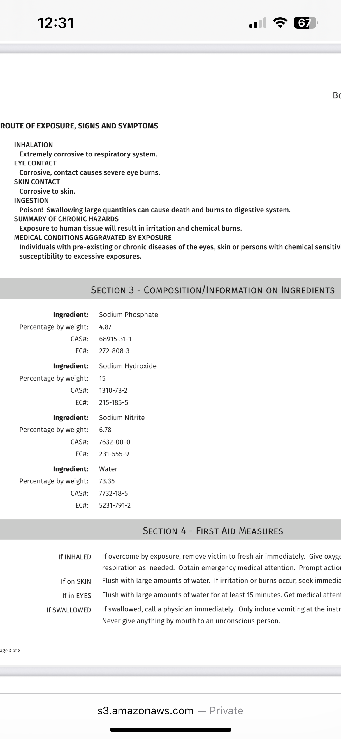

The 8 Way looks to be mainly a cleaner? The ingredients are lye, phosphate “soap” and nitrites, also a cleaner, 78% water
I know Rhomar and Fernox hydronic products have a lot of ingredients, ph buffer, oxygen scavenger, film providers,I built some test coupon racks for Rhomar years sho, as I recall they blended 17 ingredients in their hydronic conditioner
Fernox, Adey, Rhomar, Axiom are two step. First the cleaner, then flush and add conditioner. A special test kit is used to check fluid conditioner, boost as required .
