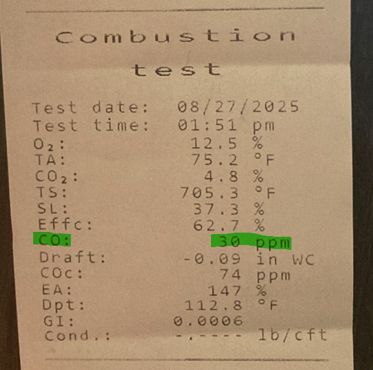

    UPDATE! I had a pro come out today. He didn't want to touch the boiler (because it's a serious antique) but I convinced him to light it and do a combustion test. He found 0-3 PPM on the outside of the boiler, and 30-50 PPM on the inside / flue. He blessed it to keep operating and suggested that I replace it due to age.
    BTW, the gas co didn't even tag the boiler, just shut it off. I have no idea how they managed to get 60 PPM on the outside.

    EBEBRATT-Ed Posts: 21,393
    Well things could be done to improve things.
    Probably a new Carlin gas burner if it is worth the conversion.
    Your stack temp is high 705deg would be 400 with a new boiler and probably could get it down to 5-600 with a new burner
    Your draft is way too high sucking heat up the chimney -.09. It should be-.02 over the fire and maybe -.04 or .05 in the flue.
    And the burner is not mixing gas and air to burn efficiently. Your Co2 should be 8 not 4.8
    The burner is the combustion numbers and turns the fuel to heat.
    The boilers job is to absorb the heat and transfer the heat to the water
    Neither one of those is great right now but IMHO is is more of a burner issue than a boiler issue.

    It may be possible to clean and adjust the current burner if you can find someone that knows how. Most of the draft control is built in to the design of a modern atmospheric gas boiler. With a conversion burner in a coal boiler the tech has to control the draft.
