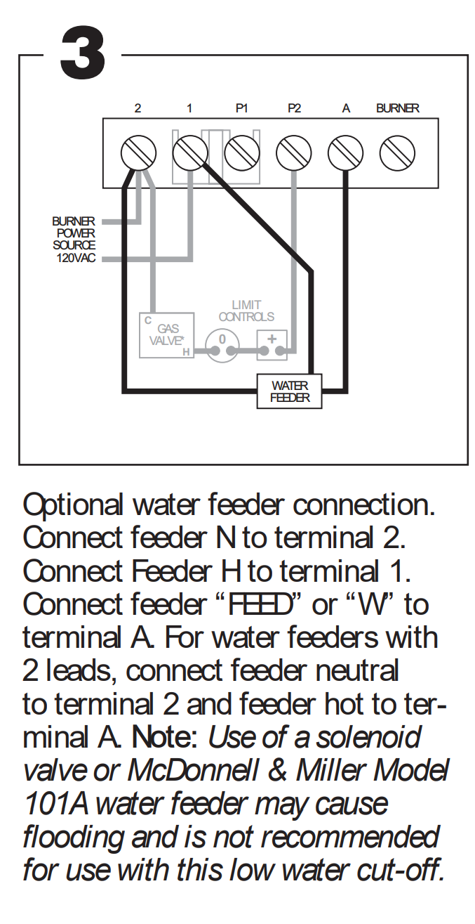

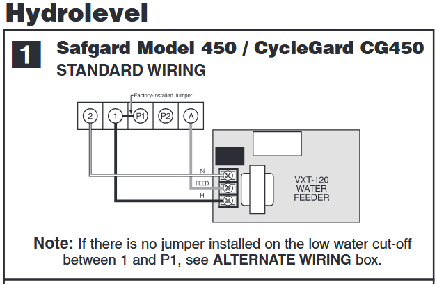

LWCO is a CG450 with outputs to the feeder on "A" , Neutral on "2", H on "1"
Feeder is a VXT-120
if I read between A and 2, I should be able to determine if the LWCO is calling for feed or not. I'm assuming that 120V would indicate calling for feed.

    A closes to hot to call for feeding. The connection to 1 is for constant power for the counter. If there is power between A and 2 it is calling for feeding. You could also connect a 120v indicator light in parallel with the feeder to monitor it. If you turn the power off to the boiler and the level keeps rising, one of the valves isn't holding(or you have a tankless coil or indirect that is leaking).

    HVAC manufacturers don't provide information like that, as every installation is slightly different. If one manufacturer made the whole thing, yeah — then they probably would. But in this case, the Cyclegard manual for your LWCO gives the connections at the LWCO (two possibilities) while the VXT-120 manual gives the connections to the Cyclegard. Nice of them.

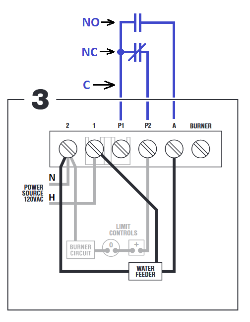

    I believe when 120 VAC is applied to the 'Feed ' terminal that activates the feeder. Yes why Hydrolevel used that nomenclature is beyond me, I would have been happy if P1, P2 and A was NO, NC, and Common since I believe it is a relay inside. If you disconnect the wire between the A and the Feed what voltage was on the Feed terminal before and after in reference the the Neutral ? What state is the LWCO in ?

    I believe the CG450 internal relay is in this state when the unit is powered up and all is normal (the water level is OK).
    NO = Normally Open (Off), NC = Normally Closed (On), C = Common

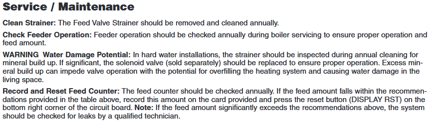

    But- does the boiler overfill when it is not being operated, such as now when the weather is warm? If so the valve in the VXT may need rebuilding. Shut off the water supply to the VXT to confirm this.

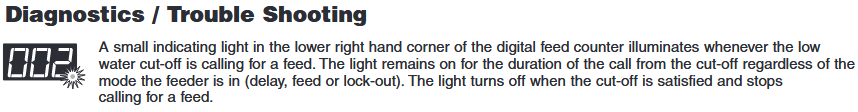

    Also, may be easier than a multi-meter or disconecting wires.

    If, on the other hand, it's the VXT — again, perform the annual maintenance.

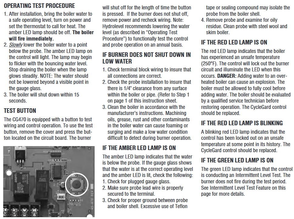

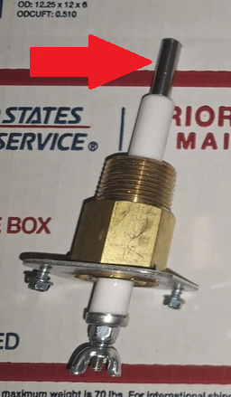

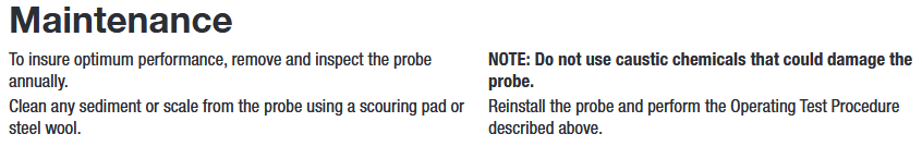

    Have you checked and/or cleaned the probe ???
    If the probe has been contaminated or coated to the point that the electronics can no longer detect the presence of the boiler's water the CG450 LWCO will be continuously in alarm.
    In this case simply replacing CG450 LWCO unit and reusing the original probe will probably result in the same issue.
    This area (Red arrow) needs to clean. The white insulation area between the probe electrode and the brass threads should be contamination free also.

    I'm am aware of the maintenance requirements of the probe.
    To be clear, when the water level is correct, the Low Water light is NOT on. When I drain the boiler below the probe the Low Water light IS on. correct me if I'm wrong but I I think that mean the probe is doing its job.
    Does suggest that the electronics are OK — except for the last bit which trips the LWCO. Unhappily, that relay also shuts the boiler off… so you don't have any LWCO control at all.
    You need a new control.
    Robert_H
    109A_5 Posts: 4,759
    OK, I get it now. Yes, it seems like something is wrong inside the CG450.

    my bet is on solder joint to the relay and the relay is supposed to be energized when the level is ok.

    As @mattmia2 stated it easily could be a failed solder joint, if the relay 'Fail-Safe' logic is structured that way. Failed solder joints at relays is common. It could be other things too.
