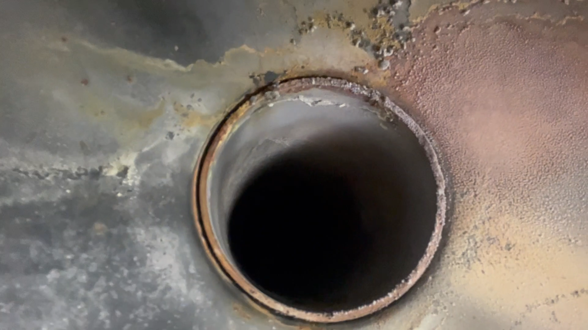

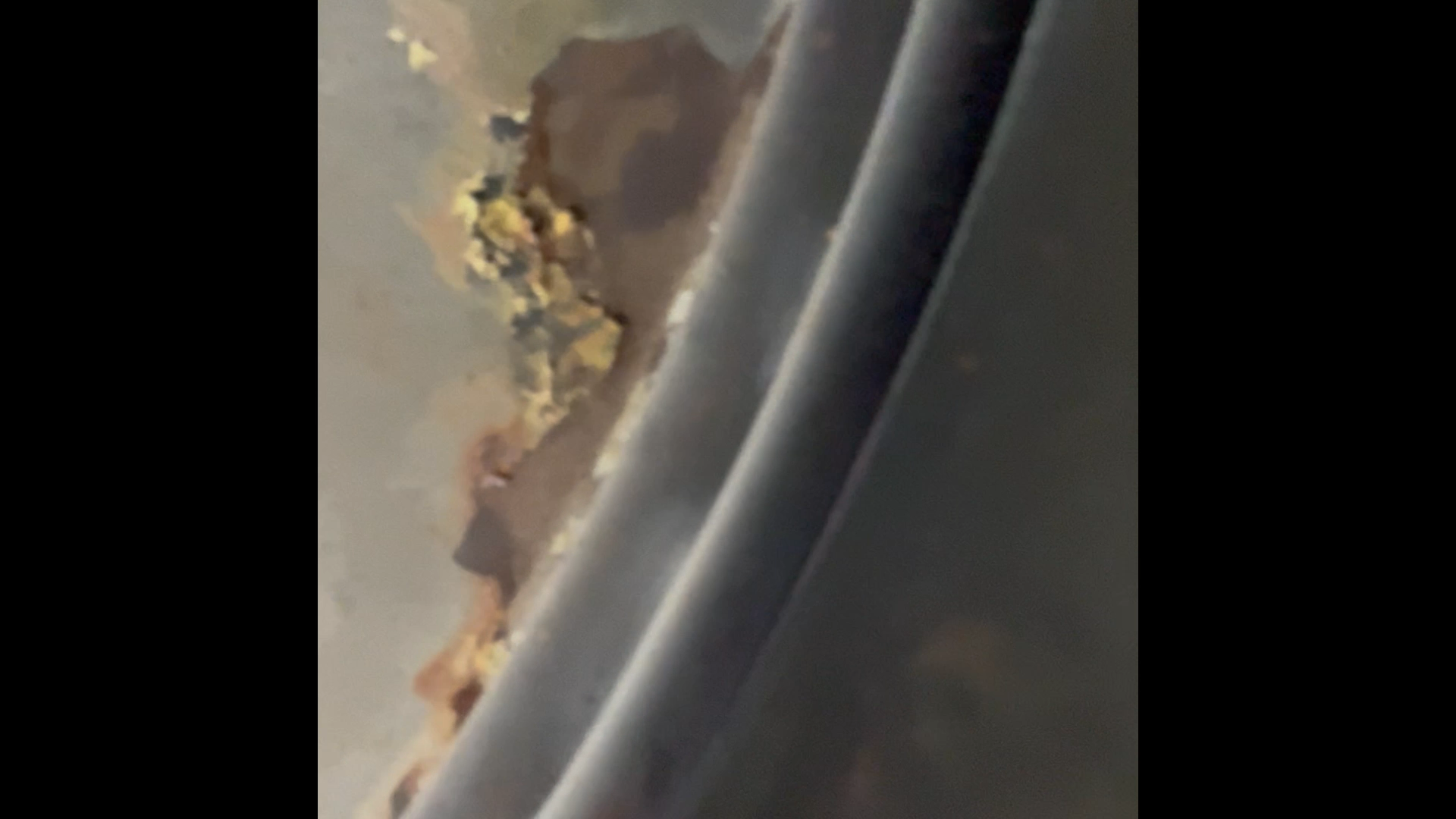

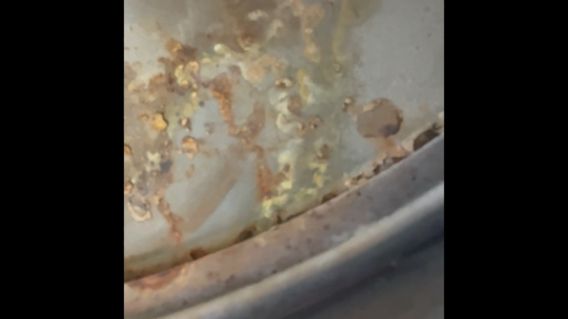

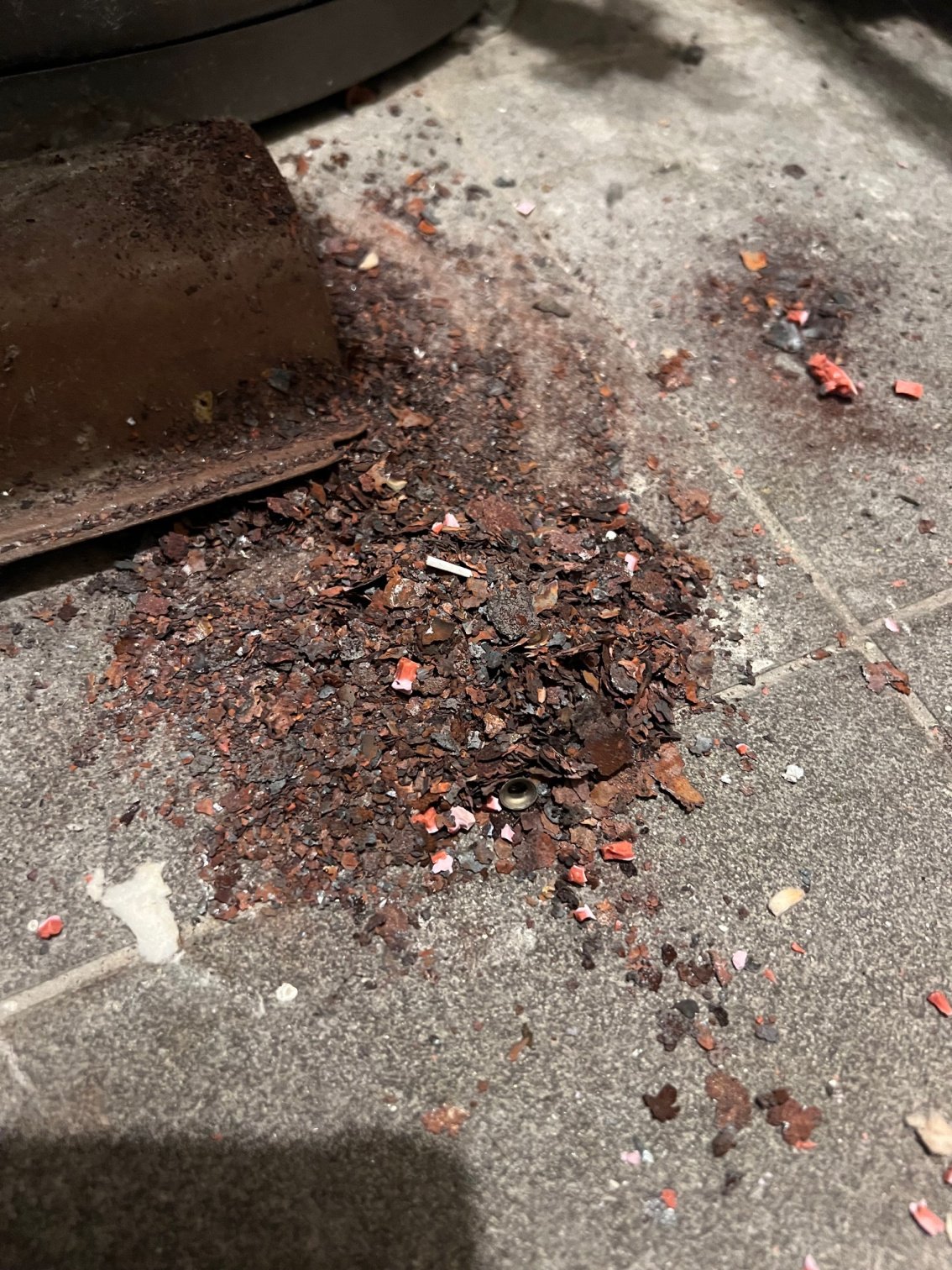

Need to replace pilot assembly on a Rheem gas water heater. Found a heapum pile of rust particles on top of the burner from the heat exchanger. What I can see on the bottom away from the burner just looks like corrosion from condensation dripping from the exchanger. Though one spot on the side does seem a little concerning.
Everything is bone dry. At least when it is cold.
Two family house. Units are 11 years old.
Water heaters and the furnaces are getting close to end of life but in what I hoped, replacement would be next year after the coming heating season.
What do you think?

  • Hi, This isn't scary. I'v often found burners with rust piled high on them, and have been able to keep the heaters going. I'd ask what quality of air are these heaters taking in for combustion air? Are pool chemicals or salt stored nearby? I would check anodes ASAP.
    Yours, Larry
    Ironman
  • Ironman
    Ironman Posts: 7,975
    No one can know for sure how long it’s gonna last, but as Larry said, I’ve seen much worse.

    got a pic of the entire tank?
    That is an odd looking seam and tube pic
  • @hot_rod ,no pic of entire tank. It's a Rheem Performance Plus. Everything looks hunky dory from the outside.
    Not sure which pic you mean. This?

    pecmsg Posts: 7,634
    1 more year leads to 1 more year that leads to 1 more year.
    start making a plan for replacement, contractor make and model
