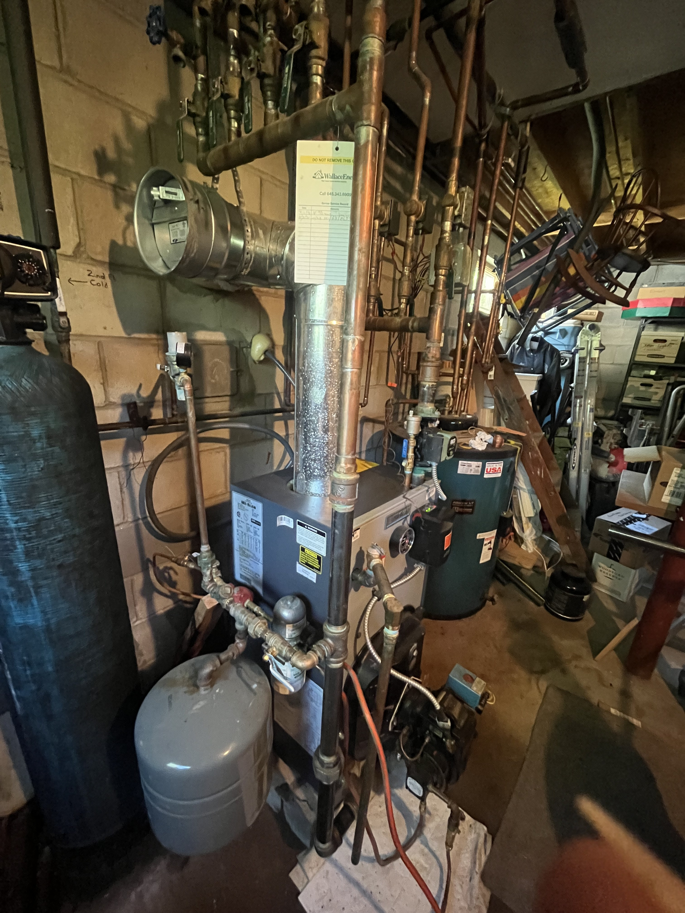

Thinking of installing a magnetic filter like the Caleffi Dirtmag or Webstone filter etc. on hydronic oil system. I need the vertical kind and they only go up to 1", but my return is 1/1/4". Can I still reduce to 1" for the filter and then go back to 1-1/4"? Is such a reduction in the middle of the return "legal?"
Also, I figure the best place for the thing is between the fresh water supply and the boiler (see photos) because then any fresh water would go right through the filter (my water has lots of minerals in it). However, it might be a lot easier for me to put it on the copper section of the return up top (going to manifold, also 1-1/4") because I wouldn’t have to worry about exact lengths of threaded pipe, but then fresh water with all its minerals would go through the system before hitting the filter; still, would it make that much of a difference?
So:
  1. Okay to reduce/unreduce?
  2. Where would you put it?
FWIW I plan to use Sentinel cleaner and then Sentinel inhibitor in the system to clean and prevent corrosion.
    what is the output of the boiler? You can reduce it if you can move the outptu of the boiler through 1". You have more than enough room to plumb in a loop to install the horizontal version.

    @mattmia2 so far I don't see the Weil-Mclain specs saying anything about the gallons of water output of the boiler, but I'll keep looking. But my Taco 007e circulator is rated to go up to 16 gpm, and AI says a 1" pipe is not sufficient for 16 gpm. No idea whether it ever really goes up to that.
    I never stretched my brain to the idea of a loop, but it is now stretching.
    A brief restriction like that filter isn't going to be a problem. And it is MUCH better to have it in the heating loop.
    Heat output in btu/hr. From that you can figure out what the flow needs to be to move that much heat.
    1" will do 8gpm or an 80,000 btu boiler

    @EBEBRATT-Ed it's 115,000 btu, so I'm thinking I shouldn't put the 1" in. However, @Jamie Hall does say the brief restriction won't matter.

    11 gpm to move 110,000 btu/hr is 4.5 fps through the 1" section, it is a little higher than what you'd design for but it will be fine for that little section of pipe.

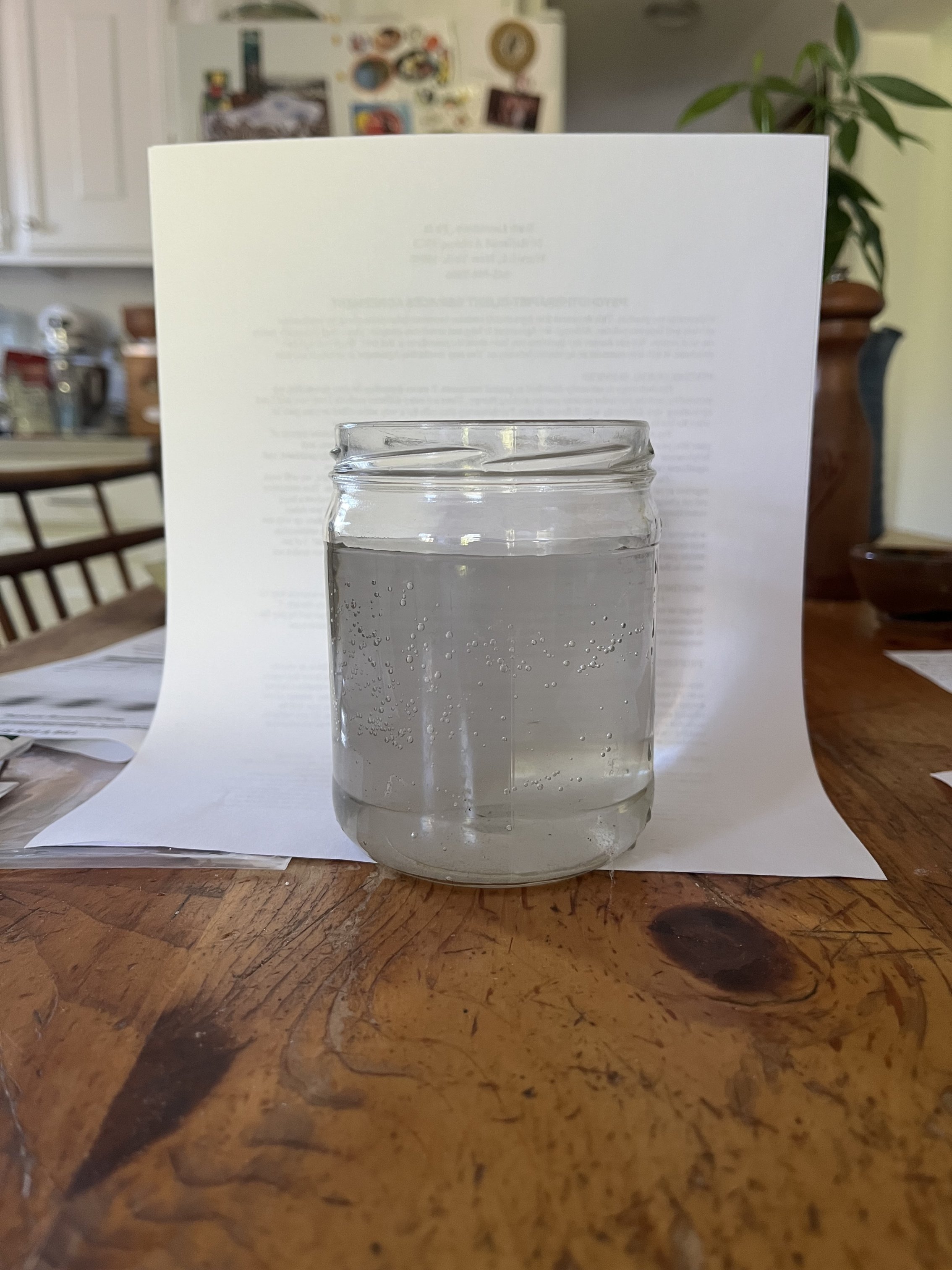

    Did you look at the water that comes out of the boiler drain at the bottom of the boiler? is it a little grey? that is not a problem that needs fixing. Actually that grey colored water is something good and you want to keep that water in the boiler. IOf you are getting thick mud out of the boiler drain, then you have a leak that needs to be fixed because that leak is causing new fresh water with all that oxygen and minerals that are causing that much mud to accumulate over one heating season.
    Open the boiler drain and let about 1 cup of water out into a container then look at the color of it (use a clear plastic or glass container to look thru the water). Take a picture of it and show everyone here the water that you removed from the boiler after 1 year of operation actually looks like. I want to see all that mud you are trying to remove with the DirtMag. I bet there is no mud. OR After you install the DirtMag… next year you can look at the accumulation in that filter and let us know if it was actually necessary.

    Lots of great stuff to reply to here, and I will later. But first, as per @EdTheHeaterMan’s suggestion, for the very first time to the general public, a photo of the thick black sludge that was only in my mind, not the boiler, after a year of operation. This is with the small leak on the supply.
    (Given this nice gray water, would it still be worth it to treat the system with cleaner then inhibitor like Sentinel’s X400 and X100 or another brand? The system will be open soon to repair that leak, however if that repair is all I do I’d just have to drain enough to get below the supply tapping — zones closed — which is a lot different than draining the whole system and refilling with all that fresh oxygen. Another possibility is just to use the inhibitor, in theory Sentinel’s can be injected with little or no draining.)

    Oh but wait… You don't have any cast iron radiators, and all your pipes are copper, and your sludge filled cast iron boiler doesn't have any sludge. I might not see that spending any money on chemicals to fix a problem you don't have will benefit you today. IMHO from a boiler installer for over 40 years.

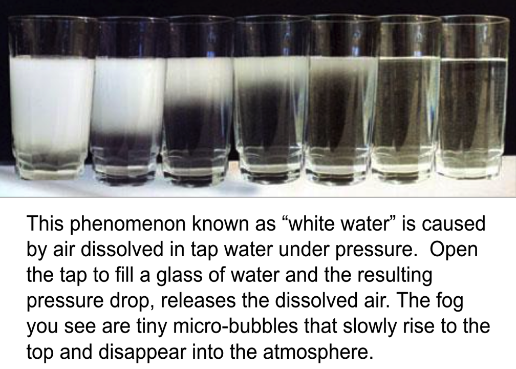

    But I do see that there is some air that was dissolved in the water under 12 to 18 PSI pressure. now that the water is at a lower pressure, that air has formed some micro bubbles that have merged with other micro bubbles to form actual bubbles you can see.
    Here is a slide from my powerpoint presentation that explains how a drop in pressure will release air from being dissolved in the water. The series of photos of the same glass appear in succession, represents the same glass photographed over a few seconds of time showing the cloud of micro-bubbles getting released from the lower pressure water and then vanishing into the atmosphere as air.
