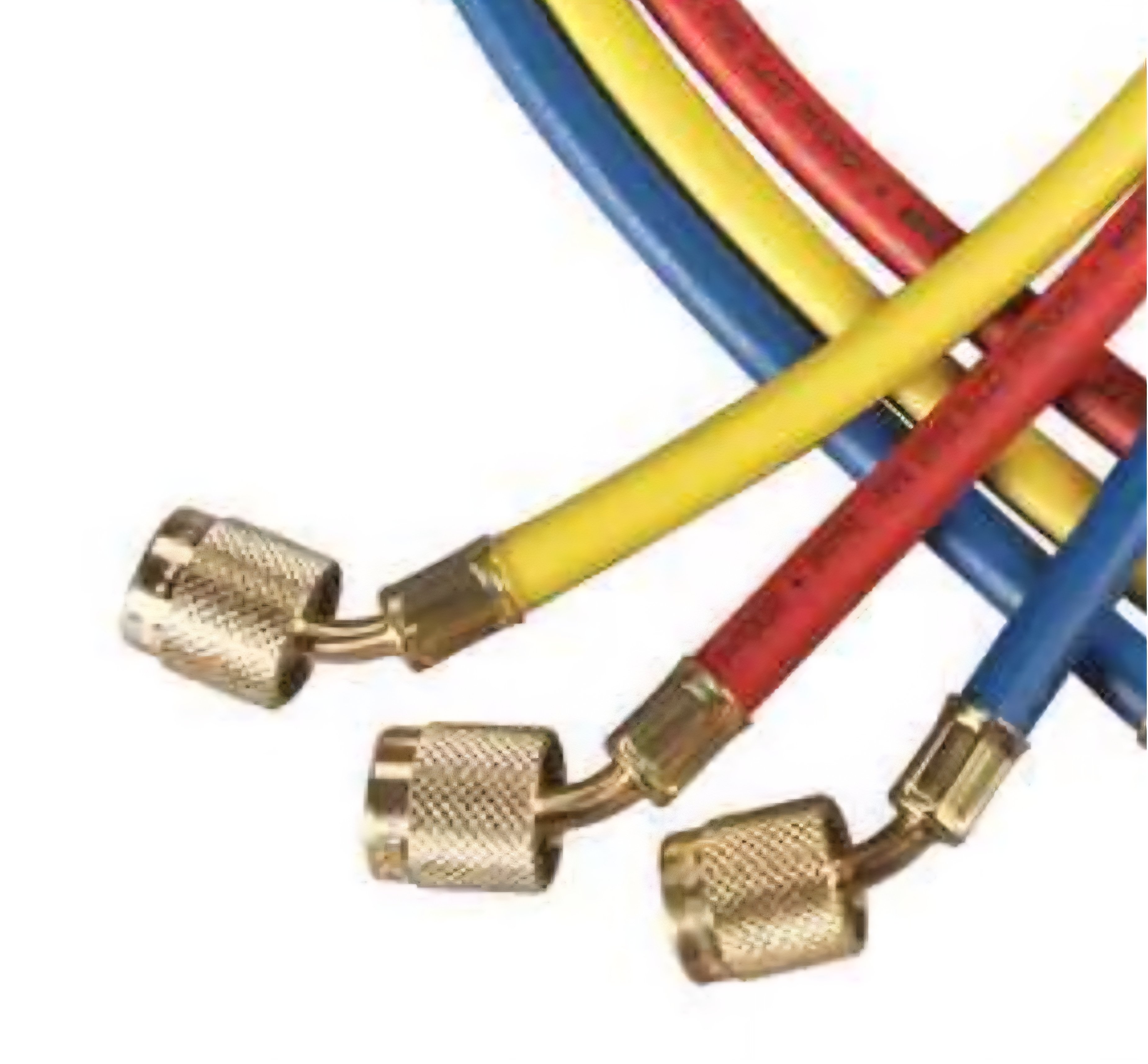

Wouldn't it make sense to have a built in pressure gauge on the high and low side. Located inside the outside jacket just before the king valves? It would reduce the odds of people attaching gauges to troubleshoot issues. Every time gauges are attached there is a loss of refrigerant.

    Try these.
    Less loss than a fly fart.
