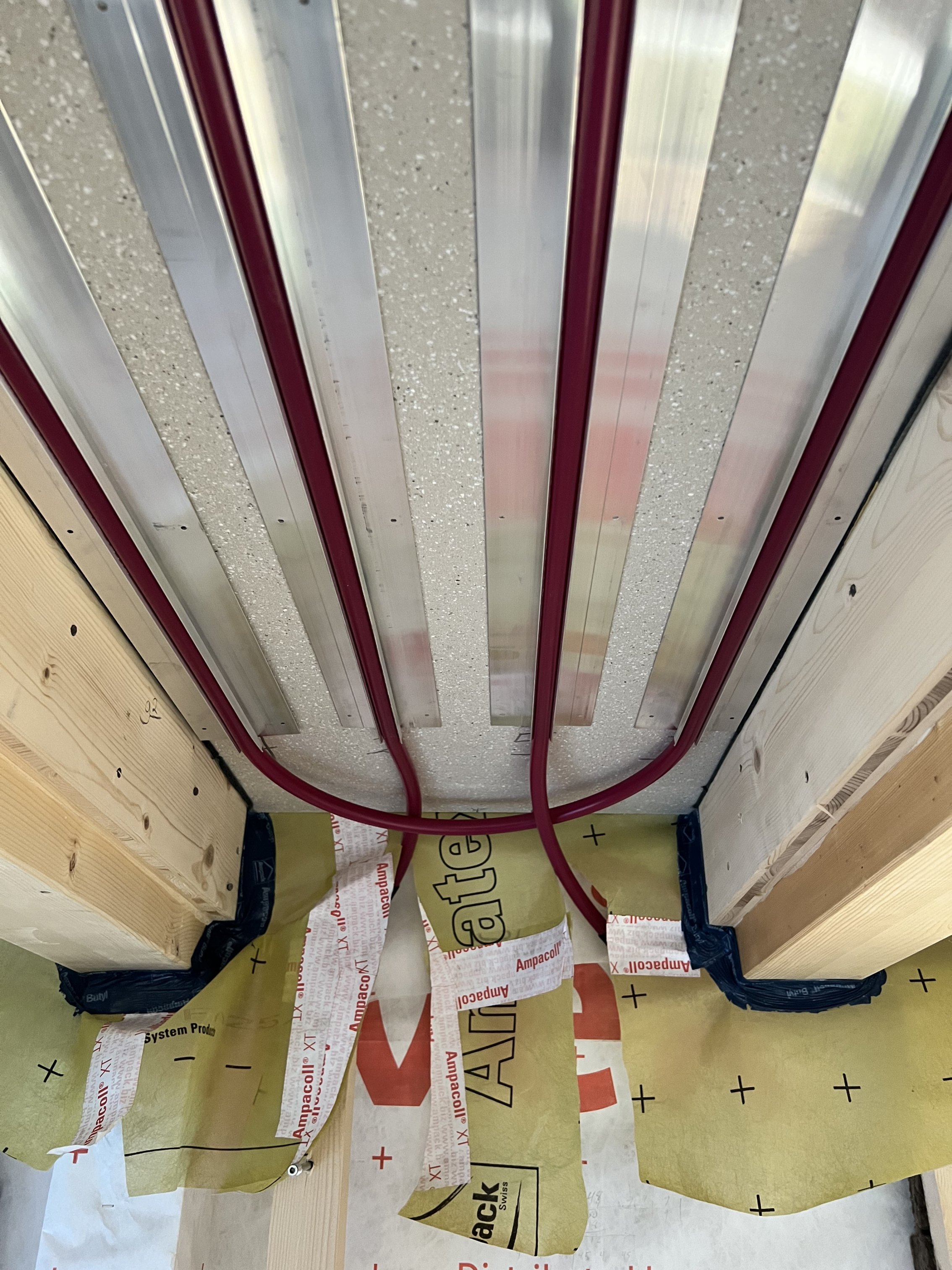

    I completed some of project with the „under-joist“ method…
    Really like it because:
    1. Don’t need to prepare by pre-looping (?) the needed length into each joist cavity. Can simply lay the tube coming directly off the roll.
    2. My joists are 5 inches wide of solid pine so a lot to drill through.
    The photo shows an example.
    Unfortunately the yellowish vapor barrier obscures the tubing routing. But from left to right:
    Feed line comes under the left joist
    Tube placed into track 2, water flow towards the viewer
    Tube placed into track 4, water flow away from viewer
    Tube placed into track 1, water flow towards viewer
    Tube place into track 3, water flow away from viewer
    And so on…
    The „non sequential“ order of placing tube was to broaden the loops in the tube to make installation easier, eliminate kinking in loops, makes exit and entrance of joist cavity more gradual.
    Used Rehau RauTherm Neo X5 16mm (1/2“) for tubing and Uponor Joist Trak for heat transfer.
    Project is in Switzerland

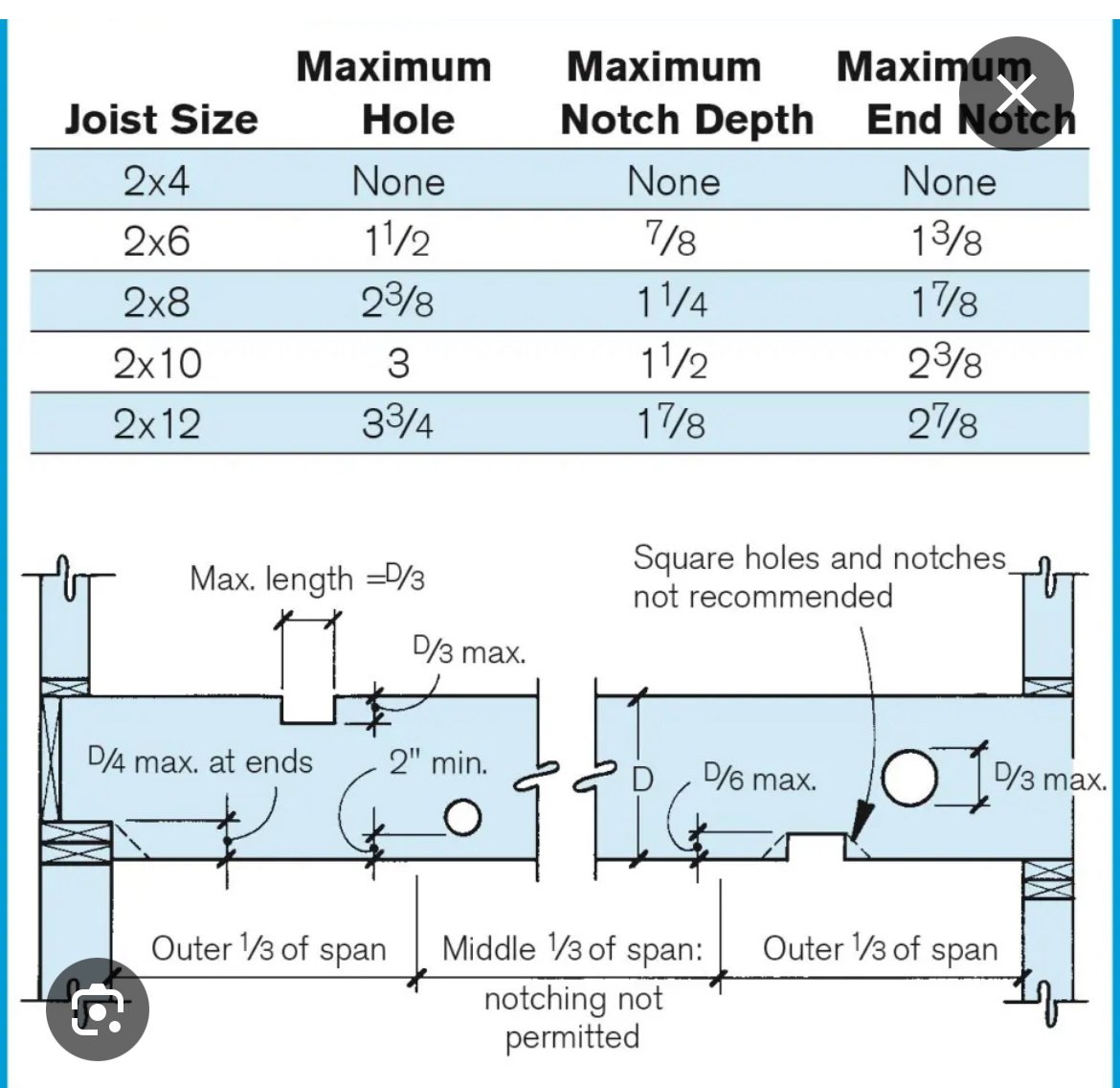

    if that is a standard joist size, you could maybe find a hole drilling chart. Typically you do not want a hole near the bearing point of a joist
    Code around here asks for fir or hem/fir for structural framing members.
    Around here we use a 1-3/8” hole for pex, which allows room for an insulator around the tube

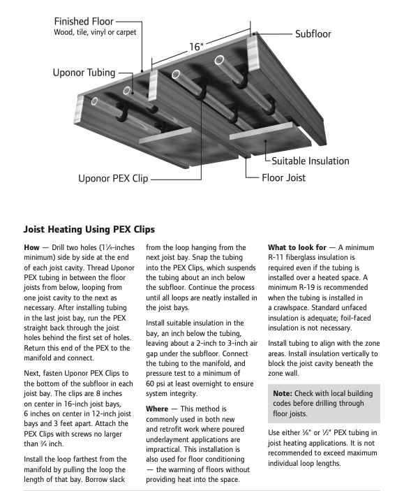

    This is a common UltraFin installation method when joists cannot be drilled

    The suspended tube, aka joist bay heating, convection system design left an air space above and below the tube to get currents moving. Same with the UltraFin system

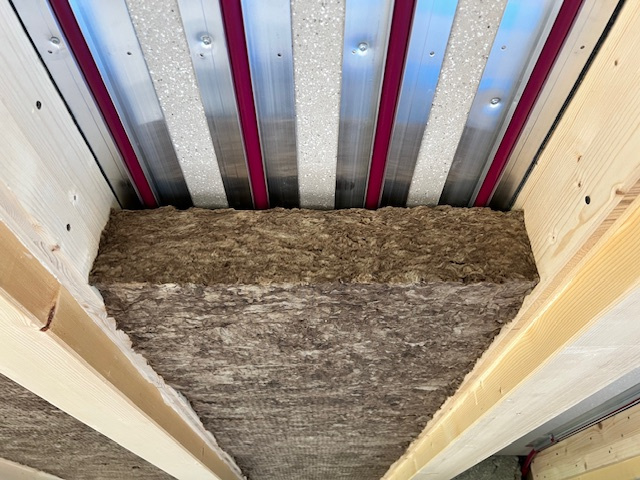

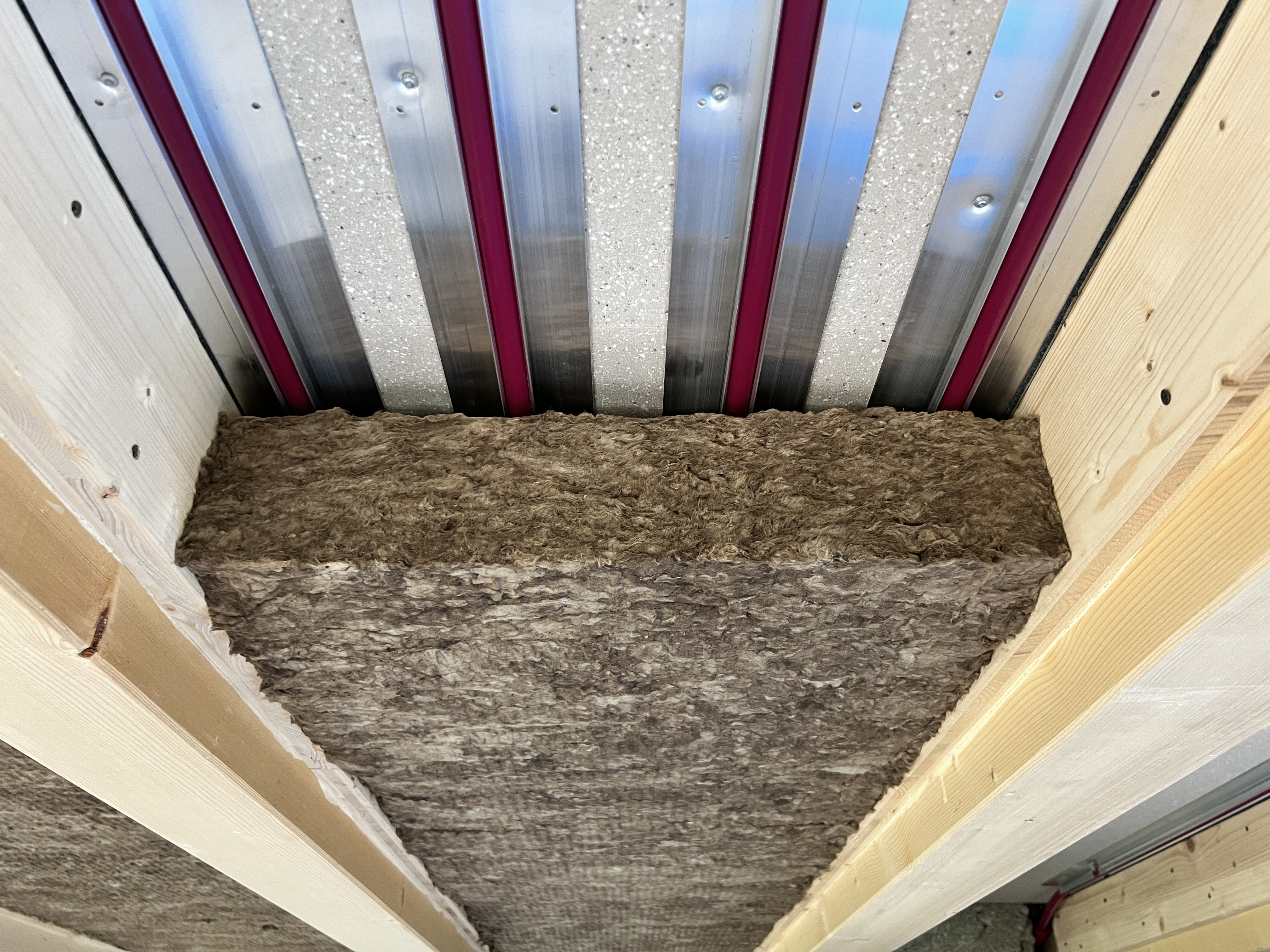

    Always part of plan but not mentioned detailed: Presence of ~4in of mineral wool (brand FlumRoc) with R value ~16 with snug fit between joists (see photo). That is to help send the heat „up“ into the subfloor and not down to ceiling.
    So, from top ("0" layer) to bottom ("-5" layer):
    0) Floor finish: 0.6 in wood parquet, but ceramic tiles in wet areas. (est. R value of wood: ~0.6)
    -1) Subfloor: 1.1 inches Gypsum fiber board (28mm Knauf GIFAfloor, R value: ~0.4)
    -2) Heat transfer plates: 1/2“ Alu c-clamp plates (Uponor)
    -3) Pipe: 16mm, O2-barrier (Rehau RauTherm NEO-X5, 0.63 inches OD)
    -4) Insulation: 4 in Mineral wool batts (10cm FlumRoc with R value of ~16 h•ft2•F/BTU)
    -5) Sheetrock: 5/8“ sheet rock for 21“ span between joists (R value: ~0.6)
