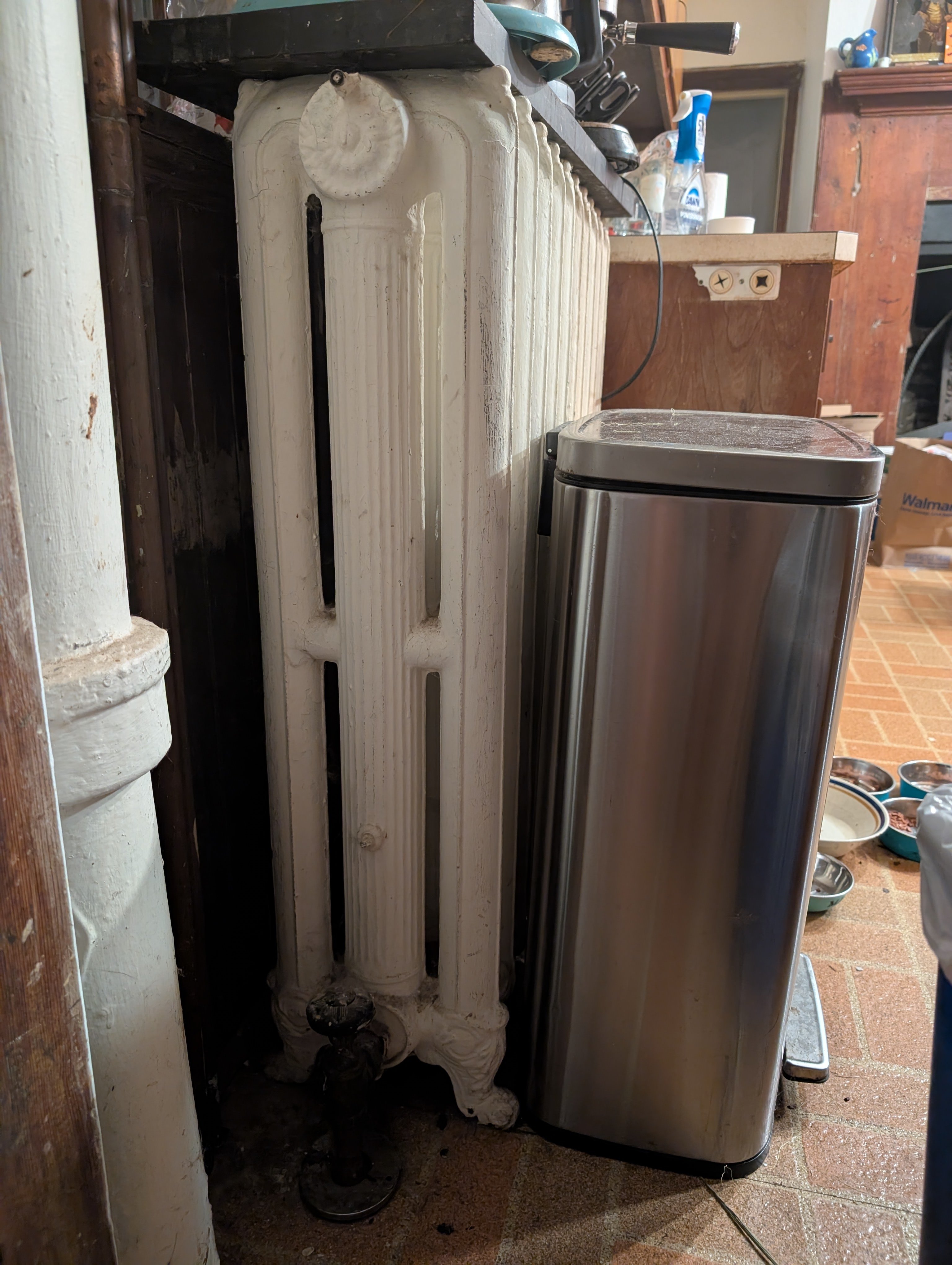

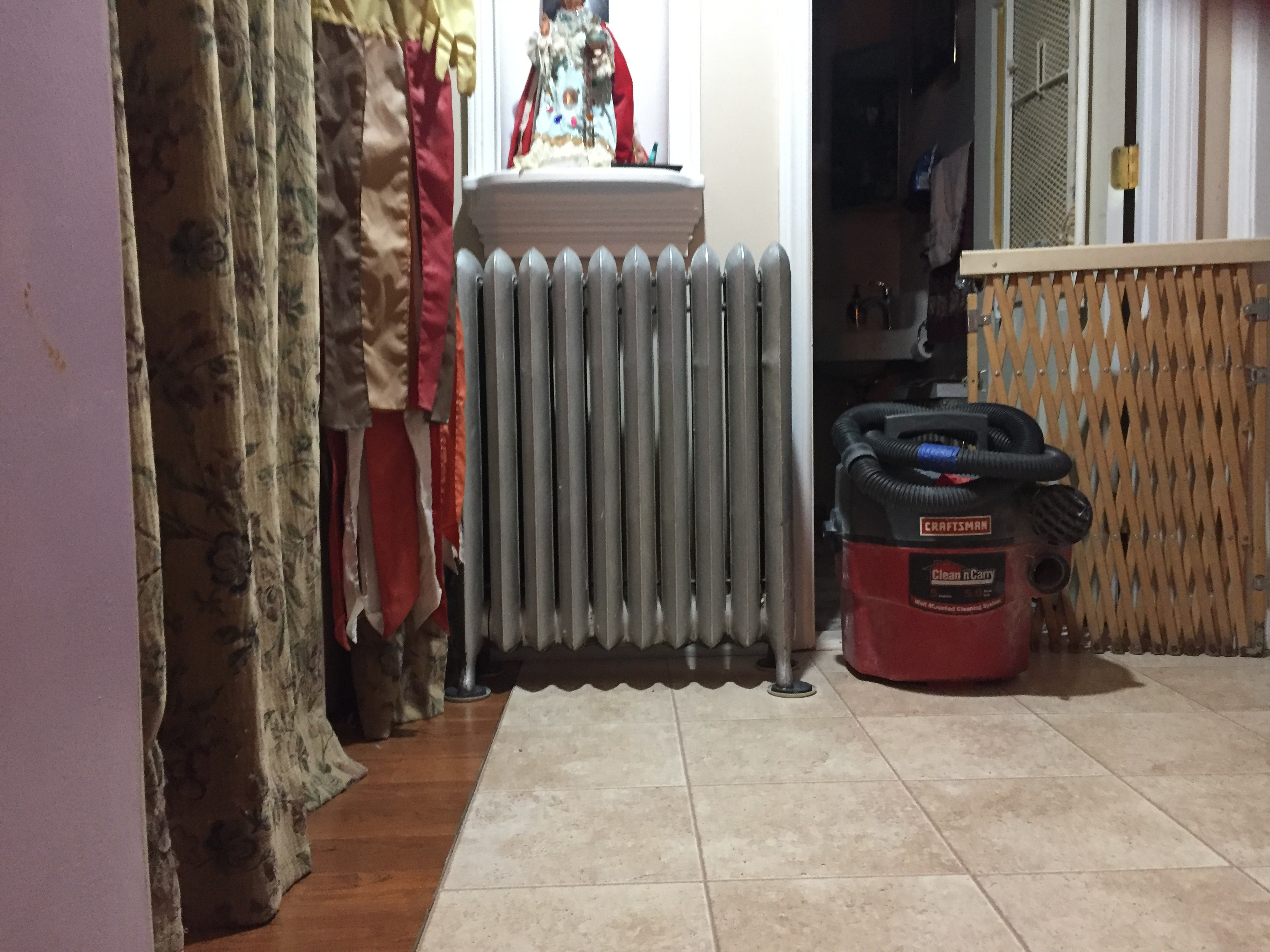

    @amaiale , take a pic from the end of the radiator so we can see what type and capacity are the sections it uses. Also how tall is it?

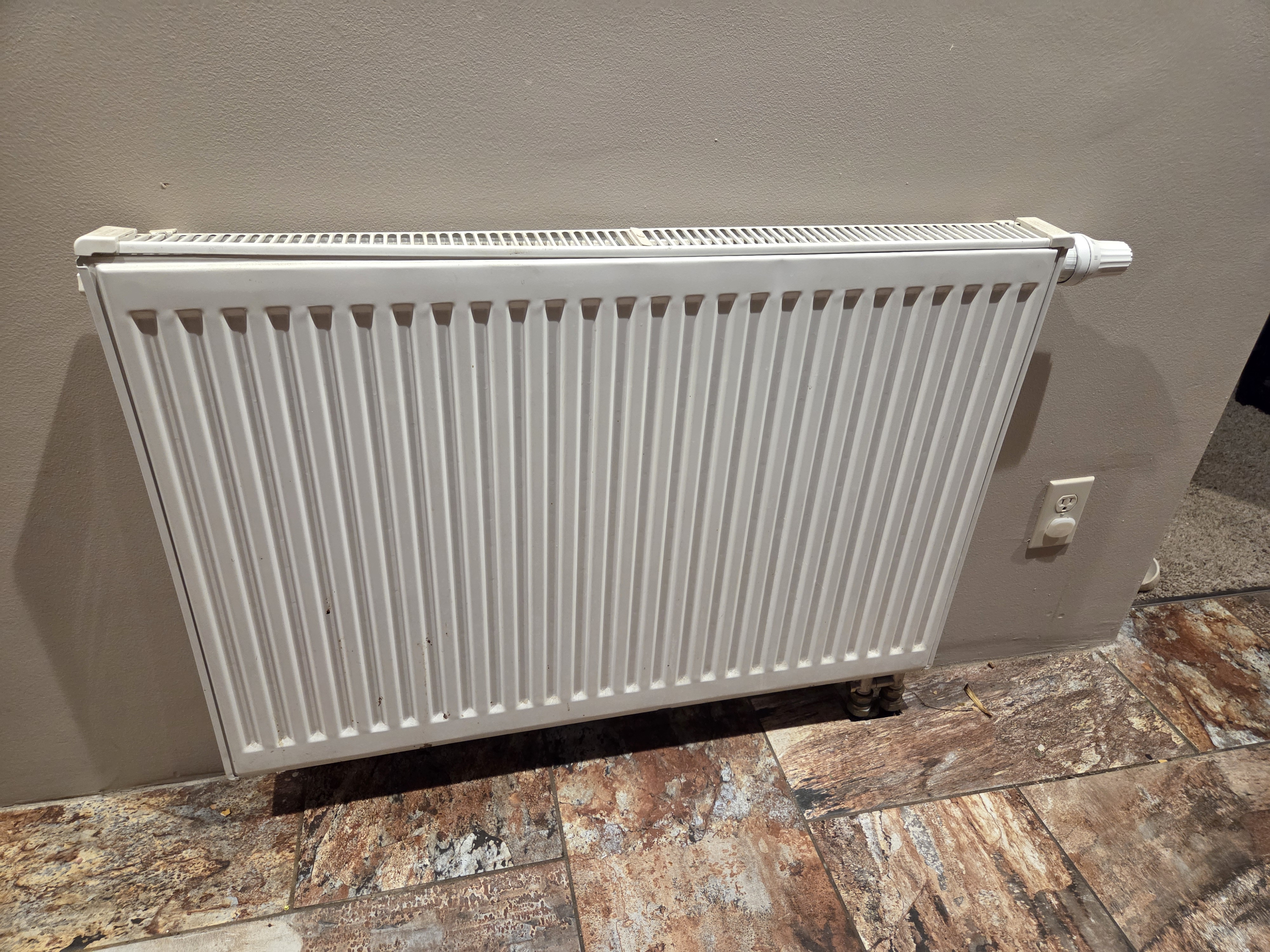

    I understand we can't replace it with a compact aluminum radiator because that would require a lower temperature. Any advice?
    who told you that? Also you could use a steel one (also lightweight).
    mattmia2 Member Posts: 17,905
    steel radiators or other low mass radiators will heat differently and will be very difficult to impossible to balance with the rest of the system unless they are on a separate zone which would present other problems because of the small size of the zone.

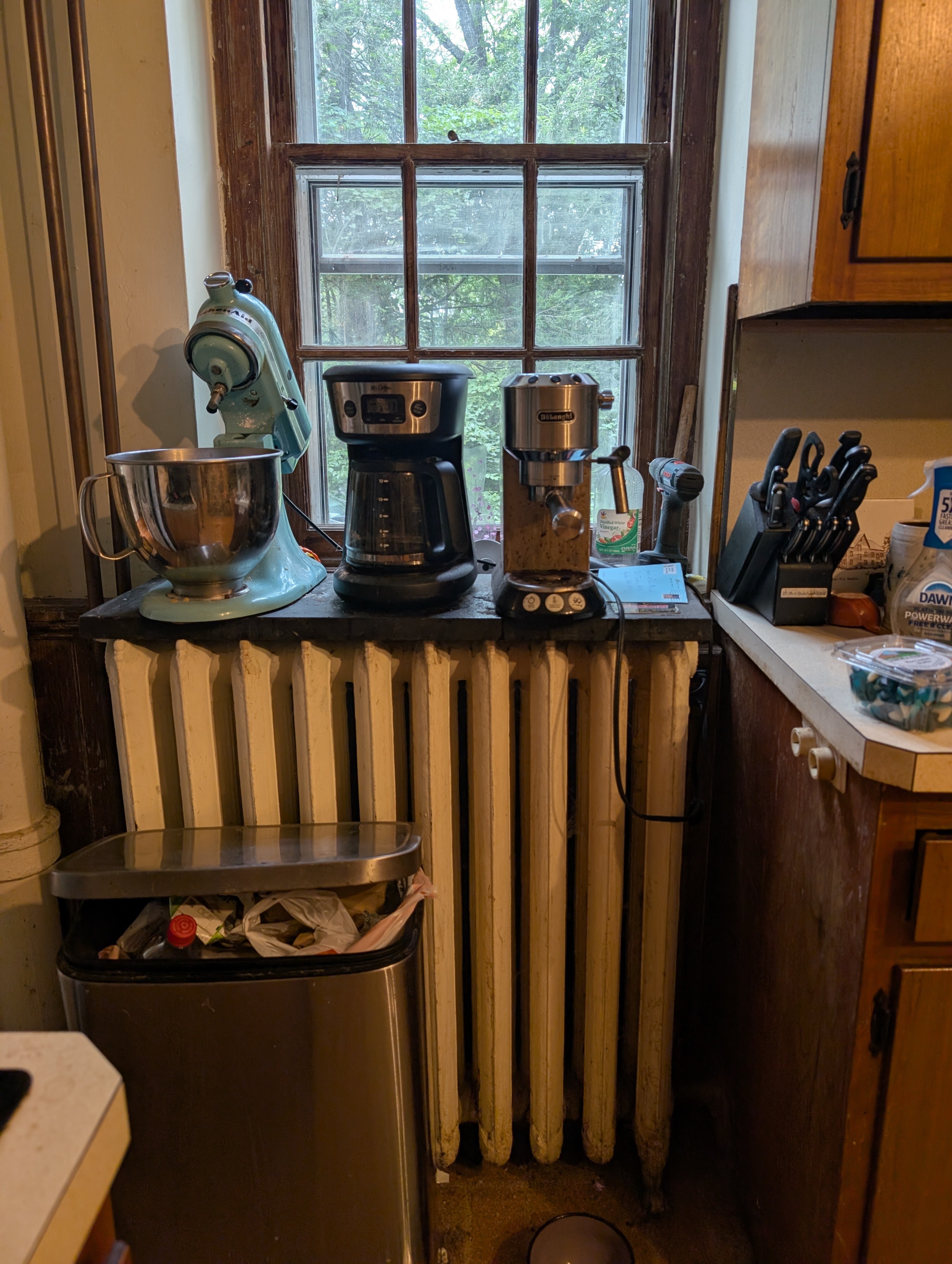

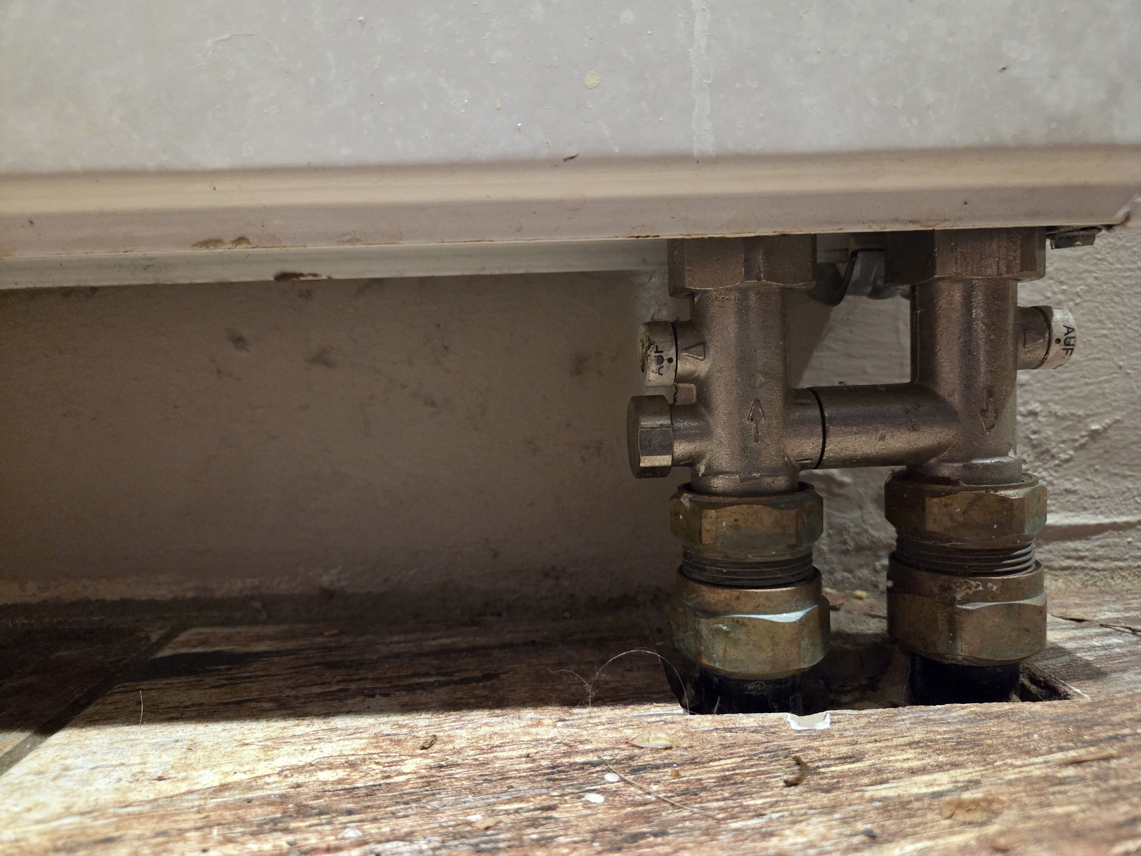

    Let me know if this photo doesn't show you what you're looking for. It comes up just a hair above the countertops, so maybe 37"?
    Ooh, I'll have to see about those. The current kitchen layout calls for about 6" of additional cabinetry (so we have room for a trash/recycling pullout next to the sink) that would basically push the radiator over by that much.

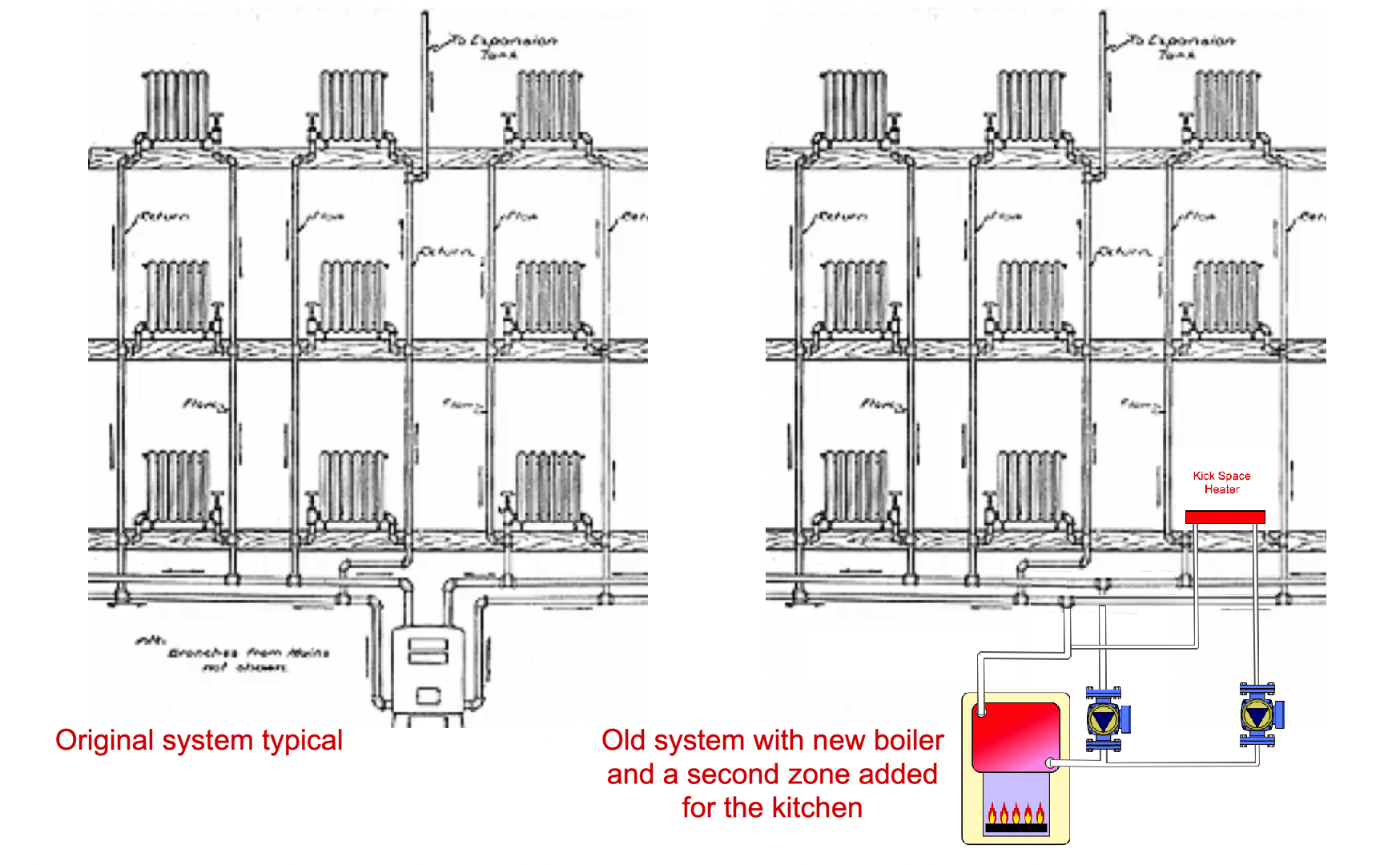

    How is the radiator connected to the rest of the system? I might suggest that your system was originally heated by a coal boiler without a circulator pump. the current boiler has a circulator pump. if that is the case there are other options for your kitchen.
    You may be able to eliminate the radiator completely. Cap off both the supply and the return in the basement. (Now you have no heat in the kitchen, so you will need more kittens).
    Install a separate zone for the kitchen using a Beacon Morris Kick Space Heater, or similar product. This would operate from it's own separate circulator with an Internal Flo-Check (IFC). you will need to install a flo check on the other system so when one zone is calling for heat the other zone does not over heat. But it is do-able.
    Here is a diagram of what it may look like before and after the radiator is removed. Depending on how important the radiator removal is, adding a separate zone and kick space heater may be worth the investment.
    Some inexperienced contractors may just try to replace the old CI rad with the Kick Space using the existing gravity flow piping design. It may even work in some rare cases. You do not want to mix different types of radiators on the same zone. That is why I recommend the separate zone in order to accommodate the different heating characteristics of the different heat emitters.

    That's an H.B. Smith Imperial 3-column rad (see page 76 of @DanHolohan 's book "E.D.R."). Whereas the usual 3-column unit is rated 5 square feet EDR per section, these are 6-1/2. So this rad is rated 65 square feet, or 9,750 BTU per hour when the boiler is at 180 degrees F.
    Since all the rads in the house were sized using the same method, if you install a rad in the kitchen with less capacity, the room will be cold. You have to work within the parameters the original installers used if you want it to work well.
    If you can find a used four-column, 8-section rad that is 38" tall, or a 6-large tube, 11-section rad of the same height, it will carry the load while taking up a bit less floor space, though it will probably stick out from the wall a bit more.
    Also, do not reduce the pipe size to the radiator. or the water will not circulate well. Again, all the piping was designed the same way, and if you add resistance by using smaller pipe, the water will go elsewhere.
    The easiest way out of this would be to leave the rad as it is, and rework the cabinet design.

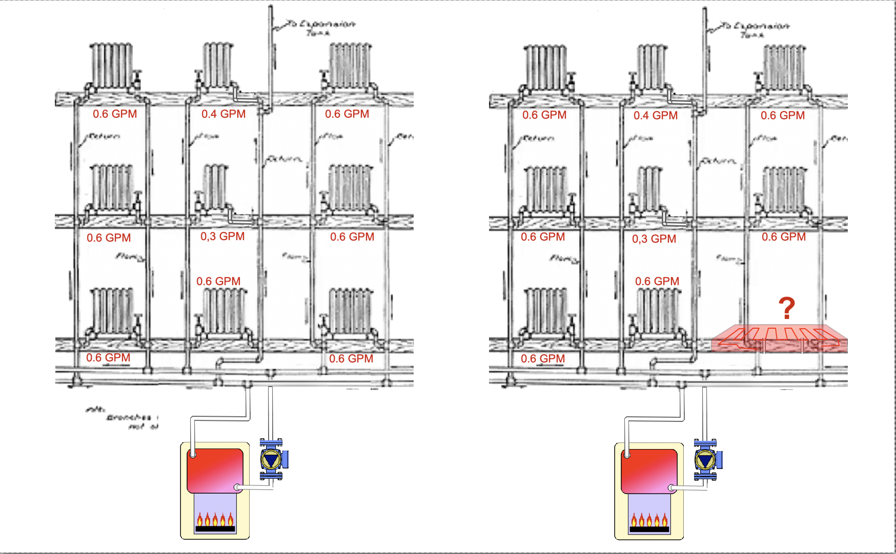

    edited August 2025
    That may work when you design the entire system to use the same tubing and ultra fin and have each loop properly sized to match the rest of the pressure drops of the other loops. Your statement about just using the 3/4" or 1" or 1-1/4" supply and return from the removed CI radiator, and the same circulator, and the same thermostat is what I have a problem with. As I said previously, "It may even work in some rare cases."But in this case I believe this is bad advise. How do you make sure that the 1/2" PEX tubing gets the proper amount of flow?
    Assuming the system on the Left is operating properly and is relatively balanced. When you remove a gravity designed cast iron radiator that has very little resistance to flow, and replace it with 100 to 200 feet of 1/2" PEX tubing, there is not going to be enough pressure differential to successfully move the GPM necessary to heat the floor. I guarantee it!
    This is why I have a problem with your advise to @amaiale. Unless you are going to actually do the job and guarantee the result, then this advice is not in the best interest of our fellow Wallie. Just my educated and experienced opinion.
    No offense intended @Kaos. I just want the facts out there and the best advise for the members.

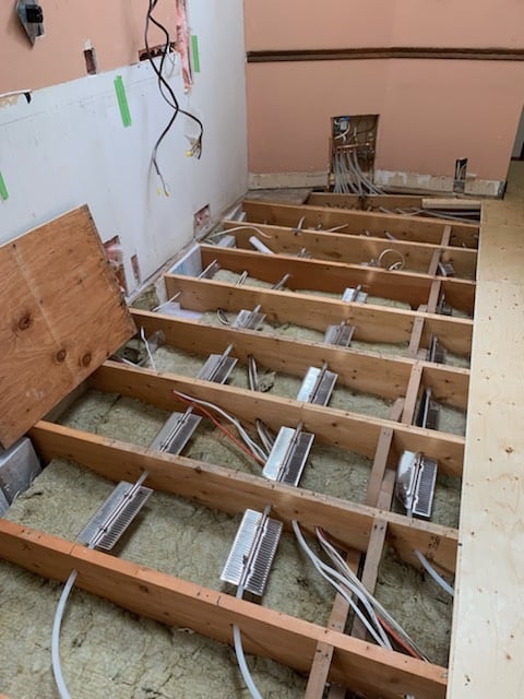

    @EdTheHeaterMan Here is the install I did a while back. This is a pumped gravity conversion with modcon so lower temp.
    Not the best picture but you can see the manifold in the wall, there are 4 parallel loops to reduce the pressure drop. Total needed was only 0.6 GPM so pressure drop is tiny as each loop is also pretty short. Flow is not an issue as delta T is less than 5F across the pipes.
    The important bit (which you can just about see) the the rigid insulation installed by the rim joist sealed in place with canned foam. This type of setup won't work properly if that is not done.
    This can be made to work with any setup (maybe not with a true gravity one) as long as there is a bit of upfront design.
    I understand how to make an insulated plenum out of each joist space by insulating the rim joist to form a cavity without any possibility of air movement in and out of the heated plenum of the joist space. This is important with most designs of staple up and Ultra Fin.

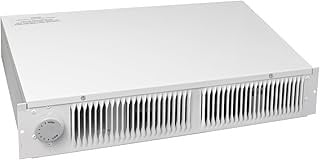

    A second option is a kick space or toe kick heater, which is installed under your cabinets. These are designed to free up all the wall space needed for the new cabinets. You can install more than one of these in your new kitchen as needed. Properly sized for your required heat load, they are a good option. Dust can blow around a bit if not used often. If you own a vacuum cleaner, this should not be a big concern 😉.
    They are offered in different colors. Here is an example below.
