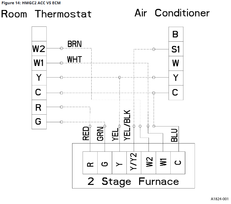

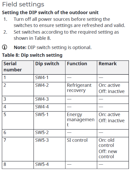

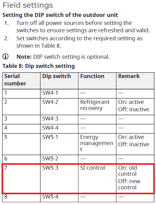

    In the manual S1 and SI seem to be the same, however I not sure if that is so. Two S1 modes ? Dip switch SW5-3. Looks like the S1 may be an output from the condenser unit that controls the blower speed by monitoring system conditions or just time. In which case the Y2 from the NEST may confuse things.
    PeteAdxfhczz

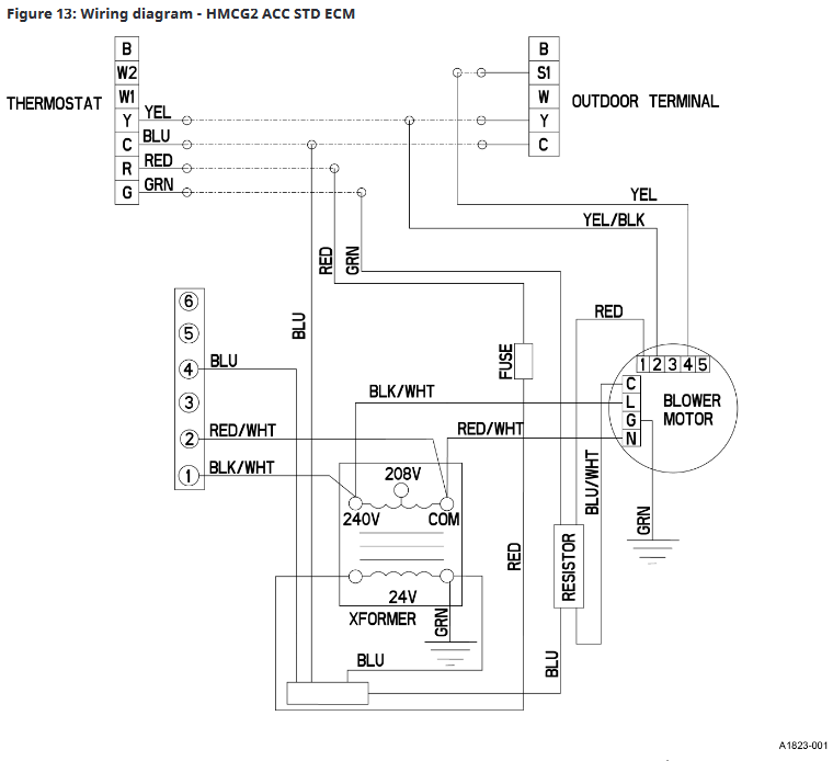

    What you see in the bottom diagram from @109A_5 is accurate, the unit outside only gets 3 wires from outside to the inside furnace control board.

    Not sure what that mode Dip switch SW5-3 does , maybe switches between ECM motor control (newer way) OR utilizing a relay on the furnace's control board switching the motor speed (old way).

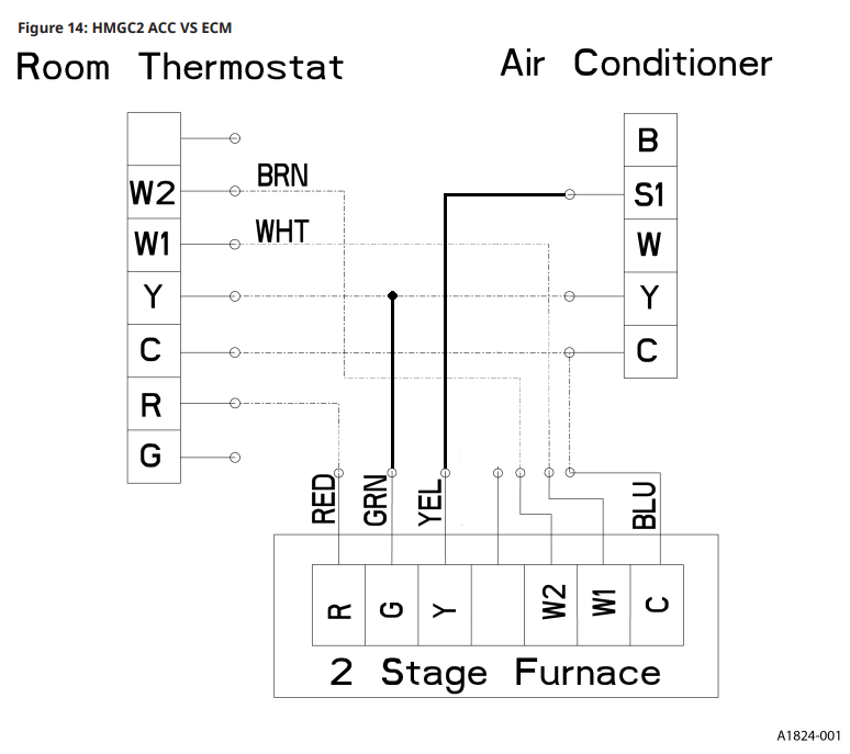

    Anyway maybe this wiring is what you were saying in your post (image below), I got a bit confused it was late. Depending on what the terminal S1 actually does (logically) the G and the Y wires (diagram below) may need to be switched at the furnace.
    Not sure with the OEM drawing above S1 to Y/Y2 who is the signal source S1 or Y/Y2, which is the input and which is the output ? If it is the furnace is the output, it is probably timed by the control board, if the signal source is the modulating condenser unit it may work from the line temperatures to determine the system load and modulate its self and then the evaporator blower fan accordingly. Which to me is what the ACC STD ECM drawing above implies. However in this case you would be working with the ACC VS ECM diagram which I modified below. There may be other ways.

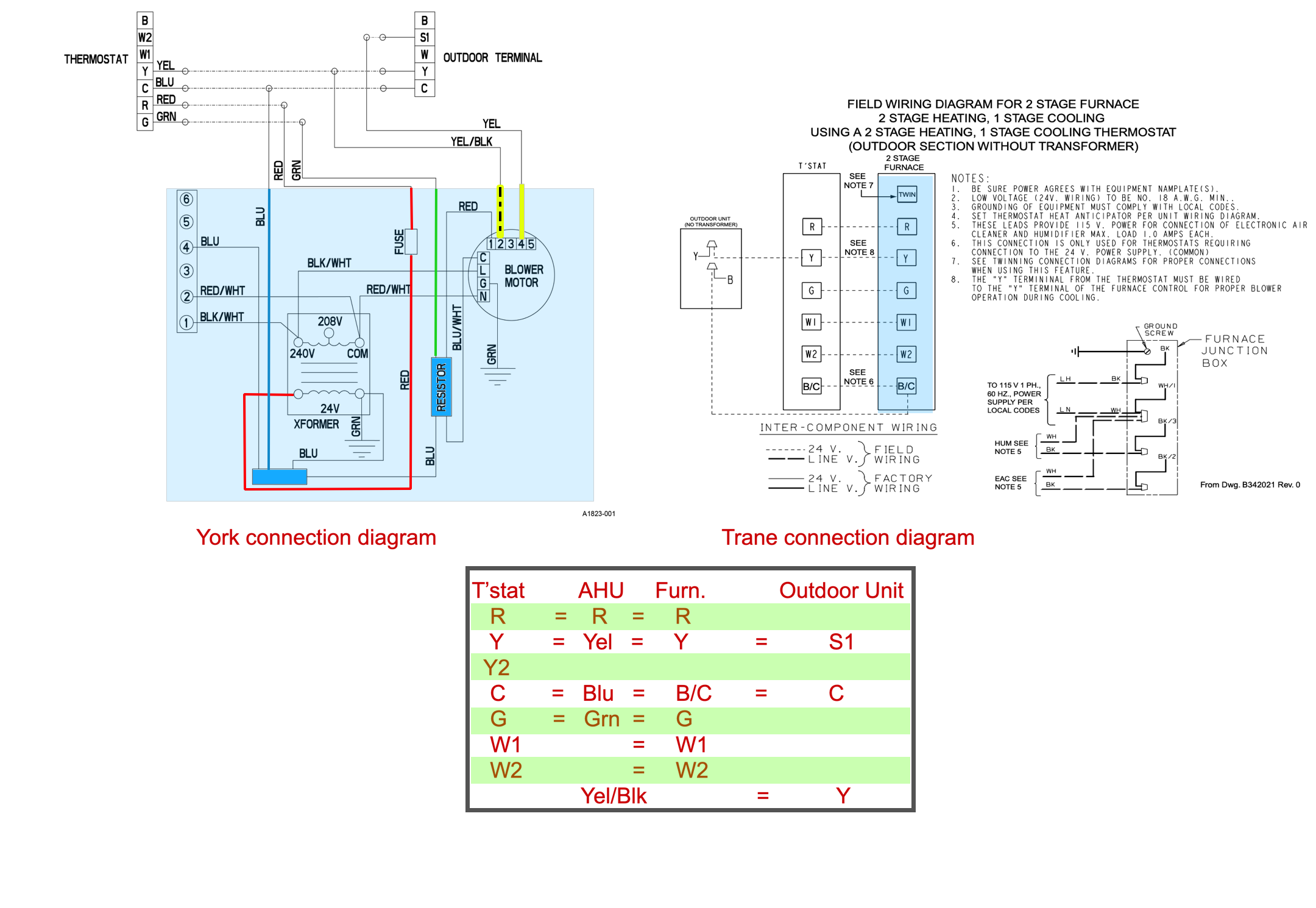

    Did a little research on the Trane 2 stage furnace and the York Vari speed condensing unit. There is more to operating that compressor as a vari speed than just connecting a high and low (Y1 and Y2) from the thermostat to the furnace and the AC unit. You really need to find a matching York Furnace that can accommodate that third SI wiring terminal on the Condenser.
    In this diagram, the blue shaded area is the wiring connection for the air moving unit (Trane furnace or the York AHU). You can see that there are several missing pieces. There is nothing that you can connect the S1 of your York unit to, on the Trane furnace. Trying to operate the York in a vari speed is impossible unless you have the two yellow wires that are connected to the vari speed motor. The S1 is not a "on off" (24 VAC = on and no voltage = off) terminal like all the other wires of the electrical system. The S1 is communicating the compressor speed to match up with the indoor blower speed.
    I don't believe you are going to get what you are looking for with a Nest, York vari Speed and a Trane two stage. They don't speak the same language.
    For now you may get the York to operate as a full on / full off condensing unit. But you really need to look into getting a matching York furnace that will operate the vari speed compressor.

    Kind of wondering if this provides backward compatibility for 2 stage AC. looking at the wiring diagrams above, I see nothing that implies the thermostat is in control of the 2 stage operation. Just a call for AC or not. If there is a call for AC, the outdoor unit is in control, and can change evaporator blower speed as needed.

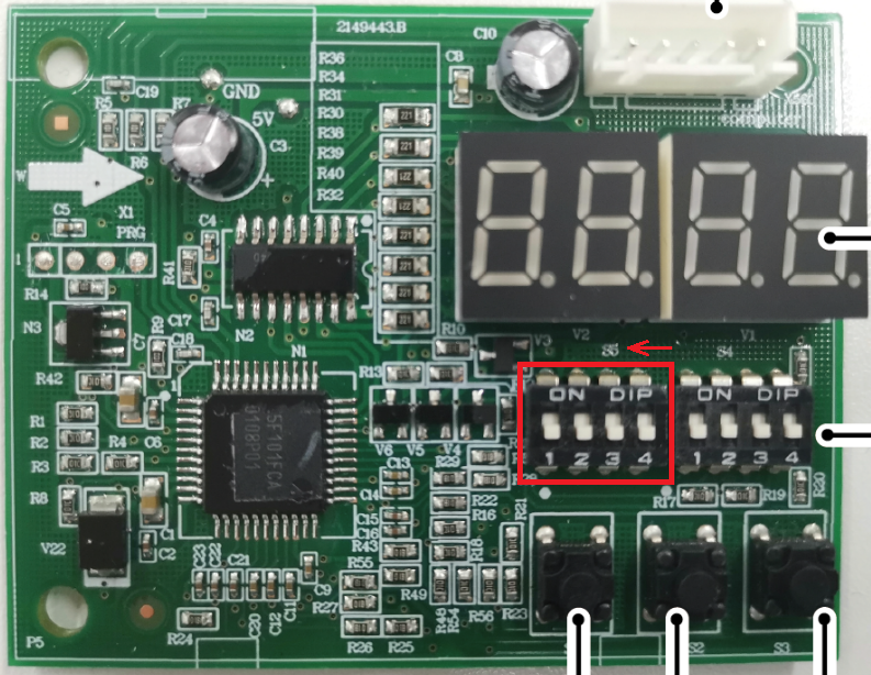

    Seems there maybe different board versions, this is one example.
  • PeteA
    PeteA Posts: 328
    @109A_5 Thanks for the additional info. I also obviously am not sure because I assumed most of the logic of ramping up and slowing down the condenser speeds would be controlled by the onboard logic as the sensors built into it would measure all of the outgoing temps and pressures on the line sets and adjust accordingly. It also seemed to me that the 3 wires coming in from the outdoor unit was to simply detect a low or normal call for AC which was why I had hoped to utilize the "G" position as the possible "low" but when @ratio pointed out that it looked like the wire was an "output" only it stumped me a little whether that "output" would be the 24v to trigger the Y contactor on the furnace control board or not. I will have the opportunity to try and test different things once my buddy helps me with the final connections of the lineset.
    The picture of the circuit board is very similar to what I saw when I was wiring up the condenser, I didn't think to take a picture of it yet because i was only connecting the power and low voltage wires not adjusting anything at the time.

    This is exactly how the York system works. the Logic of the PCB on the York condenser will optimize the compressor speed outdoor fan speed and adjust the indoor blower speed to complete the operation of the system to the most efficient use of electric power. The problem is that there is no standardization of communicating control systems, so the York will not talk to the Trane. They speak different languages.
