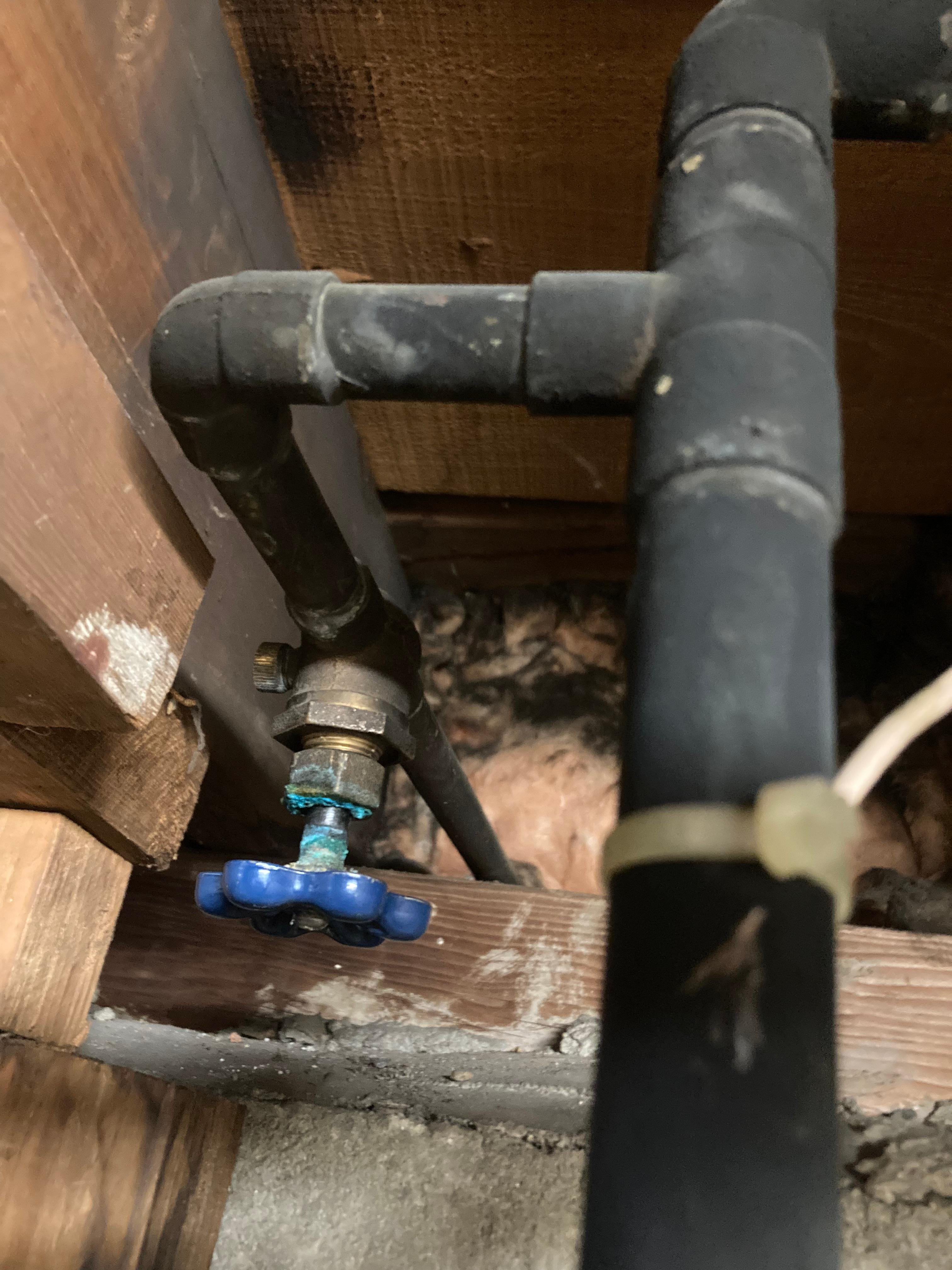

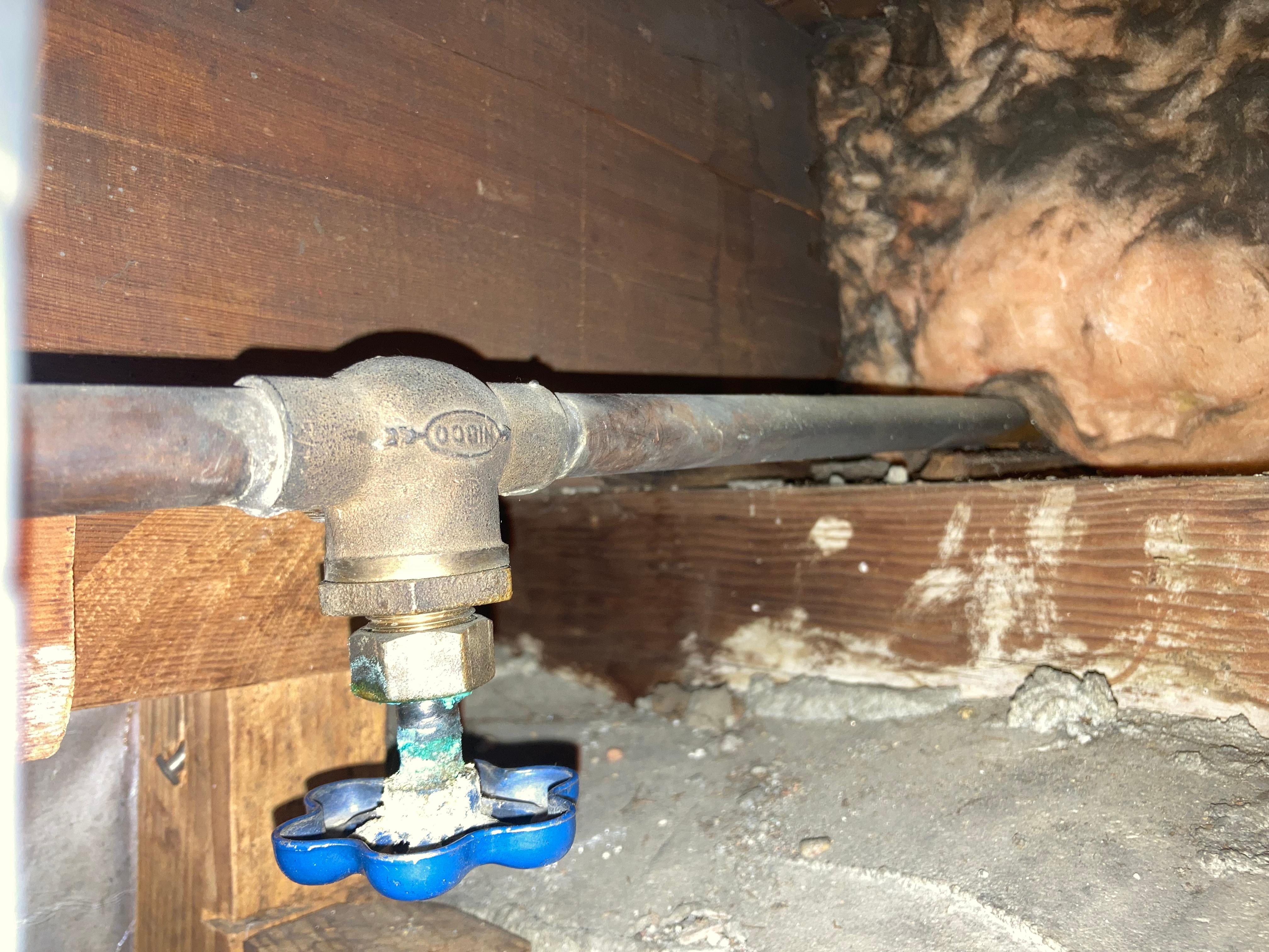

I'm going to have to replace both my sillcocks which are over 60 years old and are leaking from the stems when I open them. I could probbaly try to scrape the paint off the compression nuts and tighten them, but this is my opportunity to replace them with frost free ones.
One of them is connected to copper pipe but the other one is connected to a lead pipe (black appearance, non-magnetic, when I scrape it it reveals a gray surface below)
The copper one I will replace with a propress ball valve and a frost free sillcock which I will attach with propress compression fittings.
What can I do with the lead one? Are there compression fittings that let me go from lead to copper/brass etc? The lead pipe has a 0.63" OD.

    can you take a few pictures? lead supply piping would be more like 100+ years old. I would re-pack the sillcock unless you're prepared to start replacing until you get to something that isn't lead. the way to connect to it would be to wipe a brass or copper pipe to it and connect that to your fixture but 100 year old lead will be brittle and have a ton of oxide that will make that very difficult.
    are you sure it isn't steel or brass or copper tube?
    how is the other end of the pipe connected?
    you could maybe use a dresser type coupling but the od of lead pipe is usually pretty irregular.

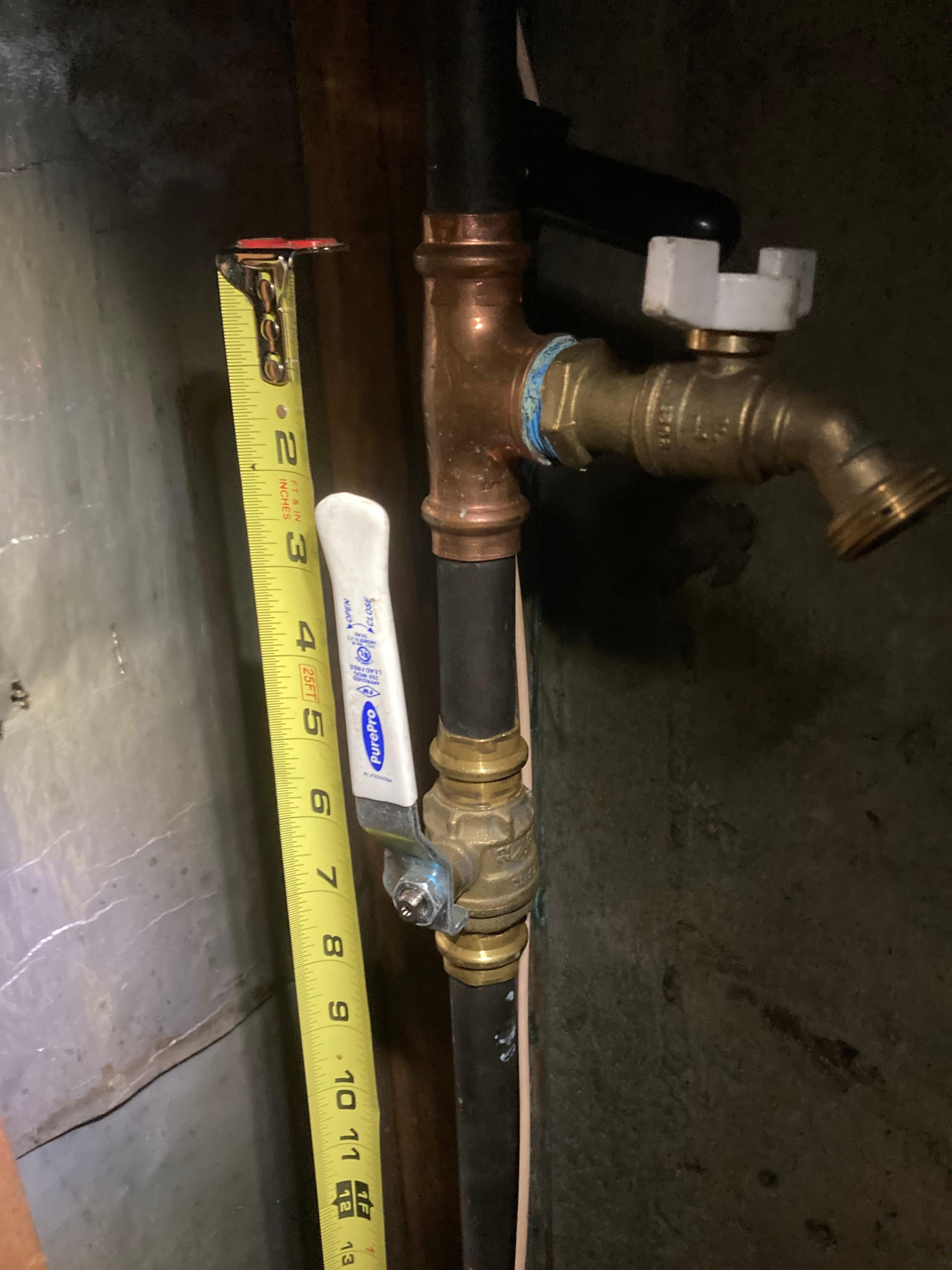

    Here are some photos of the relevant pipe(s)
    This bit is just after the meter. I had a plumber put in a cutoff and he seems to have used propress fittings.

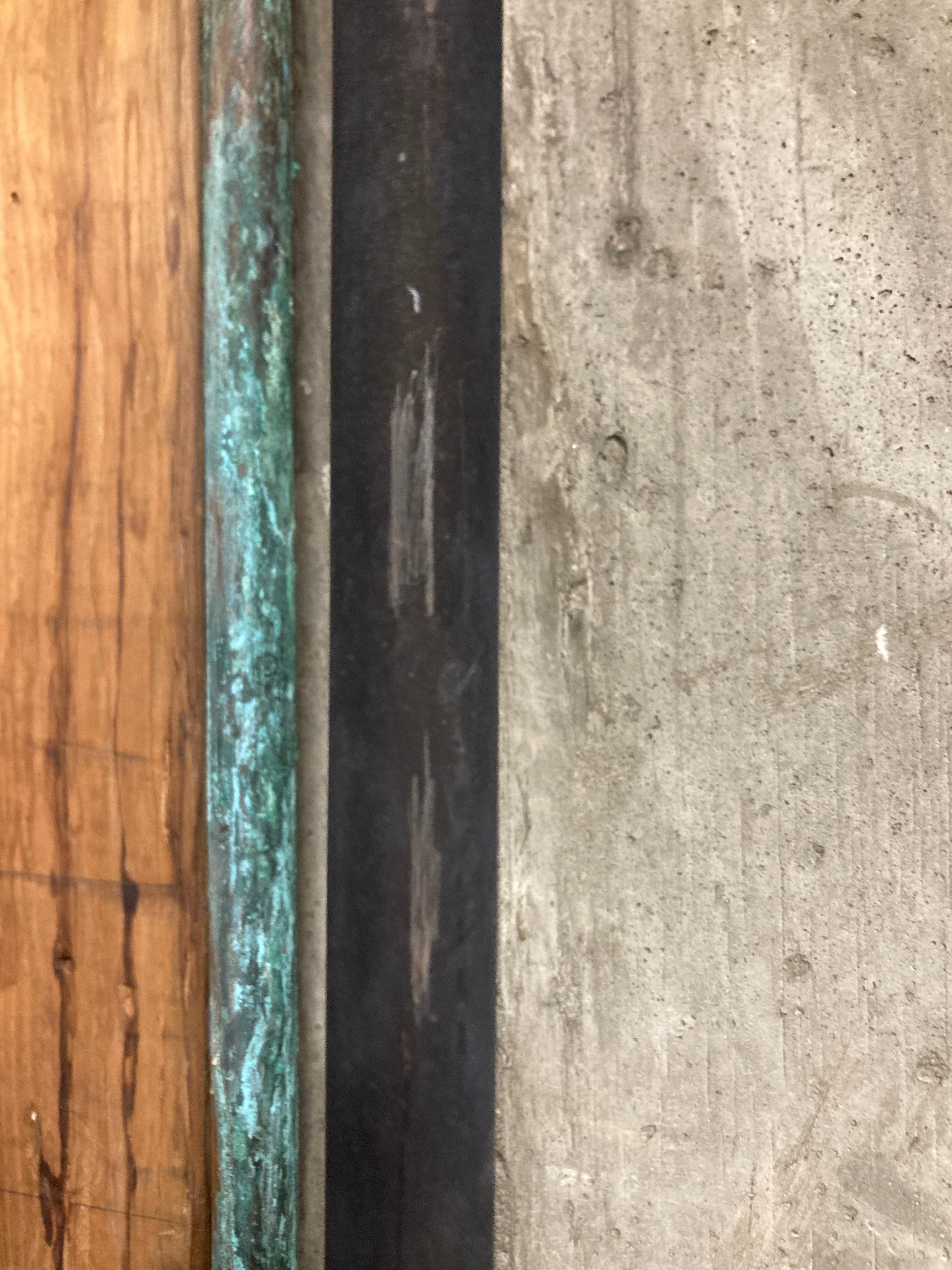

    I scratched the surface of the pipe a bit. It doesn't look like copper - it's more a grayish something.
    This is how the sillcock is attached - first goes to a gate valve with drain.

    scrape it some more or use some scotchbrite or fine sandpaper. that is copper

  • I'm glad I'm on this forum where folks like @mattmia2 kindly answer questions. I scraped some more and it is indeed a greenish color, definitely not silver. A brief internet search shows that cold water copper pipes in humid environments (like my basement) turn blackish from the extra condensation → oxidation/patina.
    Welp, looks like I can kick this can down the road a bit more and focus on replacing the sillcocks.

    Make sure to have valves before the sillcocks and I recommend adding a drain cock as well and be sure to open them before winter and make sure no water is left in the “frost-free" sillcocks or they'll freeze

    Is this "silvery" or "coppery"? I'm conflicted …
    edited July 2025
    copper. the types of fittings you showed are only used on copper.
    also the green oxide is copper, it only comes from copper or copper alloys like brass and bronze.
