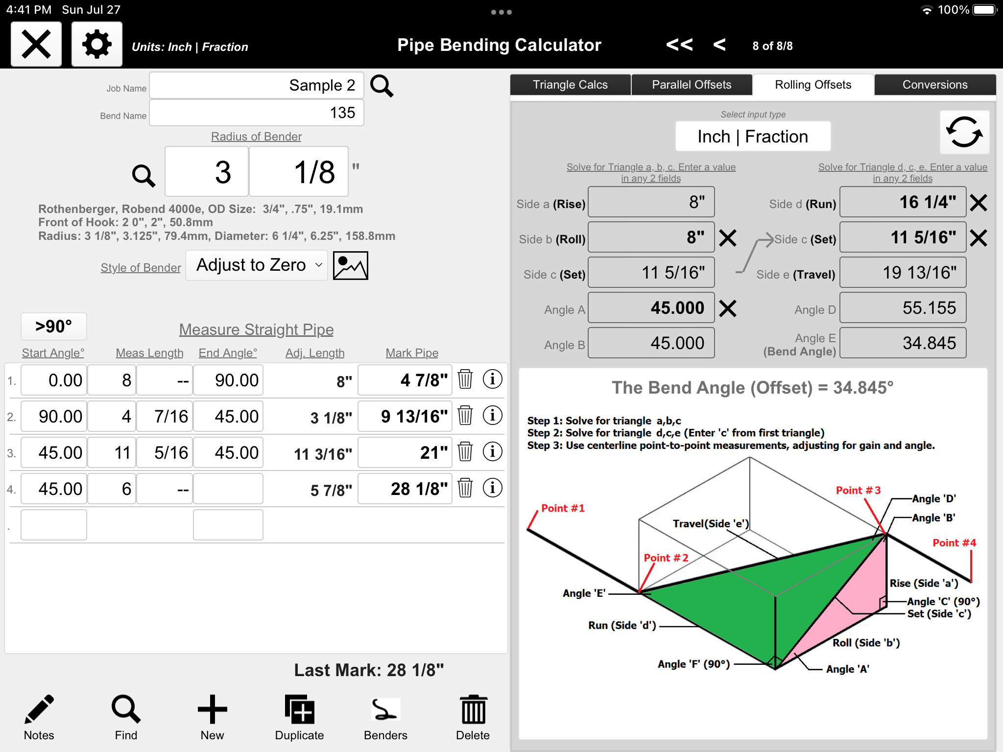

  • HydronicMike
    HydronicMike Posts: 471
    I use the Rothenberger Robend 4000. My buddy, who used to be on here, made a really cool calculator to easily do the math.
    He also showed me how to buy it overseas for about 1/2 the price as you can from Rothenberger USA. The only downside was it took about 3 weeks to come in.
