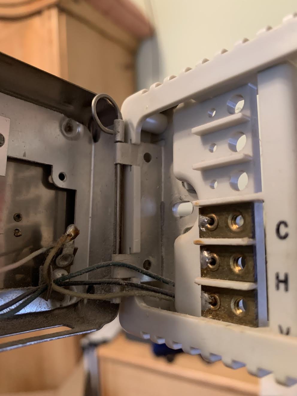

I've been working at a house where the husband is a mathematician/engineer. He was always the one that did the plumbing and electrical repairs in the house. He even did the work to repair any heating system problems. As he got older, fewer things got fixed. Slowly, the Honeywell zone valves stopped working and eventually, there was no heat in the house. The husband is now in a memory care facility and his wife has decided that she wants heat, so she called they only person - still alive - that worked on their system in the past - me.

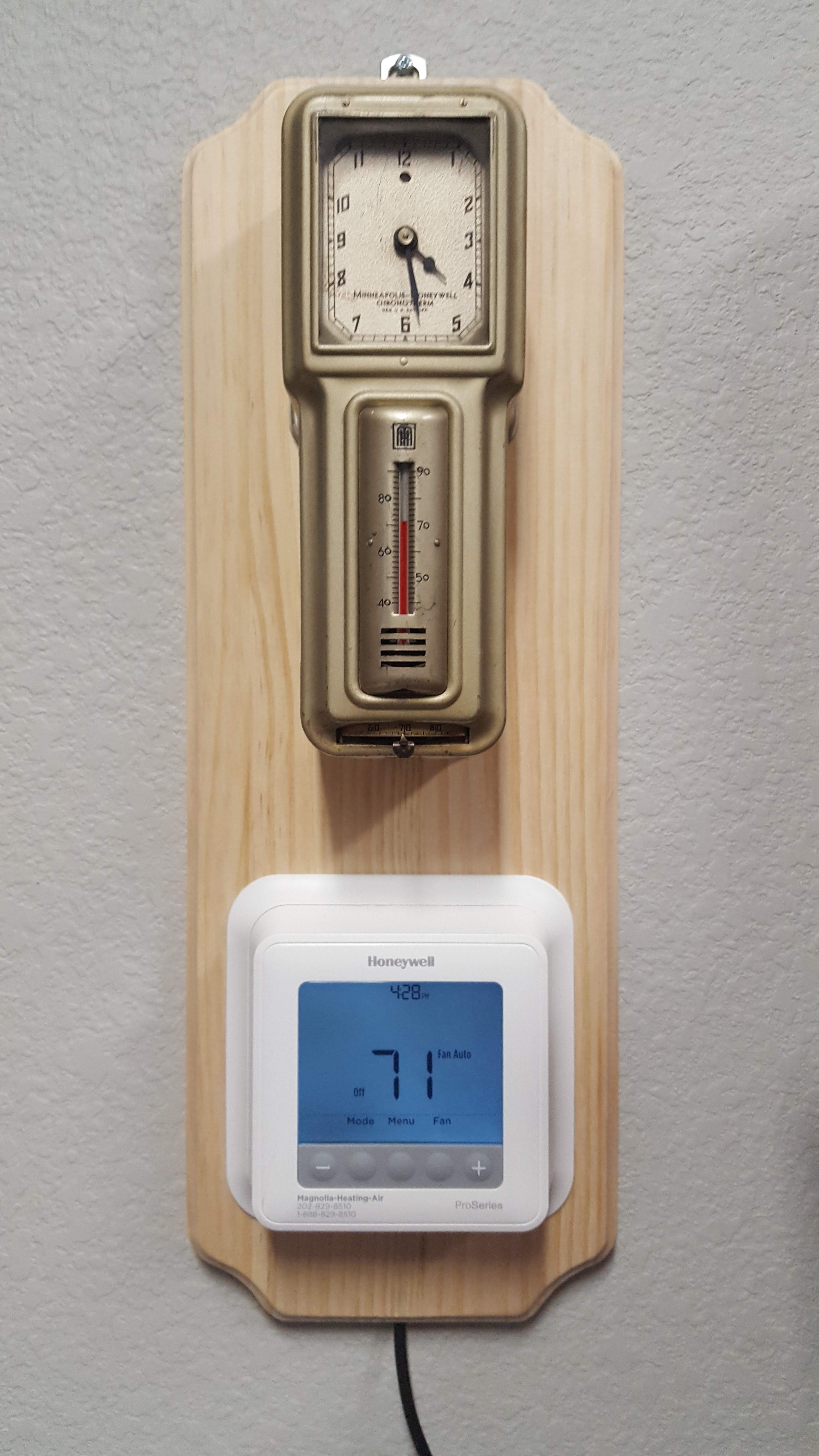

I've replaced all the zone valves only to find out that none of the thermostats communicate with the controls in the boiler room. I suspect rats chewing through the wiring as they had a longtime vermin problem and I've replaced the old thermostats with Honeywell RedLINK wireless units.

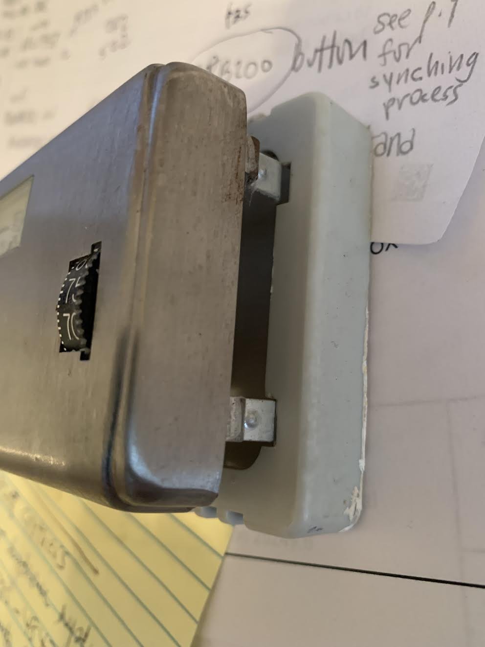

All the old thermostats still work as does the transformer relay. They are so beautiful and I can't bring myself to throw any of them away.

The horizontal type with the HG bulbs was in my mother's house from about 1960.
It was branded with the Lennox logo.

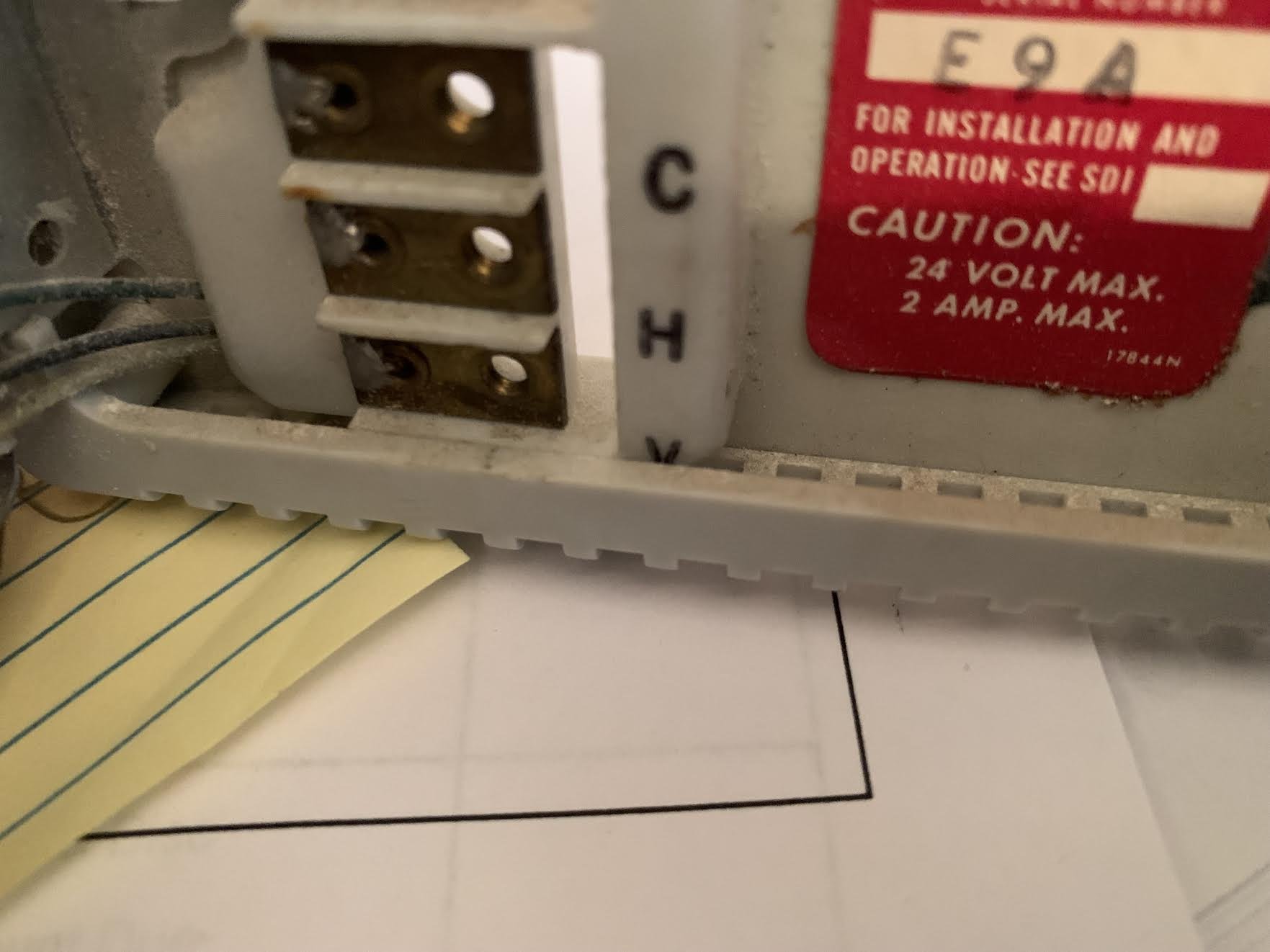

is that one heat cool but not labeled R W Y? What is that bottom terminal, I can read C and H which I assume is cool and heat.
Surprised not to see a round Honeywell mercury type!
might be too old
It's probably "Y".
The face opens up easily with a metal, pull-out hinge and smooth clips into the base. And no batteries for programming that many of my customers can't figure out. I end up telling them just to put it on "Hold".
