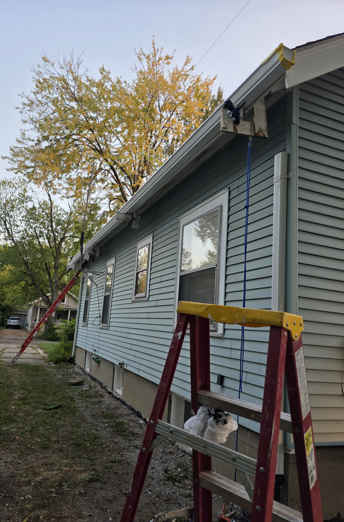

I am looking for a support to put on top of my extension ladder to support the ladder on the surface of the roof rather than leaning it up against the gutter. One roof is 8/12 and the other is about 2/12. The extension ladder I have is a 24' fiberglass type 1a Werner. I have to store the ladder on some hooks on my garage wall and the space is limited so the support will have to be easy to remove and install, I don't want to spend 10 minutes with u bolts and wing nuts to do a 5 minute job.

    This is part of what i need to access so leaning it on the wall isn't an option.
    I suppose I could try to lean it here:
    This is where I could lean it on the wall.
    I would not do well standing on a plank on ladder jacks at that height.
    109A_5 Posts: 4,778
    Yeah, I get it. To work where you drew the red line is short scaffold territory, with a fall barrier on the back side or all around. You could put a Pick between two step ladders and tie everything off so nothing can move.
    The problem with supporting the top of a ladder with some kind of extension against that shallow pitched roof like that is it may damage the roof.
    If it were me at my house and the scaffold was not possible, I would use two 2 x 4's to support the top of the ladder (kind of like an asymmetrical 'A' or an upside down 'V' when viewed from the side). The two 2 x 4's would span between the top (or near the top) of the ladder (attach securely) then to where the floor of the porch meets the house. At the house end the 2 x 4's would be at least twice as wide as the ladder for stability. The 2 x 4's would be cross braced so they can't shift or deform their shape. Something may be needed to protect the porch floor and the house wall. The assembly with the ladder could be slid or moved (left or right) to where is needed then tied off again.
    Everything would be tied off to the structure or some other securely fixed point so your ladder assembly can't move.
    I've never had a ladder that was tied off securely move unexpectedly on me and I have been in some sketchy places.

    That is a sketchy location. What's in the yard in front of it? More or less level? I have a rather nice but exceedingly heavy 16 foot stepladder (one of those contraptions — Werner I think) which would do, but not if the ground wouldn't support it.
    I'm cheap. Well, not cheap, but let's say the budget is limited… even so for that application I would find a place which rented man lifts and take it for a couple of days…
    PC7060
    mattmia2 Posts: 18,428
    the 24' type 1a fiberglass ladder falls in that exceedingly heavy category. There are shrubs under it. If I were doing more than replacing the fascia and gutter i'd come up with something more elaborate. You can reach a lot of it from the porch but the fascia is not in the right place for that.
    If the standoff can angle more down than at a right angle then it would plant itself better on the low pitch roof.

    For a commercial rooftop access, when the gutters were change, the installer put a steel angle iron frame inside the top of the gutter.
    That could be hardly noticed from the ground. The frame was about 3' wide.
    It kept the ladder from crushing the gutter and would help to tie the ladder down.
    Once secured, the ladder would not scratch the gutter.
