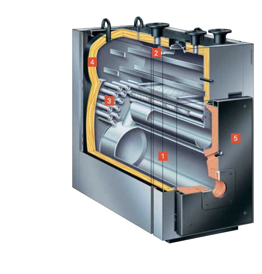

    EDIT: it appears that Viessmann does make a steam boiler for commercial use. I do not have information on older models, so it is possible that if @heron98105's old Weil McLain is a commercial boiler in the 20 HP range and above,
    Then there may be a Viessmann steamer to replace it.  I don't have access to older model numbers but the newer boilers may be one of these:
    And this Viessmann may be able to be vented into a chimney after you follow @Jamie Hall's suggestion about inspection. The consensus is still "Follow the manufacturer's venting instructions."
