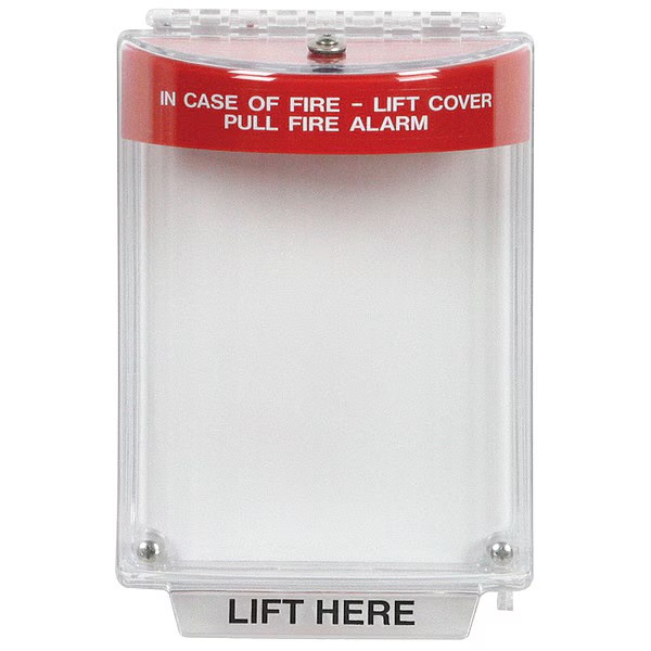

    The only thing I could suggest is to make a box to mount the switches in with a glass front (like the old fire alarms) so they have to break the glass to shut down the boilers.
    But then the person that breaks the glass will sue if they get cut.

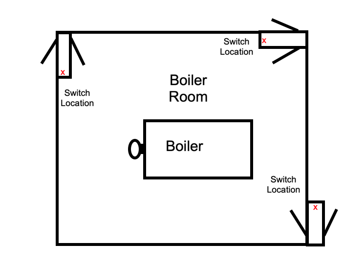

    How much room is there inside the boiler room? Is there enough room to place a one foot vestibule just inside the boiler room, or just outside the boiler room in order to make the switch pass inspection outside of the boiler room door but still out of public area?
    EBEBRATT-Edrick in Alaska
    That's a good idea @EdTheHeaterMan if you can get the various inspectors to agree on what a boiler room is and what the fire rating of the vestibule should be. That may be the best option

    I think the in case of fire cover may be ok. It stops a lot of people from pulling the fire alarm!
    The boiler room is big but the customer is tapped out. Lets start with simple covers, and see how it goes.
