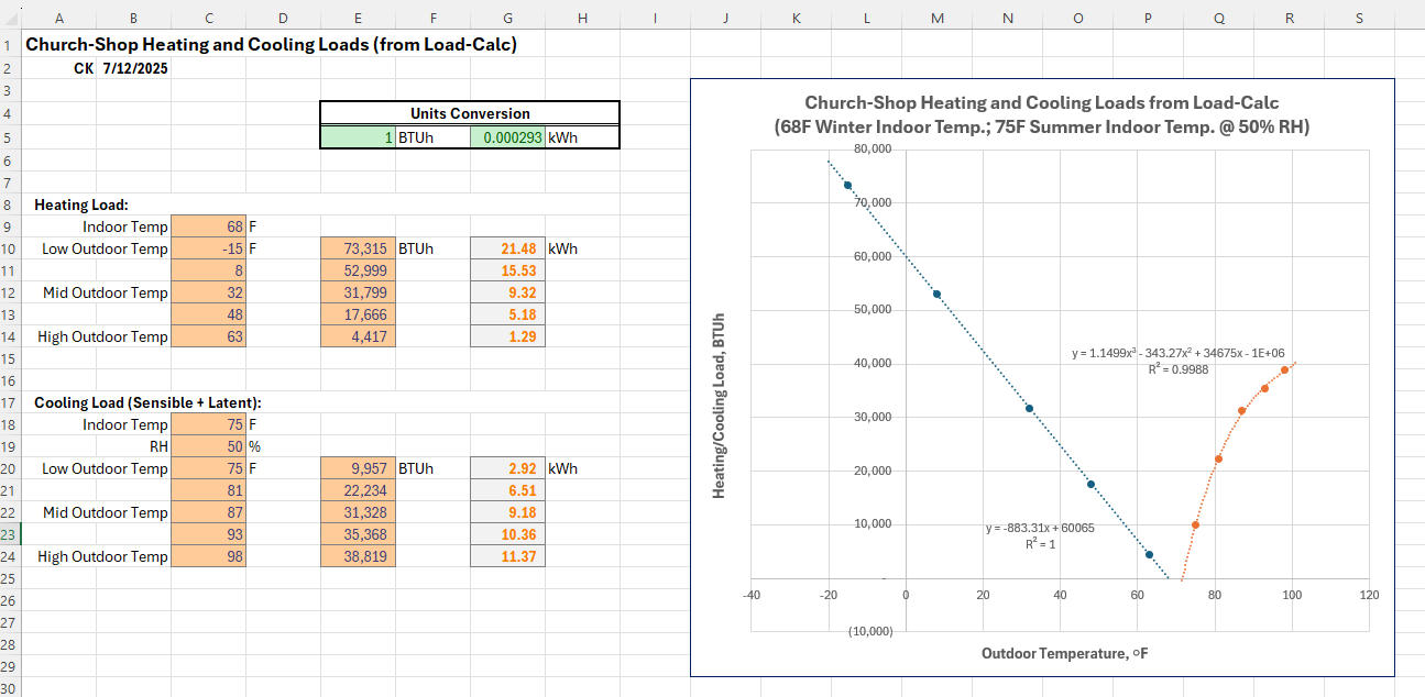

  • The building is a studio/workshop, and not lived in. It gets used intensively , and then sometimes not much at all. The tstat is left at 57, and manually overridden when I'm working. I wonder if the Manual J won't give me a better picture of heating and cooling requirments than trying to piece it together from a gas bill?
  • Hot_water_fan
    Hot_water_fan Posts: 2,249
    Good point - unless you have daily/hourly data a manual J is probably better.
    57F is wonderful for a heat pump.

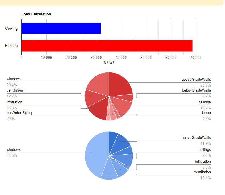

  • Screenshot from a run using CoolCalc MJ8, with 88/-8F design temps:
    This is pretty close to my guess at needing 100k furnace and 3-ton refrigeration unit. I trust CoolCalc numbers, as I used it for our home renovation and verified the numbers against another program. The system in the house is right-sized and the numbers have proved out over 6 years. I might be OK with an 80k gas furnace.

    I ran a check on building loads through Load-Calc, which came in pretty close to Cool Calc. This screenshot from a Q&D spreadsheet shows heating and cooling at 5 outdoor temps:
    Heating is linear, so it's over-specified. Cooling isn't linear as it also includes latent heat. The orange trendline curve is a cubic polynomial, which happens to fit without oscillating.
    I think this tells me if I use a dual-fuel system with a 3-ton heatpump, it's probably gonna be done heating the place somewhere around 30-35F. This will vary depending on the unit. A 'cold-weather' pump may cover the heating load down to 20F.
    I'm disinclined to pursue all-electric/futureproofing scenarios. The added electrical load to the building is a negative (I already have several welding and machine circuits on a 200A panel.) Sizing a heat pump to cover heating down to -10F is going to make it too big for efficient cooling. Time to to check the energy cost and equipment costs.
    If a heat pump is cost-effective vs. gas in the shoulder seasons, I still see value in a modulating gas furnace if it fills in steps between 60% and 100%. The 10:1 turndown on a modcon boiler is great - there are a lot of steps to use between 32F and -12F! Maybe gas furnaces don't modulate that finely?

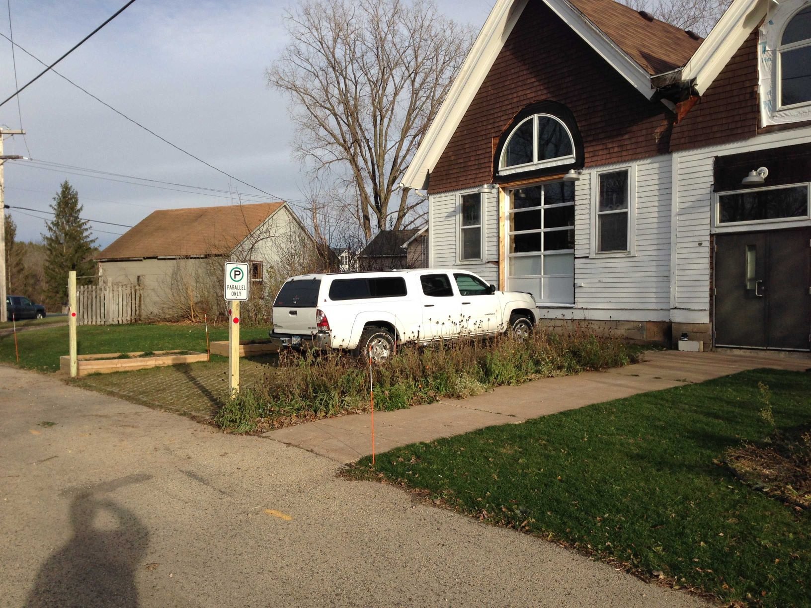

    Sounds like a fun project, got any pics you want to share of the building?

  • The pics above are all pre-2016. I did a lot of work on the building from 2012-2016 and then focused on making income instead of construction work! Its time to get back on the building project…

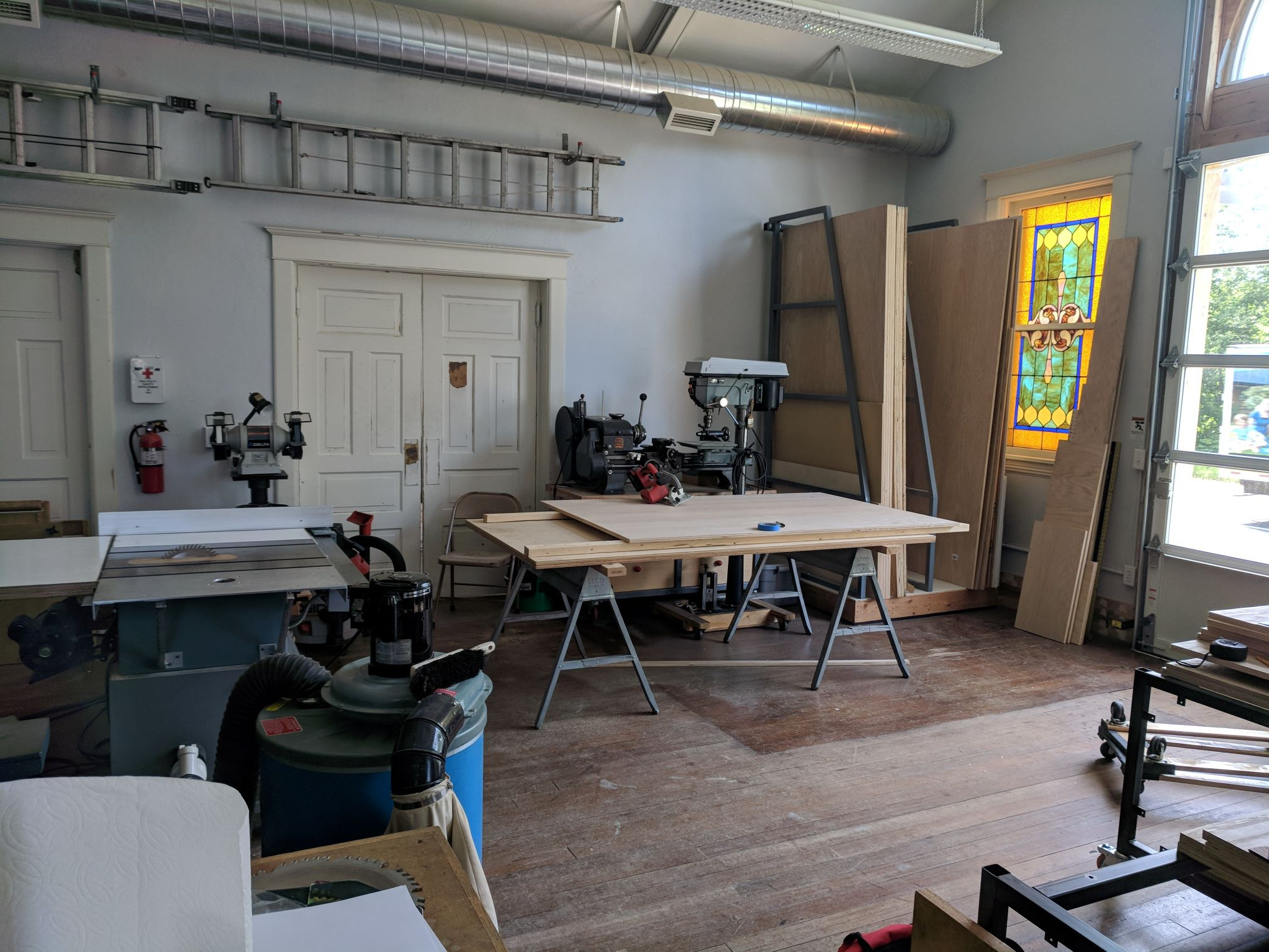

    Here is are recent pics of the interior ( the hoistway in the back is through the old altar/chancel area and lets me get heavy stuff to the basement. That's where the machine shop is):
    Material handling works well. In and out of the storage racks close to the glass garage door. Buck up oversized stuff on sawhorses if I need to, and then right onto to the saw.

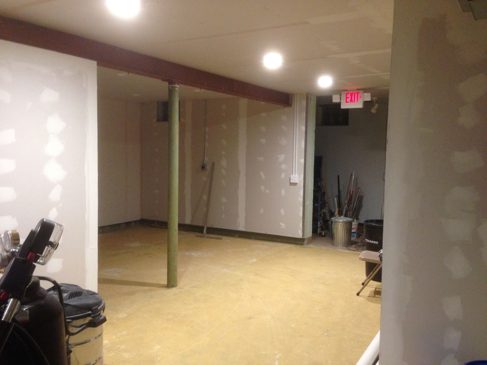

    The old entry area had a low drop ceiling that covered attic access hatch. Typical 60's/70's awful remodel work. I tore out that part of the attic framing and made a loft. It still needs guardrails…

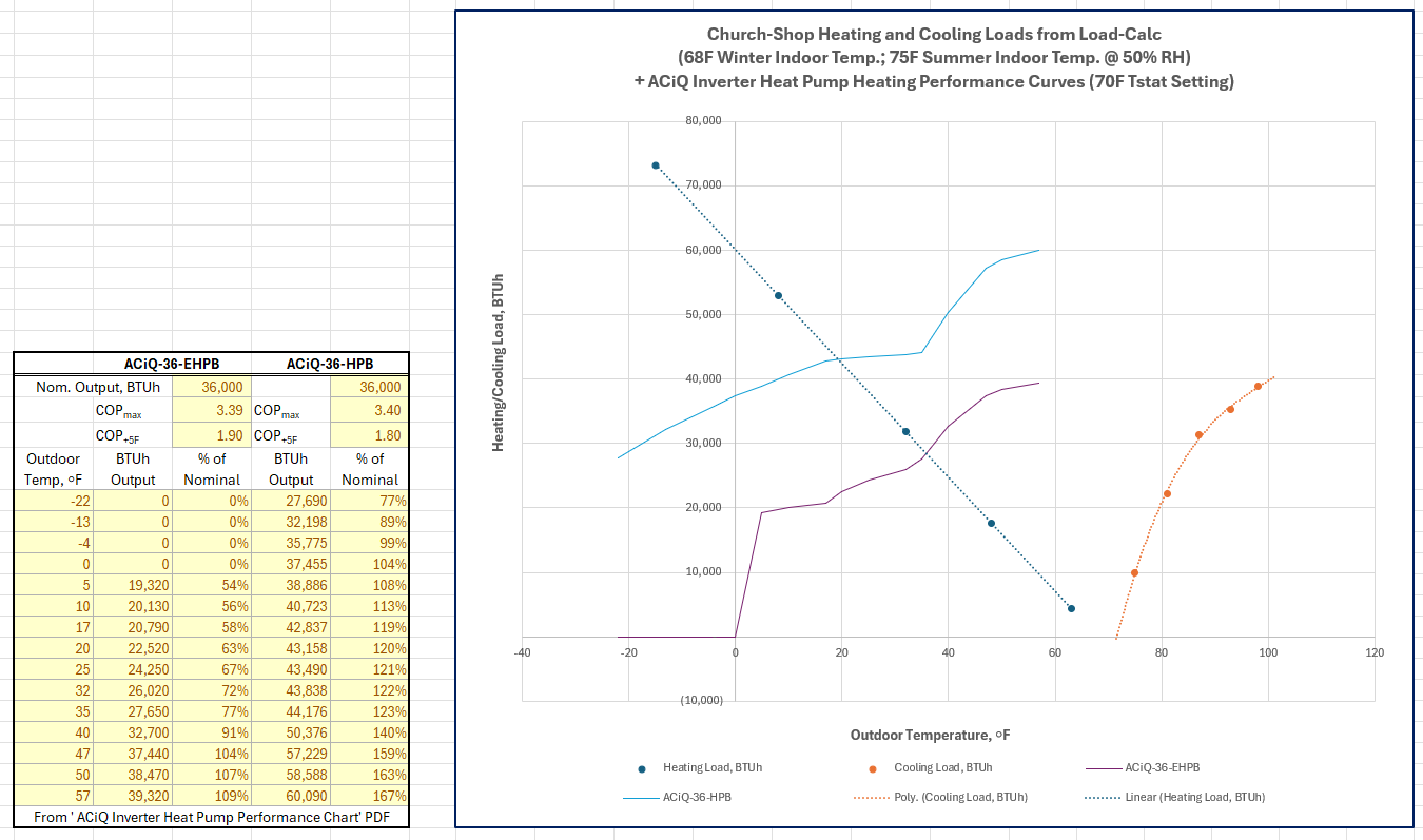

    Here is a chart of my predicted heating and cooling loads with heating performance curves for two ACiQ inverter heat pumps (+5F and -20F rated, light blue and purple curves):
    I gather the ACiQ-36-EHPB would cover my heating down to 35F, and the ACiQ-36-HPB would cover heating down to18F. Both publish a COP of 3.4, which I presume is max COP. Both publish a COP at +5F of ~1.8-1.9.

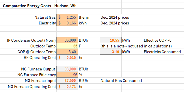

    Here are the calcs I set up for energy costs:
    I don't know what COP the ACiQ condensers would be at at the points where they cross my heating load line. I'm guessing aorund 2.65 (midway between ACiQ published high and low values, and looks about midway on the high and low outputs of their curves). Does that seem correct?
    Even if I set my COP value at 3.4, it is still less expensive for gas is than electric (with Dec 2024 prices):
    I suppose a better picture would include electrical consumption for the blower and controls , but thats a given for either an NG or ducted HP system. Then there is the pan heater for any HP condenser in MN (I call that essential, and am amazed how many folks don't have them). If I'm missing something here, please tell me!
