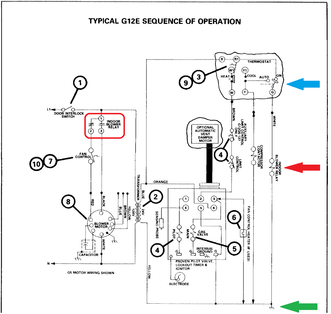

My Lennox furnance (Model G12Q5-165) & air conditioner (Model MS9-511-3P) is from 1979 (I tried to turn on my house fan (no heat or air conditioning) & it would not work. Since my fan in the furnace main unit will not come on the air conditioner will not come on. I found out that the transformer in the main furnace unit was burned out so I got a new one & installed it. When I turned the fan on at the thermostat the main unit in basement would hum. I turned it off immediately. Did that several times. Then I turned the fan on for longer - it hummed for 7 or 8 seconds & it burned out the transformer again. It appears to me that the transformer is getting shorted out from a short in the fan control. Does that sound right? Can repair parts be found for these old units? When they work they are great.

    pictures of the controls and the schematic inside one of the doors would help here. probably not a whole lot to short on these and almost certainly wiring that is touching somewhere.
    An older unit like that is a lot easier to troubleshoot that a newer unit. You have a short probably in the 24 volts coming off the transformer,
    Could be the blower relay could be the AC contactor outside in the AC unit

    Are you sure the AC was off and only the indoor (G) fan relay was powered? If so, ohm out the fan relay coil. If Y was powered, check the condenser contactor as well.

    Hopefully this wiring diagram is similar to your unit. When the thermostat is in 'ON' fan mode (Blue arrow) the only load on the 'G' terminal is the coil of the Indoor Blower Relay (Red arrow), which effectively changes the wiring connections to the blower motor to a (usually) faster motor speed by changing the state of the relay's contacts (Red box).
    The coil of the Indoor Blower Relay may be defective or a wire between the thermostat and the relay coil is chaffed or crushed to ground (since one side of the 24 VAC secondary is grounded (Green arrow)), overloading the transformer when the 'ON' fan mode is selected.
