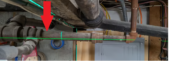

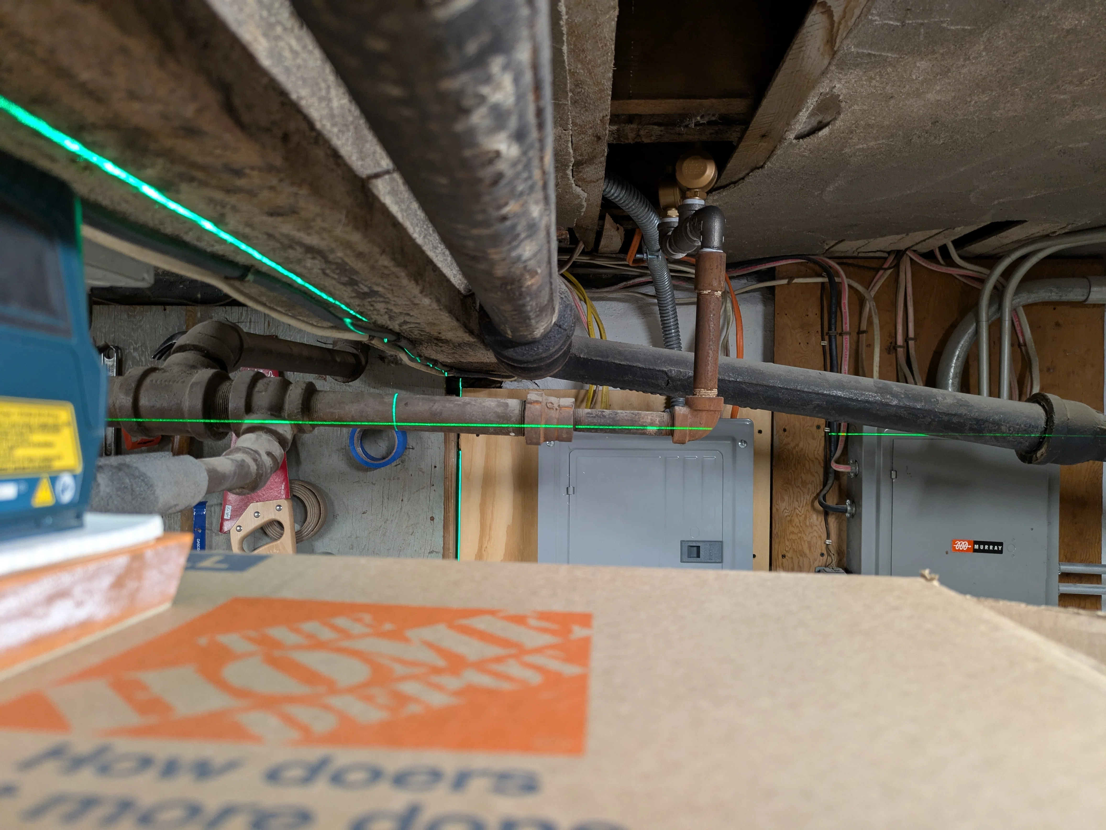

My daughter and son-in-law purchased a 1920 home in Boston last summer and I've been slowly beginning to correct some problems with their one-pipe steam heat system. I've been following this forum (thanks!) and have read Dan Holohan's book.
The system is very quiet. The primary issue is the very slow heating of the radiators towards the end of the primary main.
The main vent was clearly way undersized. The longest section, a 41' long 2" main, had a single Vent Rite 35, with an additional Vent Rite 35 at the end of a 10' dry return. I replaced the first vent with two Gorton #1's and removed the vent on the return. Since then, I've read advice on this forum that two Gorton #2's would be more appropriate. I have a couple of questions before I proceed.
First, I don't have a lot of head room and installing Gorton #2's would mean locating them between the floor joists, about two inches below the subflooring. Do I need to be concerned about steam damaging the subflooring in the event of sputtering or a vent failure? Am I better off going with eight Gorton #1's on a humungous antler so that I can keep the vents lower down? Or should I be considering another brand? I saw a number of people on this forum reporting trouble with the build quality of their Gorton #2's in the past. Has this issue been addressed?
Second, the vents are located off of a 3/4" pipe at the end of the main, immediately after the return tees off. Due to the pitch of the pipe, part of the pipe likely has a low pool of water. Is this going to choke the flow of steam on it's way to the vents? Or cause a water hammer once the venting is increased? I've attached a picture. The green line is from my laser level.

    Yes it could cause a water trap there, preventing air from exiting the vents. Have you ever felt air leaving these vents?
    I wouldn't worry about changing them out for a #2 until you see how well they vent. You can time how long it takes the steam to fill the main.

    Now… that sloping pipe. As it is, it could be a problem. However, I think that if you take the reducer off under the big pipe, and put a 45 on there angled up with say a three inch nipple, then a 90 towards the room (to clear that other black sloping down in back) and your Gortons on there it should work. Adequate headroom. There will still be a bit of a puddle there — can't help that — but it may work just fine.

    You could disconnect the pipe at the Red arrow add two 90 elbows and a few nipples to pitch the vent pipe the other way. However I'd wait and see if it is actually needed. If the Steam / water vapor seems to affect your wood in the area of the main vent you could use aluminum flashing (or the like) as a barrier.

    You appear to have two #1 vents on the pipe now and the pitch, while not ideal, appears to properly serve the vents. Are you sure you have a problem? If you truly need to correct the backpitch, you can probably jack up the pipe an inch and apply a hanger…
    The two #1 vents are probably adequate, and you can add a third if more venting is indicated.

    A little over 1cuft of main should be easily handled by two #1's.
    Looks like it is a parallel flow main so it has to slope toward that dry return. That dry return has to drop down below the water line before it connects to anything else like another dry return. Does it do that?
    Did you say that there is another vent in that dry return at the boiler? You could put all the venting there and cap the vent with the slope.
    That pipe as is will hold a pocket of water which will collapse steam at that area and usually will hammer since the vent is beyond the pocket, the vent will allow steam to get to the pocket.
    If you are using that vent connection you show, you need to remove the section at the tee where it connects to the dry return and use bushings, ells, 45 ells, and nipples to get the pipe to the vent sloping toward the main. It could be 3/4" after the tee.
    With the right tools that pipe coming out of the tee should unscrew but you could also cut it about an inch from the tee, make 2-3 slots inside the pipe almost to the threads, and use a chisel or punch to collapse it between the cuts then it will unscrew easily.

    With an oxy acetylene torch you could easily heat that pipe red hot and bend it up a smidge. Heat the long nipple in the middle and put wet rags on both the fittings on either side.
    You can't lift the whole pipe with all the rads attached and even if you could it would turn the main into a counterflow which would cause issues.
    Either that or take the long nipple out and use a couple of elbows to make a swing joint.
    Put a close nipple in the tee, put a 90 on then a short nipple and another 90 on. Run it back along the main parallel to it to where you have room for the vent and 90 up. Tip the 90 coming out of the tee up so it will drain.

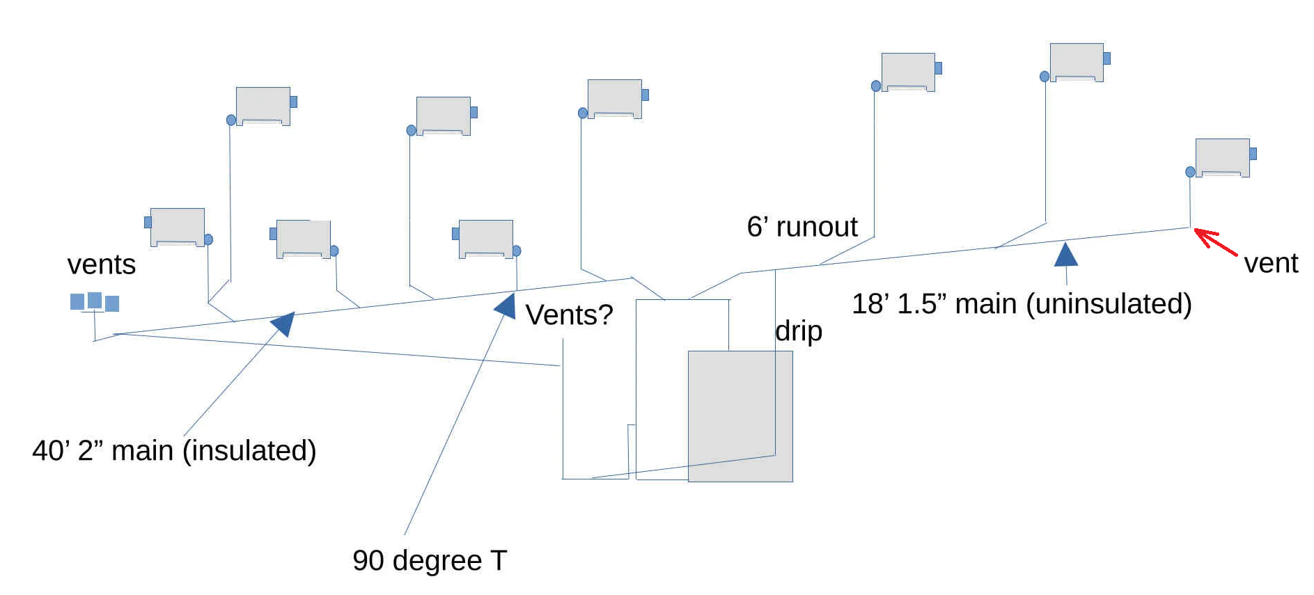

    Approximately 40' of 2" cast iron pipe on this main, with five risers (3 to the first floor and 3 to the second floor)
    The main is well insulated, aside from the T's and elbows.
    The oil burner is too loud for me to hear any puffing from the mains vents.
    The needle on the (new) 3psi gauge has never budged from 0.
    I'm hoping to avoid messing with the piping to the main vents, if possible, as I really don't want to break anything and leave my daughter's family without heat. I can try the suggestion to remove the vents and see how long it takes to heat up the main, but it'll be a couple of weeks until I'm there again to try this. Since I'm seeing no movement on the 3psi gauge, does this the mains venting is adequate? But if so, where is all the steam heat going if it takes 30 minutes for the radiators to begin to get warm?

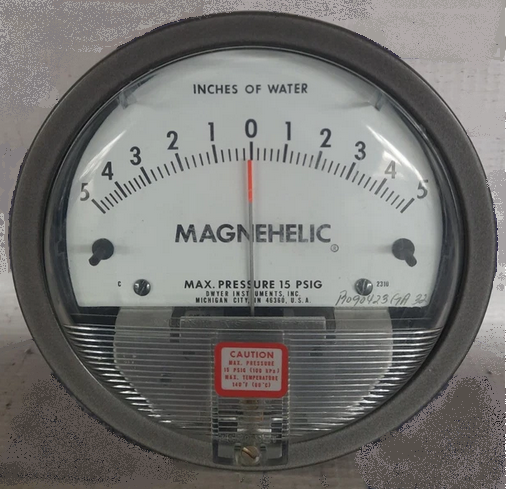

    If I were to get a Dwyer Magnehelic Gauge, what range would you recommend?

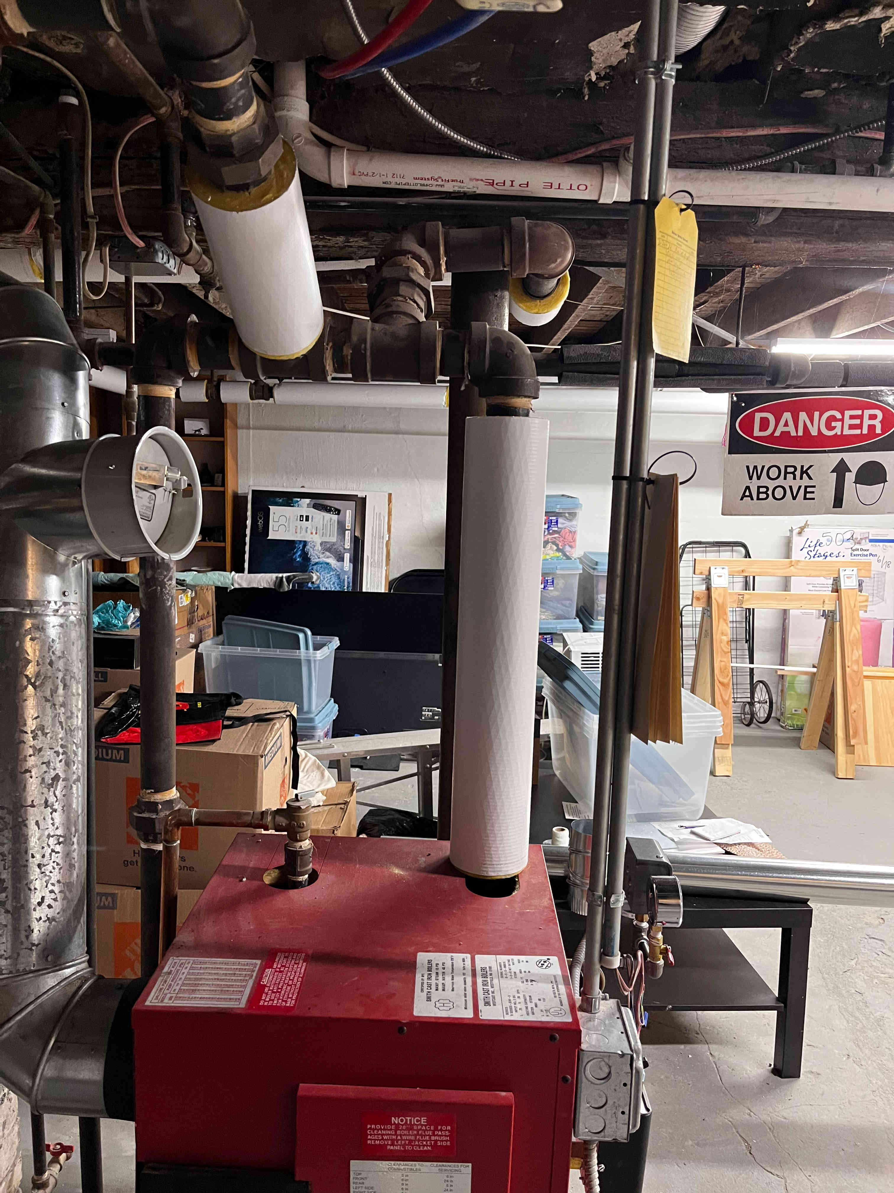

    Boiler pictures may help a bit.
    Without knowing where your system pressure is It is hard to recommend one specific Dwyer Magnehelic Gage. You could build a Manometer from clear tubing to get a better feel for the actual pressure. I have two gauges 1-0-1 and a 10-0-10 (as a sanity check) connected with 3/16" silicone tubing to the top of the boiler after about 12 inches of brass riser. My pressure usually does not go over about 1.25 inches of water column.

    Pigtail on the gauge could be plugged. Seems to take a while to heat. How about a few pictures of the boiler and the piping.

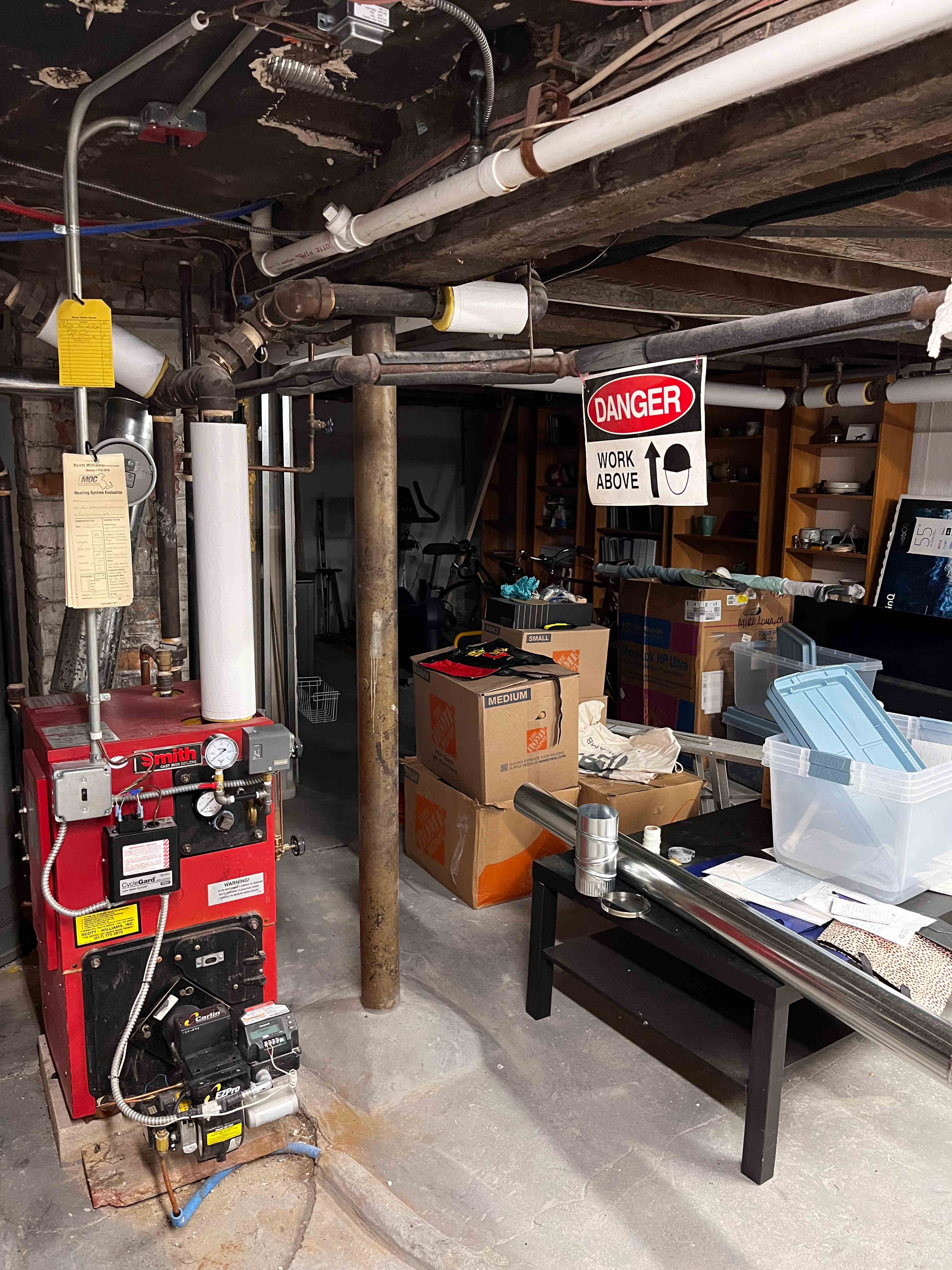

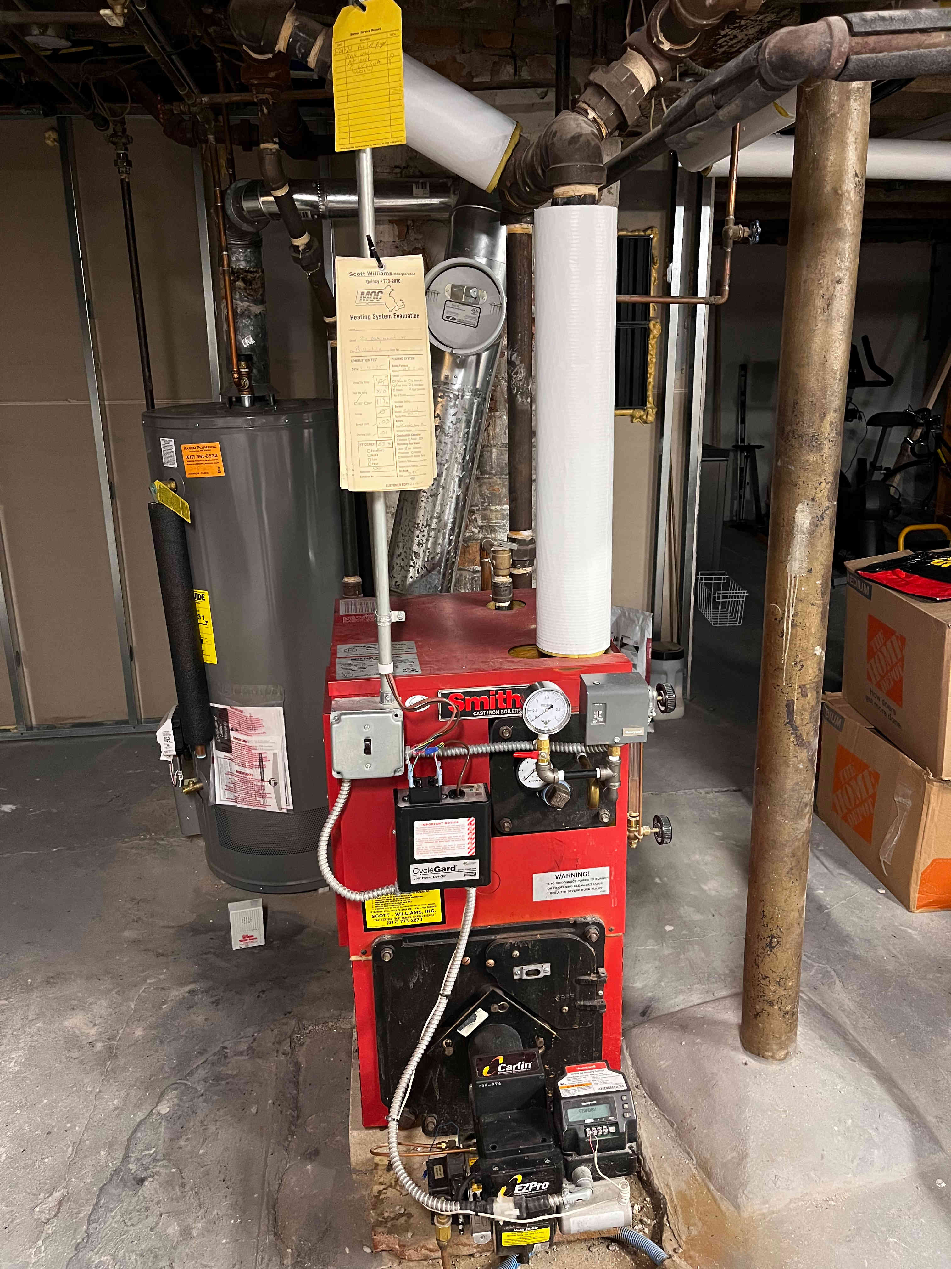

    Here are some pix and some answers (and some questions). I really appreciate everyone's ongoing help.

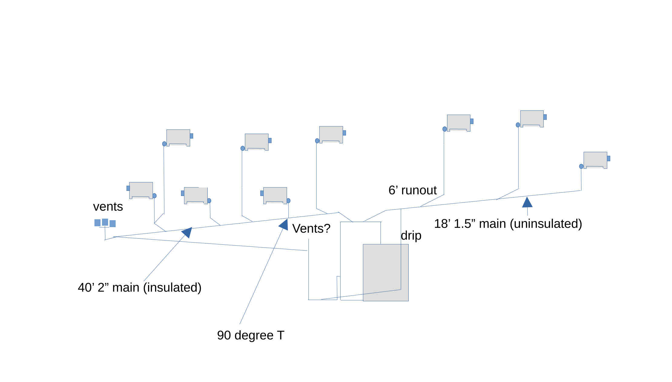

    In the pix you can see that this is a second main, as well, with a takeoff after the first main. The second main has a 1.5" pipe, about 17' long. There is no mains vent, but the three radiators work fine.
    On the first main, there five risers and six rads because there are two rads coming off of the last riser. This is in a rather tight location above a major structural beam.
    It takes 11 minutes on a cold stone start for the top of the boiler header to get steam hot. Another 11 minutes for the end of the main to get steam hot. This includes one minute with the burner off while the LWCO does its measurement. Then another 10 minutes until one rad is steam hot and another 13 minutes until all of the rads are steam hot.

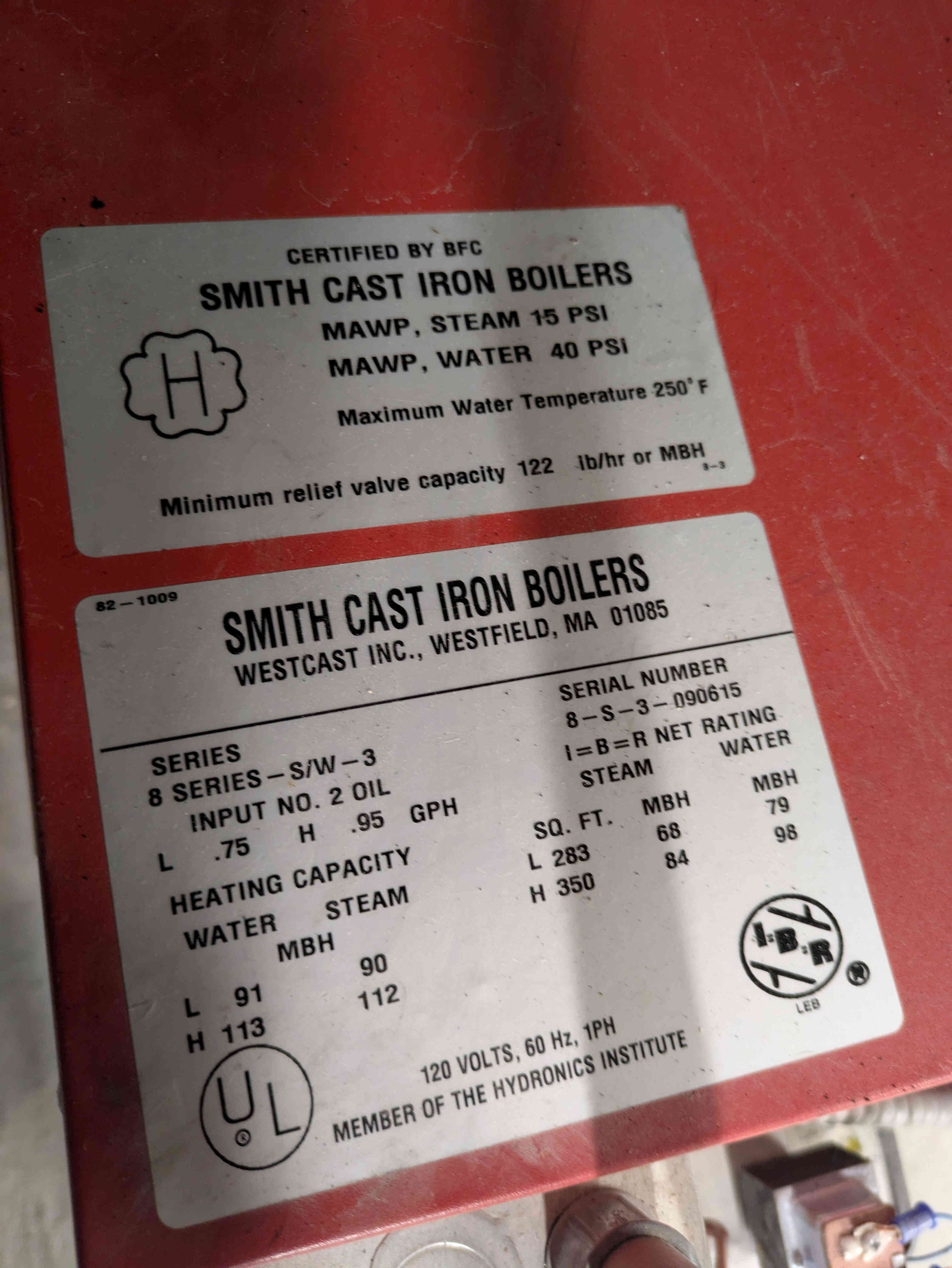

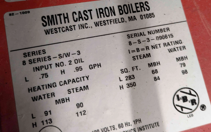

    The heating system evaluation card lists the nozzle as "65". I was wondering whether this might be low, as the boiler ratings plate lists L .75. Or is that rating for hot water and not for steam?

    As far as the nozzle goes, I wouldn't mess with it yet. They may have increase the oil pressure so you could actually be running at .75.
    The Smith model #8 was a good boiler sadly no longer made.
    White smoke out the chimney would be the sign of a failed boiler. After seeing the boiler, I doubt that is your issue. Piping near the boiler seems ok.
    When you add up the radiation Smit gives 2 ratings for that boiler 283 EDR and 350 EDR depending on the nozzle used. Compare your total radiator EDR to this #

    This one pipe system and has two mains. If the 'Steam Main extensions' from each main are not connected below the water line (typically near the boiler) you are just inviting problems and a lot of unnecessary work putting the vents near the boiler.
    Just change the venting pipe that exists so it doesn't trap any condensate (restricting the air flow) as mentioned earlier in the thread and increase the main venting as also previously mentioned. Then see how the system performs.

  • If that pipe is at the end of a main it is pitched wrong based on your level and will fill with water so any vents you put there won't work because the air won't pass through the water that will settle in the pipe. You need to relocate the vent if you want your system to work properly.
  • This is how a main vent is piped so it can drain.
  • Note the continuous pitch back to the boiler once the steam has turned back to water.
    Sorry if there is any confusion. This picture shows the end of the 2" main, ~40' from the boiler. The T on the far left is for the riser to the last two rads. The reducer/T, with the pipe coming towards the viewer, is the return. And the pipe (red arrow) going to the right leads to the vents. My understanding is that this is very close to where Dan's book says the vents should be. Based on the green line of laser level, it looks like the pipe is only partially blocked by a puddle. Fortunately, there is no water hammer.
    Eventually, I plan to fix the pitch of this pipe. Sooner if I'm convinced it is a problem.

    Another question that I can't tell from the pictures is;
    You have two mains are there two returns ? If so are they connected above or below the boiler's water line. How long is the shorter main and its return ?
