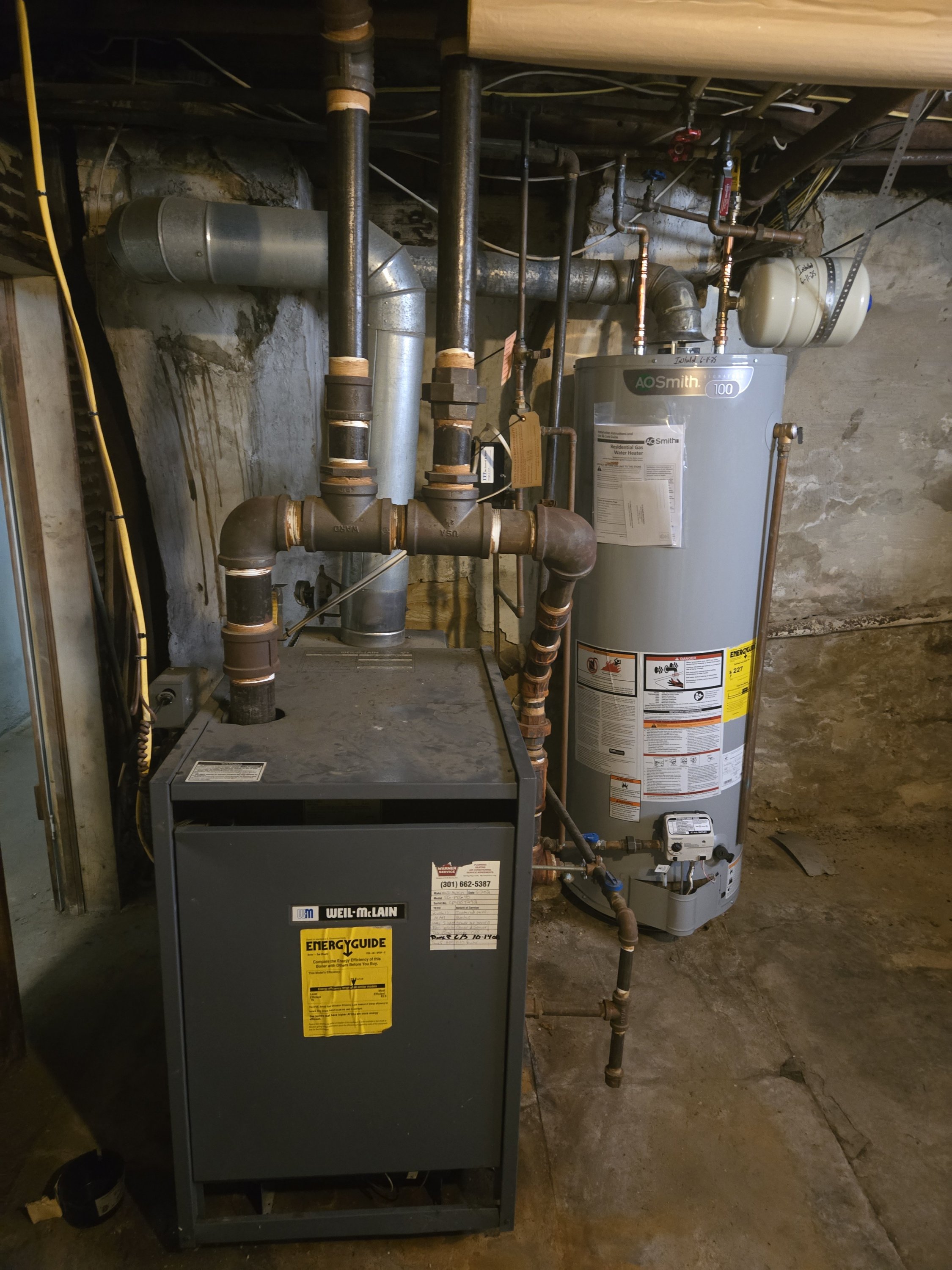

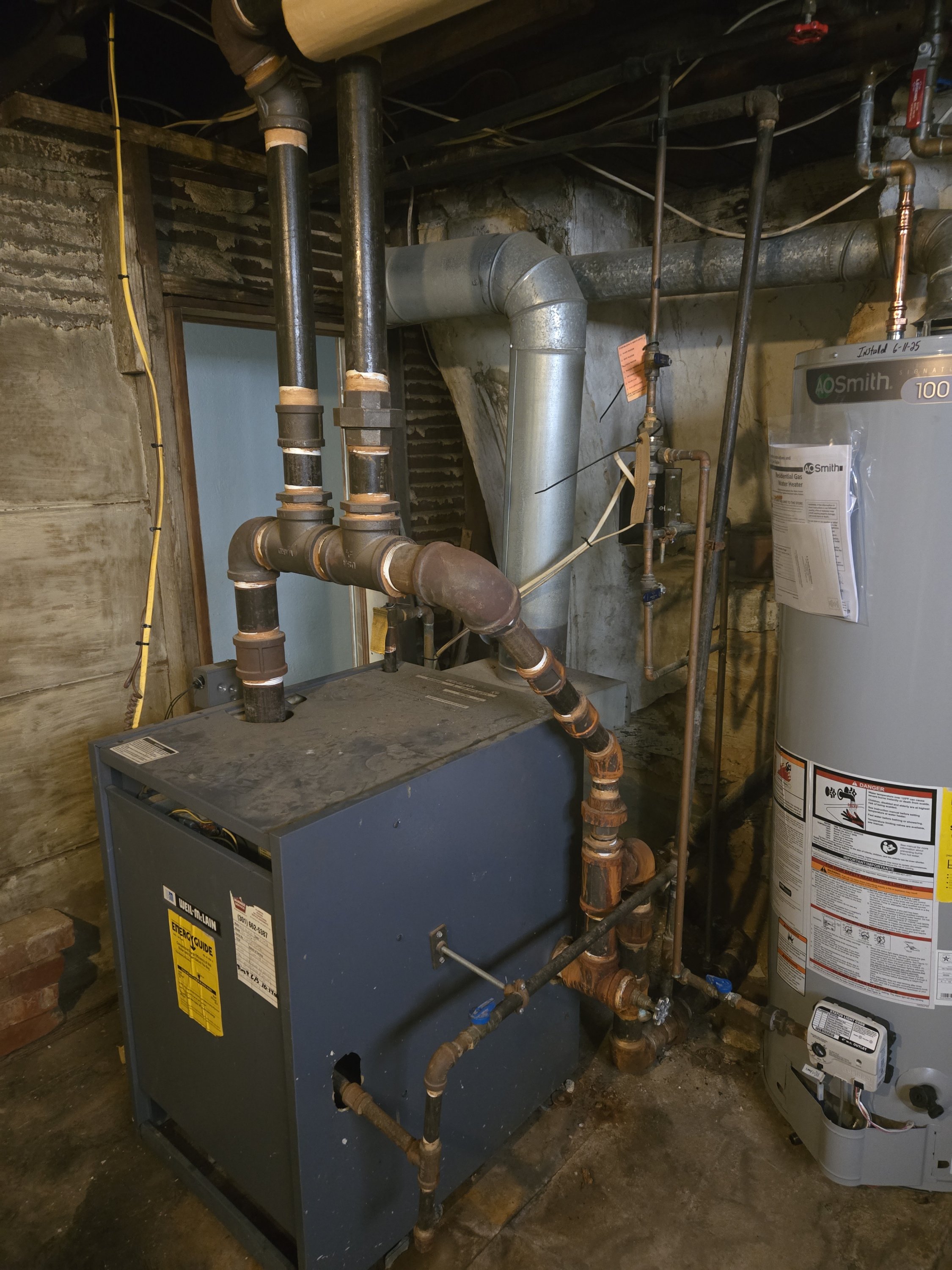

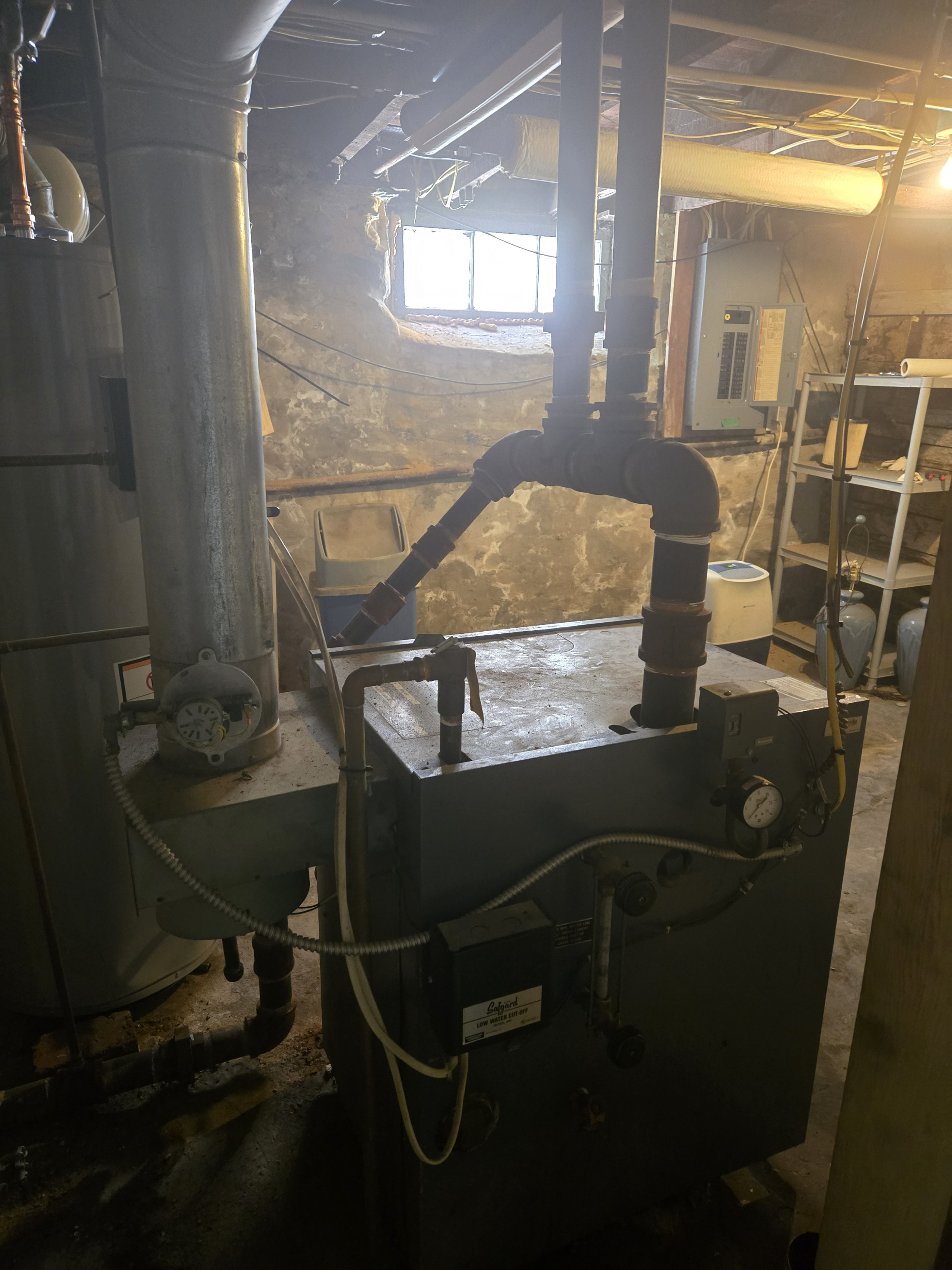

I have steam boiler (installed 2002), long story short, I accidently overflowed the system. I was advised that I need a new boiler due to leaking. The contractor came and measured the radiator to size the system. The estimate is very vague and states that:
This price includes all materials and labor to install (1) PEG-40 78,000 BTU Weil McLain steam boiler with 2 new Honeywell heat only thermostats.
What additional questions should I be asking about the install for this and potentially getting other quotes? When overflowing, water was coming out of the vents on the main pipe.
Someone else came out and said it didn't looked piped correctly.
Thanks!

    Over-flowing a boiler does not harm it. But depending on this "leaking" it might have accidentally indicated that your boiler has a hole rotted through it (the typical failure case for all boilers).
    Where was it leaking?
    Your boiler is piped fine in the photos you shared.
    They are wanting to replace your existing boiler with the exact same model which might be OK, although it's very very common for the existing boiler to be oversized. Did they share with you the total "EDR" or "square feet of radiation" that they calculated? That's the total sq ft of radiator in your house, and that is how you size a boiler, so it's good that they measured your radiators.

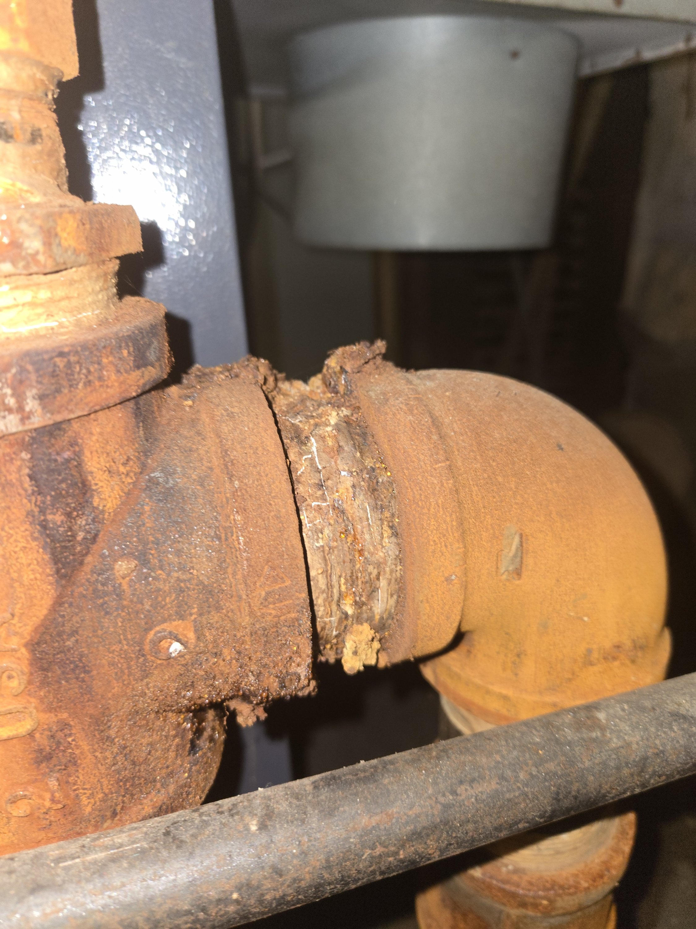

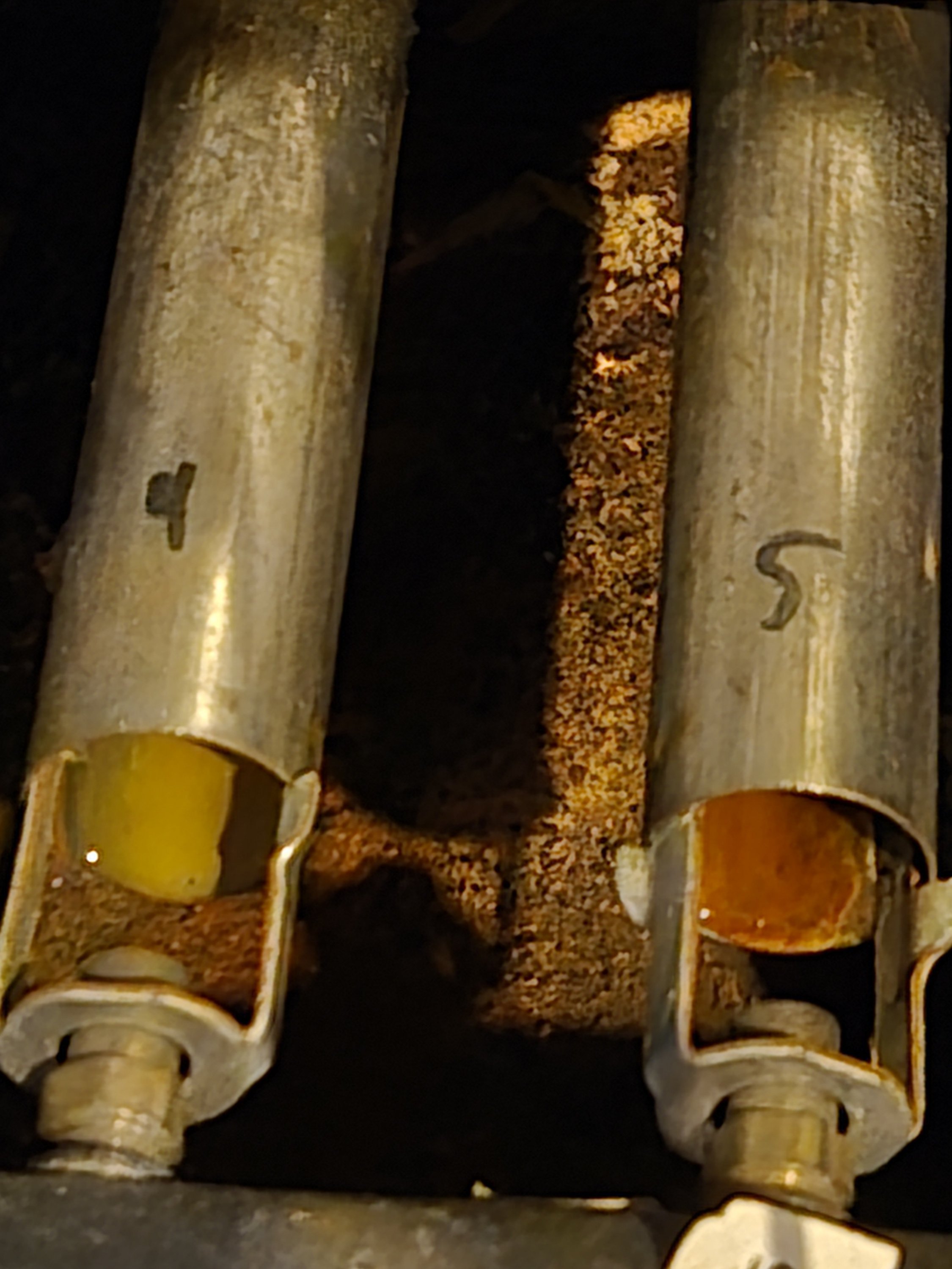

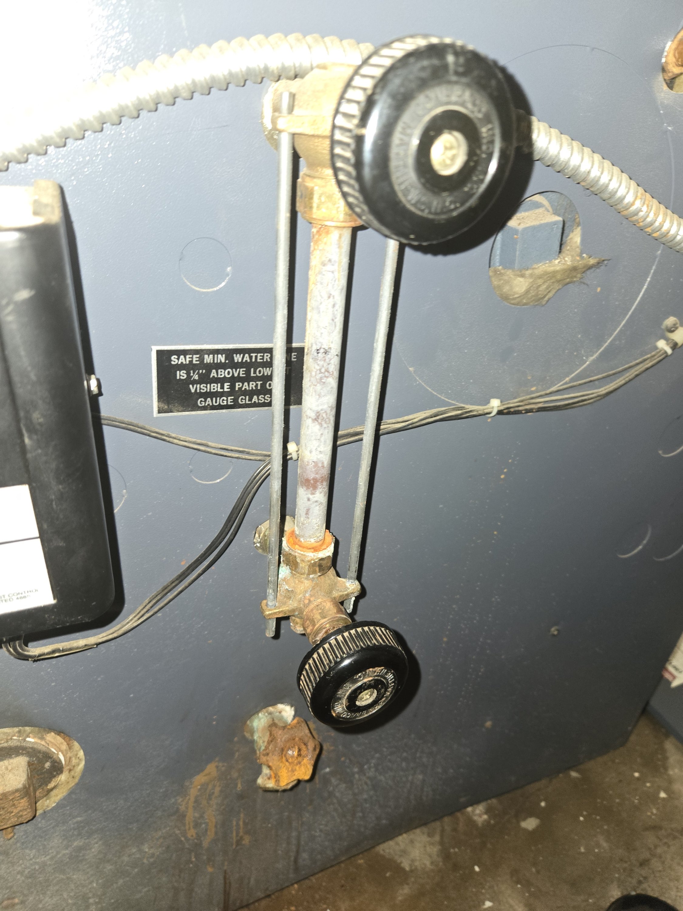

    There was water around the boiler, he mentioned that the insid3 burner (?) was rusted in 3 or 4 places. The other flaws pointed out was a murky site glass, a rusted pipe, and then water in the burner tube. I tried to recreate what he showed me, but not sure of the inside.
    Definitely trying to get second opinions, but since we are in the middle of a heat wave, everyone is dealing ac emergencies. Thought I could take some time to learn and be more educated when having others come out.

    The individual that installed your existing boiler followed the instructions properly. That is rare to find someone that knows how to get it right the first time. When you get the replacement boiler (if needed) the piping should look very close to what you already have. Sometimes you may get someone that has no clue and will redesign the piping because it is less expensive, Don't let that happen!!!
    As mentioned by others overfilling a boiler will not make it go bad. overfilling the boiler may have discovered a leak that you otherwise might not have found, but you want to be sure that you really have a leak and not just a defective steam vent the let water out on the floor as a result of overfilling. Second opinion is always a good idea. If you live near a steam boiler expert, chances are you will find one in the "Find A Contractor" link at the top of this page.
    Using the same size as the old one may also be a mistake. If the previous contractor selected the wrong size boiler, you will want to correct that with the replacement boiler. If you even need a new boiler.

    Thank you for this! Learned so much. My calc was 80544 if everything measured correctly.

    What was your total EDR (sq. ft. of steam)? Avoid working in BTU, it's a recipe for confusion
    ethicalpaul Posts: 9,076
    Look for a steam boiler with a "Sq Ft of Steam" rating of 300-330. Always round down to the smaller boiler if you land between two of them. Others will disagree with me on this, no doubt.
