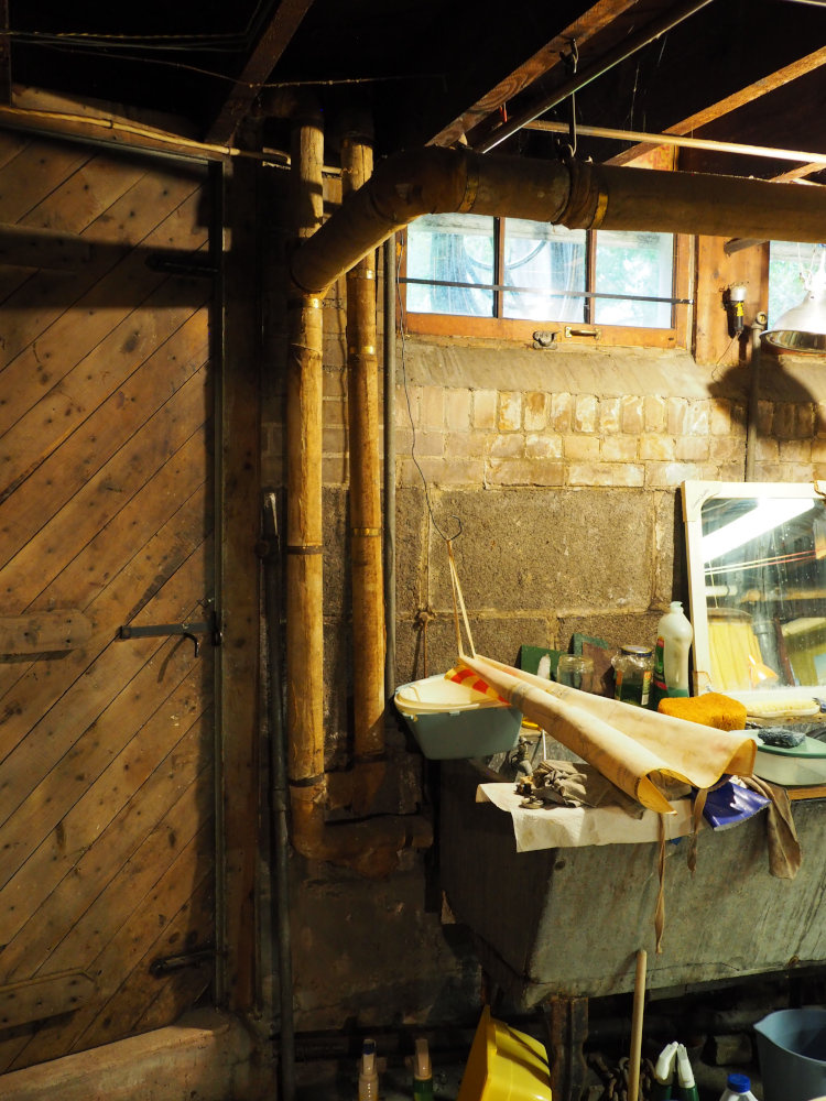

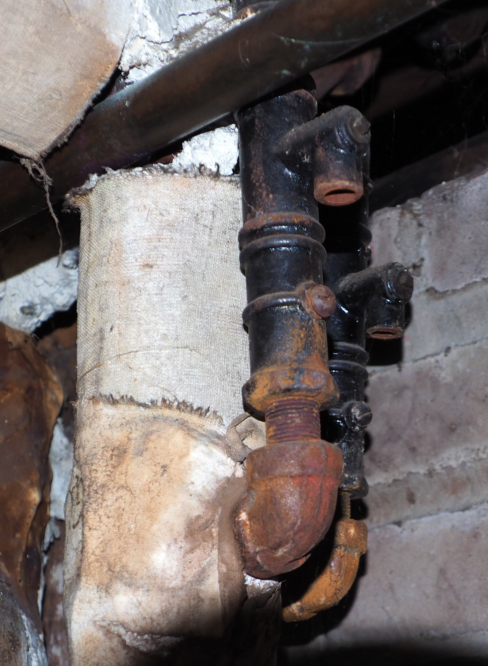

    FYI, a clarification of the lingering old return vent that looked odd in design to several people. Well, there are actually two vents in the pic that appear as one. See pic. Note that there is a a screw (for adjustment, or plug?), and there is a square head screw cap at the little elbow (direction option for attaching something?).
    Steamhead Posts: 19,007
    Might have been part of a setup designed to hold vacuum. What do those elbows connect to, under the old vents?

    What do you mean by "under the old vents"? To be clear, the pic is of 2 vents, each on a separate return. I do not know what the elbow on the vent connected to.
    I'm wondering where the pipes go after they drop below those old vents. There are elbows that go into what looks like asbestos. Ideally they should drop from that point down into the wet return before connecting to each other or anything else.
    Semi-retired
    Orifice plates go in the supply union of the radiator. In combination with regulating the pressure of the boiler they limit the amount of steam admitted to the radiator to less than what it can condense so that all of the steam entering the radiator condenses to water so it can not blow through the radiator and in to the returns.
    Those vents may be some variation of the KMC vacuum vent that it sounds like was just a regulator that let air out under very little pressure but would only let air in when the system was under some amount of vacuum regulated by the weight of a column of mercury. If you disturb those I would be very careful to keep them upright.

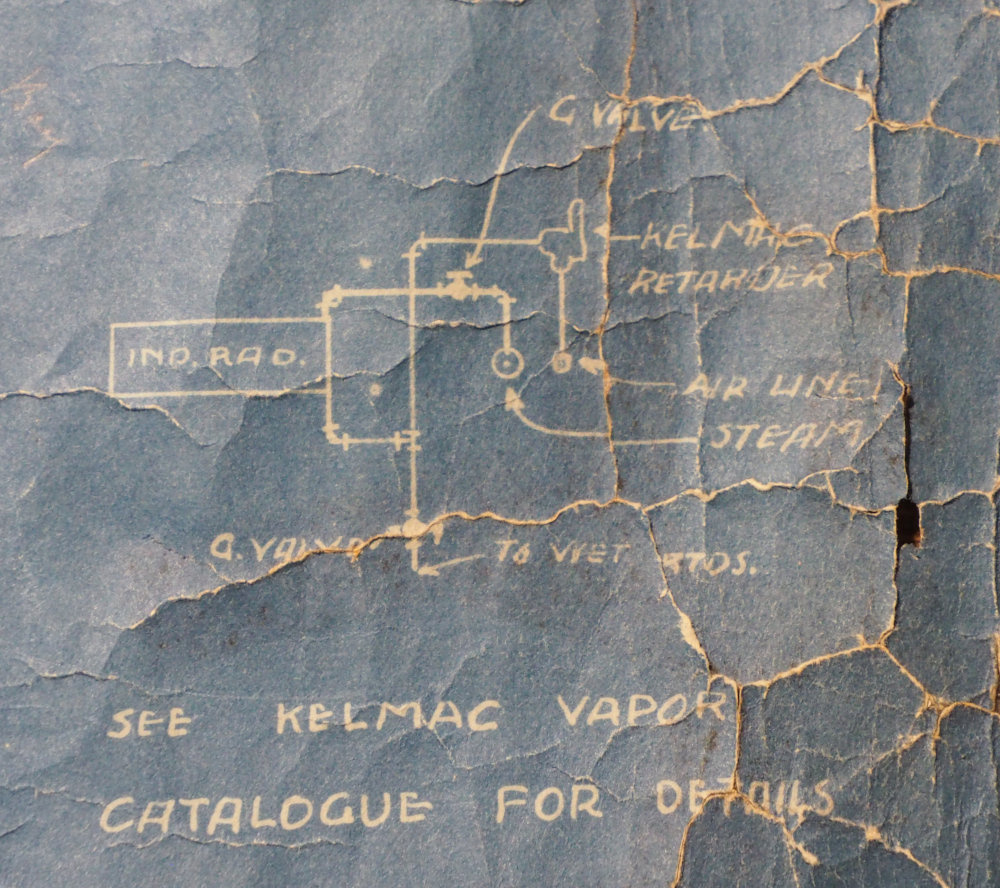

    The blueprint of the Kelmac system shows a retarder tee-ed off the at radiator outlet. See pic. One might reasonably surmise that it was the original setup; then when the Bryant Gas Boiler was installed in 1924, vents were placed in the basement, i.e., the two old vents in earlier pic (maybe the Kelmac Retarders went bad); then the Hoffman 1A were swapped out in the mid 70s. Don't see any trace of mains vents' previous existence. I guess that is weird? Perhaps the traces disappeared because some insulation was replaced in 1924?
    edited June 2025
    Looks like the radiator in the diagram was installed in the basement- maybe an indirect rad that fed ducts going to main living areas?
    Semi-retired
    do you still have indirect radiators?
    the kmc diagram in tlaosh shows some device from the mains to the air main which presumably are the main vents.

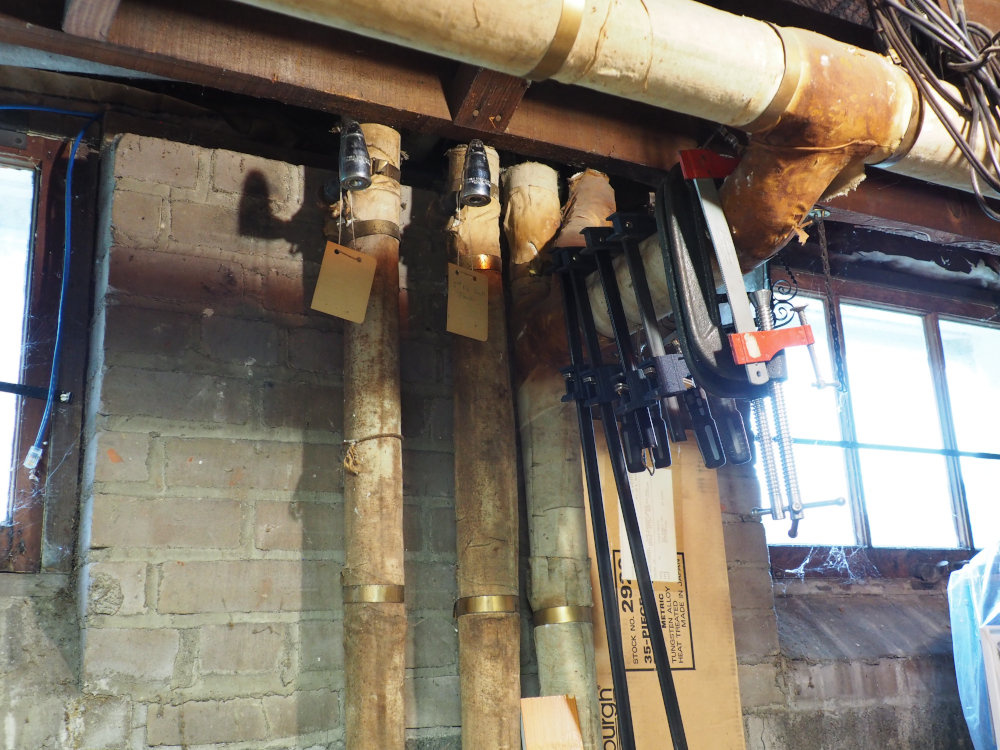

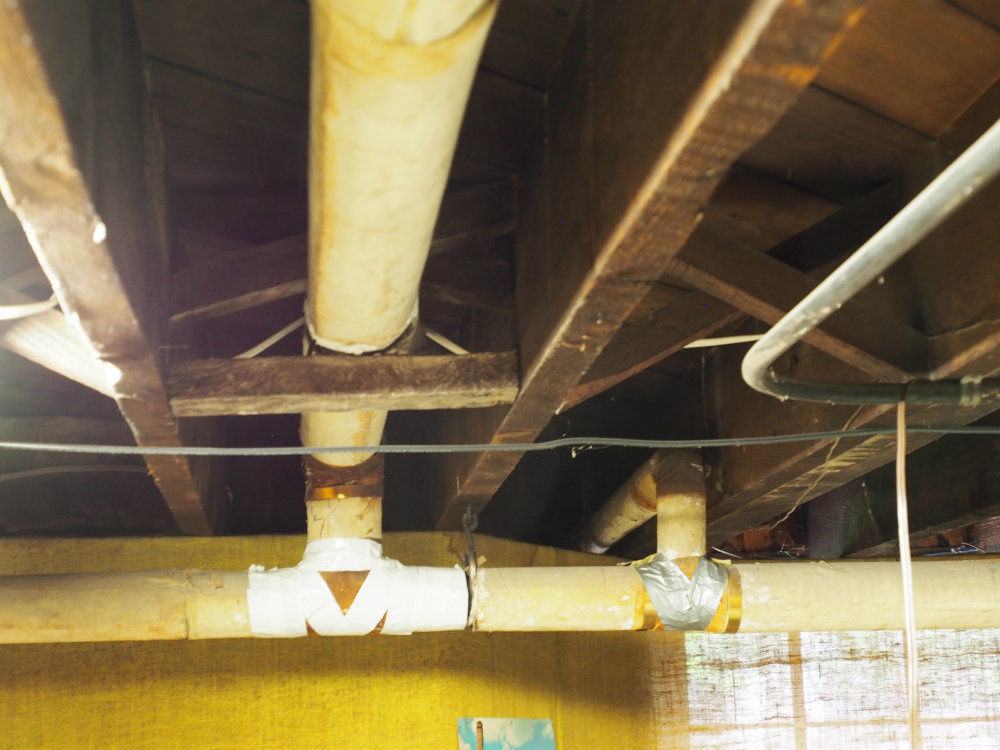

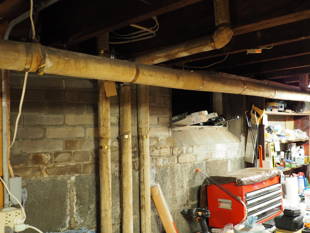

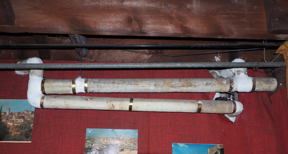

    Satisfying a request for more pics. Having learned a good deal about my system, lately, It seems pretty basic. Not sure if the pics will add much insight, but here they are.
    This is the "funny piping" example. Apparently a mains drip; it goes down vertically behind the curtain. Next to it, obscured, is a separate radiator drain with a barely visible Hoffman vent.
    Next is the wet return about ~8" off the floor. I found 3 levels of wet returns, including 15" and 26" heights. Curious. However, there are 3 branches of wet returns. 2 wet return branches are 1 1/4" one is 3/4". Curious.
    Here is the end of a main branch; it drips down and supplies up. The right pipe is a radiator drain with vent (hidden).
    10 feet over are 3 radiator drains with vents.
    Continuing to next wall are 2 radiator drains and a mains drip and 2 supply pipes heading up.
    Here is a mains crossing to the other side of the house.
    I dunno. Pretty boring I guess.
    it is very confusing. i have questions but i'm not sure what they are yet. there is a lot of piping there. that insulation looks more mid century than 20's.
    I don't know what is happening where there is a tee and the pipe goes up and down and off the branch of the tee. Might not just be a tee in there.
  • pacoit
    pacoit Posts: 127
    edited June 2025
    Oh! I thought it was an example of radiator outlet setup for each radiator. I wondered what "IND" of IND Radiator meant. But, in fact, in the 70s. a duct (presumably with indirect radiator) that went to two floor grills "foot warmers" was removed to provide headroom to make the basement more accessible and useful!
    Well, if that's the case, then the original 1917 radiator venting setup remains unknown. Could that schematic also have applied to all the radiators?
    I still wonder about the schematic's reference to "air line". Was the setup originally a vacuum system?
    Edit: I found piping to the removed IND radiator is still there.
    the trim was probably similar. the indirect radiators would be sized to heat the room. they were to heat fancy rooms without you seeing the radiator in higher end houses. frequently they were ducted to use 100% outside air from a vent outside somewhere.

    So, as is, my system, as many have suggested, seems to be woefully under vented (10-15 min heating cycle). I should clarify my use of the term 'heating cycle': it's not the boiler ON time; it is the time for the radiators to begin getting steam.
    If I were to add venting to the mains, is it correct that I should place a vent at end of each main? Each of my mains branch to a Tee where the distribution takes place. So, should I place a vent at ends of each Tee section (2 vents per Tee section)?
    and then the existing vents would clear the air from vertical supply pipes and radiators?

    Basically, that's it. Vents on the ends of the mains.
    The major difference in your system from most vapour and regular two pipe systems is that over the years it has been modified so that the original venting arrangements have been lost, and the Hoffman 1As have been put on all the radiator outlets. In a "normal" system the radiators would vent into a dry return, which also carries condensate and in turn vents to the atmosphere. Nothing wrong with that — it should work just fine, provided that the vents work!
    You mention a vacuum system. And enquire about vacuum type vents (which vent air, but hold against a vacuum). Such vents are available. Two problems: first, they are very expensive compared to normal vents. Second, you would need one for every radiator… or to add dry returns or vent lines, which introduces other problems since then they would have to be trapped or you would nave to add orifices.
