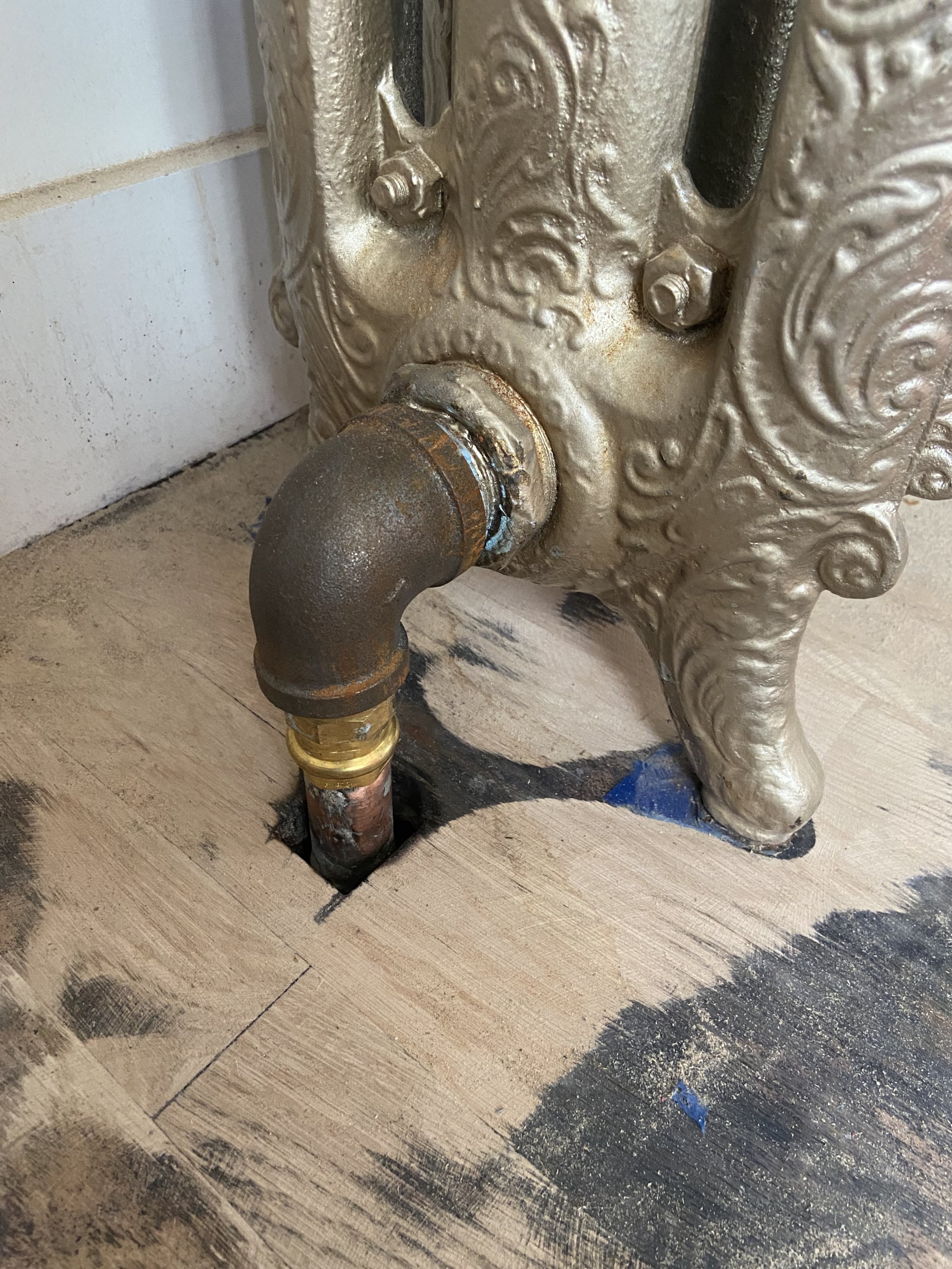

Hi, can anyone advise me on how to proceed. The plumber disconnected the radiator form the input and output valve bled the system that repeatingly. They also kept feeding it water from the furnace. They other radiators are working fine. Can anyone assist me in determing the problem. The plumber says to get a new radiator which I do not agree with.

    here is the pic. How much pressure should the furnace be should we raise the it? We already opened the bleed valve

    Why pipe dope on a union 🤦🏼‍♀️

    The radiator was removed and reinstalled to install new floors. Then there was a leak, called different plumber who said leak was fixed paid him and it has not worked since. The valve and feed elbow we’re changed.
    There are 2 radiators connected to that feed. The other radiator is working.

    Is the gold part called a union? If yes that part is pressured not saudered. We think that part is incorrect but plumber said it is.
    The spud is the part that screws in to the radiator that mates with the valve. the part of the spud and valve that go together with the nut is called a union. It is to allow the piping to be taken apart. It doesn't need to be doused in dope and teflon tape but is unlikely to be the cause of your lack of flow. That spud should have come with the valve, they aren't standardized so it need to be the part that came with that manufacturer's valve, but if it were wrong it would leak, not prevent flow. If you open the bleeder, does water come out?
    since that copper pipe is very unlikely to be original, i wonder what else was done.
    When you open the small silvery valve at the top of the radiator on the outlet end, does water come out?
