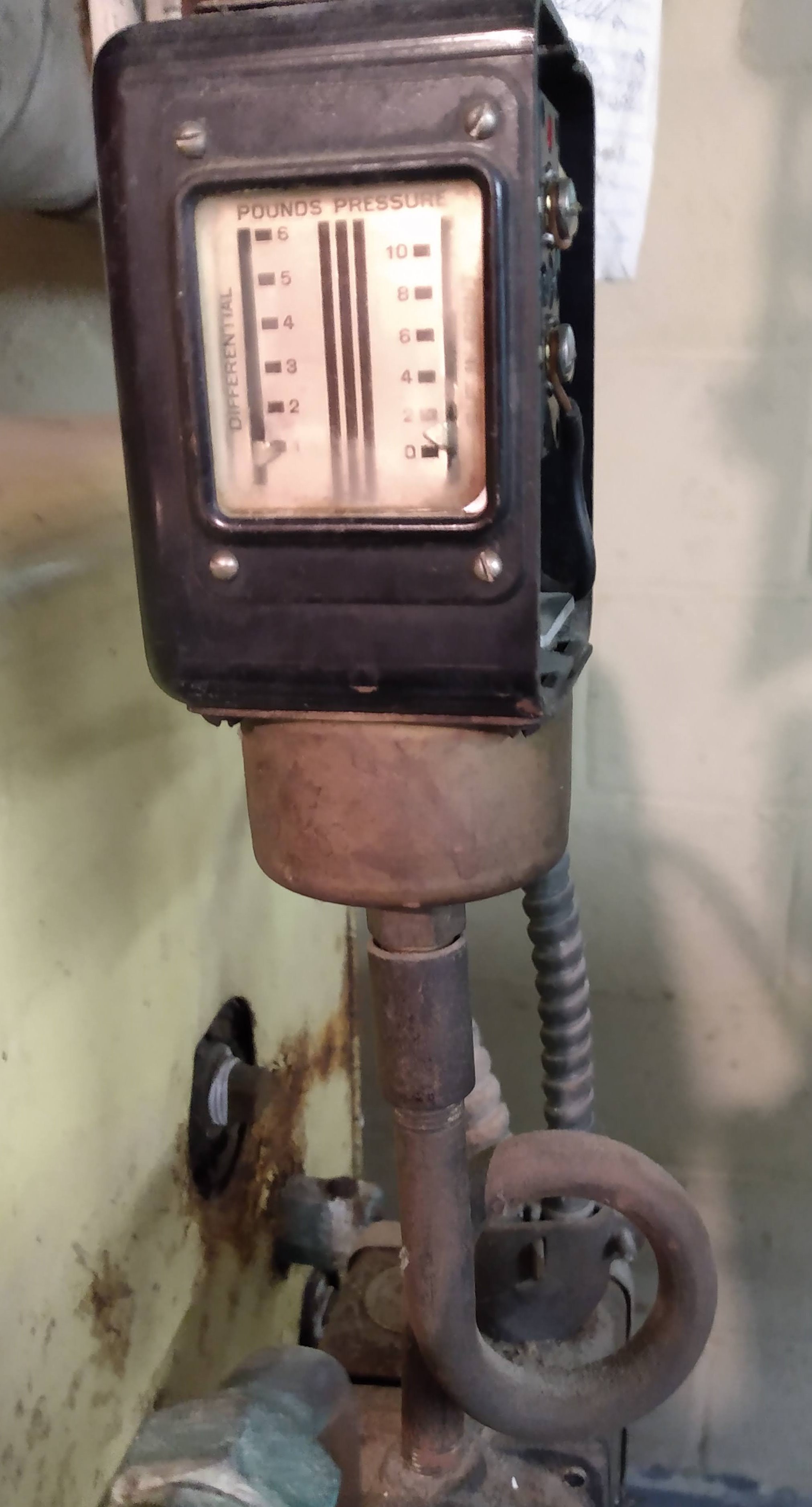

20 years ago I moved into a small house built in 1950. One pipe steam heat. Ancient yellow Burnham heating chamber, Beckett model AFG burner, Honeywell R7284 primary control (which was replaced ~15 years ago). Once a year I have someone come and do the "annual startup/cleaning service" as part of my oil contract. I check the water level once a week when I do laundry, fill as needed, and drain out and replace some dirty water every few weeks. Other than failure to ignite now and then, requiring me to go down and hold the reset switch a few seconds, it just plain works and keeps me warm through the winter.
Got me through last winter fine and I shut the main switch off in late April. But then we had a very rare chilly memorial day weekend here in NJ, so I turned it back on one morning for a quick dose of heat. Normally when the system is completely cold like that, I know it takes maybe 45 minutes or so to run through the first cycle and for all radiators to get warm, at which point it shuts down for 5-10 minutes before coming back on until the thermostat temp is reached. But this time I was sitting in the room above it and after an hour I started to think "it's been running a long time". Then the radiator started hissing, which it normally never does. So I went downstairs and saw the 0-30psi gauge on top was around 12lbs. Now, I never really paid attention to it before, but I kinda think it only ever got around to a few lbs before shutting off. So I flipped the main switch and forced it to shut off. By then the house had warmed up anyway.
If it was mid winter I would just call for service, but since i won't need it again for another 4 months, I decided to maybe see if I could diagnose and fix it myself. I'm no great handyman, but I can replace a faucet or the innards of a toilet, or take apart the dryer and replace the belt. Basic stuff. So I googled a little bit about how the system works.
The pressure shut off is an oil-o-matic 'type 400', I assume the same thing as a basic honeywell "pressuretrol". I tried doing the following today :
Completely drained the tank. Removed the panels from the pressuretrol, and the low water cutoff, loosened and retightened the wires. Same with wires from thermostat. Put water back in tank. Turned up thermostat and flipped main power switch on. It fired up. With panels still off, I then used a wooden popsicle stick to carefully press up on the metal plate at the bottom of the pressuretrol. The system shut down. When I let go, it restarted after a few seconds. Same with lifting the little mercury filled bulb in the low water cutoff. So I seems as if all wiring/switches work fine. Shut main switch off.
I read about the pigtails getting plugged up which seems to me the most likely thing, so I figured I'd next clean that out. I disconnected the wires and removed the pressuretrol. I then tried to snake through the pigtail with both a small pipe cleaner and a long heavy ziptie. Neither would get further than the bottom of the pigtail ring.
Tried (with hands) to unscrew the pigtail, but it's not budging. Is there a trick to it? Should I try soaking it with liquid wrench or something? Thoughts/suggestions? Or should I stop messing with it before I make it worse and just call someone to deal with towards the end of the summer?

    You can use something like a screwdriver or small pry bar or piece of pipe as a lever through the curl of the pigtail to turn it, try the lever with one hand and support the back of the pigtail with the other so it turns at the base instead of trying to bend it at the base or there is some possibility you could break it off of the lwco housing.
    The blowdown you should be doing should be at the valve at the bottom of the lwco with the boiler firing. It should stop after you let a little water out. That lwco probably should be rebuilt or replaced to make sure it is clean and free to move.
    Scrape the pigtail outside with a file or a knife to see if it is brass or steel. Steel will be shiny brite and brass will be yellowish.
    If steel it should be replaced with brass.
    If it is steel it could be rusted in place and may be difficult to remove and it could break.
    Best bet is a small pipe wrench grip it as close to the boiler as possible. If it feels like it will break you may be better off calling for service.
    Pigtails plugging up can be a common issue.
    Also you should not have to reset your burner that is not normal operation and an indication something is wrong.
    If you use a pipe wrench, make sure it is seated so the back of it is against the tube when the jaws grip so it doesn't collapse it. If that lwco hasn't been opened and cleaned in a decade or 4 it should be.

    To get that old pigtail out, you need leverage. Use a piece of 3/4" steel pipe or a large screwdriver
    as @mattmia2 mentioned above. If you have a steel pigtail, you may need to heat the base near the LWCO cherry red with a torch. that will break the rusted seal from years of corrosion and rust that has bonded them together.
    The farther you grab it from where it screws into the LWCO the more chance it will break off.

    I would spray the threads with "Kroil" or any penetrating oil numerous times over a few days before you try to remove that pigtail. Let the penetrating oil sit for hours to allow it to do it's magic. Then use a 6" or 8" Ridgid pipe wrench, putting it as close to the low water control as possible to reduce the chance of breaking the pigtail. Try turning the pigtail just slightly CW as if you are trying to tighten it before you try to remove it. The last torque that pigtail saw was when it was installed so the resistance to turn will be the least when turning it CW as if still tightening it. When you get it out, replace it with a brass pigtail and use Permatex anti seize lubricant.

    Follow retiredguy's advice.
    That pigtail's older than I am.
    Forcing this pigtail off without soaking it with oil can easily break it off at the base. Soak with Kroil, tap on it with a hammer, soak some more — every day for a week or as long as it takes to loosen it up. Otherwise you'll be trying to extract a 1/4" steel stump from an ancient boiler.
    Better yet, forget about removing it and work on unclogging it… Use a piece of stiff stuff wire, oil, a tie-wrap, anything you can poke and work at clearing the crud out. When you make progress try blowing it clear.

    Heat could loosen it, Another method would be to cut it after the curl and stick a rod almost the same size as the id in it so it doesn't collapse and use a small pipe wrench. Someone with some experience would be able to feel where they should try force and where they should try something else.
    The elephant in the room here is that that lwco should be disassembled and cleaned anyhow.

    A short piece of the coiled outer sheath from a bicycle or lawnmower cable bent out at the working end to have a slight auger hook may act as a small custom snake. You could use a drill motor to turn it.
    If the old pigtail is too much problem a new one with a few new pipe fittings could probably be added here (Red arrow in picture) assuming that tapping goes into the boiler, looks like that plug may come out easier.

    Agree that if the pigtail doesn't come off easily after soaking with the anti-seize then this may be advisable to try vs risking breaking off the pigtail. For only $10 this tool might also be worth a try if you can't find any pure 1/4" steel spring cable that you can sacrifice. https://www.lowes.com/pd/RotoPlumber-Cleaning-Kit-Attachment/5005510875
    I most certainly would run a cycle and do a blowdown to verify whether your lwco is actually functioning to turn off the boiler.
