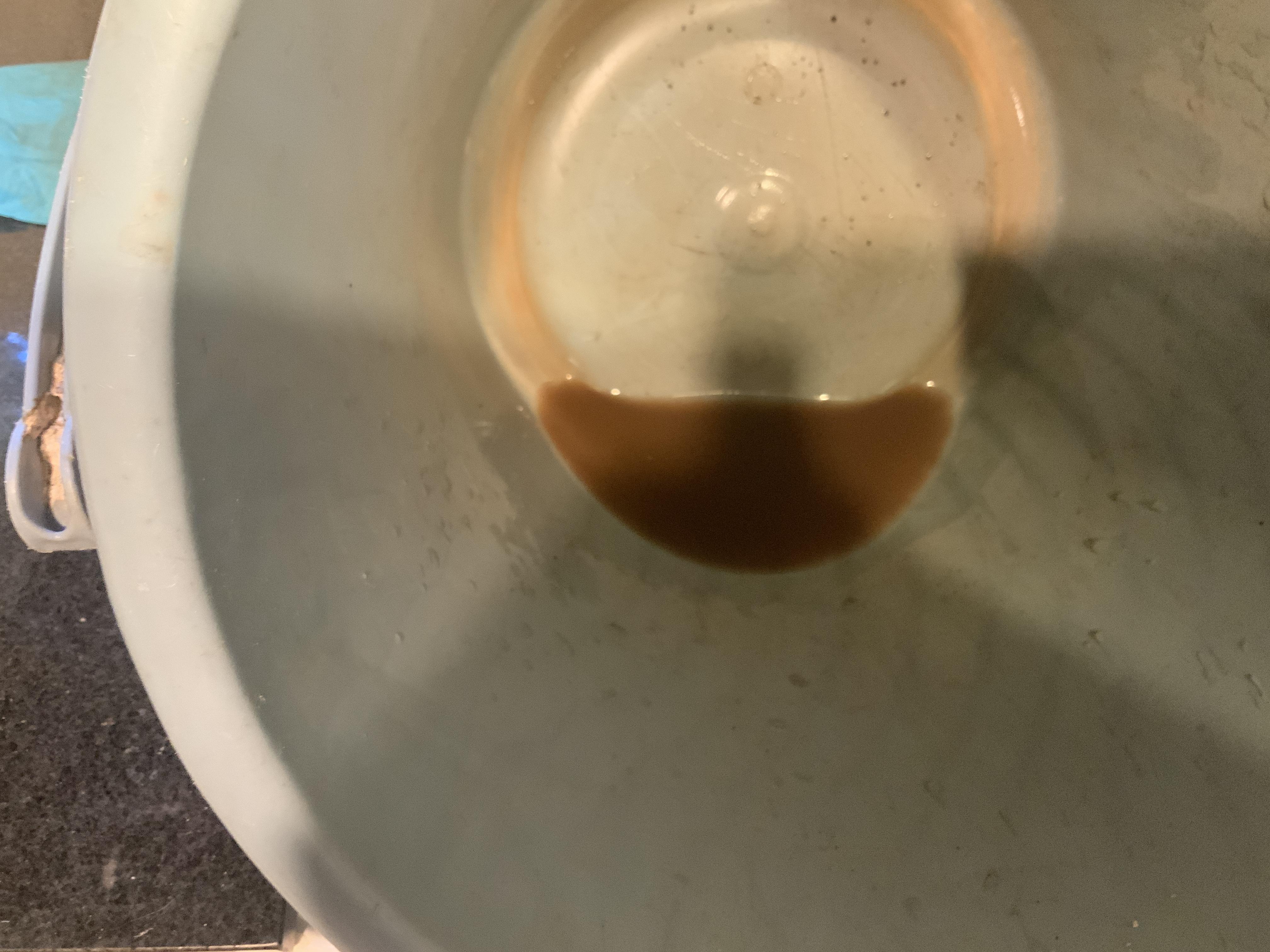

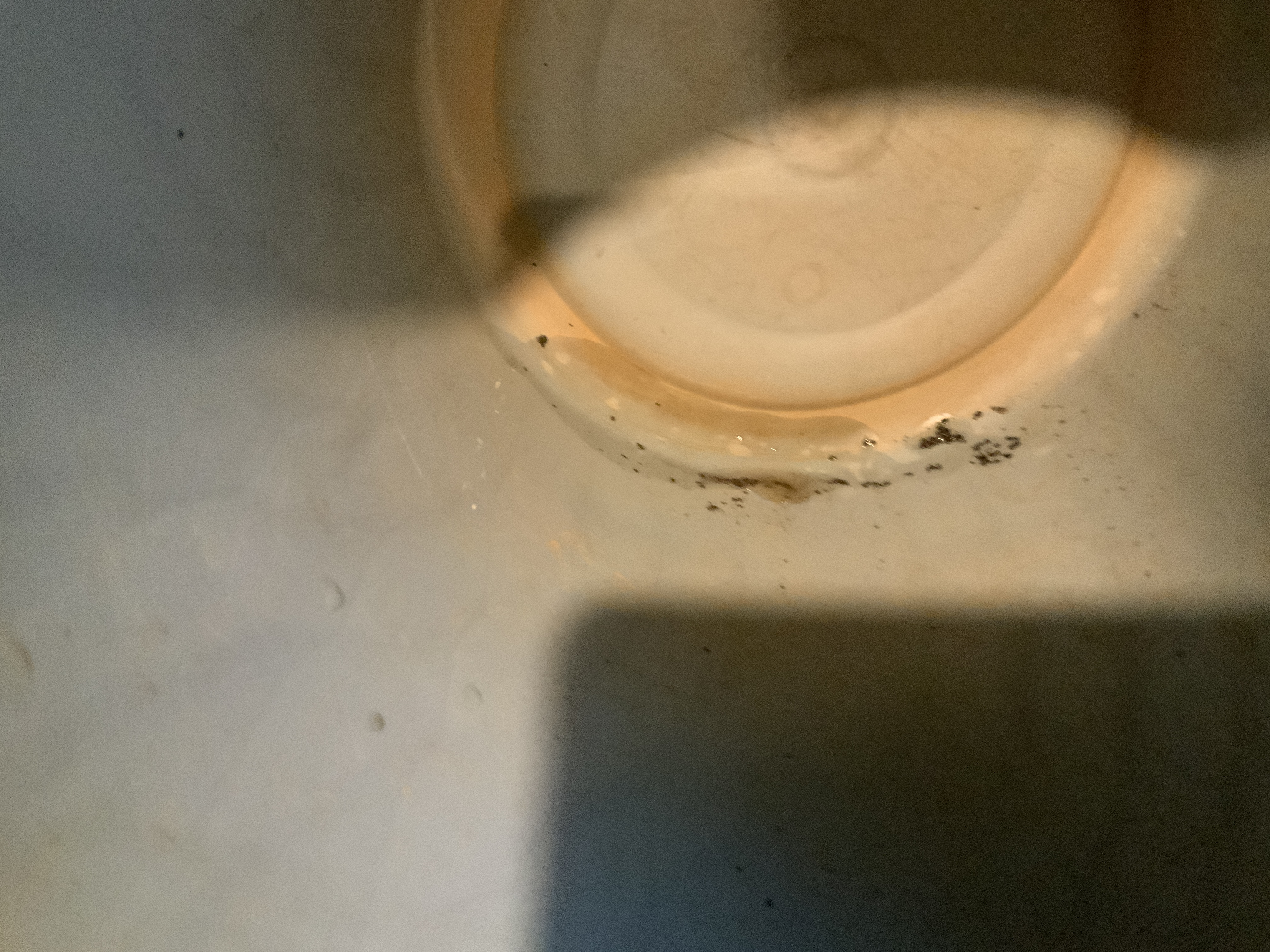

    Clogged vents?
    I am attaching a pic of the rust particles from the boiler. These are very large compared to the ones that clog the vents. The vents have a small amount of water which does not seem to interfere with their operation

    Thanks ethicalpaul, that is an impressive feat. Here is what my rusty water looks like after 1.75hrs of operation yesterday.
    I think most of this crud is coming from my pipes and not the boiler. I have no definitive way to prove it but since my boiler is ending it’s 3rd season and I have been adding 8-Way, the latter is only inhibiting rust in the boiler but not the pipes. However, if the pipes above the waterline last indefinitely, then my only option is to tear out the insulation on the entire wet return and check the condition.
    My other suspicion is that the rust buildup is throwing up water into the mains and creating wet steam which is why I find water in the vents when I go to rid them of rust particles. While this water is not oily, the smaller rust particles get suspended in the boiler water which eventually get suspended in the wet steam and travel to the the vents. These particles are not large enough to clog the BMs.
    I will drain my boiler and put distilled water + the 8-Way and see if that helps.
    Thanks.
