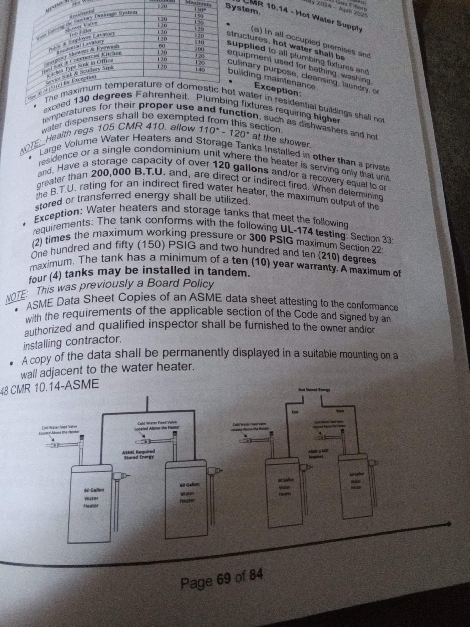

    What state are you in? In Massachusetts here I just took my annual training, and this is what I encountered for code changes. It appears in commercial installations, the total btu of all the tanks is being considered. The only exception is up to 4 tanks with UL-174 testing and a 10 year warranty. Who was the company that did the inspecting, Hartford, Federal, or another?
  • pedmec
    pedmec Member Posts: 1,459
    We do large volume water heaters all the time and all are ASME rated. This is how the Mass plumbing code reads
    (e) Large Volume Water Heaters and Storage Tanks.
    1. Water heaters and storage tanks shall be stamped as ASME compliant when:
    a. Installed in other than a private residence or a single condominium unit where the heater is serving only that unit and,
    b. Have a storage capacity of over 120 gallons and/or a recovery equal to or greater than 200,000 B.T.U. and,
    c. are direct or indirect fired. When determining the B.T.U. rating for an indirect fired water heater, the maximum output of the stored or transferred energy shall be utilized.
    Examples:
    a. An 80-gallon tank with a recovery rate 210,000 BTU must comply with ASME requirements.Two tanks installed, each with 100-gallon capacity with an indirect water heater with a recovery rate of 199,000 BTU feeding tanks shall meet ASME requirements.
    Exception: Water heaters and storage tanks which meet the following requirements:
    a. The tank conforms with the following UL-174 testing:
    i. Section 33: Two (2) times the maximum working pressure or 300 PSIG maximum.
    ii. Section 22: One hundred and fifty (150) PSIG and two hundred and ten (210) degree maximum.
    b. The tank has a minimum of a ten (10) year warranty.
    c. A maximum of four (4) tanks may be installed in tandem.
    2. ASME Data Sheet.
    a. Copies of an ASME data sheet attesting to the conformance with the requirements of the applicable section of the Code and signed by an authorized and qualified inspector shall be furnished to the owner and/or installing contractor.
    b. A copy of the data shall be permanently displayed in a suitable mounting on a wall adjacent to the water heater.

    I just found this in the MA. Plumbing Code, looks like the inspector is right. Just noticed this is the same thing @pedmec posted above.
    it's common for most states to follow what ASME says.
    (g) (h) ASME Requirements for Large Volume Water Heaters and Storage Tanks. 1. Water heaters shall be constructed to conform to the specific sections of the ASME Code when the heaters have the following features: a. Installed in other than a private residence. b. Having a storage capacity of over 120 gallons and/or a recovery equal to 200,000 B.T.U. c. Being unfired or heated by direct firing by means of oil, gas (natural, manufactured or bottled propane, etc.) or electric resistance elements. d. All safety controls required by ASME shall be supplied in strict compliance with ASME standards. e. f. Examples: i. An 80-gallon tank with a recovery rate 210,000 BTU must comply with ASME Standards. ii. Two tanks installed each with 100 gallon capacity with an indirect water heater with a recovery rate of 210,000 BTU feeding tanks shall meet ASME standards. The requirements of 248 CMR 10.14(10)(b)1. do not apply for water heaters installed in a single family dwelling only or a single Condominium unit having separate water heating source for the specific needs of that unit only
