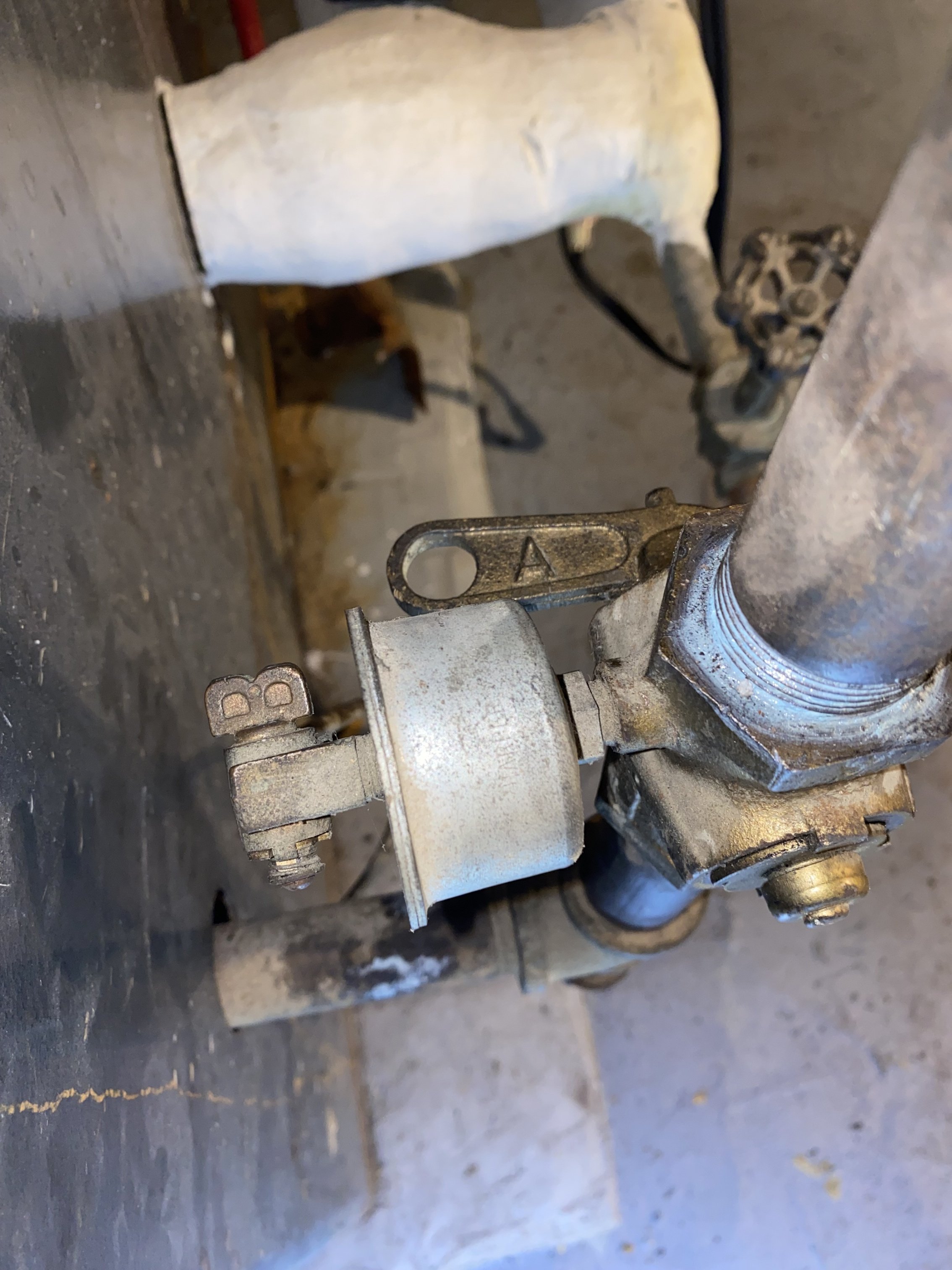

Hey everyone bare with me on this one… So I get a call for a few gas leaks leading to the boiler. I get on-site and see an old Weil Mclain H-9 boiler natural gas… I fix the leaks and proceed to visually inspect the boiler and fire it up and hit a snag… It has a pilot line coming from a manual open close valve on the main gas line(closed because national grid closed it when they went for the gas smell). So the only way to light the pilot is to open it obviously, well there's nothing that controls the gas flow once you open the valve it just dumps gas to the pilot and you light it! So if the pilot flame goes out it continues to dump gas!! No way this can be the original design but the pilot valve definitely looks original. Someone replaced the gas valve in 2019 and it sure seems they made a few modifications. This boiler also has an automatic pilot little box that has its own thermocouple looking rod by the pilot that has 24 volts sitting at it and when it senses the pilot it sends 24volts out through the safeties and so on. Obviously I can rip the gas train out and put something with a standing pilot but this baby is old and not sure it would be worth it. Anyway's there's no way I will leave this as is because there's nothing that controls the pilot gas!! Anyone ever run into one of these before? I'll attach all the pictures I have. Thanks.

    I think the idea was that the pilot would never go out. IF the pilot ever went out, the small amount of gas would just "float" between the cast iron sections and go up the chimney. We have seen many old boilers and many old kitchen stoves with this type of pilot.

    If you look closely at the last photo you posted, the vents on the main electric gas valve and the main gas regulator are also vented to the "combustion area." I think the idea was that if one of these rubber diaphragms leaked it would also just ignite or not and go up the chimney.

    That setup does use a thermocouple- it is connected to the White-Rodgers "automatic pilot" control, which cuts off the electricity to the main gas valve if the pilot goes out. But it is not a "100% shutoff" system since the pilot gas is not cut off if the pilot goes out.
    Converting that would require a combination gas valve that could handle at least 560,000 BTUH. ISTR Robertshaw makes these. You'd reroute the thermocouple and pilot tube to the new combination gas valve, remove the separate pilot valve and plug the opening.

    Standard pre total shutoff rule gas train. Not really enough gas from the pilot to be unsafe unless you are really trying to collect it or don't follow the lighting instructions. The relighter is just a high voltage transformer that sparks if there is not flame and grounds out the flame is present and providing a current path.

    That was common to have a "hot" or "active flowing" pilot train at that time. Yes, the intent was that the NG would just go up the chimney if not burned. Some gas valves and regulators had vent tubes that are terminated at the pilot to burn off any excess with the same logic in mind. Now any such vents have to be vented outside.

    If it were LPG it would have had a total shutoff valve, probably a separate valve before the pilot and the main valve or a switch and pilot valve that was held open with a thermocouple after you pressed the button. LPG has been more or less always total shutoff because it is heavier than air and tends to collect. Might have been made when total shutoff for all gas heating equipment was adopted in some locations and not others.

    There are Baso thermocouple valves that shut off all the gas with a pilot tap after the shutoff. I don't recommend modifying it unless you replace wit with a modern combination valve for liability reasons. Modern valves have a double seat that the old gas trains didn't. If you just make it total shutoff pilot and leave the rest of the train you aren't bringing it up to current standards.
