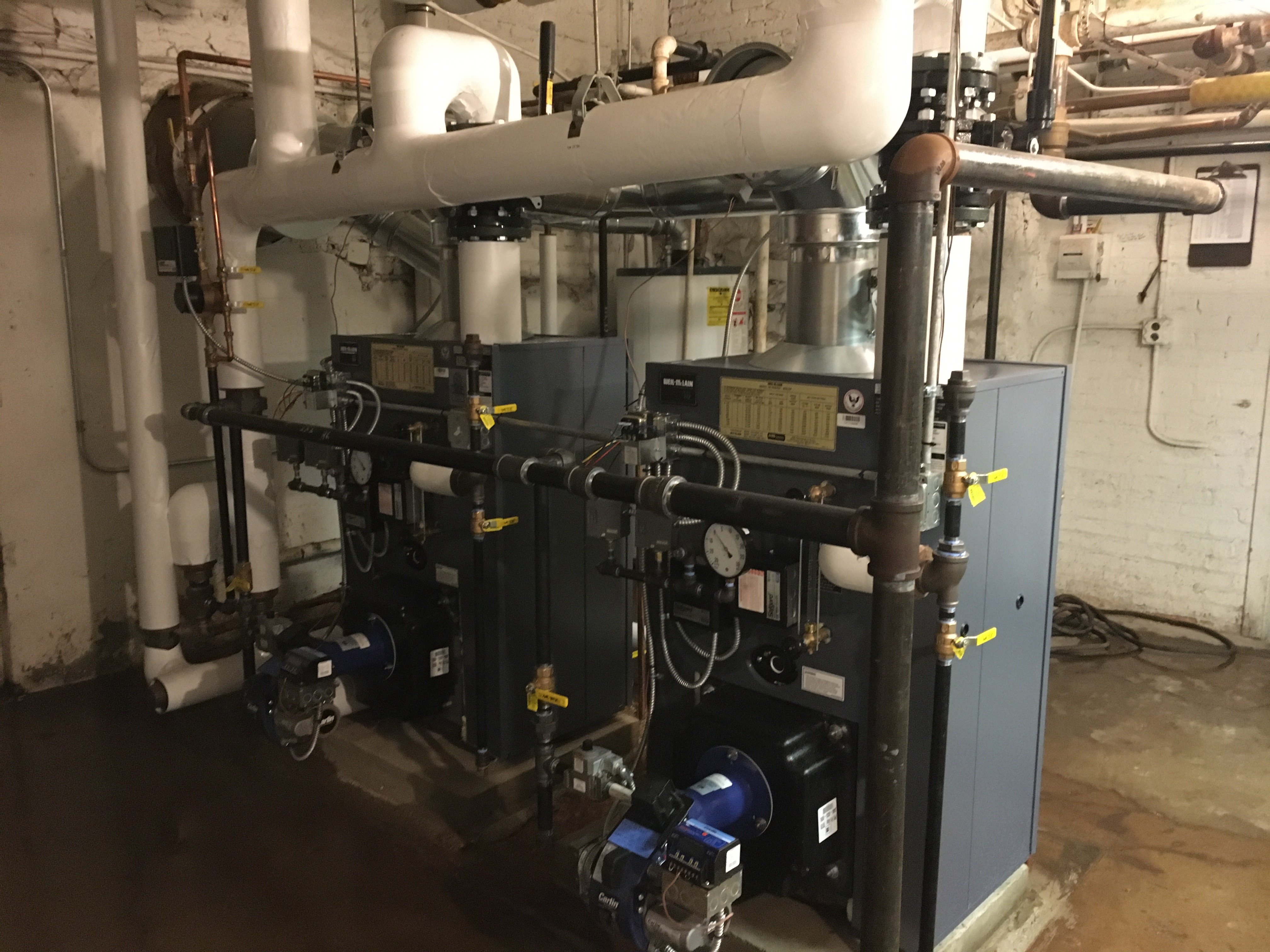

  • The Steam Whisperer
    The Steam Whisperer Member Posts: 1,326
    edited May 2025
    Here's a pair of 380's steamers. They are balanced on the supply with 4 inch risers and a common header and on the return with a 2 inch common return tied to a shared condensate pump. Water levels are rock steady across the boilers. They are stage fired by the two stage thermostats that run the zones valves .The radiation is all 2 pipe with supply valve orifices that allow partial heating of the convectors/radiators. We have a number of twinned steam boiler applications and have no issues with water levels as long as the common piping is generously sized. Twinned steam boilers have been in use for over a hundred years. Getting them to work is all in the piping and large tappings of the boilers.
    This is about 1/2 the space they heat spread over 4 zones. At design load (0F), with most zones in setback( 45F), a single boiler will supply all the zones with the heat needed
    From the efficiency curves that I can find, the efficiency of atmospheric boilers really startsdropping quickly at about 30% load. Power burner boilers seem to hold efficiency well down to about 10% load before dropping quickly.
    Attached is a bit of history of this heating system and efforts to make the building more green. Current fuel bills are about 1/2 of what they were in the past.

    They made a slight deception in their description of the improvement. TWO 380's are about 720K. It's a bit disingenuous to suggest 350K is sufficient………..despite the fact that it can manage 80% of the heating season.
    The 380s refers to the Weil McLain model # 380. They fire at 345,000 input each. One unit at 345,000 input heats the complete structure at outdoor design when most of the zones are in setback. It is really neat stopping by when it is 0 F and seeing only one boiler that is 18 inch deep and about 30 inches wide running to heat around 14,000 sq ft of space in Chicago. The uninsulated sanctuary ceiling peaks at about 50 feet, IIRC.
    mattmia2dabrakemanLong Beach EdDave in QCA
  • LRCCBJ
    LRCCBJ Member Posts: 1,043
    This would beg the question of why TWO 380's when one is sufficient in the design day? It's quite a bit of additional cost…………for nothing.
    Or, do you need both of them to recover from setback which would affirm my original premise regarding their deception.
  • bburd
    bburd Member Posts: 1,324
    Because for one boiler to heat the complete structure on a design day, most of the zones must be in setback. One boiler will not heat the whole building to the normal occupied setting in that situation.
