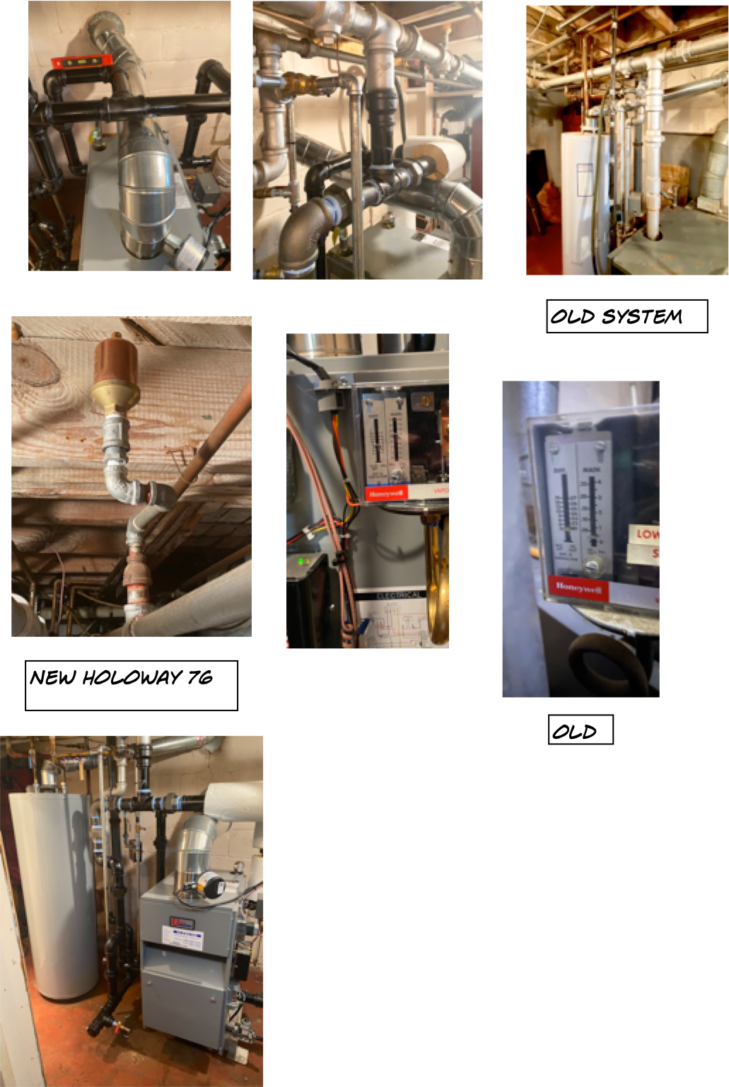

    pictures of system. were the vapor specialties that had the vent in the boiler room kept in place?
    it could just need skimming.
    where is the vaporstat set? is the vaporstat cycling? what is the edr of the system and the new boiler?
    edited November 2025
    Pictures before and after, if possible. Something changed — and the question is what?
    And what were the previous vapourstat settings? 4 and 10 may be too high.

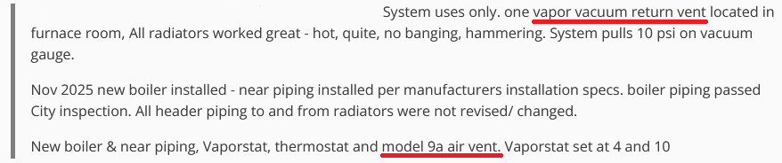

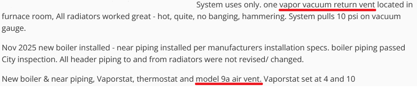

    Are the " one vapor vacuum return vent located in furnace room " and the " model 9a air vent " the same item ?
    Did one replace the other ?
    Was the " model 9a air vent " added ?
    Does the system still pull 10 psi (?) vacuum ?
    If the vacuum return vent was removed and a non vacuum vent was installed they did not do you any favors IMO.

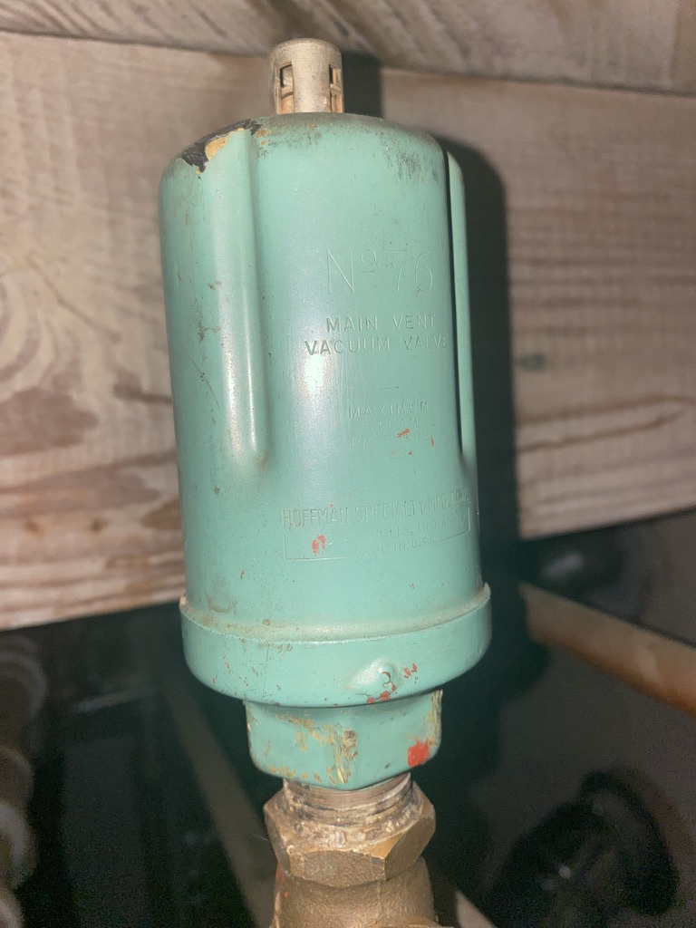

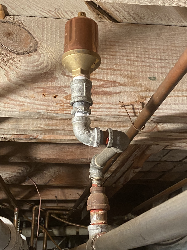

  • My mistake - the model 9a vent. is actually a Halloway 76 vent.
    Are the " one vapor vacuum return vent located in furnace room " and the " model 9a air vent " the same item ? Yes
    Did one replace the other ? Yes
    Was the " model 9a air vent " added ? new Halloway vent replaced the old Halloway vent
    Does the system still pull 10 psi (?) vacuum ? yes
    OLD 76 VENT -
