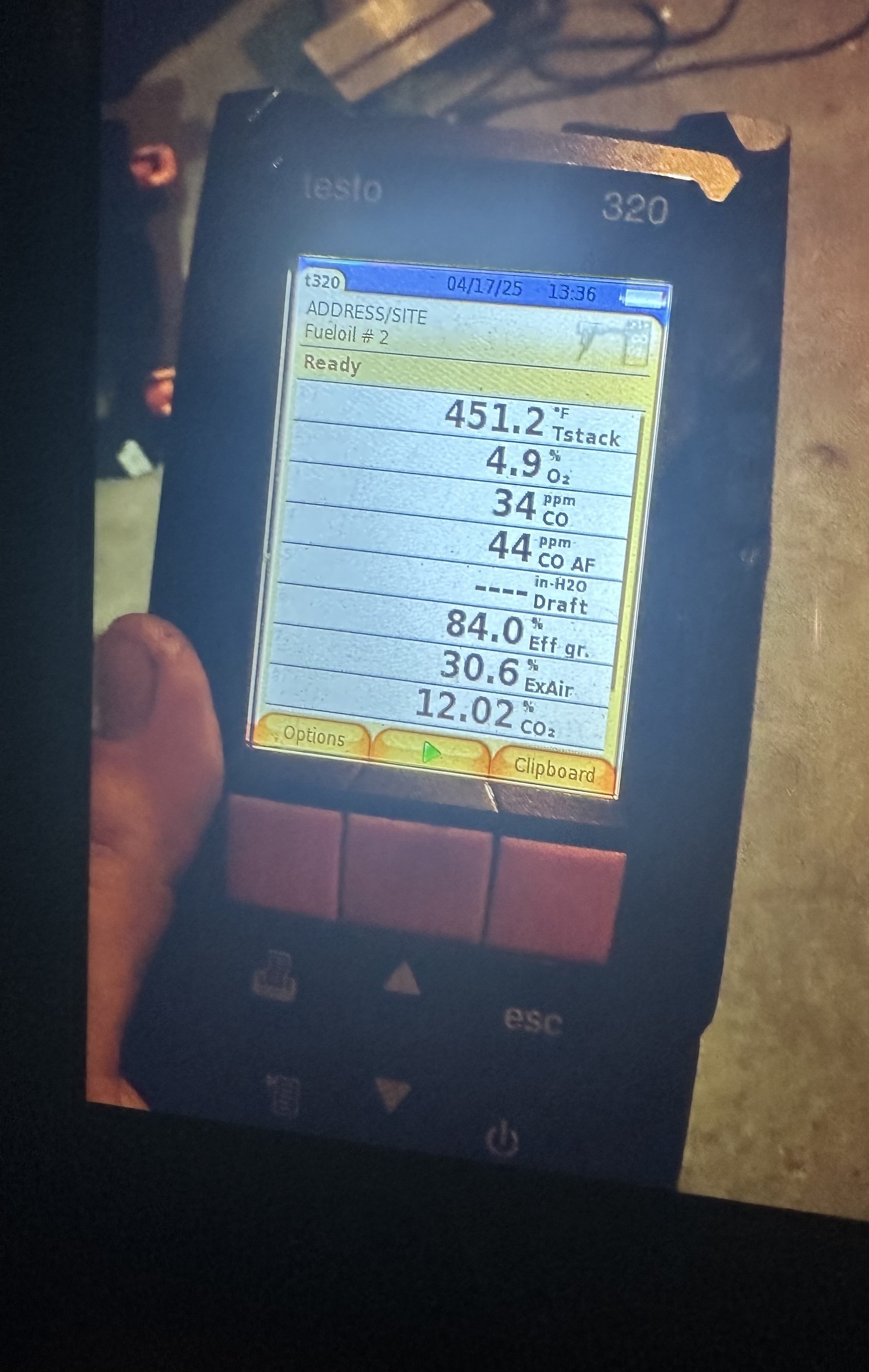

    I don't know what to say. Can 9 different techs be that stupid?? Seems hard to believe. The chimney has been lined the combustion has been checked.
    Possibly an after drip from the pump if it is not clean cut or has no solenoid?
    I did have a job once with a failing oil pump. You would get normal oil pressure but every once in a while the pump would drop a couple of psi and the fire would get lean and stinky. Checked pump strainer, nozzle filter and oil supply and all were good. Replaced pump and fixed it.
    Cold be a slipping coupling as well. Sometimes ok sometimes not.

    I’m wondering that as well they all have there own way of doing things some way knowledgeable then others I kno 1 thing they always want to change the nozzle and it’s always a different size I got several down there that they left I know nothing of what there’s surpose to actually do so I can’t say much there I just kno there’s a smell and it’s only when the boiler runs
    HVACNUT Member Posts: 7,584
    Tell the analyzer to show draft in the breach. It must be zeroed out first. Over fire needs an extension piece or it'll cook the sensors.
    Take the top cover off the boiler. There's a flat plate with 4 bolts. It's also has a cover for top flue. Make sure all is tight. No gaps in the kaowool rope.
    What size liner? A typical terra cotta chimney is 6.5" x 6.5", and the flue on the boiler is 7 inch. Verify over fire draft.

    More and more I'm thinking that either something is overheating or there is a slight oil leak somewhere — but not combustion.

    This thread is long and I concede that I haven't read every single word carefully, but has anyone else given this the sniff test? Sometimes people (and I'm not saying you) believe they smell things when the suggestion is there - maybe there was something wrong that was adjusted/repaired but you think you are smelling it.
    Assuming there is a smell -
    I would do a draft test as everyone suggested in order to make sure there is negative pressure in the stack and the breech, but I would also leave the draft gauge in place after the boiler has reached full temperature and watch it to see if the pressure goes positive when it cools down. If it does go positive, any leaks will allow/push fumes out of the boiler.

    thanks everyone for the suggestions and information on the boiler as I was just
    told yesterday that there is 2 pinhole leaks in the block they said it’s not worth repairing so time for a new 1 this person actually opened the boiler and everything unlike the let’s do a combustion test and get outta here for 2/.5 hundred per for diagnostic
  • MaxMercy
    MaxMercy Member Posts: 622
    Pinhole leaks won't cause an oil smell. Maybe you were smelling hot water evaporating from the block.
