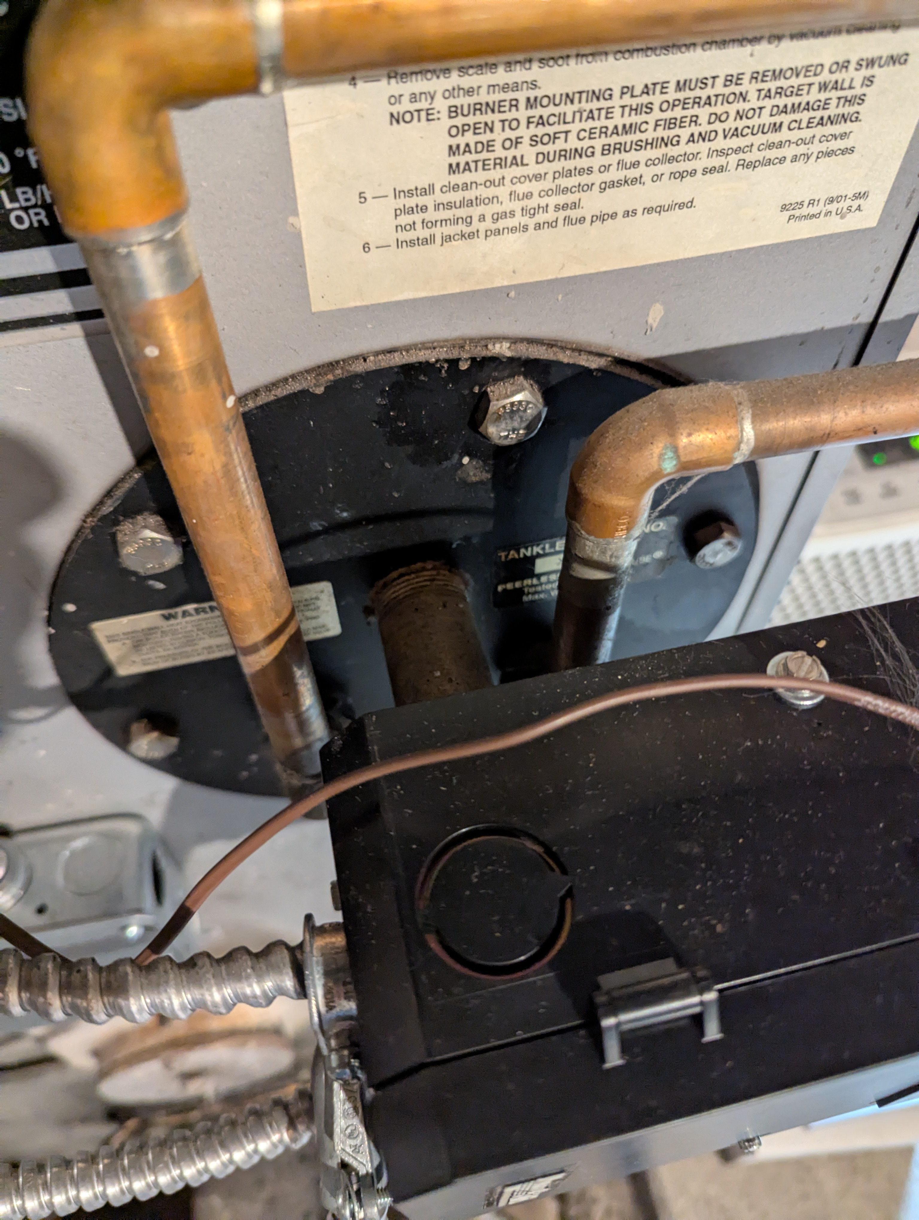

After chasing our tail all winter with less than optimum hot water, new aquastat, etc., we now have a coil leak. Isolated it by shutting off the cold water supply on the coil. Thence the PRV is no longer leaking. It only leaks when there is pressure in the coil.
I would like to change the coil. Bolts are clean, no visible corrosion. Coils and seals seems to be available commercially. This coil lasted 17 years on public water.
Heating season is over. Just not sure we want to take the chance if breaking a bolt on the disassembly. Tech says not worth the risk.
Any opinions?
    Tech says not take the risk?
    So according to your tech its a new boiler or try to replace the coil. Why would you not try to replace the coil?
    If yo want a sure thing your our other choice is to abandon the coil and plug both coil connections and install a separate hot water tank or an indirect HW tank connected to the boiler.

    the bolts looks to be in good condition, but a competent tech can remove or drill out a broken bolt. put anti seize on the new bolts so this isn't a concern.

    The company will not want the liability of breaking bolts or tapping. Its not like the old days. If a HO wnats to try it so be it then you can try heat Kroil oil or whatever.
    Those bolts look easy to get out but a tankless isn't great for hot water so I would go for a separate tank or water heater.
    You could put a wrench or socket on the bolts and give it a tug….but not so much pressure as to break it and then decide. If they come out new coil if they don't put in a tank.
    3/8-16 bolts don't break that easy.

    Luckily any plumber can cap off a coil and put in a water heater

    Coil off a boiler was a bad idea when fuel was cheap, they are a terrible idea now. The boiler dumps more heat into the house and up the chimney than into hot water outside of the heating season. That heat that is dumped into the house now needs to be also cooled. The most expensive way to heat hot water.
    Replace with a tank (heat pump water heater or resistance tank) and be happy you got rid of the tankless coil. Your wallet will thank you in the long run.

  • Thanks for all your inputs. We did find an option to change the coil. Local tech with a good reputation. That's plan A. Plan B will be probably be something with more efficiency down the road. Propane or electric is our only option in the Poconos.
