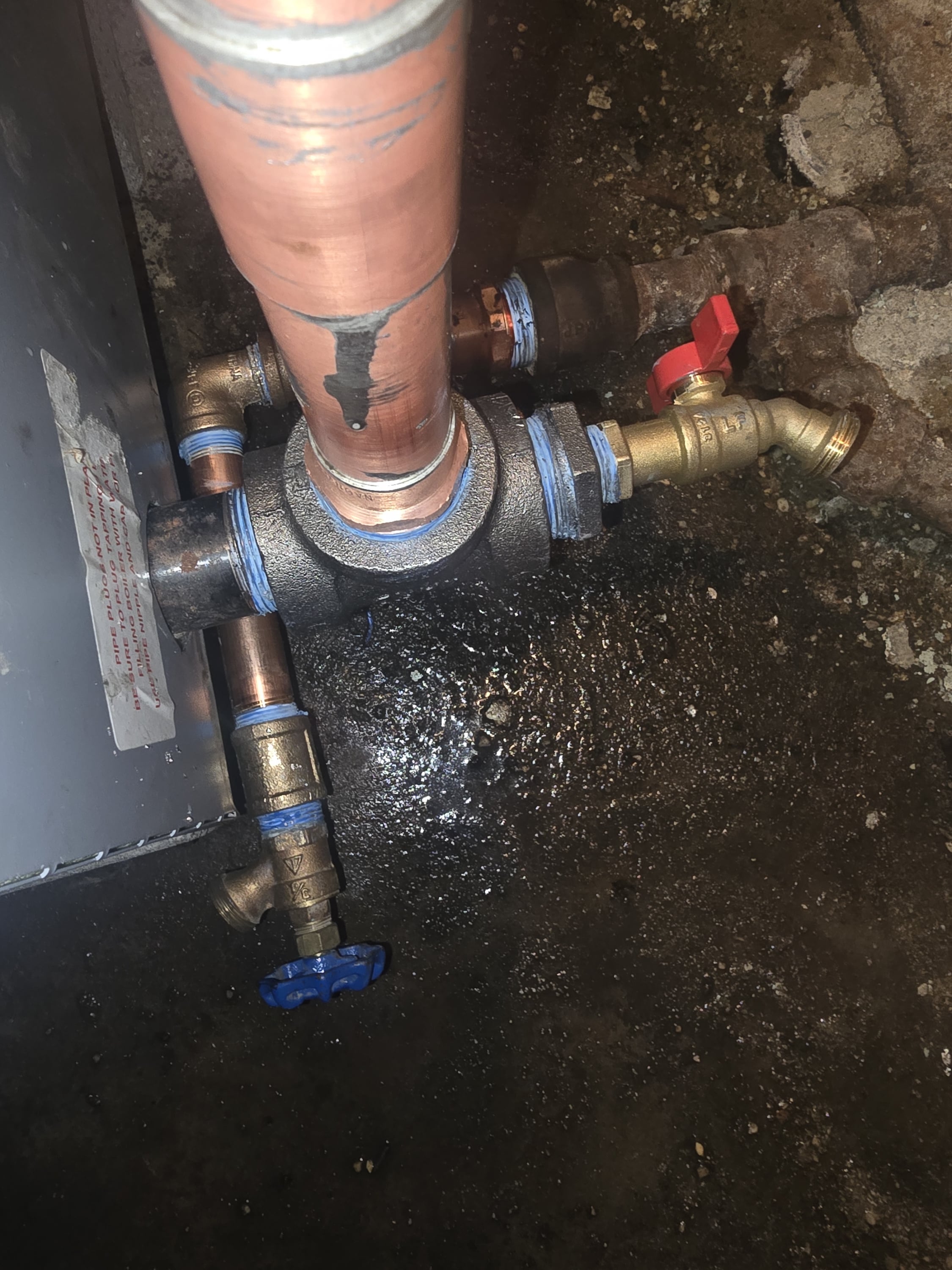

Hello,
Today I've discovered some water on the floor and made a few pictures. It's a steam bases heating system and I think it's not that old. Visually black colored pipes look much better than others. I guess when the boiler was installed only the pipes around it were replaced. On 1st picture there are 2 vertical pipes: black, that looks newer and another one behind it. I believe they are 2" size.
There is threaded coupling between them. The rest of the images show the same coupling from different angles. My questions
  1. Is it just very old and rusted out? Or there could be another reason for this damage? (I can see other horizontal pipes that look not good. )
  2. Is there any other fix except a replacement? There are no unions close to that section and it's a tight space because of a water heater staying next to the boiler. So I believe it will be a challenge to disassemble it.
  3. On first image, there is an elbow goes from vertical to horizontal right direction. There is something between the elbow and a pipe that goes to the right. What is it? Was it used like an extender or it has different purpose there? Maybe it's a size reducer?
  4. Is that rusted pipe/coupling pips also a black pipe or it's a different type of material?
Thanks

    Well that's a bore. All the pipes in your photos are black iron; just some of them are newer than others.
    The "something" which you mention — if I'm looking at the same something — is just a close nipple, a standard short piece of pipe with male threads on both ends used to connect two fittings — in this case an elbow and a T.
    Now you do indeed have a leak, rather a small one, in one of those threaded joints. There are lots of reasons why a threaded joint might leak, but only one permanent way to fix it: disassemble it, clean up all the threads, and reassemble it. Without seeing much more of the piping, I can't tell you how much disassembly might be required, but I can assure you it's possible: it was all threaded together, and it can all be unthreaded. There is, however, a temporary (meaning anywhere from months to decades) fix which might work. I think this may be the horizontal in a Hartford Loop (can't telll without seeing the rest of the near boiler piping) and, if so, is under very low pressure. If you can get all of the surfaces involved very clean — right down to bare metal — careful application of the appropriate JB Weld epoxy may well do the trick.

    There's gotta be two unions, one one the black painted pipe above for the equalizer out of frame and one on the horizontal run for the Hartford loop, also out of frame. I betcha a dollar that close nipple is rotten.

    Thank you for all response. I'm adding more images to display the whole picture.
    It definitely looks like the nipple between new and old pipe is rotten.
    About the unions: 1st one is on Front picture above the T. I don't think it helps me anyhow.
    Second union is only on the Back, pretty far from the bad nipple. There is another pipe that almost lays on the floor, below that second union. There is a second that looks very rusted, but somehow it's not leaking (yet).
    So, as I understand, my plan is to disassemble second union and unscrew section by section until I get to that union. I will probably need to cut the water supply line that is connected to the horizontal part on the Left picture.
    If I disassemble everything from the second union to the leaked union, should I replace all the pipes, elbow and unions or just that bad nipple and the bad looking pipe on the floor?
    Can I replace them with small diameter? If so (I saw a video where that loop had smaller pipes), what is the minimum allowed size?
    About that "something": no, I think we're talking about different things. It is visible on Left picture. The bottom elbow - it looks like there is male to female adapter inserted in the elbow first and then the horizontal pipe is connected.

    You can use copper on anything below the boiler water line. I would not put a copper adapter into the boiler however. I would come out with a nipple and a black coupling , tee or elbow.

    In reality and practice, those pipes may be very difficult and close to impossible to unthead. Or they may be come apart easily. Even with two large wrenches it may be very difficult. I've used acetylene torches and still couldn't do it at times.
    Always be prepared with options if you can't get stuff apart, and those options are breaking off fittings and replacing pipe and possibly cutting and threading pipe in place.
    And watch those boiler tappings. Protect them from shock.

    Thank you all for the responses. My plan A is to replace the bad pipes with exactly the same sizes and lengths. It will be in a couple weeks. And I may get back here if something goes wrong.
