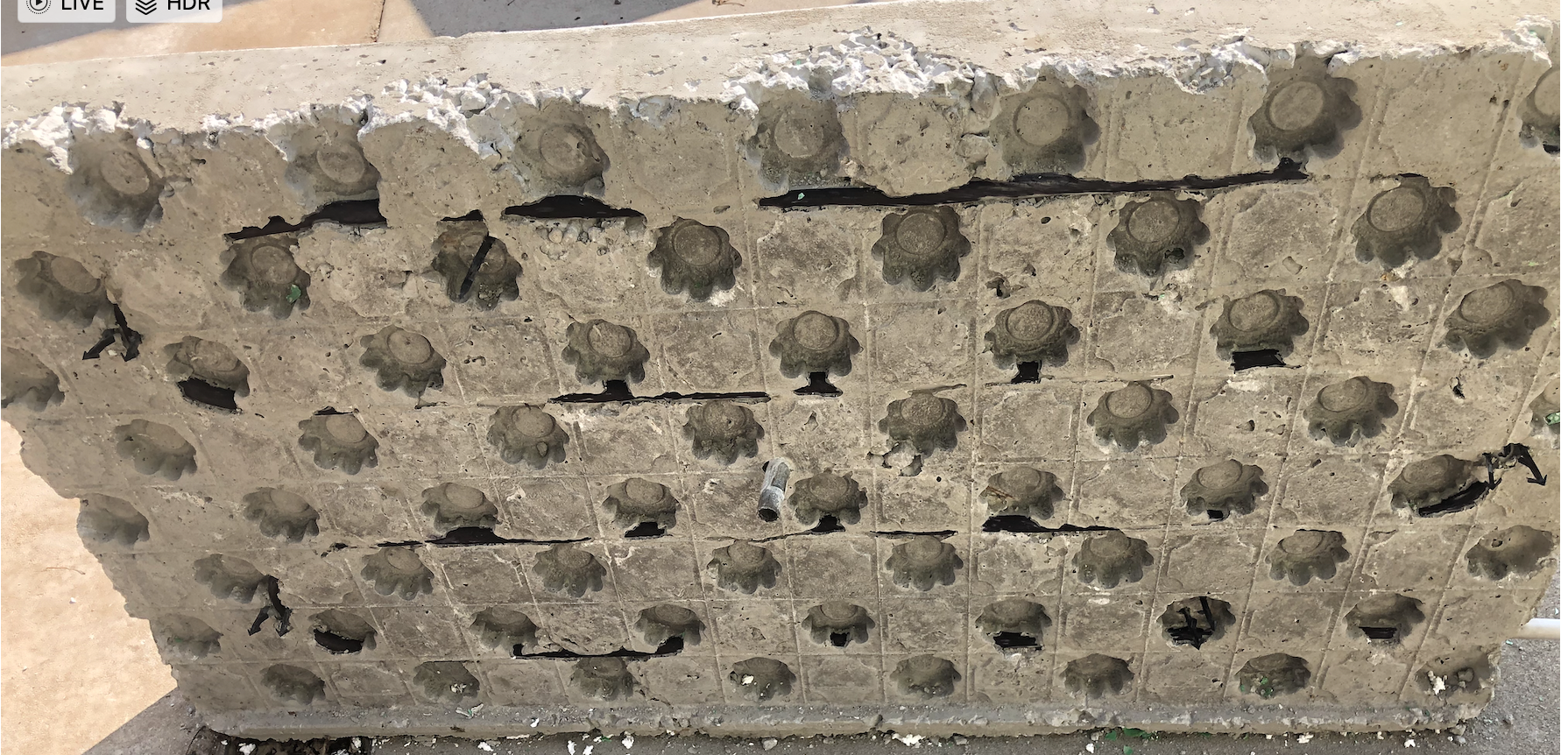

    hot_rod Posts: 28,699
    The nub type panels are quick and easy, but they do put the tube at the very bottom of the pour, and surrounded by foam and air in some cases. You will have higher downward loss, slower response, lower output, and need higher supply temperature.
    It's not too hard to fasten tube to 6X6 mesh and elevate it into the slab pour 2", you want the tube encased in the slab ideally.
    Here is how I did my shop, tube 6" oc and mesh lifted with small blocks of foam. Or buy the continuous strip metal bar chairs.
