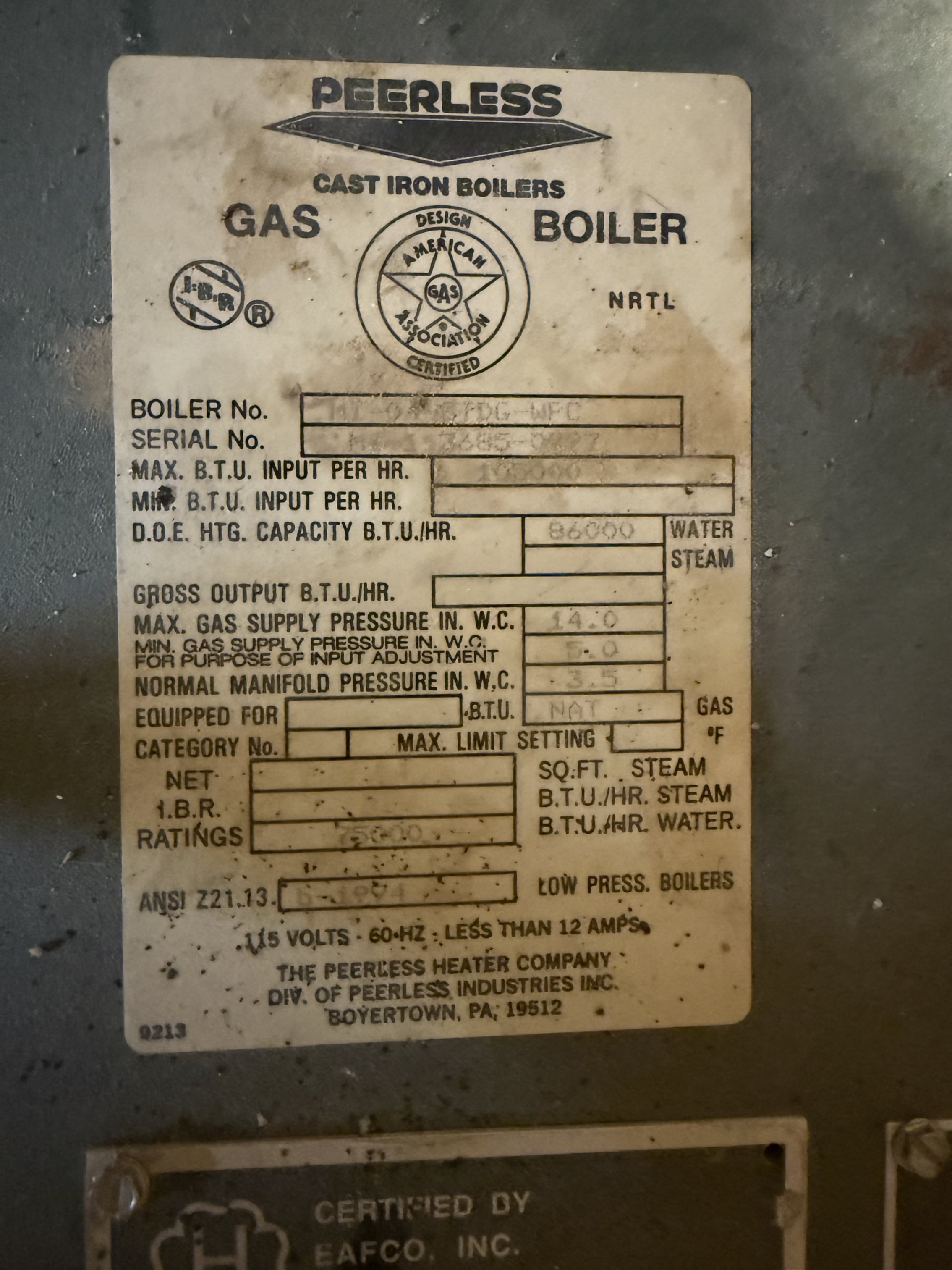

new to this site so bear with me. I have a peerless gas boiler 86,000 btu. Unit was installed in 1994 ( see attached photo)
and seems to be running good. 3 zones of baseboard heat. Question is; should I consider replacing the boiler with something more efficient since the unit is 30 + years old? I have a company I trust to do the work just wanted some unbiased opinions.

    What did your trusted company suggest?
    As the kind of homeowner I am, I prefer the 83ish percent efficient cast iron boilers for water and steam. They are dead simple, they are inexpensive to install and service, parts are readily available and installable by me, they require almost no maintenance.
    Especially, ESPECIALLY if it's currently running!! There is no chance of ROI to pull out a working cast iron boiler IMO.

    I'm just a homeowner/engineer, not a heating pro. If it was me, I'd ride that horse until it broke. Meanwhile, you have time for planning a replacement.
    Number one thing is to know how much heat you actually need. Boilers are often oversized because installers don't take the time to do proper heat loss calculations. You can get a rough idea of how much boiler you actually need by telling us (a) city/state you live in, (b) square footage of your house, and (c ) when the house was built, how much insulation in walls/attic, and what type/vintage windows.

    Zero return on investment!
    Tighten the envelope, Reduce the size of the boiler and maybe you'll get the money back on the boiler work.

    Agree with the above posts. If it has been combustion tested and is burning ok and not leaking the boiler can last at least another 10 years.
    You could get a quote, sized a new boiler correctly put the money to the side and run the old one. If your home can be tightened up, insulated and windows replace if needed do that first.

    That's good. So your heat loss on a design day is probably 20 BTU/hr/sq ft or less. That's under 40,000 BTU/hr total for the house.
    If your boiler is not also making domestic hot water (ie you have a separate water heater that isn't connected to the boiler), you could get away with a smaller boiler than you have now, but the one you have is not grossly oversized. ASHRAE recommends sizing to 1.4x design heat loss, so you would probably end up sized around 60,000 BTU/hr.
    Also, be aware that the main efficiency gain of a modulating-condensing (mod-con) boiler happens when you can heat the house with low-temperature water that allows the boiler to condense the flue gas vapor, and that depends on how much radiation you have. A 1960's house with baseboard radiators probably needs high temperature water on cold days, which means that for most of the heating season you might not get the full efficiency benefit of a mod-con boiler. And mod-cons are more complicated and potentially more expensive to maintain and service. So you could wind up with the worst of both worlds: not getting the efficiency gain, but getting the added complexity and maintenance cost.

    Does your boiler have a vent damper? Spill Switch? Rollout Switch? If so, then the only difference in the 2025 Peerless MI boiler is the operating control. It's definitely better than what you've got, but it's not worth replacing the whole boiler over.
    The vent damper is purely for efficiency. If there's no Spill and Rollout, then have your company install them, and let it ride.
