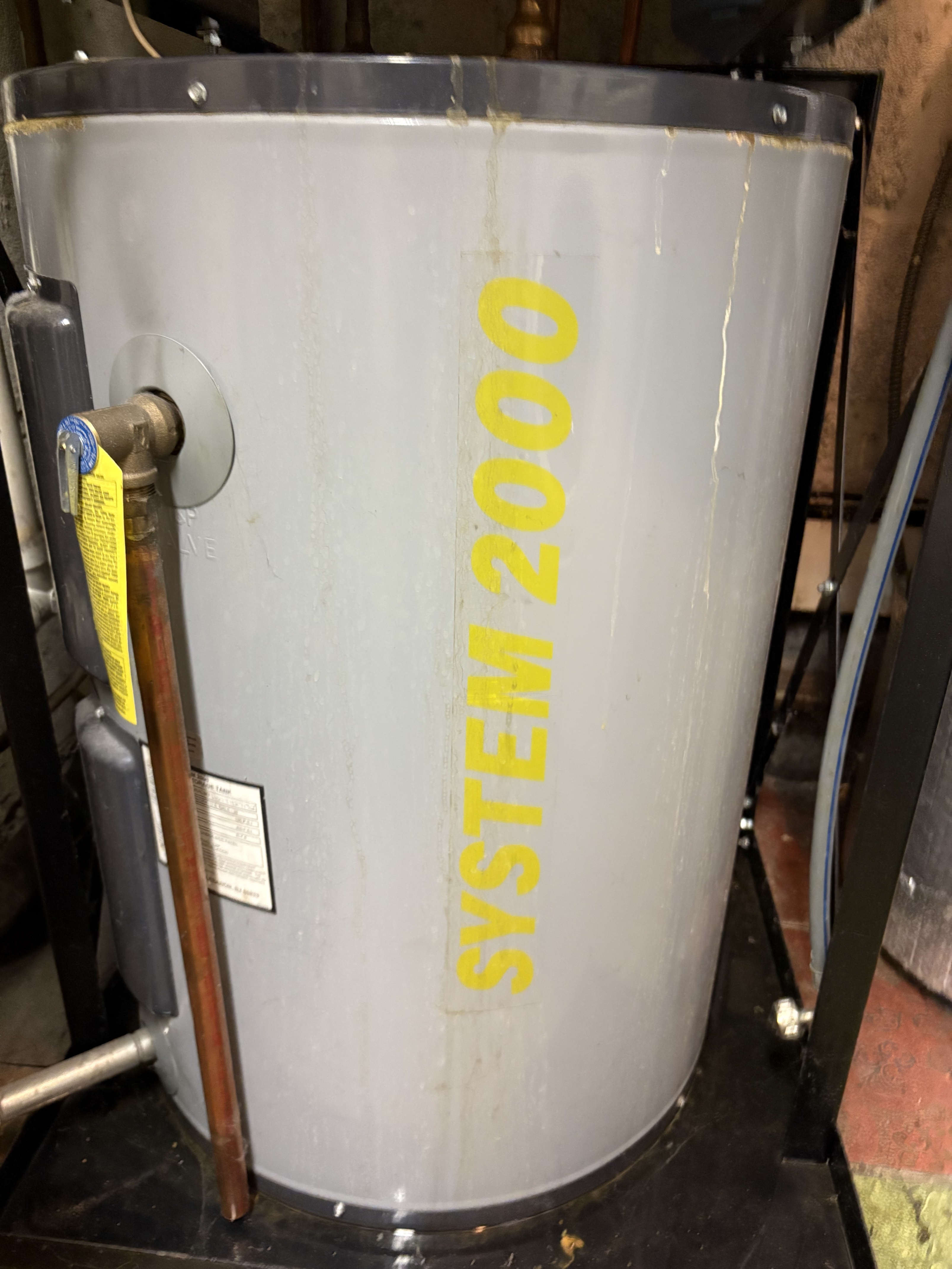

System2000 water tank leaking
skyline137
Posts: 85
in Oil Heating
My system 2000 water tank needs to be replaced. It seems like a proprietary tank for system 2000 only. How do I find someone who works on these systems? The tank is about 31.25 high and 22.5 diameter.
I don’t think supply houses sell them. Sold directly from factory to contractor.
Not everyone knows how to modify a standard electric water heater so the boiler can purge properly.
It is always best to replace it with a tank from Energy kinetics but if you are looking to use a standard electric tank there are instructions on our website to convert a standard tank for use with our boiler. Feel free to have your service provider reach out to tech support for assistance if needed at 800-323-2066
John Ringel Energy Kinetics4
