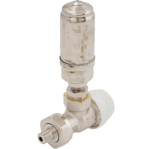

    You could put a cover over the radiator that would reduce the output. You could put a slow vent on it so it doesn't fully heat. You could put a TRV between the vent and the radiator to keep it from heating at the start of some cycles.

    Yeah exactly what @mattmia2 said— you don't need to replace them, just cover them either with a box or even a blanket and slow venting, a Gorton or Maid o Mist #4

  • Thank you all for the suggestions! It is a one-pipe system, it sounds like the TRV will be my best bet! I will try and cover it in the mean time =]

    Just remember Vent, not valve. 1/8 npt.

    Personally I would just use Ventrite #1's to slow them way down and be done with it. $35 on Ebay w/ free shipping. Not saying TRV's wouldn't be an even more elegant solution, just your money and your decision. I tend to be a bit frugal…
