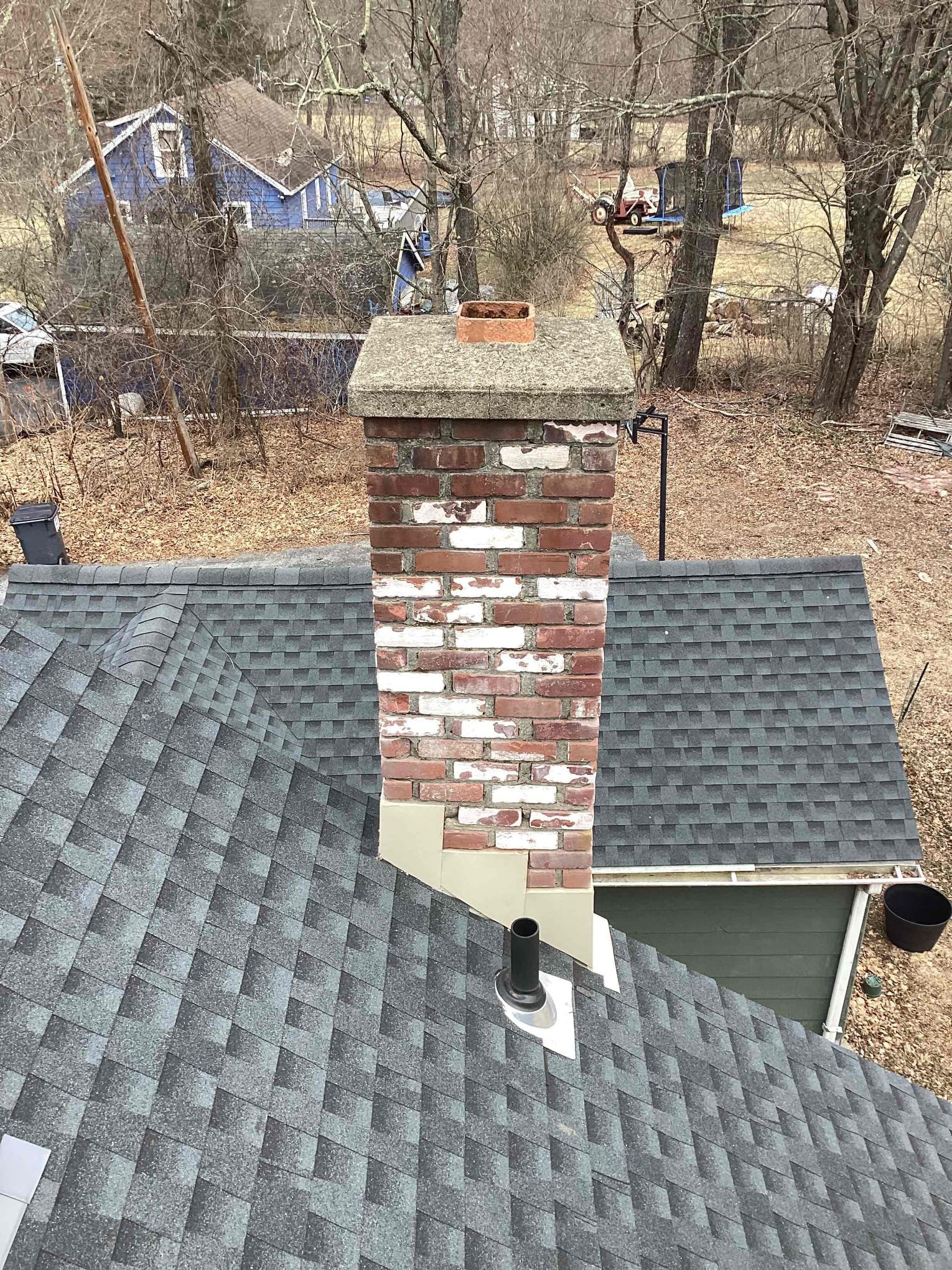

I have a very old boiler with oil heating and I live in NY. I recently had a chimney company come out and they are saying I need a new liner and repointing. I am not convinced about the liner, and am wondering if it matters whether I do repointing or lining first, as I may need to break up the work into 2-3 years. Pictures attached. What looks the most urgent/concerning?

    If it really is only another 2-3 years, repointing it then vs now won't be a lot different. if it were 5-10 years that would be a different story.

    I would start with pointing. Once that mortar starts to go it goes fast.

    I don't think the chimney guy is scamming you. It looks like you need repointing however the chimney is not going to fall down soon its not that bad but needs to be done.
    As far as relining we can't see the whole thing with pictures and what I can see looks ok. I would repoint first and save up for a liner unless the chimney guy is saying the liner is unsafe now.

    You have a Weil McLain Gold boiler, which is relatively efficient venting into an unlined, cold, exterior masonry chimney in NY. You might be able to get a properly sized smoothwall 316ss liner down this offset terra cotta but they likely would need to break out the old clay liner to make room for a sufficiently sized ss liner. The chimney must be suitable for the class of service- it is not. Refer to NFPA 211. Aside from the liner, the exterior chimney above the roof appears to have de-bonded between the mortar and brick. The Ordinary Portland Cement-based mortar is too hard for that reclaimed soft brick as noted by the spalling, crumbling and de-bonding at the boundaries. Old used bricks still have original mortar impregnated into the pores of the bed joints thus rendering them less likely to bond with new mortar. The freeze-thaw cyclic damage to the upper chimney repeatedly erodes this boundary causing the brick to actually separate from the mortar.
    Meanwhile, the weather has been eroding the mortar externally. Since there is no rain cap, significant frank water has penetrated down the clay tile putting the acidic condensation and soot into solution form where it easily destroys the mortar joint between flue tiles. From there, the water easily pours into the interstitial spaces of the chimney infusing it with soluble salts created by the acids combining with the alkaline mortar. This salt attracts water and is drawn to both the surface where it is visible. We call this chalky powder 'efflorescence'. It's a water magnet. However, there is also similar salt migration to the interior of the chimney interstitium where it condenses at the capillary break formed by the gap between the clay tile and the chimney wythe walls. Where there is bridging caused by mortar backfilled between the wythe walls and the tiles, water and salts will migrate to the interior of the clay flue tiles. As it wicks up the unglazed ends of the clay tiles, it is easily drawn up the 2 foot length of each tile by capillarity. As the water right behind the glazed or vitreous inner face of the flue tiles gets heated during a firing cycle, this trapped water converts to steam expanding 1,600 times. The result is the spalled face you see of the tiles. Now the tiles have lost mass and no longer meet the code for thickness, nor their joint integrity not the chimney proper. The cracked cast crown allows further water penetrating hastening the demise of this chimney. The counter flashing appears to be slightly let into mortar joints but not sealed in. This allows more water in.
    If you pushed hard against the upper chimney, it would probably fall over. From the comfort of my home, it appears to justify rebuilding from viable material-up.
    The chimney connector off the WM boiler does not appear to slope upwards 1/4" per LP. It must have a barometric damper per code unless that boiler mfr expressly forbids it (WM does not). The connector must be the proper gauge thickness (appears to be 26ga. galv. x 7" diameter, which is too thin. Must be 24 ga. You must have a minimum of 3 screws per joint equidistantly spaced. The connector must be supported, which it is not. No pic of the chimney breaching- can you supply? The flue was grossly undersized for both boilers firing simultaneously so glad it is shut down but needs to be disconnected, which can be done when the connector pipe is replaced.
    I think you need to consider demolishing that chimney down to where it is viable and rebuilding with a properly sized smoothwall 316ss liner to new 24 ga. galv. connector or better yet 26ga. ss rigid liner as connector with a tee and barometric damper as shown above.
    This is a very sick chimney probably well beyond simple pointing and lining. Repointing and relining do not remove those soluble salts, and pointing is not a structural repair.

    @Bob Harper I appreciate the very thorough analysis, but since I can't afford to rebuild it now, and the proposed liner and repointing work won't solve the problem, I'm inclined to just do nothing for at least another year or two. We do also have another chimney connected to a wood burning stove in the basement, which we have not yet used. We will eventually get that one cleaned, inspected, and at least repointed at the top (it goes up through the center of the house), but we have only owned this house for five years and there have been more pressing issues to address before we could tackle that.

    Punch a hole in the back of the chimney 18" above grade. Connect a few feet of smoothwall 316ss liner from a sidewall power venter, such as a Field Controls SWG interlocked to the burner, connect new stovepipe, put a rain cap on top of the flue, and call it a day until you can do something more permanent.
